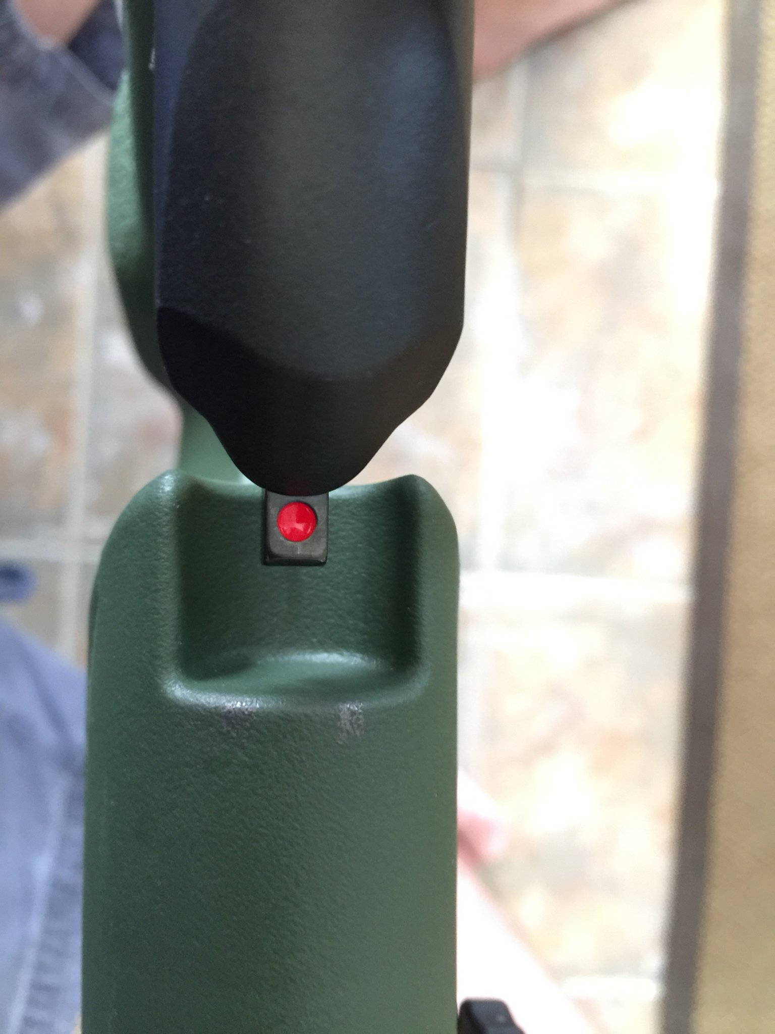

Hi all, I’ve just received my sako green bravo and fitted it to my new tikka Ctr. As others have found the bolt cannot be removed from the rifle with the cheekpiece in situ and when cycling the bolt it hits the cheekpiece.
Pretty disappointing but apart from that it looks a good little chassis for the price.
I see KRG are aware of the issue and hopefully will produce an updated cheekpiece for the tikkas. Will those of us who purchased our bravos he able to get the new cheekpieces when available?
A recess with a curving and longer (finger tip shaped) recess should cure the issue.
It looks like I need to cut into it about 4mm, this would result in a hole as the plastic looks pretty thin. How have other tikka owners done it?

Go back one page. There is already someone who cut out a notch to do exactly what you are saying.

There are some pictures on the previous page with some really clean cuts to the cheekpiece to allow it to cycle with it raised higher in elevation.

I will be using the cheekpiece at the bottom so hopefully that means I have to take a smaller notch out of it, an inch higher would need a larger notch

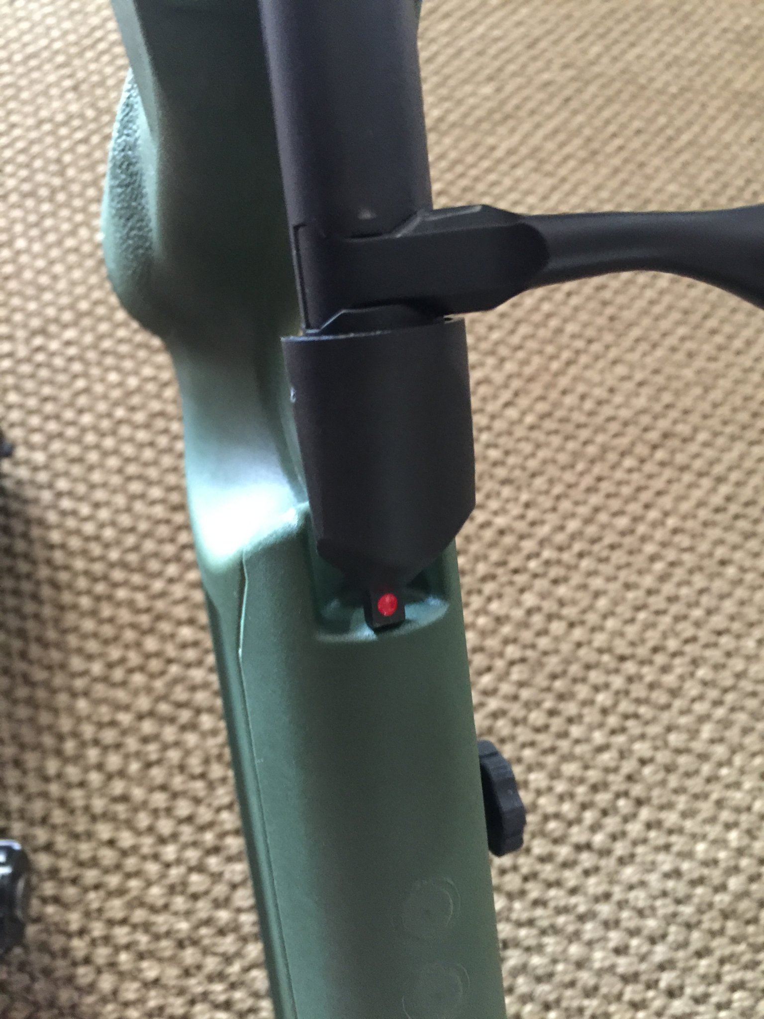

I’ve been emailing krg and they suggested that my new Ctr may have the long action bolt stop in it. I happened to have some spare tikka bolt stops so I checked and low and behold it did have a LA stop.
I swopped it for a short action stop and this fixed the safety indicator hitting the cheekrest issue.
I still can’t get the bolt out with the cheekpiece in situ but since I currently have the cheekrest fully down I won’t have an issue cycling the bolt.

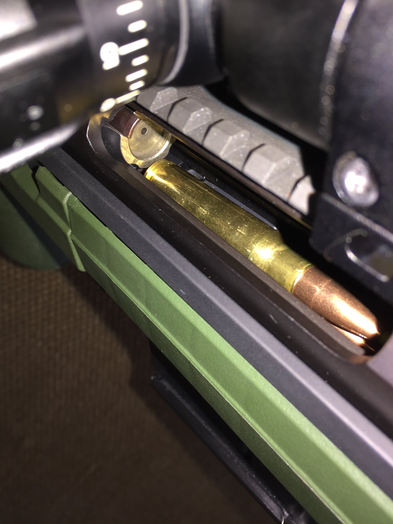

Yes, sorry about the delay. It works well with the sa stop, I initially wondered if it was a bit close to the round but it works great.
I wondered if it was a little close to the mag but no issues so far.

Huh, I wonder if this may be the solution then for the dudes whose CTR cocking indicators are hitting the cheek riser. The Bravo isn't compatible with LA Tikkas anyway
The CTR stop is between a short and long action. It's needed for use with the factory CTR stock and magazines. If you drop a short action stop into a factory CTR rifle, the bolt will not travel far enough to the rear to feed.
Short action on top, CTR on bottom.
Not in my Ctr, mine had a long action one in it for some reason.

Can the CTR bolt be removed from the rifle with the cheekpiece all the way up? Or does the cheekpiece have to be removed completely for this?

2. Previous page shows my outlined cutout of the shroud and indicator with a dremel. Took 10 minutes and looks clean.
