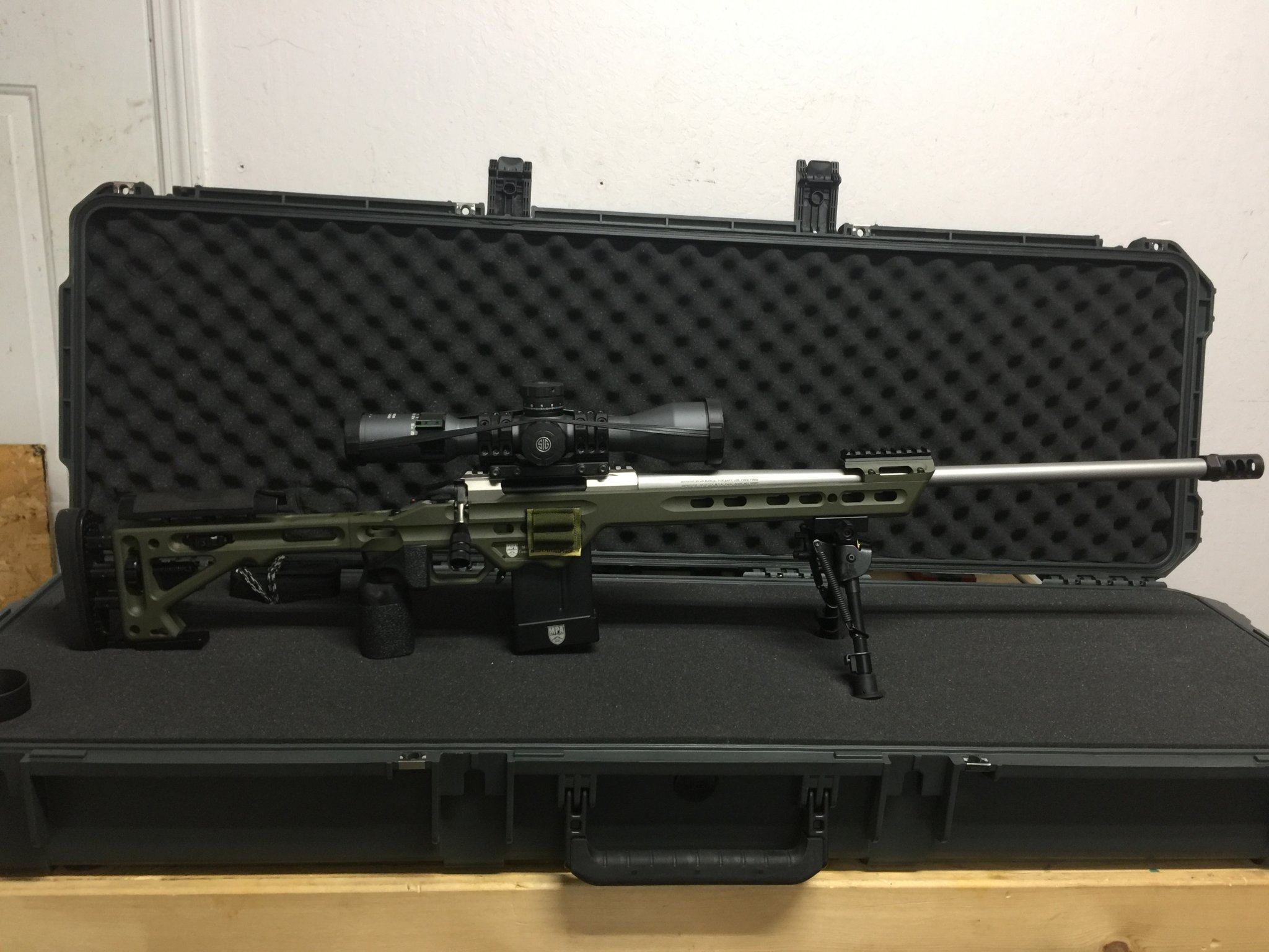

I just finished my build. Tikka CTR, MPA COMP chassis, Sig Tango Six with Spuhr Mount, and APA Little Bastard break. Am very happy with the out of the box accuracy. Doubt this will be my last Tikka.

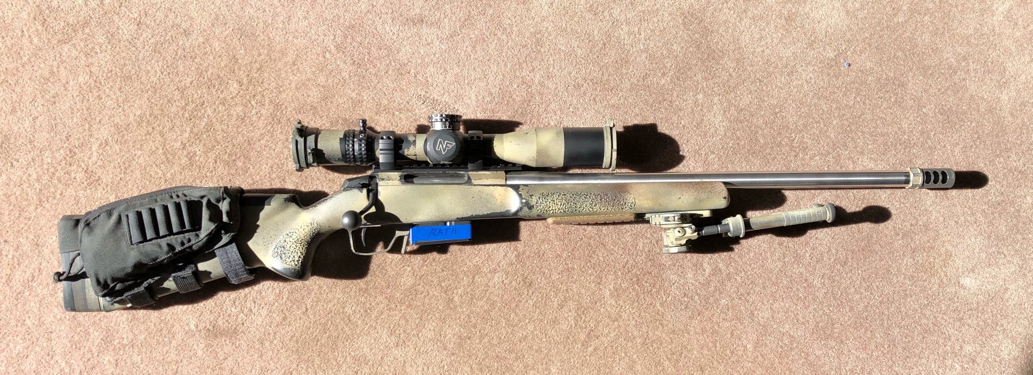

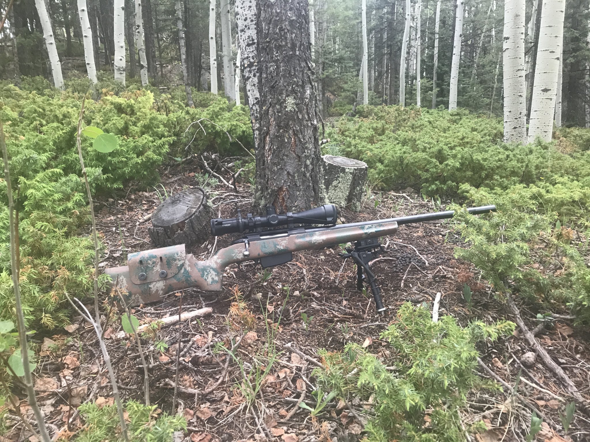

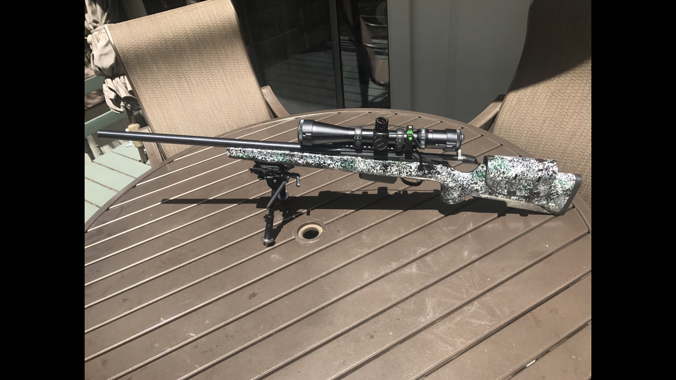

Little sponge experiment on my E-Lite stock, not really my cup of tea color wise but a friend wants the stock so … he will get it.
This stock has the Universal adapter flush mounted to take either the Spartan 300 or Javelin bipod.
edi
What does this stock weigh and where would one purchase?

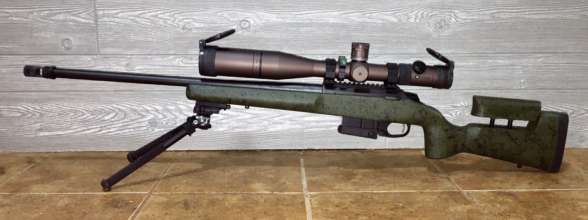

Great looking gun. Can you provide some more details on it? Sorry if you already did somewhere back in the many pages before.

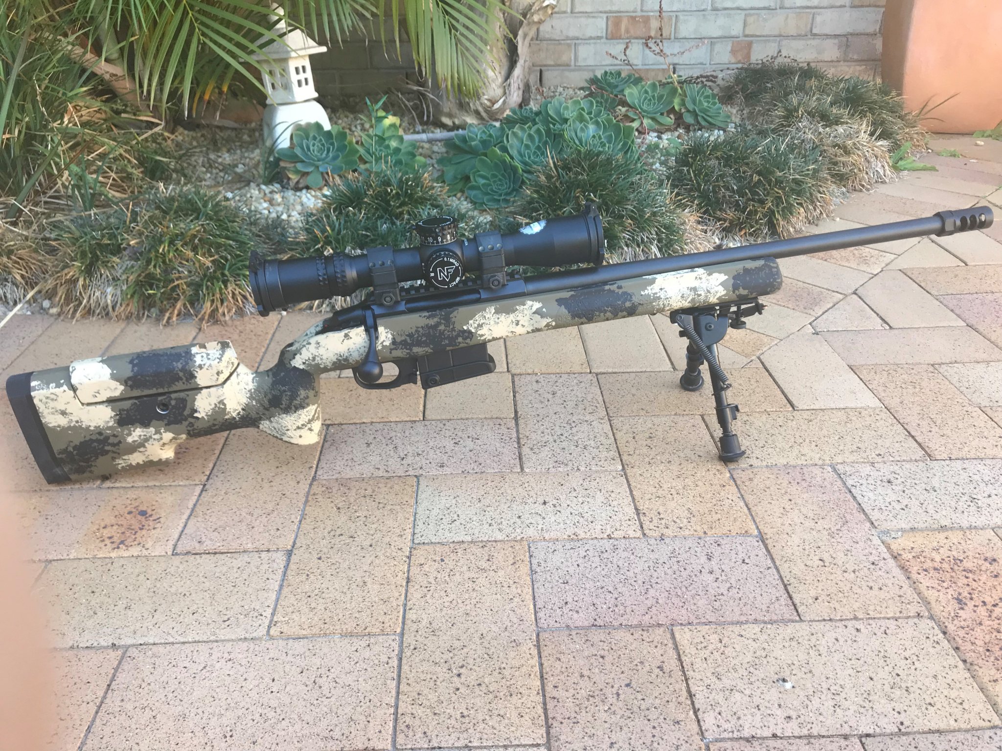

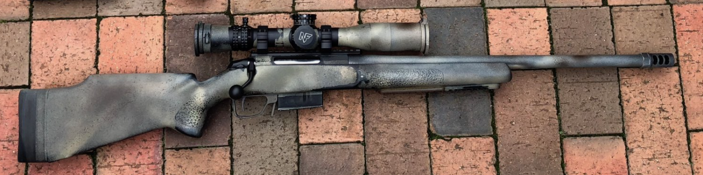

Thanks, really pleased with how this one has turned out. Began life as a 24' .308 Tikka Varmint, I cut the barrel to 17.5', then added a 22 inch 6.5x47 Hardy barrel with a APA little bastard brake. It's in a Manners T3 with CDI bottom metal.
Attached pic is First 5 rounds out of the rifle at 500m with ammo loaded for my Surgeon 6.5x47, I'm planning to find a load with 130jlk's for the Tikka, should do 2800-2850fps without trouble. Scope is a Nightforce ATACR 4-16. The entire combo is my favourite crossover comp/hunting rig, weights 12.5lb and makes for a very manageable setup. The comb to bore height with the Manners T3 means that with a stock-pack and low APA rings the cheekweld is perfect. Other additions are a Timney 2-stage and the Sterk hardware.
Honestly the upgraded Tikka option makes it very difficult to go the custom route these days.
I have a Surgeon build that I love, but it's difficult to really say that it's better than a Tikka with a few tweaks. Gave the tikka a hit of Krylon today.
Roundabout 29 Oz. Due to the cheek raiser the weight is centred further back.
At the moment available more or less everywhere except in the US. Recon the import licences to the US will be sorted very soon. Stocks are all carbon monocoque construction. Made in Ireland by PSE-Composites.
