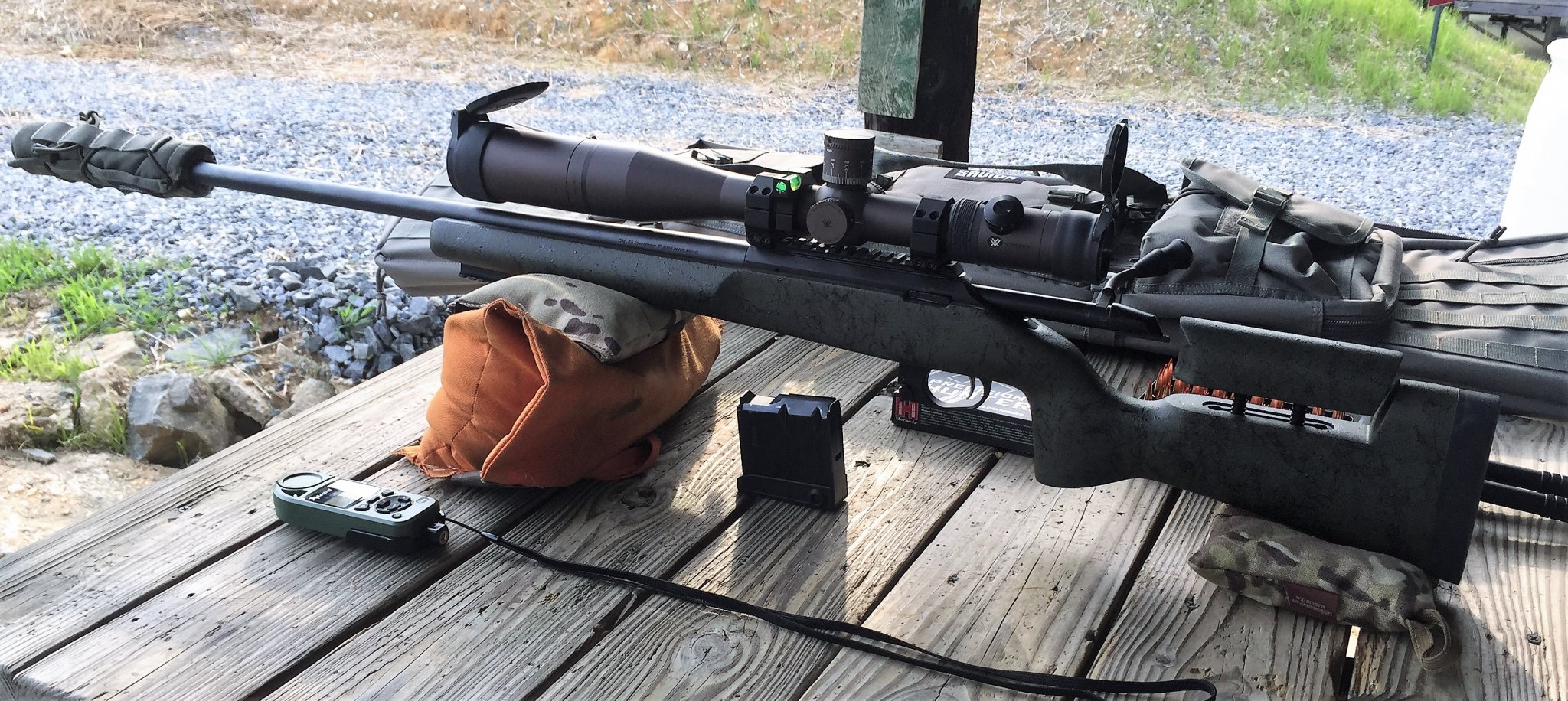

Thanks, really pleased with how this one has turned out. Began life as a 24' .308 Tikka Varmint, I cut the barrel to 17.5', then added a 22 inch 6.5x47 Hardy barrel with a APA little bastard brake. It's in a Manners T3 with CDI bottom metal.

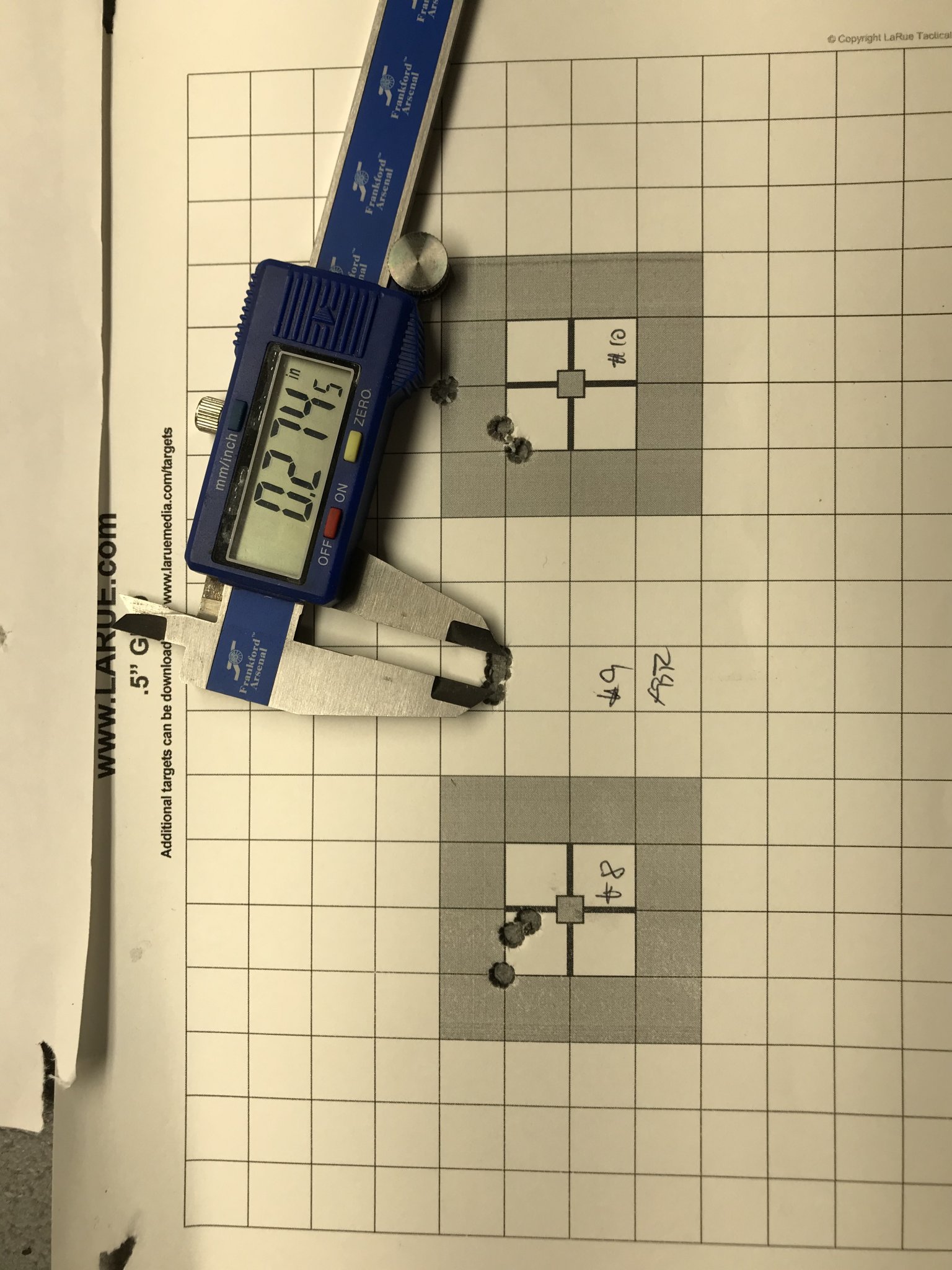

Attached pic is First 5 rounds out of the rifle at 500m with ammo loaded for my Surgeon 6.5x47, I'm planning to find a load with 130jlk's for the Tikka, should do 2800-2850fps without trouble. Scope is a Nightforce ATACR 4-16. The entire combo is my favourite crossover comp/hunting rig, weights 12.5lb and makes for a very manageable setup. The comb to bore height with the Manners T3 means that with a stock-pack and low APA rings the cheekweld is perfect. Other additions are a Timney 2-stage and the Sterk hardware.

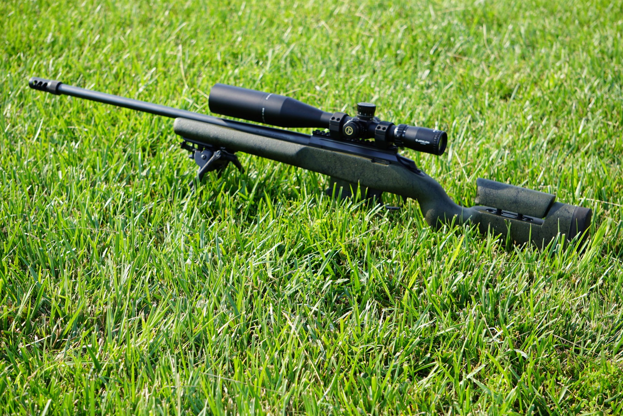

I have a Surgeon build that I love, but it's difficult to really say that it's better than a Tikka with a few tweaks. Gave the tikka a hit of Krylon today. View attachment 6909683
Thanks for the details. I have too many rifles, custom and factory, and am very happy with them, yet I'm drawn to doing a T3 build. You may be on to something...;-)

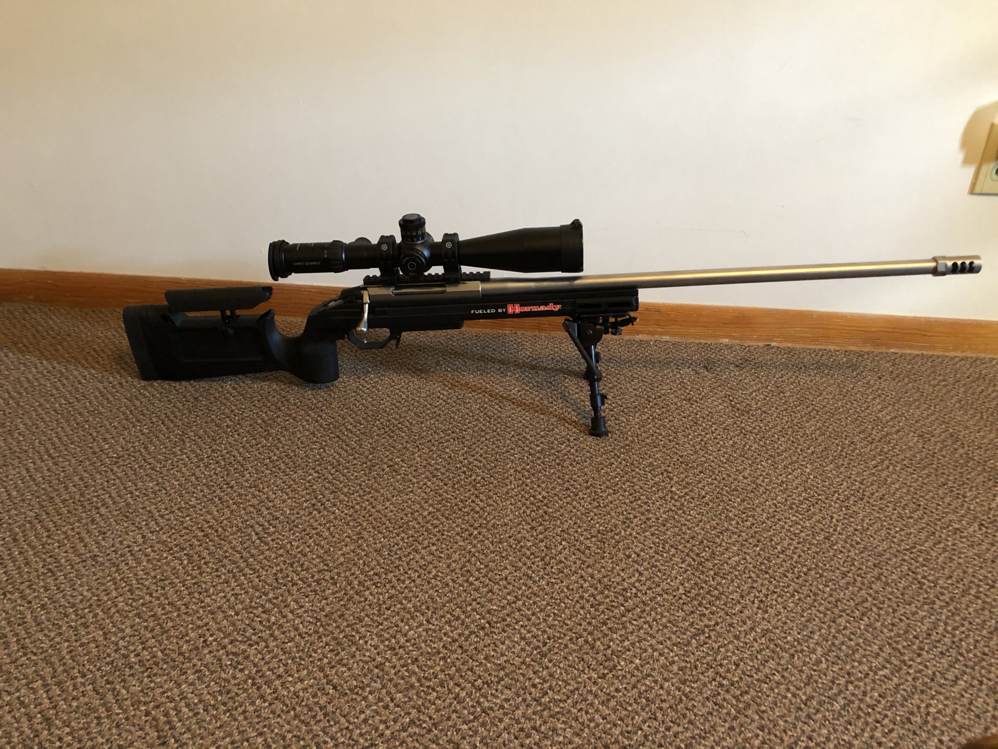

Tikka T3x CTR in KRG X-Ray
.260Rem
20" Barrel

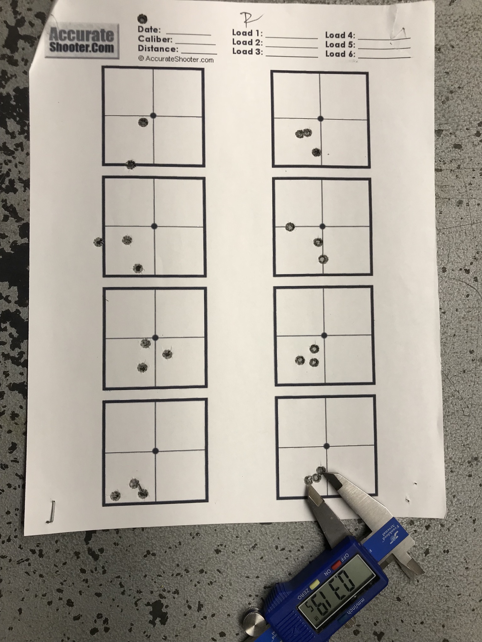

Finally had a chance to try out some loads in my 223 Varmint T3x. Shot at 100 yards, hopefully I'll stretch it out next week.
Looks like 22.7 gr IMR 8208 XBR and Nosler 80gr CC works well @ 2591 average ES 62, left @ 2585 ES 8, pulled the right @ 2605 ES 21
Bottom right is 24.1 gr Varget and Nosler 80gr CC @2642 ES 48
Top right is 24.7 CFE223 and Nosler 80gr CC @ 2621 ES 35

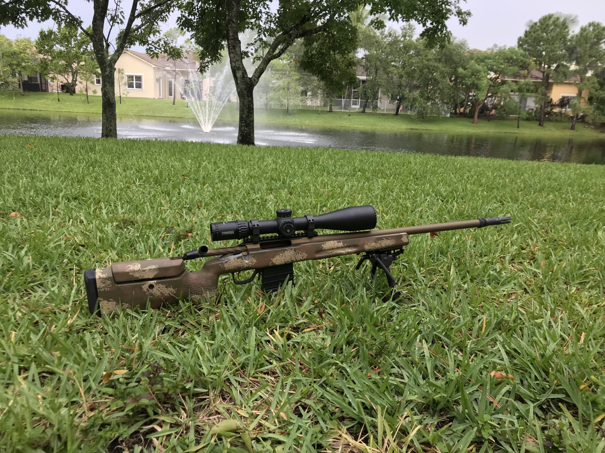

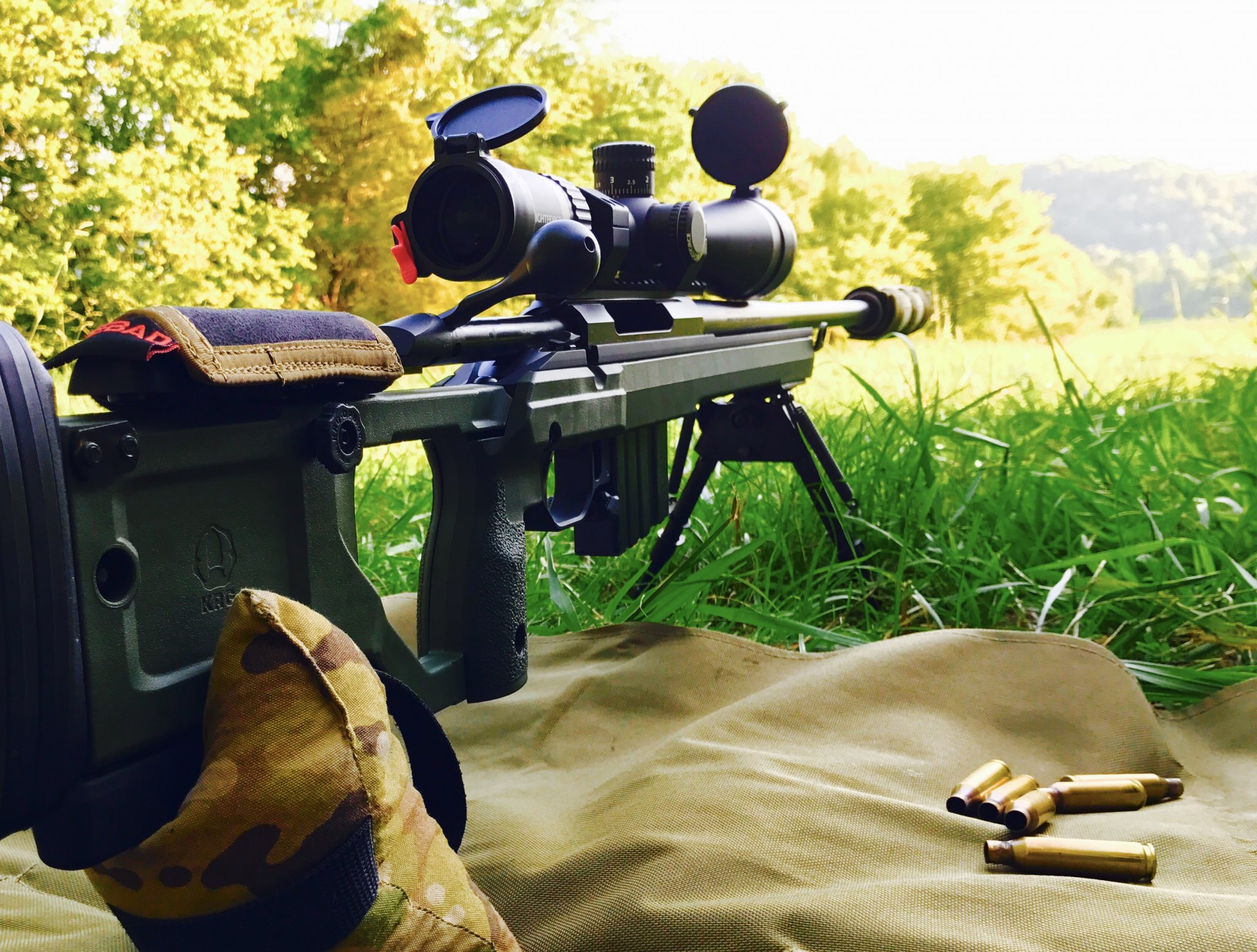

Finally have my build complete:
Tikka T3 action
Bartlein Medium Palma (Smith work done by Moon at Crescent Customs)
6.5 Creedmoor
KRG Bravo
ARC M10 rings
SB PMII w/Gen II XR
Shot 10rds Hornady Precision Hunter and was really pleased for factory ammo with the results over my V3:
Now on to load development in my Lapua brass.

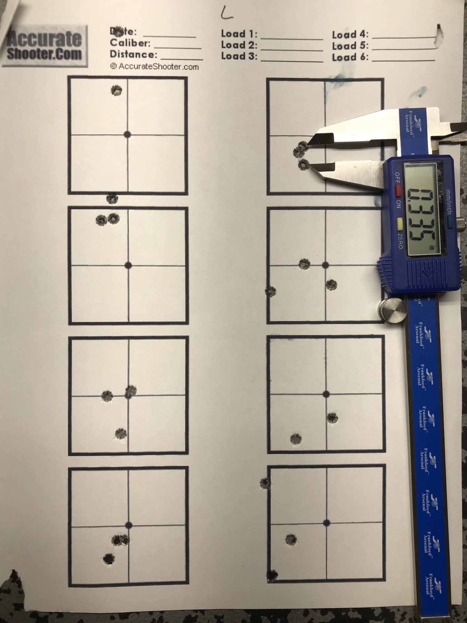

Tikkas. I love my Tikkas! Accurate, smooth bolt, but god they have slow barrels. This is what I have seen from 3 different rifles. My current is a 20” factory 6.5. ELD-M 140 ammo gave me 2585. IMR4451 with the 140’s put me at 2550. RL17 with 140’s got me 2600. H4350 and the 140’s got me to 2625 but where can you find it?

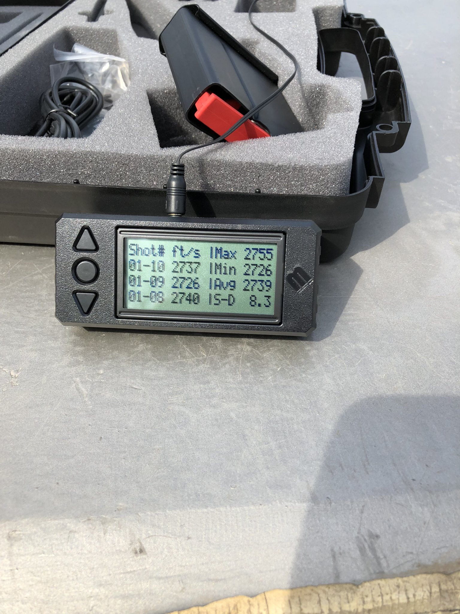

For those that reload and want more speed from their slow T3X factory 6.5 barrels, RL16 is it! Today was my second range day with the loads and testing temp stability.
I have been using RL17 for a few years and while its accurate, its terrible with temp stability. I was seeing 70-85fps swings from shooting between the seasons. Today I tested my loads again from a Magnetospeed V3. Velocity stayed the same from a 53 degree day, to 73 degrees today. RL17 would have been a good 20-25fps faster.
( typical caution alert... DON’T copy my load). With that outta the way... I settled on 42.4g in Hornady brass, 140g Hornady bthp, and cci200 primers. Nothing special about the brass. FL resized, trimmed to 1.915, chamf/deburr... done. Rounds seated 2.820.
Now, for the good stuff...
20” (take note... 20”). 2685fps. 9.2 SD over 10 rounds. Thats a full 100fps faster than I was getting with the ELD-Match ammo. Oh yeah, half MOA. Zero over pressure signs.
So, that being said... I’ll be stock up on this stuff for sure. Hope this helps someone looking for a lil boost from their T3.
