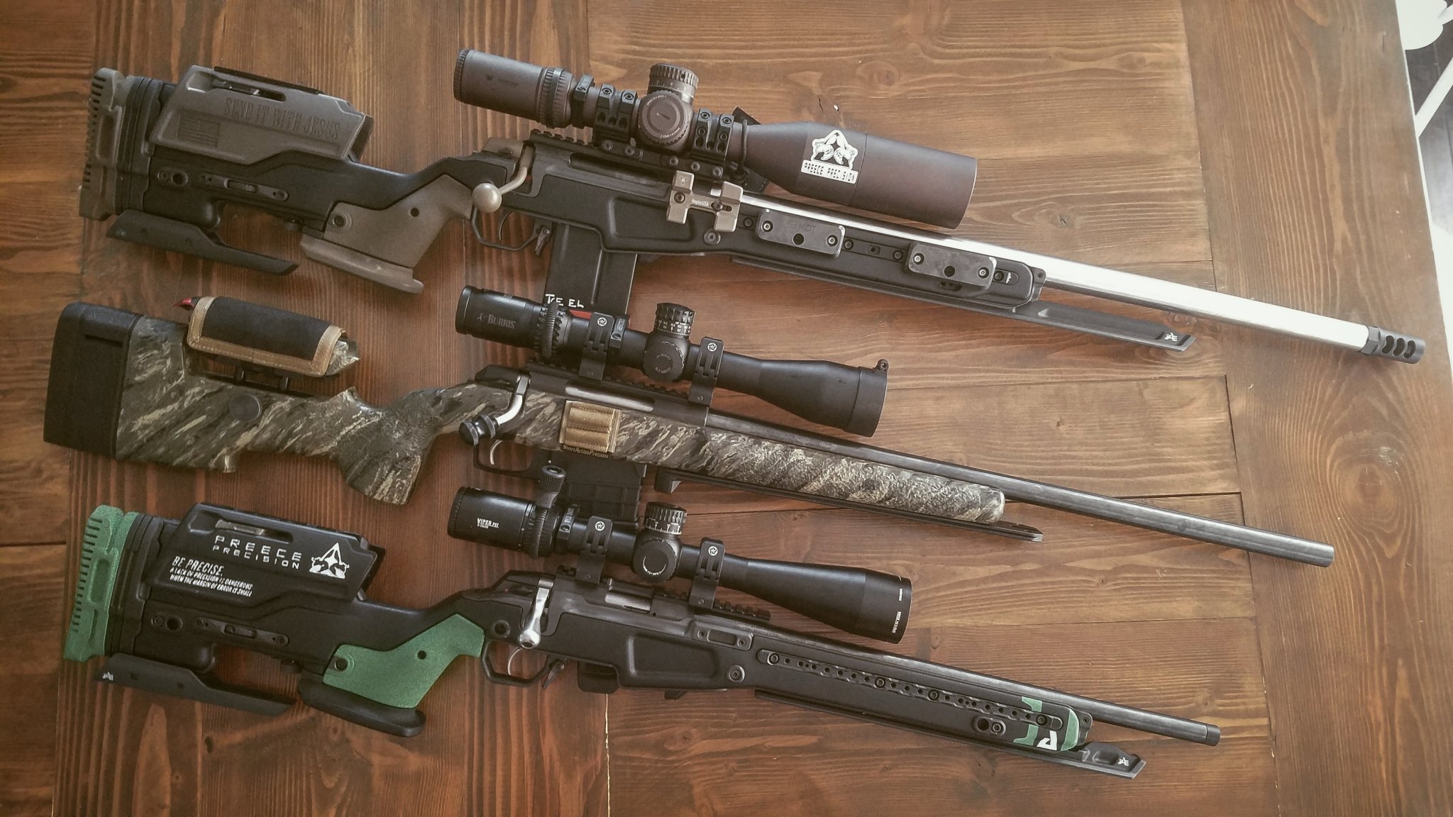

Good day for a family portrait. 6creed on top, 223 in the middle and 22LR on the bottom.

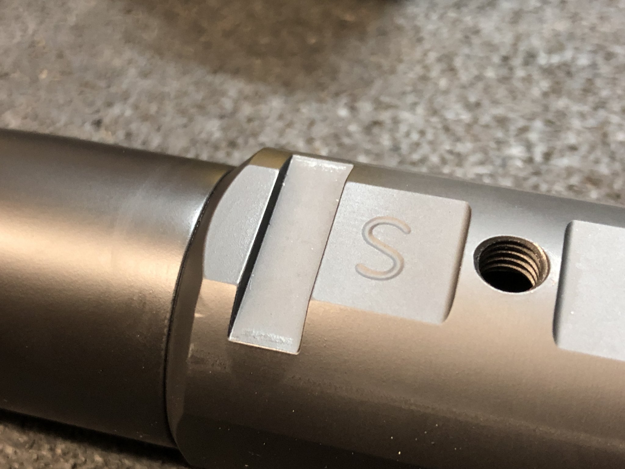

Finally "done" after pretty much a month of dicking around trying to get my factory Lite barrel off, and my new one set up. New one is a 24" SS 6.5CM McGowen, 8" twist in roughly medium Palma, but at 1.20" at the chamber instead of 1.25" to fit under the magnum Bugnut.
Ended up having 0.075" milled off the action face and the Bugnut, which came out just about dead on the diameters, and got the action done in Elite Smoke Cerakote.

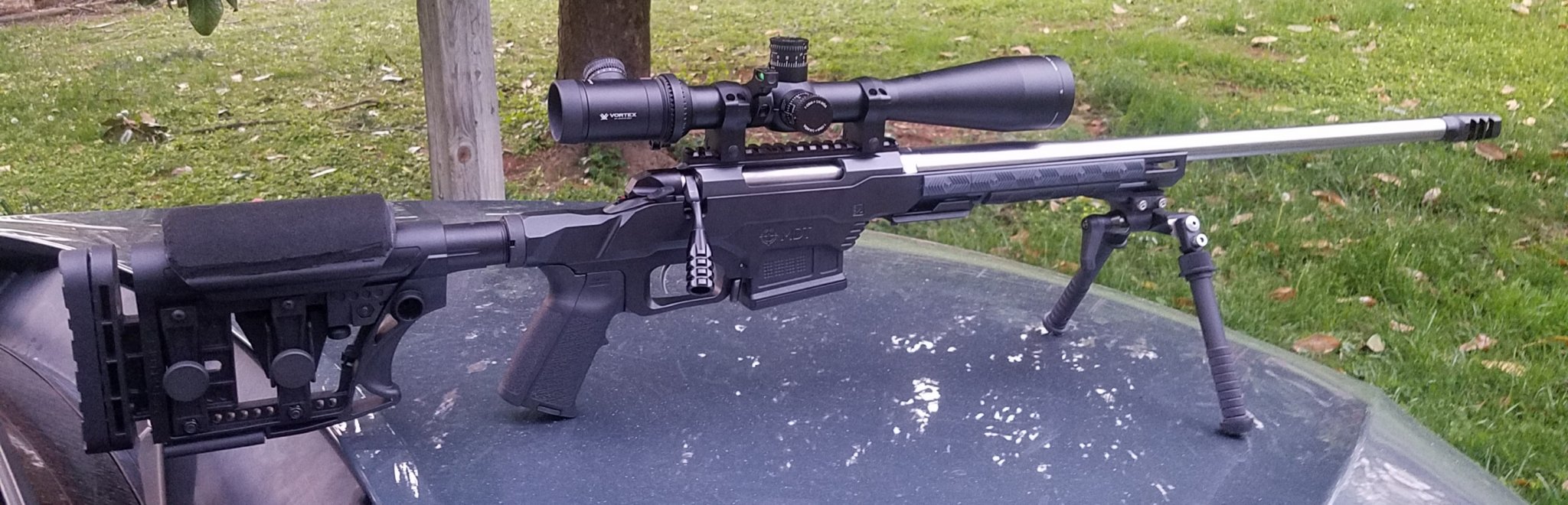

Ok so finally got my rifle together. I was all over the place on whether I wanted a CTR or a Tac A1. I knew I wanted a chassis, and I liked the A1, but decided the CTR would give me more options. So I got the CTR, and was planning to order my scope mount and a KRG Bravo or an MDT HS3, when I came across a good deal on an A1 chassis, so I picked that up. I really like the A1 chassis, and it turns out that was what I really wanted. So ordered the other supporting parts I wanted and this is what I ended up with. Had to mill out the trigger area to clear the wide KRG trigger shoe.
Tikka T3X CTR 6.5 Creedmoor 24”
Tikka Tac A1 Chassis
KRG Midas 2 Stage Trigger
EGW 20moa Tac A1 Scope Rail
American Rifle Company X-High 1.42” 30mm Rings
Weaver Tactical 3-15x50 Scope
Dead Air Muzzle Brake
BCM MLOK 3” Picatinny Rail for Bipod
B&T Atlas PSR Bipod
Current Plans:
Get a pile of ammo
Shoot as much as possible
View attachment 7068045View attachment 7068046View attachment 7068047View attachment 7068048View attachment 7068072View attachment 7068073

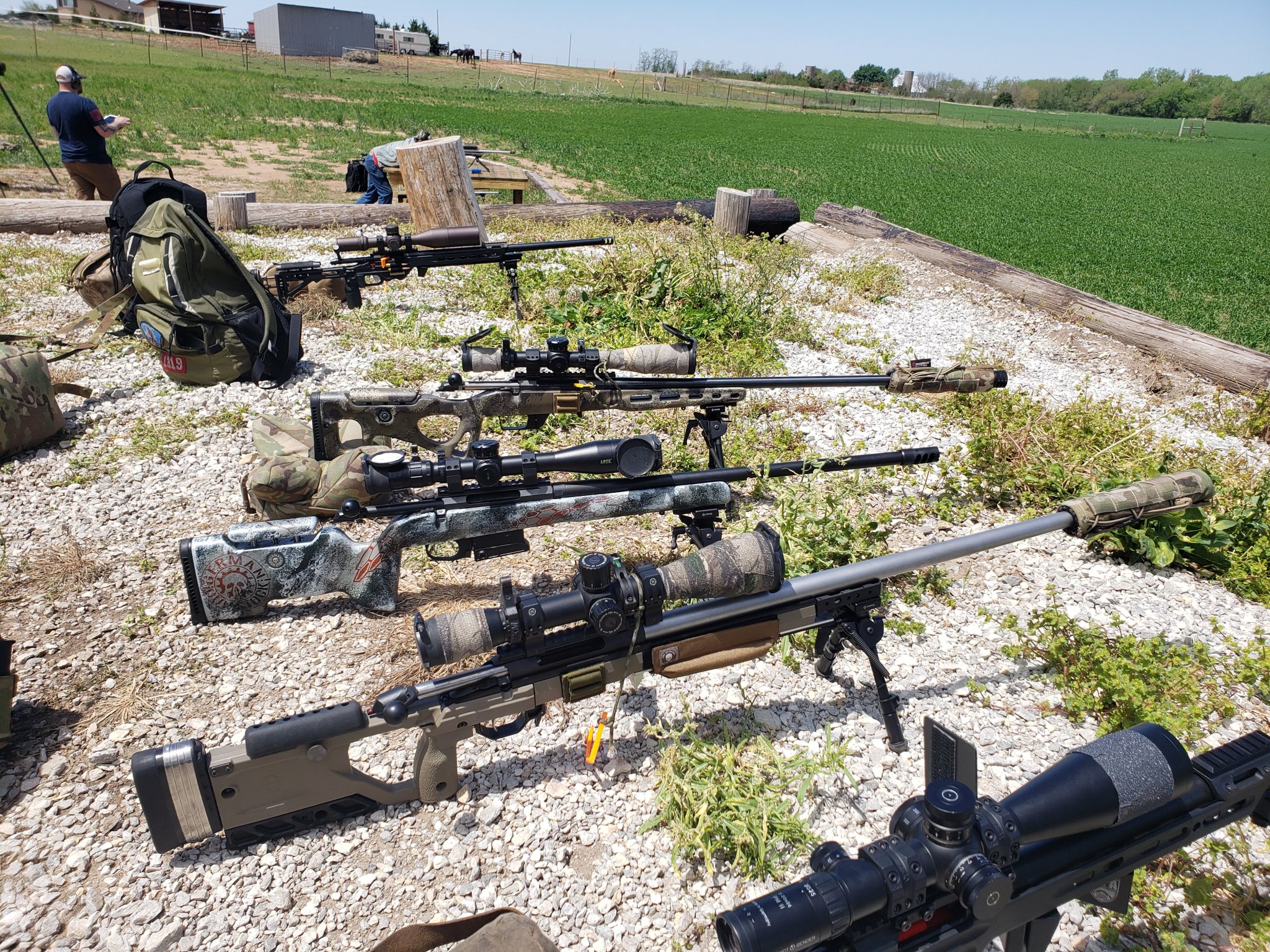

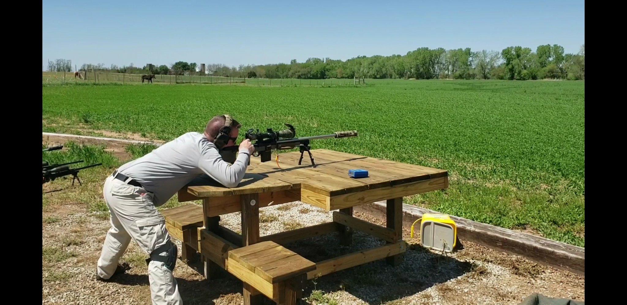

Some pictures of my 3 Tikkas at a local Pro-Am match from Saturday. My son shot my 6.5 CTR in his GGS Raptor, I loaned my 223 varmint to a new shooter, and I shot my 22BR. We had south, then west, then northwest winds from 8-24mph throughout the day. I shot like an amateur for 4 of the first 5 stages, then did good on two before I had to leave early. I overestimated the wind on most of the stages that I struggled on. I would have been better off shooting with a brake with all of the positional stages we had. My son was 10th in the Am division. He shot that rifle for the first time that morning before the shoot. I don't think I ever want to load 360 rounds for 3 different rifles in a week again.

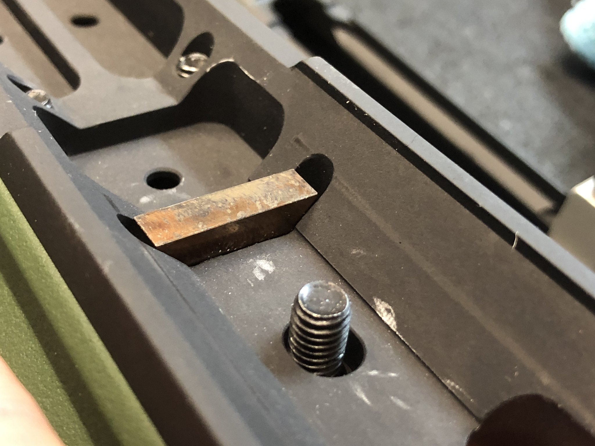

Hoping to get some advice on my Tikka.
It’s a Tikka T3 chambered in 223 with a 23” Bartlein 1:7.5 twist heavy Palma barrel, fitted by a reputable smith. Barreled action has been cerakoted and sits in a KRG Whiskey 3 Gen 6 chassis. Vortex Razor HD Gen 2 4.5-27x56 scope in Spuhr 4701 mount.
I noticed it often prints a double group. For example, fire 5 shots at 100m, puts 3 in one ragged hole and then the other two in another group (say 0.5” to 1” away), or produces one flyer. It could well be my shooting.
I also noticed that the zero moved a bit over the last couple of range sessions (one time by a few inches) which confuses me.
I suspect that it could be the scope mount, but the Spuhr seems pretty foolproof and has been torqued correctly.
My other thought was it could be how the action is installed in the chassis (I didn’t have the right size bit for my torque wrench when I installed it). Just pulled the action from the chassis. Judging from the wear on the cerakote in the recoil lug slot on the bottom of the action, the bottom of the action is actually riding on top of the recoil lug at the edges.
I believe it shouldn’t be like this - the recoil lug should only make contact on the front and rear not the top. Can someone confirm this?
(Updated to add: the action is also making contact with the V block along the sides, so it isn’t sitting really high or anything)
Here’s some photos...
And if this is indeed a problem, what’s the best way to fix it? I’m contemplating filing down the top of the KRG recoil lug a little.
I measure the recoil lug as sticking up 4.73mm from the aluminium V channel in the KRG chassis.
Would appreciate any advice.
Should be a 5mm hex bit, if your chassis is anything like my LSS-XL, you need either a medium or long bit to get at the rear screw. I bought a regular Carlyle 1/4" drive from Napa and it's just the right length- they're longer than most.
I'd start by torquing it up right... bit is like $6.
Not to point out the obvious but (My other thought was it could be how the action is installed in the chassis (I didn’t have the right size bit for my torque wrench when I installed it) thats your huge issue right there. I wouldn't do any bit of filing or monkeying around till you properly torque your action (65inlbs) into the chassis and take it back out to the range. KRG sells the correct bit you need, its like $6.

What is yoyr load/bullet combination? Are you shooting the Nosler RDF (random damn flyer)?
Good point! I will torque the action to 65 in lbs and see how that goes first. Thanks.
Using the Hornady 75gr ELD-M & AR2206H.

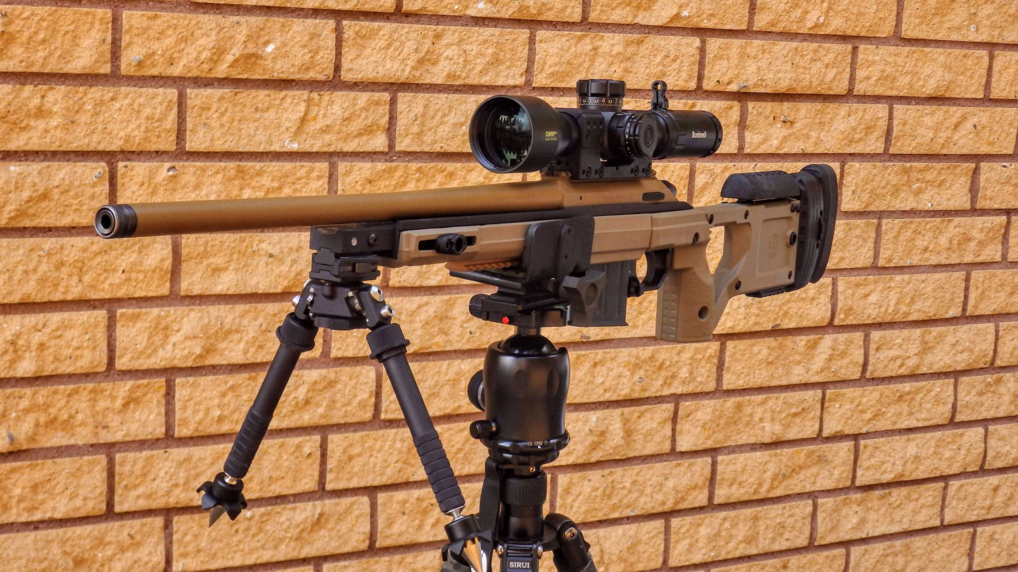

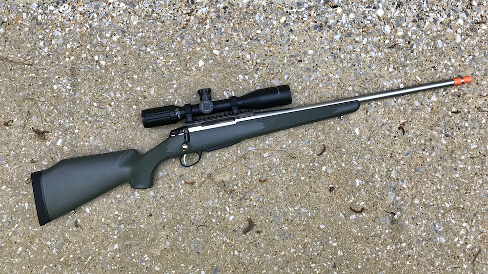

My only Tikka. T3x .243win
McMillan Sako Hunter Edge
Area419 rail
Badger rings
SWFA 6x42 mrad
Shoots cheap Federal 100gr soft points into a tiny hole. I just swapped to the 6x from a VX3i and I love the added FOV, reticle, and turrets on a hunting rifle.
