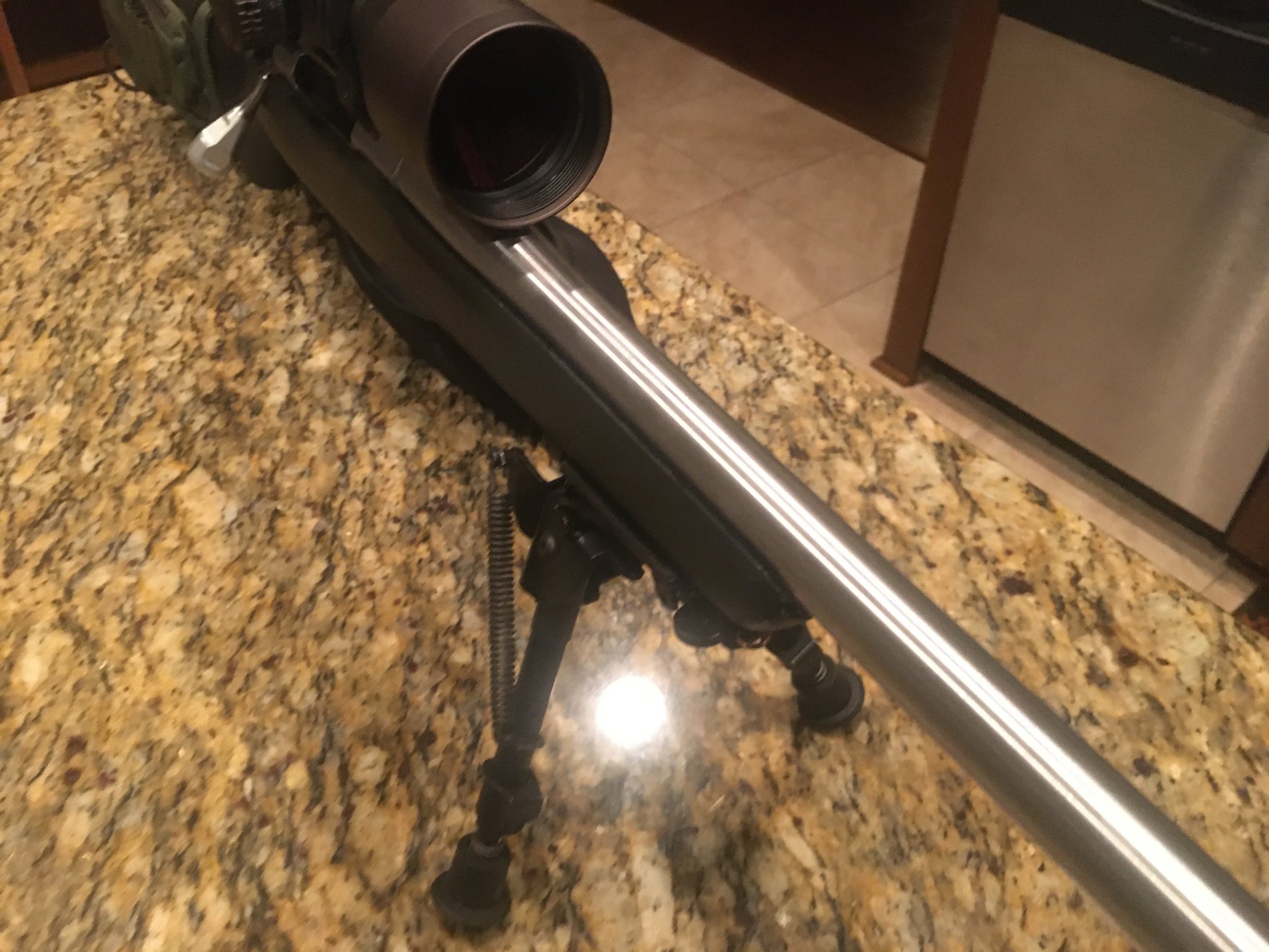

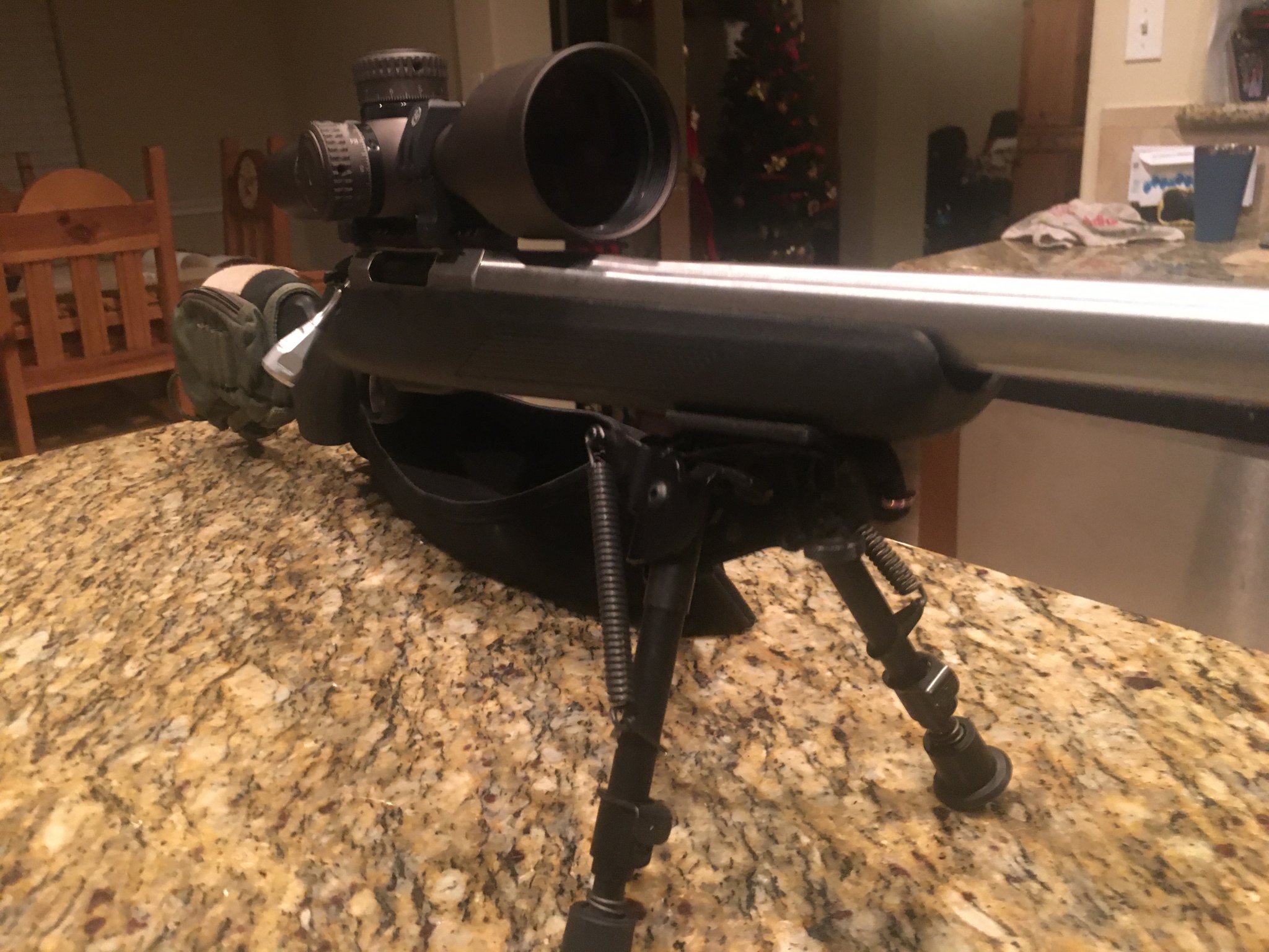

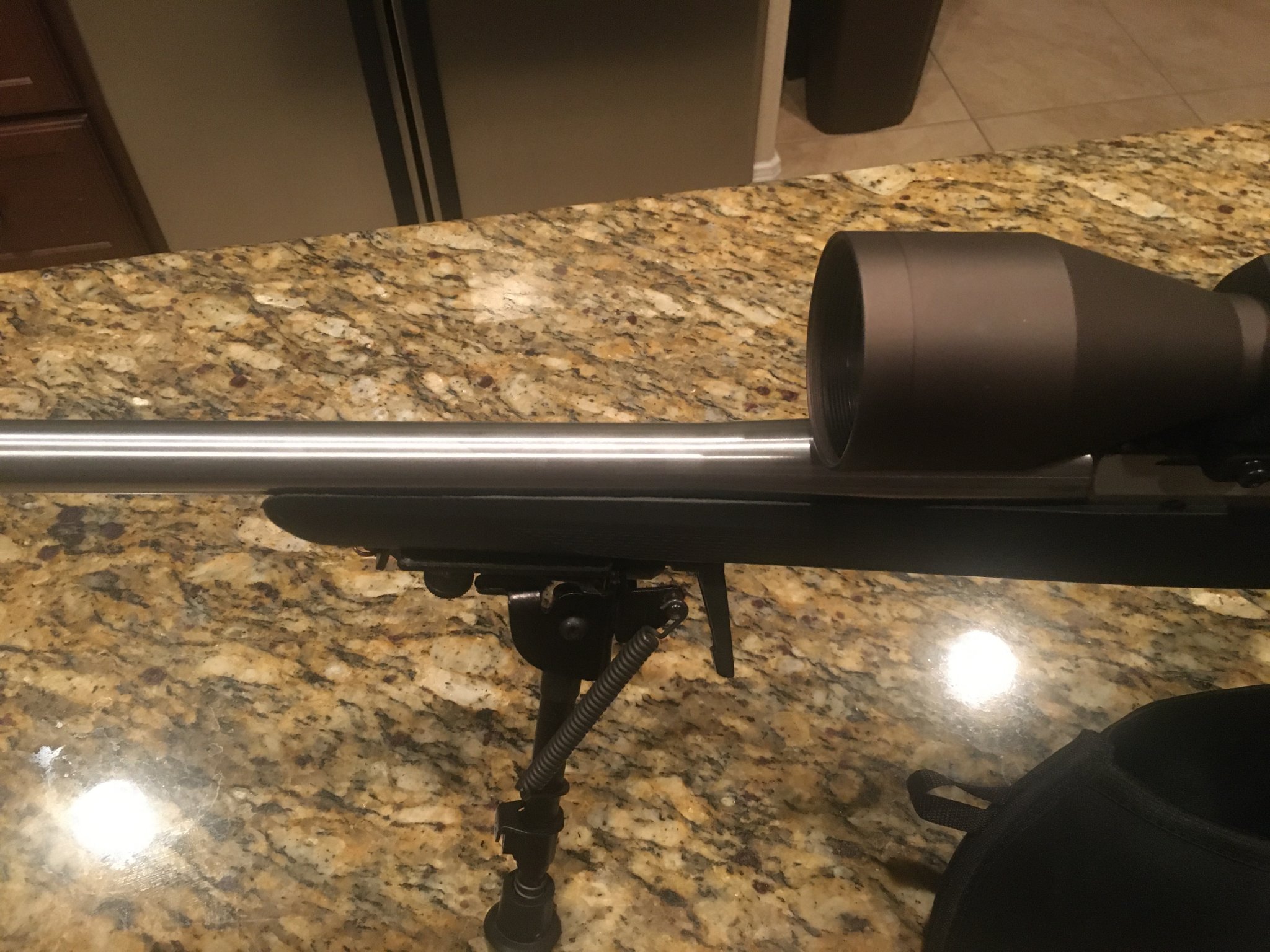

I just opened up my t3x lite stock to accept a medium palma which is about the same as the Rem Varmint contour. The Tikka stocks are much better than the plastic remington and savage crap. Plenty stiff enough for these contours. I wouldn’t go bigger than that anyhow or your rifle will be a pig. I can shoot off a bipod without the barrel touching the stock. I just took a dremel to it. I didnt take the time to sand it perfectly smooth. Didnit for function. Yes it has a little too much scope on it. I need to switch it out And havent done it yet.
View attachment 7213898View attachment 7213899View attachment 7213900
Looks awesome, which barrel did you go with?
Sendero contour worked good for me,not too heavy and gave me good balance
It fit the original stock fine? I just put. a brake on my .300 and it groups really right just heats up so damn fast.
how’s the accuracy?
If this one is for me, the accuracy is what you would expect for a high quality aftermarket barrel. Shoots Prime 130gr and Hornady 147 into tiny clusters. I have only shot one group with each. No sense in wasting ammo on group shooting.
