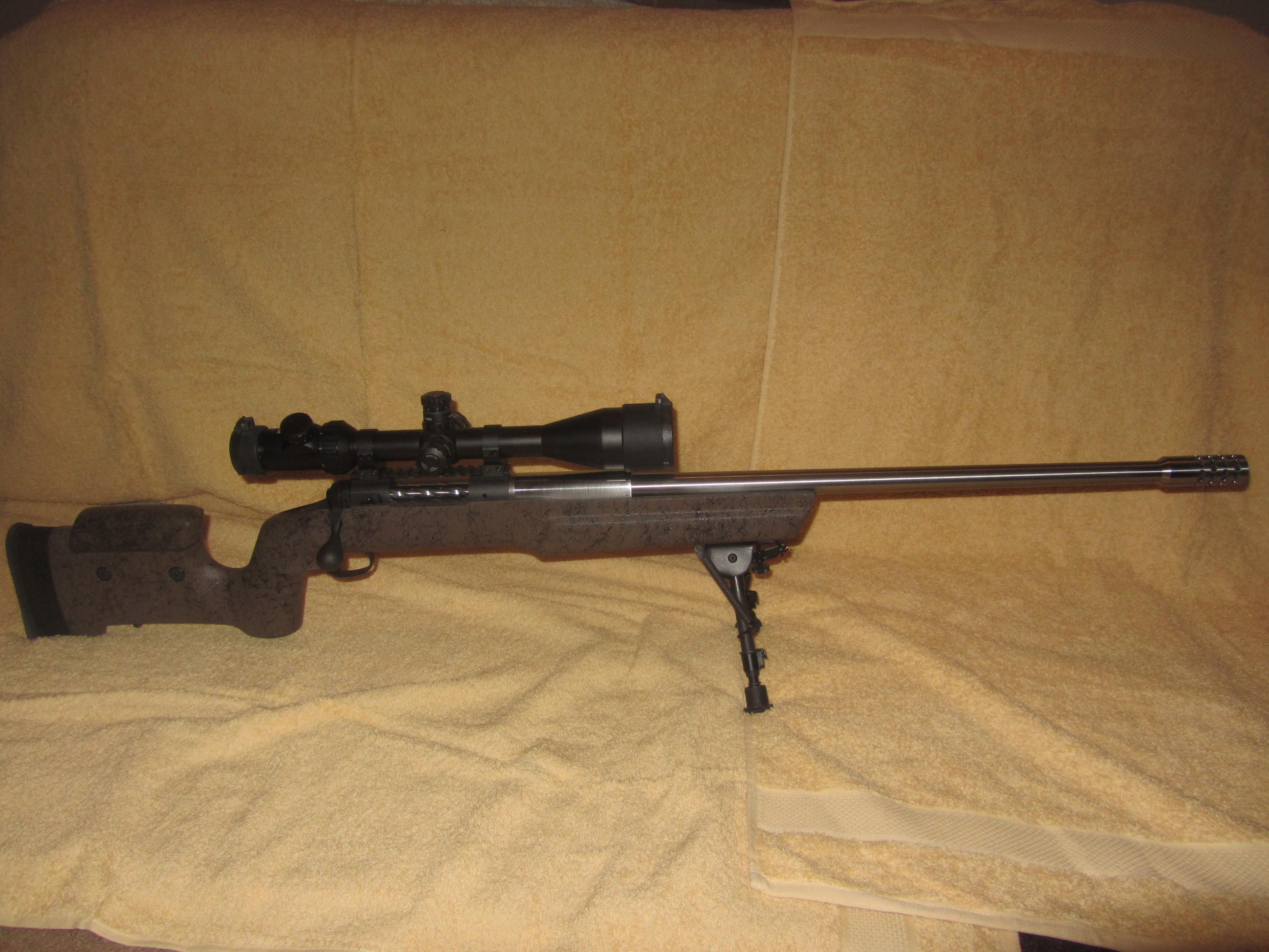

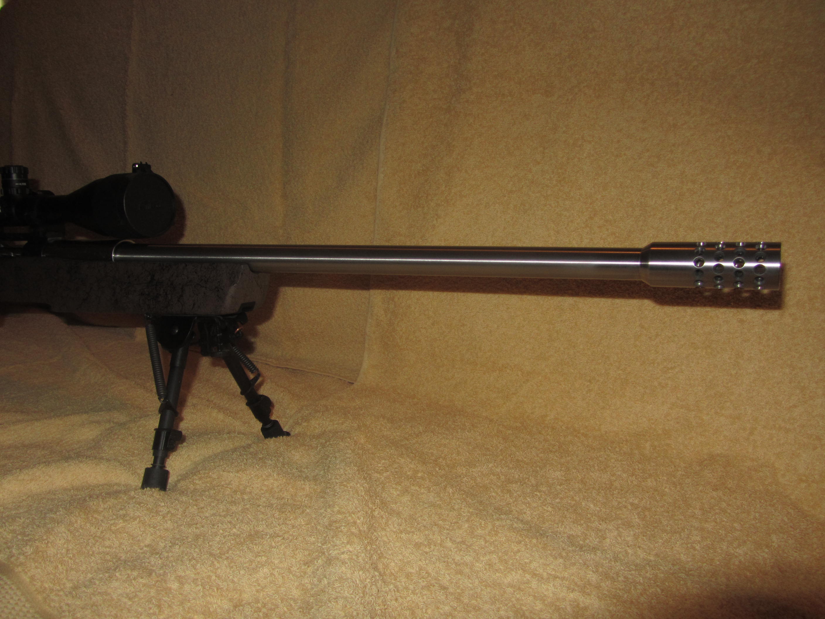

Here is what I ended up with when I figured out I had too many spare parts laying around. I figured out I had enough stuff to put together a rifle, and here it is.
Savage 10 action picked up in a trade that sat around for 5+ yrs.
Shilen 6.5 barrel
B&C stock that had been worked on and ruined by previous owner with a dremel.
Egw steel 20 moa 1piece base
some parts from a rifle basix trigger kit
ptg bolt head and body
barrowed 6.5X47 lapua reamers
scope is millet in pics but switched for vortex viper 6-24
17-4 stainless/ aluminum material

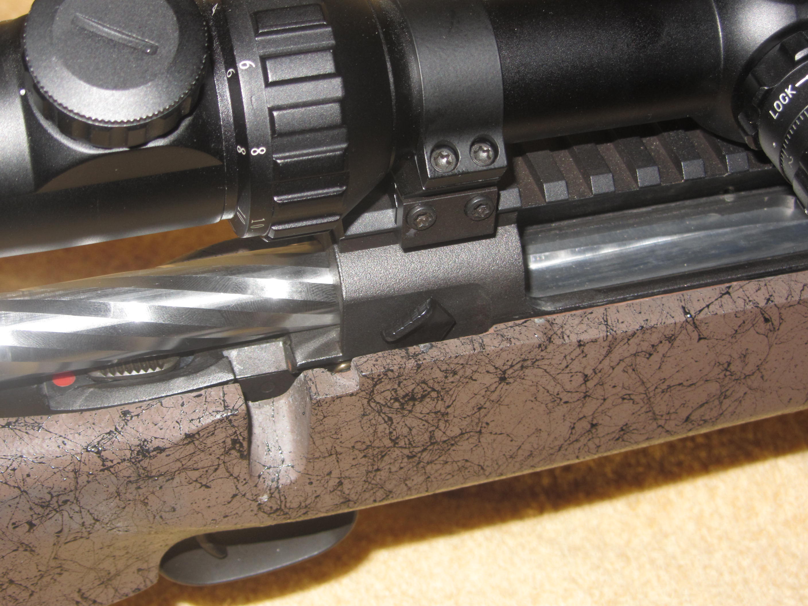

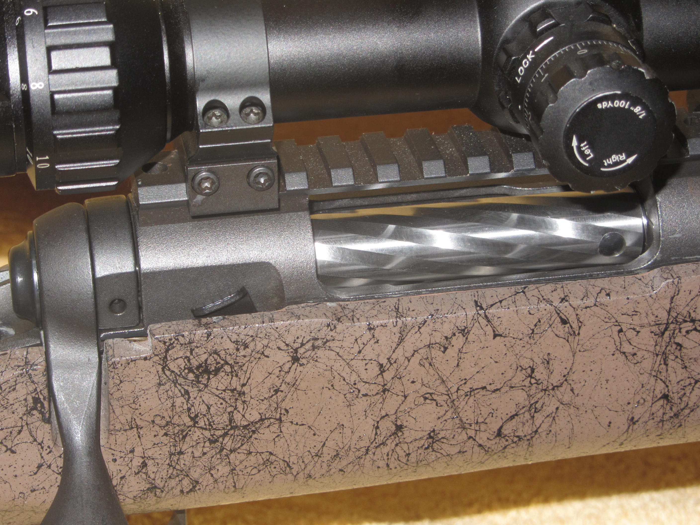

Where is the aluminum incorporated?
I made it a single shot, and made a bottom piece to match the receiver bottom. You can see it in the 5th picture. it matches the bottom of receiver radius on the outside and is cut for a tight fit to inside where the mag would sit. cut a tapered radius bottom so cartridge slides right into chamber and minimum bolt clearance. More bedding surface is the idea

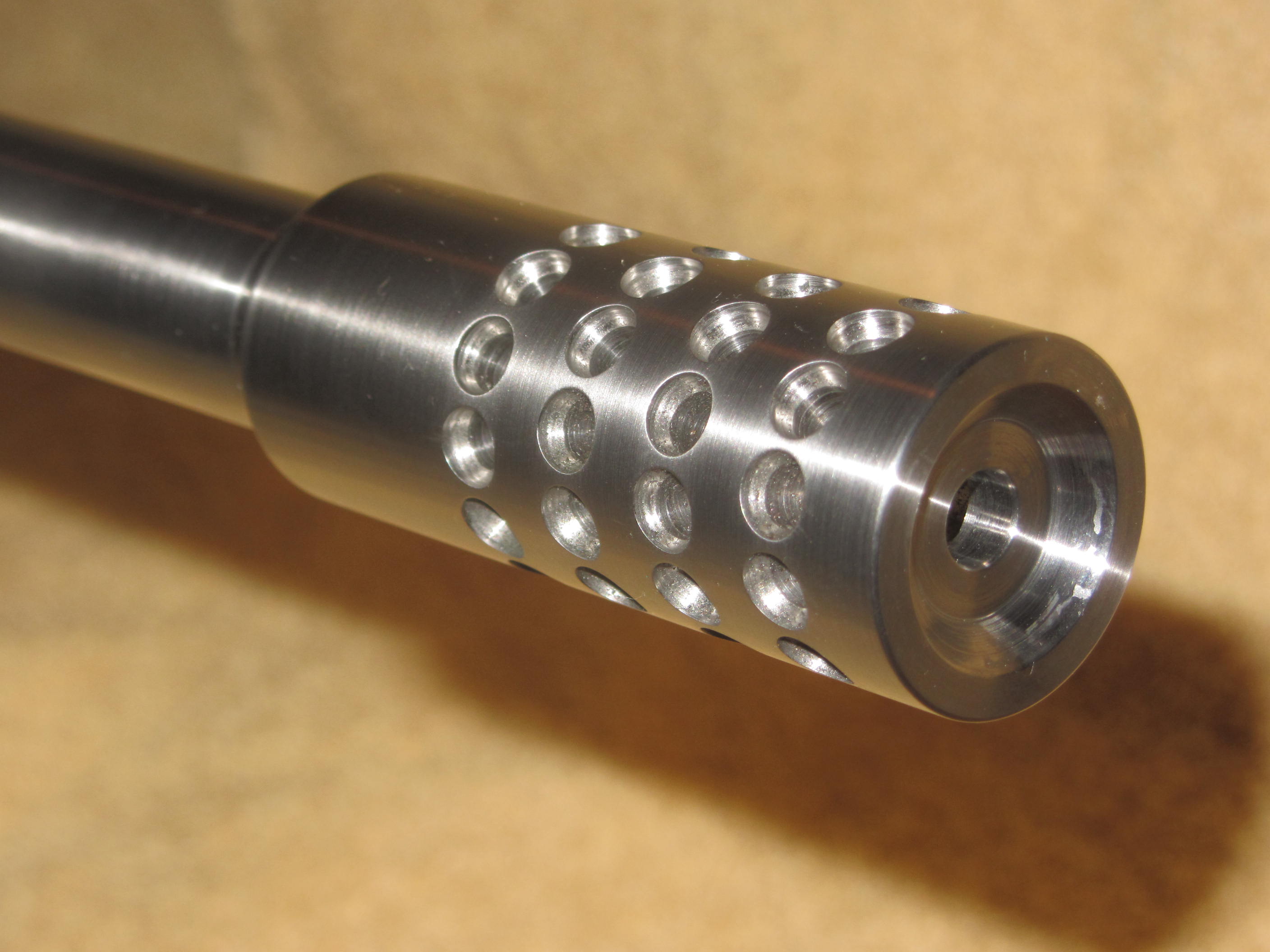

Whats up with that barrel nut? That things long enough to look like a barrel block..
I'm surprised your the first to notice that, it is not a barrel block. It is a barrel nut that I made of my own design, it is sort of like a miniature free float tube for an AR and only touches barrel where it is threaded. It has clearance all around barrel from the threads out and made to a specific length.
Specific length? Top secret? Will you share?
Adds stability like having a longer action?
Yes it adds stability to the action when hanging a barrel from it. The length is determined by the balance point of the action and barrel together. The barrel is still completely free floated but the bedding goes to end of this barrel nut adding about 6in. on this particular one. It basically gives you about 14in of bedding surface and absolute zero tension or stress on the action. I have done this on several rifles and it seems to work quite well. if it is done correctly you should be able to remove your action screws and the action sits in stock without tilting or moving, the barrel doesn't lay down into the barrel channel. This is a true stress free design, and the only way to accomplish this and still have a fully free floating barrel. :)
