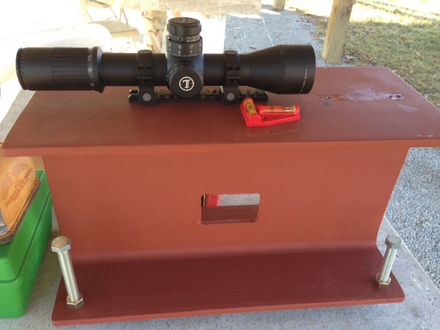

    Wasnt Killswitches test rig just a piece of railroad tie with a picatinny rail attached to it or something? I would just find a large heavy object that would resist movement and tap it for a rail (or just glue one to it) and then throw your ringed scope on it.
    Edit: it was I beam but also tapped for adjustable feet, that would allow you to dial out any of the slightly off initial error. [IMG2=JSON]{"data-align":"none","data-size":"full","src":"http:\/\/i626.photobucket.com\/albums\/tt345\/ddearinger\/D892995D-1341-4066-BE9A-081C45D61E04.jpg"}[/IMG2]

    Here's the original....way back in 2013. The hole in the middle is for running a ratchet strap thru and securing it to a shooting bench.
