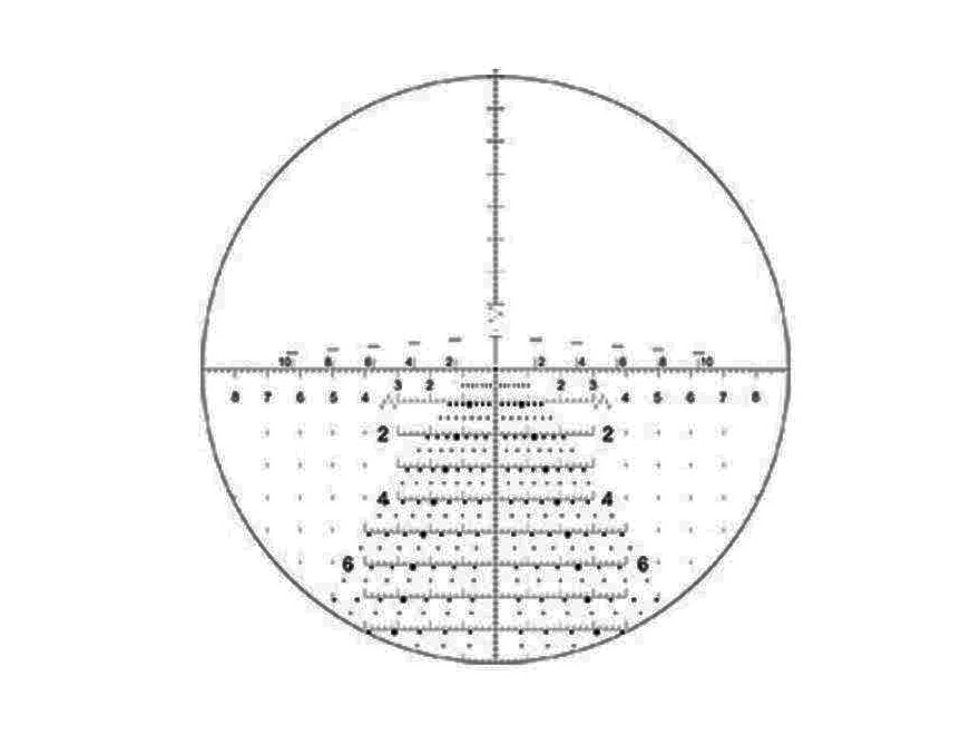

I love my Horus reticles but mostly the T3. Can it be improved? Probably. Everything typically can be.
Dang it, I just ordered a T3 S&B. Oh well, I'll learn it and see if I can get something out of it. If not, sell it and move on.
You will love it. Simple to use and watch the wind dot video. You’ll find that everyone is using Christmas tree reticles and that’s all Horus is. You zoom in and it’s no busier than anything else. The wind dots are handy and it’s easy to range with it.

I find the reticle useful on generous sized targets. I dont use hold over or wind dots past 3 mils (600 yards with my 6 creed) and like i said, that's on generous sized targets. So with that said, I hardly use the reticle at all as it is intended to be used. I find myself dialing elevation and holding wind and use reticle to spot misses or getting a better idea what my wind hold should be.

Does Horus work? certainly. It is a mrad-grid and we can all make it work. However, it is not for everyone.

I finally got a day here in Texas Panhandle that I had time to shoot and the wind wasnt blowing 20+
Wind was 3 o clock 4-6mph Targets 6'' square at 500 and a 12'' diamond at 704 yards.
I ran these targets shooting one shot at 500, one at 704, one back at 500 and one back at 704 holding appropriate elevation and my first wind dot.
I ran this drill 3 times clean. Each time I go out with the TReMoR 3 I am getting more comfortable and confident with the reticle/system.
I'm no where near ready to say I'm going to change reticles in my hunting scope's to the TReMoR but im really starting to like it shooting steel.

The Tremor3 I think has useful application for PRS matches where you need to engage targets on the clock, since it's less data to remember for holdovers (wind speed instead of different wind holds for every target) and it gives you more time to build a stable position and take your shot (holding instead of dialing).
That said, it definitely takes time to get used to so that you can avoid being lost in the tree. I've run into issues in the past where I held the wrong wind value for the target I was shooting because I had a dozen wind holds written on my data card (a high and low value for each target, some stages have 6 targets). This is also arguably an issue with training, but IMO it's easier to remember 2 wind speeds that apply to every target than it is to look up the high and low wind holds before shooting each target.
In terms of benchrest or F-class shooting the reticle is way too busy. If you have plenty of time to dial your elevation the reticle is too busy (wind dots start to obstruct your vision). It's simply meant for engaging multiple targets at different distances with a time limit that makes dialing elevation a potential concern, or for engaging mover targets once you have calibrated the mover markings on the main horizontal line. Any use outside of that it will be a compromise over other tree reticles that aren't as busy.
The reticle shouldnt be that controversial, its a christmas tree with time of flight dots to aid a shooter by skipping quick wind formula math. I think a lot of it is the personalities involved in the same way Larue product can be controversial because of mark.
