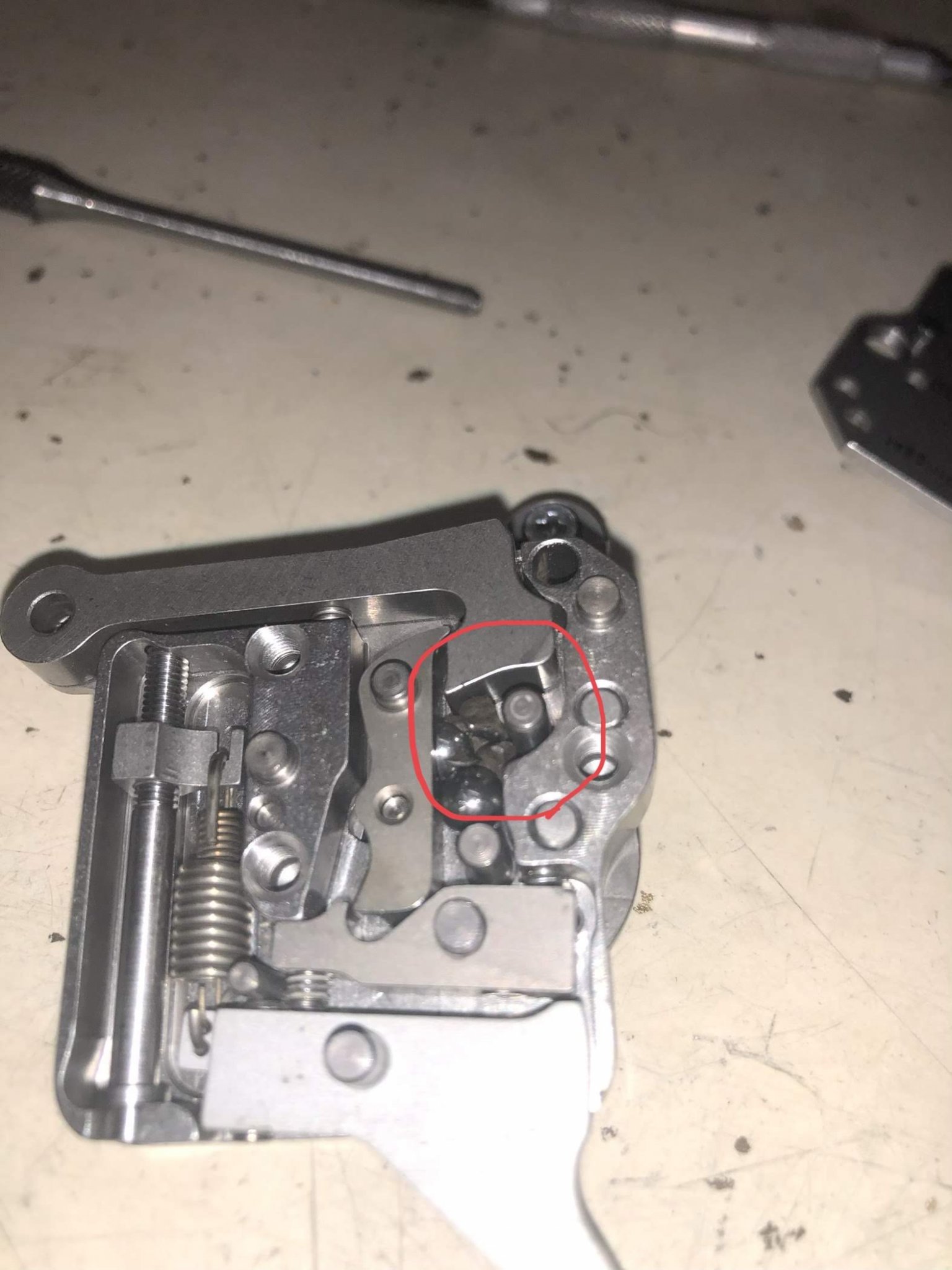

there is not a trigger made that won’t go down if enough crap gets in it...for me the Calvin elite was the worst the jewel second and the BnA only one time I had issues with it...I havenot shot the TT long enough to say but I can say we shot 3 strings of a match last Saturday in 20mph winds at start and 35+ when the MD shut it down and no issues with the TT.
I would have to say that the Geisselle super 700 is worth a solid look. I had MikeR@tacops put one on my Delta 51 and it definitely does not fail to impress but that is just my experience. YMMV.

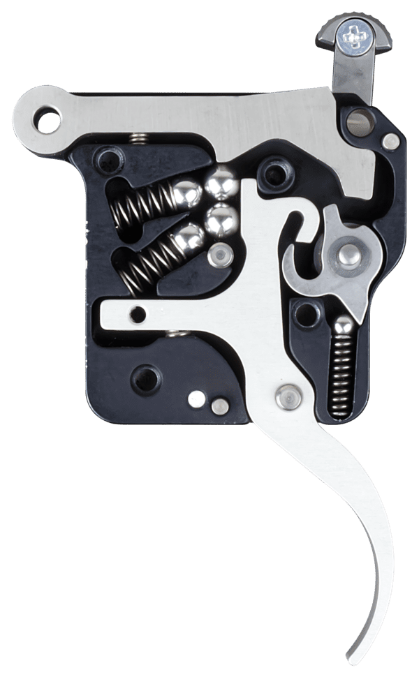

I don't know that TTs have anywhere for dirt to get it. I think they're sealed.
I'll pull one out and really dissect it.
you dont need to pull anything out....look at the bottom where the shoe goes into the body...or how about the top of the trigger at the sear....
This is right off their site, so take it for the marketing that it is, but, I've never heard of one going down from dust/dirt.
"Even when intentionally contaminated with the harshest materials, Frictionless Release Technology™ and TKR Technology™ work together to keep your gun running with incredibly crisp trigger breaks."

Simple answer: NO They are not! The only trigger I have not seen go down in matches in desert Arizona, Utah, Colorado, and Nevada, and not only do they not go down but they don't require lubing and constant maintenance.
Had a tac sport pro 2 stage go down on me 2 different times. They were great on replacing/repairing, but never would answer about what went wrong.
I live in northern Nevada...we have the fine powdery alkali dust here as you probably know so if this trigger goes a summer without going down I’ll be a believer.
I had gnats make a Calvin elite go down...twice in one day.

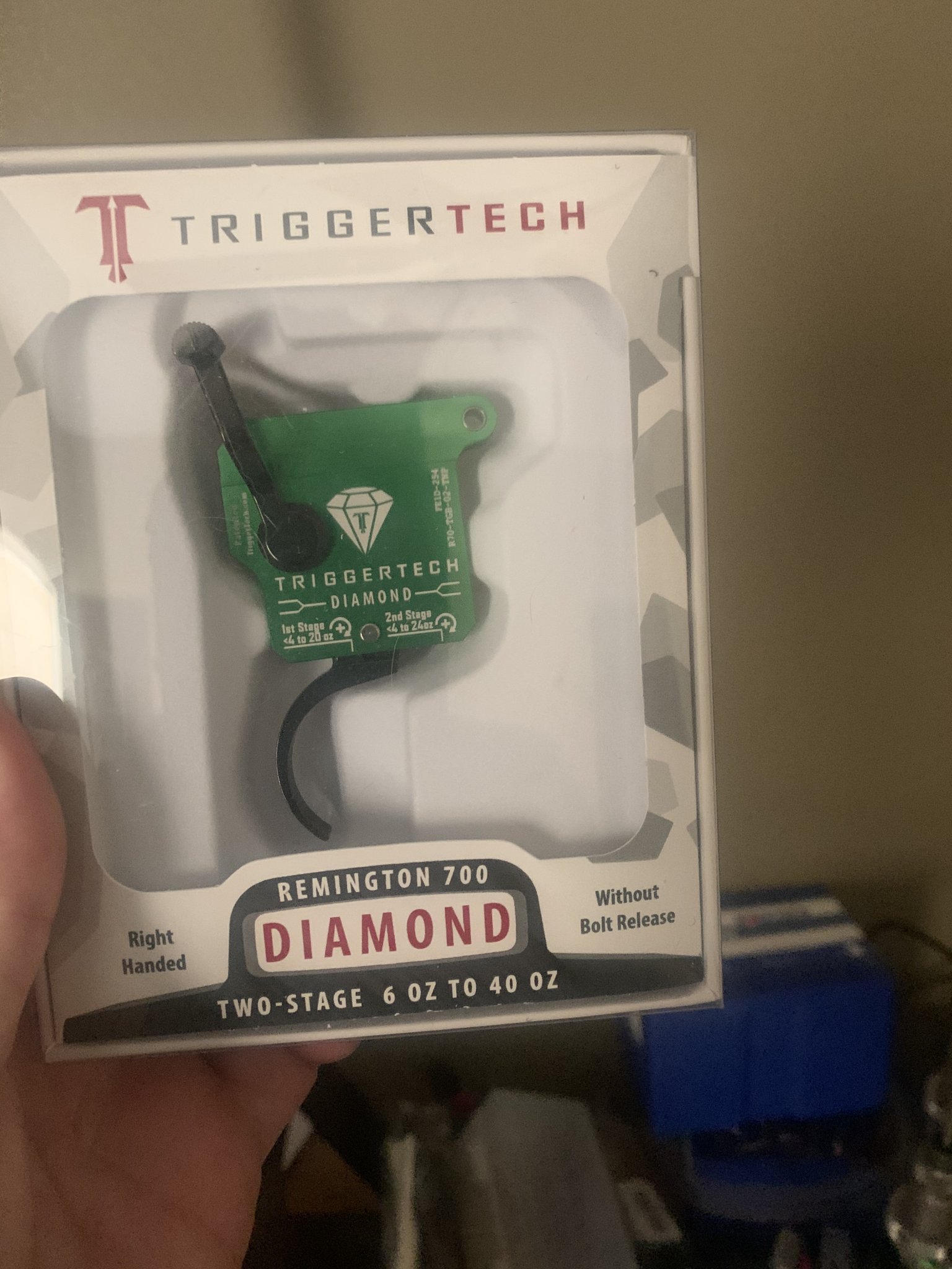

Supposedly the large orders will be shipping pretty soon. Was only allowed to order one trigger per dealer to be shipped immediately for a couple weeks.
real curious to here your thoughts....i went with the single stage diamond and am happy enough that i doubt ill be changing back to a 2 stage

Been messing with it for a bit now. My shitty trigger gauge says I have total pull around 8oz. I’d never run my single this low as I don’t want to develop a slap being so light.
This doesn’t feel like 8oz would on my single since you have the second stage.
I think this two stage will help a lot of people running light triggers than tend to slap them. And it might convince me to run an 8oz trigger at matches.
The only downside is the distance of travel on first stage. It’s fairly short. I prefer the longer stage of something like an AI. But it’s not enough that I hate the trigger.
I’ll drop it in my vudoo this week and try to put several hundred rounds through it without breaking the bank.
Initial impressions: if you like a light trigger but find yourself a bit timid about marrying your finger to it, this helps a ton with it.

Could you do me a favor? Could you test how low the first stage can be set? I am wondering how closely it can replicate the feel of the AR Diamond. The initial stage on that is only about 2oz, if I remember correctly.
Sounds like it's probably modeled after the AR Diamond, which is a 2 stage that feels more 1911-like. (very short & light first stage)
It can definitely go down sub 4oz.
My shorty gauge only measures about 8oz with markings. It was taking up first stage and breaking at about 8oz total.
Im going to stick to using my TT Diamond Flats set at 4oz till the Hide members start giving feedback.
Reactions: 47guy
Messed with it some more. I think I found a setting I like a lot.
1lb first and 1/2lb second.
When you go sub 1 on first stage, the take up (to me) feels too soft/slack. 1lb gives it a very solid feeling and with a 1/2lb second, I get the benefits of a light trigger without the sensitivity that can develop a trigger slap.
Reactions: BCX and Chargerguy
Also, with my lone peak, 8oz total pull (not sure 1st/2nd break down) was not drop safe with safety off.
1.5 (1 and .5) is drop safe without safety engaged.
