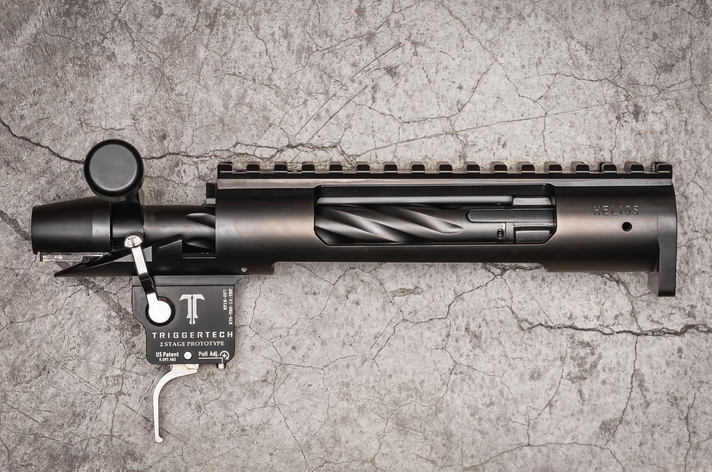

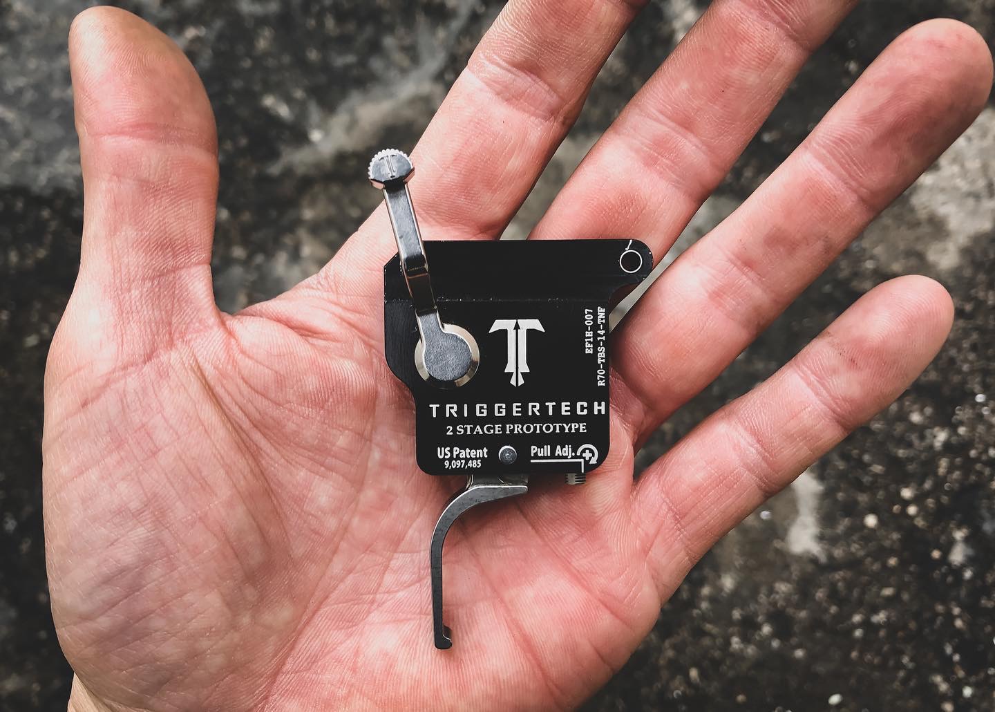

I’ve been messing with one. I’m not sure what will be different on the production version.
I wrote a blog post on the prototype. I used it on my 28 Nosler LR Hunting rifle. I don’t have experience with a Bix’n & Andy or Huber for comparison. When I get the ok from TT I’ll post it here.
I'll be looking forward to reading it. How do you like the 60 degree three lug bolt, and the threaded trigger pins on that Helios Terminus action?
