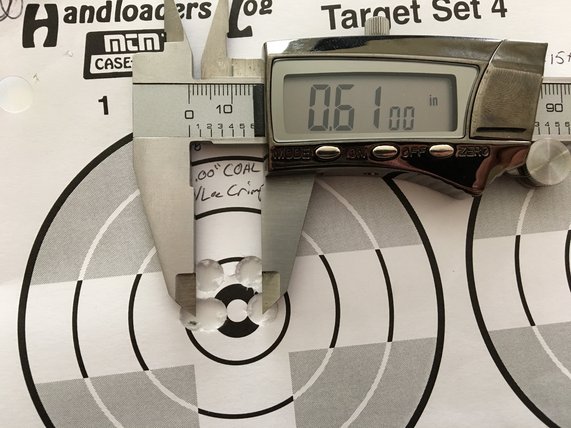

That's "your opinion", which is fine. "My opinion" which I can back with data, tells me it works just fine. The picture attached is cold bore first rounds of the day out of a Noveske 300BLK, the gun will normally run good groups anyways with this load but what makes this one especially good is the rifle has had a T-2 on it for 3 weeks of shooting several hundred rounds. I slapped on a NF NXS 3-5-15xx56 in Larue LT-745 QD mount on the rifle the night prior and laid down this 5 shot group at 100yds (again, cold bore, first rounds).
Will other mounts do this, I'm sure they will. But this right here sells me on Larue. Or at least, they work for me, for precision.
Just my $.02... take it or leave it

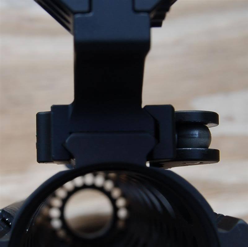

It's about surface area,
Larue has the least amount of contact vs any other QD mount. The knife edge is a bad design.
I have not seen a Larue perform as well as noted above, but the military has tested it, and in cases where this part of the test is included, Larues always come up short. ( A lot of times the military will leave this part of the test out in order to use a Larue, as an example a Spuhr mount was discounted in one test because the testers said the mount was too shiny)
But Larues loosen up over time, and under recoil, especially with a larger center fire vs the AR15 calibers. The knife edge is making minimal contact, and if you over tighten them, they will damage the rails over time. Just look from behind at rail level, lost of space there.
A broken clocks is right twice a day, this is usually the case with the Larue, aside from dishonest testing that often occurs. These success stories are almost always on a AR15 platform, which some call a clue.

The ADM Mount
The Larue Mount
Reactions: EDDK9
I can understand that and see how it could potentially be a problem. Thanks for the visual.
