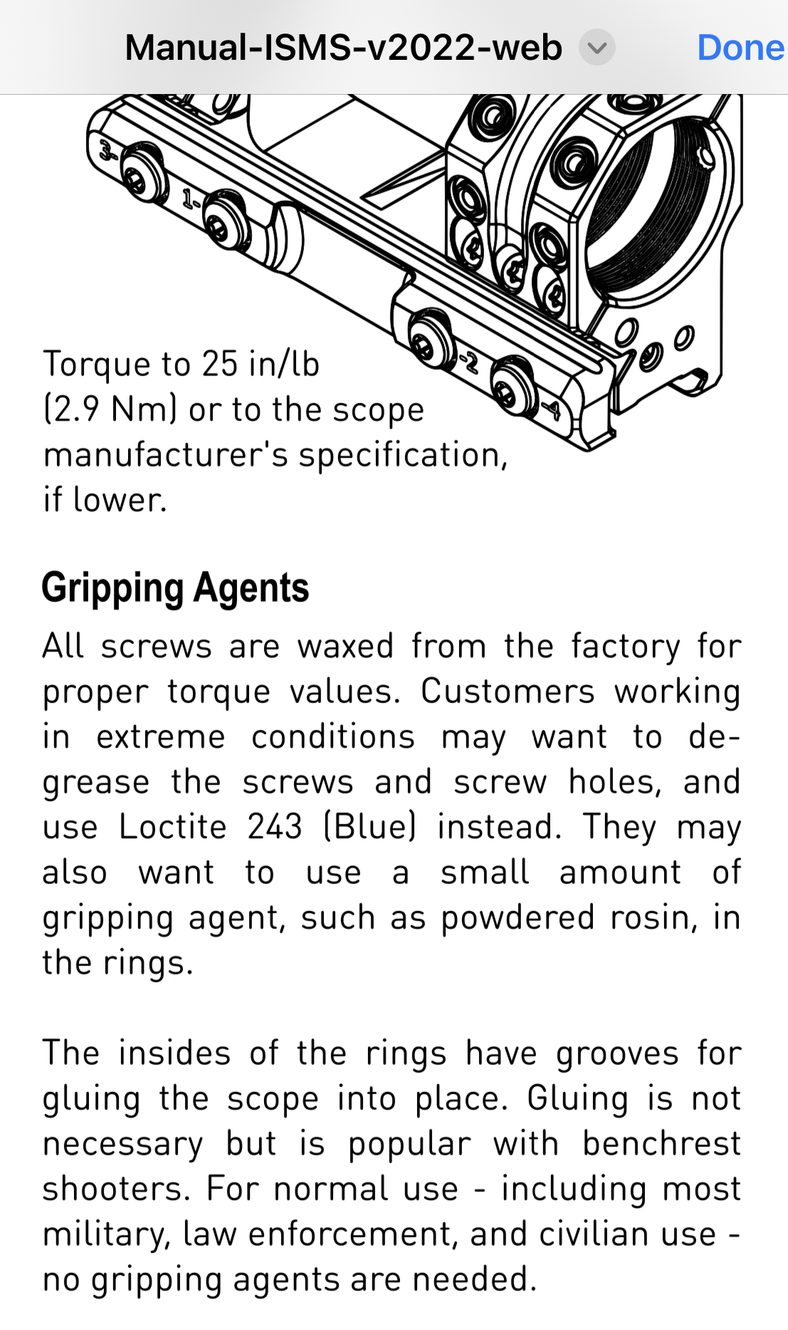

On the unlubed fastener front re:Spuhr, my new mount came with wax on the fasteners, and they had this to say about it:
Here’s the link to the manual:
https://www.spuhr.biz/wp-content/plugins/download-attachments/includes/download.php?id=3698
When reinstalling, one would think using wax again would be the recommendation, but amusingly they do not address the issue.
I am going to just tig weld my scopes to the rings lol
But seriously, this does not overly concern me. (the wax…tig welding concerns me lol)
Obviously this wax thing doesn’t seem to factor into your mounts cracking. As I understand it, torquing a dry bolt would result in a lower torque value than a lubed bolt would realize. And a waxed bolt would be considered “lubed”? Right?

Recently I found out that Locktite does NOT act like a lube. Apparently blue threadlocker has a k-factor near water. Again, tig welding is the solution lol

The very first spuhr mounts I purchased all had obviously waxed hardware. None of the late gen 1 or early gen 2 mounts I purchased came with waxed hardware, the hardware was very dry out of the package. I did not add any extra lube, anti seize, or thread lock on any of my installs... And the clamp bars still failed at an alarming rate, lol. My first hunch was an out of spec rail as the first 2 failures were on the same Murphy precision rail on the same rifle so the rail being out of spec was my initial suspect, but then I had 2 clamp bar failures on 2x JP rifles and 1 failure on an AI AX. At that point evidence points to the material or design (or both) of the clamp bar, because I can say with 100% certainty it wasn't due to using lube on the fasteners or an out of spec torque driver.
