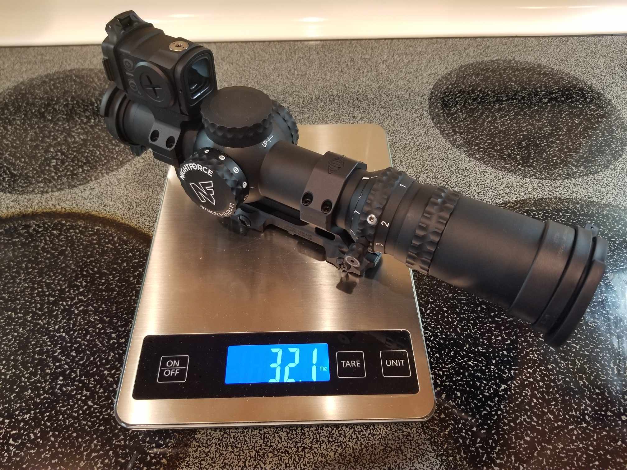

I recently bought the NightForce Mil-Spec ATACR 1-8x (SU-294/PVS) and the Vortex AMG 1-10x. I'm extremely impressed with the Vortex, it's an amazing LPVO. Pretty much everything about it is better than the NightForce SU-294 (and it was cheaper than the SU-294 after I consigned the DD rifle for sale at the FFL I had the rifle/scope transferred to). If the new Vortex scopes prove to be reliable and durable, and if they can offer them at a more competitive price point, they could sell a shitload of these things (that's if they decide to release more than 50 scopes to the public)! Even though it's nice to have a limited edition item in the collection, I truly hope that Vortex makes a ton of these scopes available to everyone!

What does it ACTUALLY weigh? I know the weight is published, but I've never had an optic that was close to published weight, lol! My ATACR was about 23oz for example, as I recall, with just the OEM scope caps.

Correction, perhaps my scale wasn't zeroed completely.
ATACR setup: 32.05oz
AMG setup: 29.15oz
So I gave up 3oz weight savings, and added 1.5" in length and reduced from 10 to 8x in exchange for the color of my choice and a more fielded/tested product with a less finicky eyebox and brighter illumination, and not having to sell a rifle in the equation, is pretty much what I'm hearing? I can live with that, but I do wish the Vortex were available more commonly, I would have really mulled it over a fair bit.
