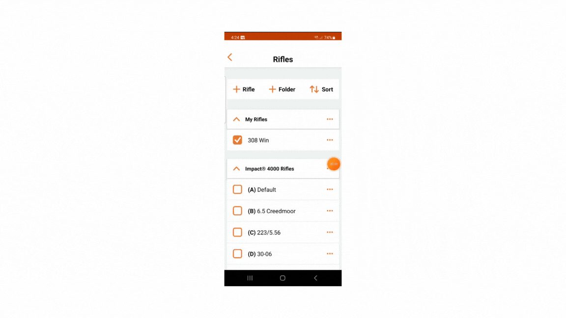

Got my mounted up and I'm headed out to an 1100 yard range this morning. It's sitting on a 6-5 bolt gun.
Made the mistake of creating all of my rifle profiles in geoballistic and not doing it under the folder for the range finder. Had to recreate them all. It was easy to get the app data to line up with my kestrel. I basically trued all of the data by selecting the same distance that I trued my kestrel at (1000yds for my 6.5CM), and then entering the dial from my Kestrel. Winds up spitting out the same data. Oh man, sorry about that, I will load a quick video on how to do that and edit this post asap. Essentially, in the top righthand corner of the rifle screen in the app there is a "sort" button. Hit that, then you can drag and drop to any file you want.
I didn't tighten down the bolts with a torque wrench, but I did it by hand and then created a witness marks with a paint pen. Pulling the unit on and off and tightening back to the witness marks shows that it returns to zero.
It does not hold a relative zero when switching between guns. More to come on this. My 6.5 has a set of badger rings with their diving board, not a one-piece mount. When I put it on a spuhr mount with a diving board, the unit was several mils high and several mils at 100 yds. I'm going to try the same thing with the badger C1 mounts that I have and the night force mounts, all which have diving boards. Different mounts sit in slightly different ways. There is really no way to account for switching mounts.
I believe the difference is because the spuhr Mount is 0moa which is adding 3+ mils to the laser elevation compared to a 20moa mount or base. Everything is canted the same on the mount. Its just a function of different heights,manufactures, how your rings are tightened, etc....
Hopefully some of the bold print helps. Let me know if you have any questions.
Hopefully some of the bold print helps. Let me know if you have any questions.View attachment 8241758
It was really hard to catch that you started that process by clicking the SORT arrows at top. Went back to YouTube vid and that was buried 35mins in to a 45 min video, but at least now I can move guns around in the app. Profile management is still a hassle. Would like to keep master copy on app and sync that master to the impact. Also requiring 10 profiles on the unit at all times introduces chances for user error. Kestrel can sync just 1 if desired or hide unwanted ones.

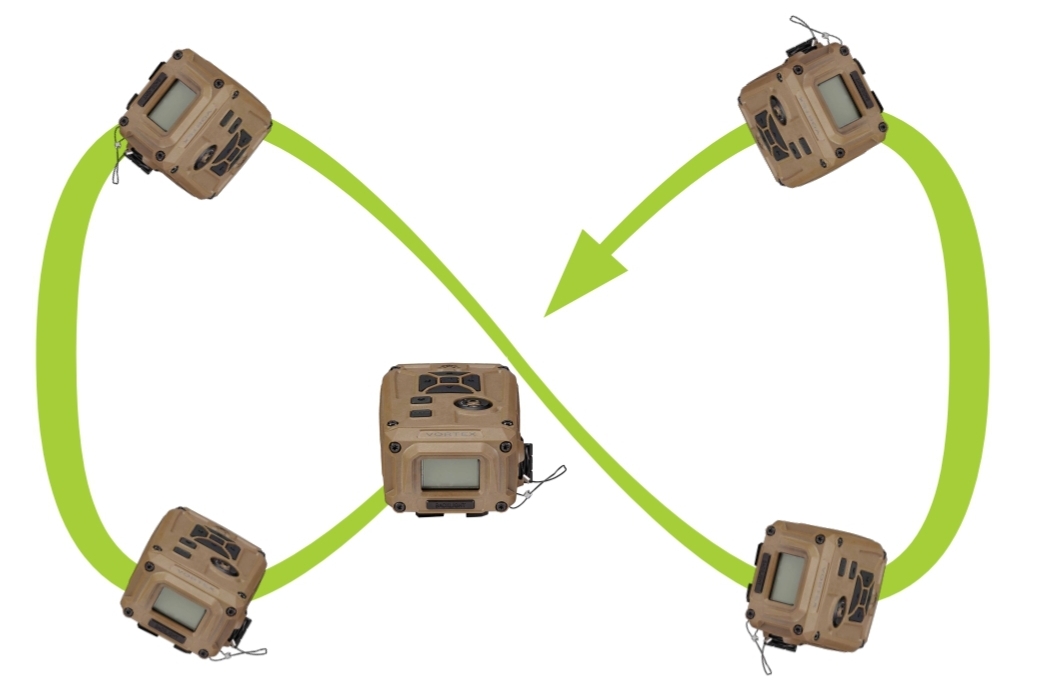

Compass calibration is easy if you watch the videos. Not happy to hear about the two batteries leaving it on with no backlight
Tried at least 10 times in the middle of a sage brush field after watching the videos. Still couldn’t get it. Ultimately gave up. Wacked a dog at 450 so it didn’t matter much. Batteries might be a bit disappointing if that Trend continues… it was only 52 outside.
Which step are you failing calibration on?
I kept failing on the figure 8s until I realized it wanted to be flipped completely over like a carnival ride during the motion.
Calibrated every time since without a fail
Figure 8s. I tried flipping it, not flipping it, clockwise, counter, over head, right hand, left, you name it.
My wife thought I had turned a new leaf and picked up interpretive dancing in the sage brush with how long I was out there.
Hopefully battery life isn't like that across the board. I'm typically out for 8hrs a night, 3 nights a week on deer, pigs, and yotes. That's ALOT of batteries.
Would like to see v2 with a USB-C plug for external battery and computer connection as backup for Bluetooth...
I failed the first time with the horizontal side spinning, there is a specific order and I must have image dyslexia because I was doing it the opposite way first multiple times and then I looked hard at instructions and realized I was spinning with the unit flipped on the wrong side, so pay attention to those images ;)
You made me spit out my tea with that image :ROFLMAO:
I dunno how to explain it but I swear I failed it 40 times until I looked at the picture in the manual and started getting more wrist into the motion to flip on completely over during the 8s ... and then it just worked...
Sorry for the highly technical explanation lol
I watched a set up video that dude was all gentle and stiff and I tried to copy him over and over and it wouldn't work...

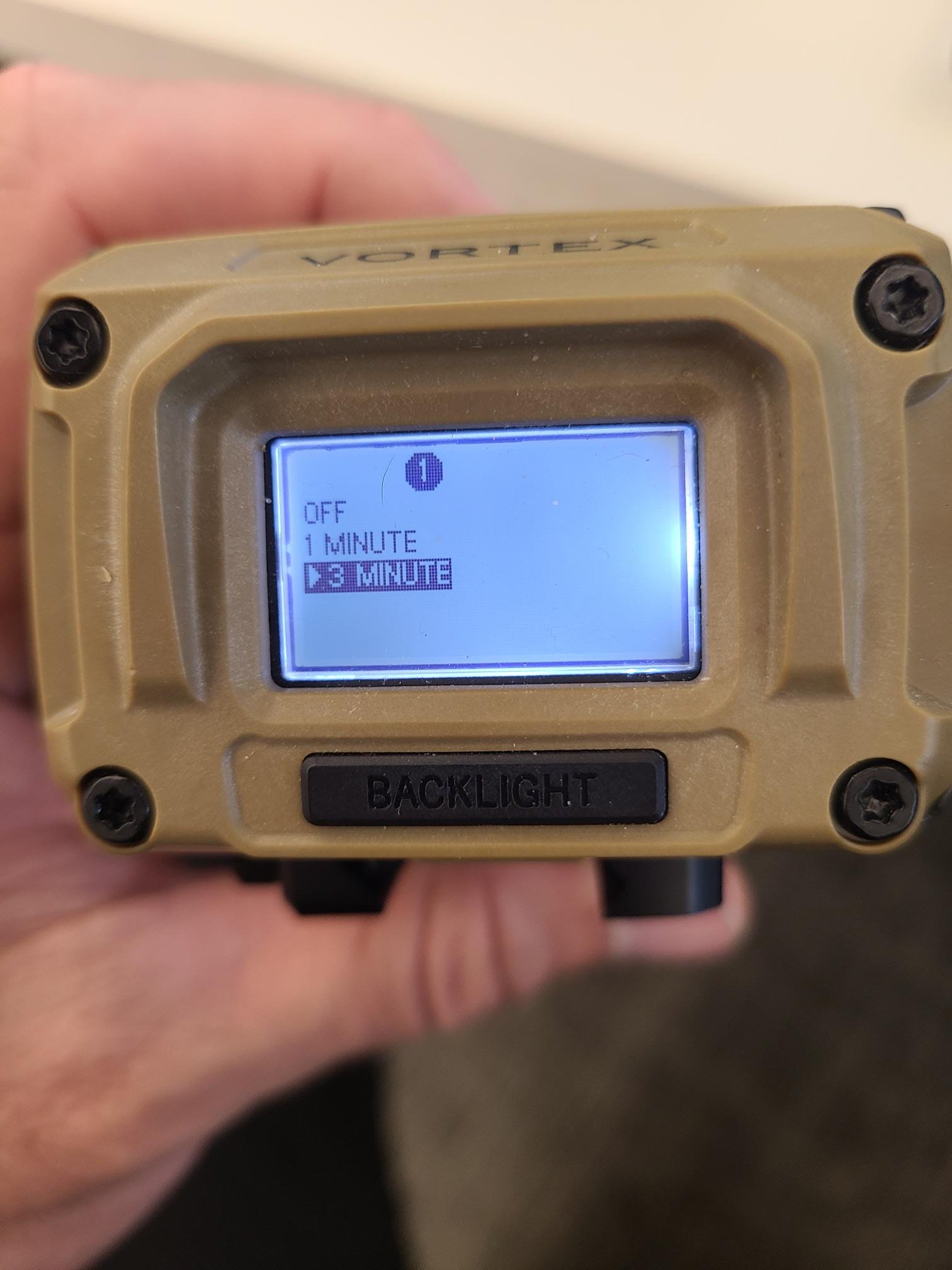

any chance there could be a update for a option to leave it on with no backlight then when you zap a range the back light comes on?
For how much night hunting some of us do that would be nice so you don’t have to power it on up top then zap a range up top or in the remote.
Like a backlight time out setting not auto off. And backlight on when you hit the range on the remote.
