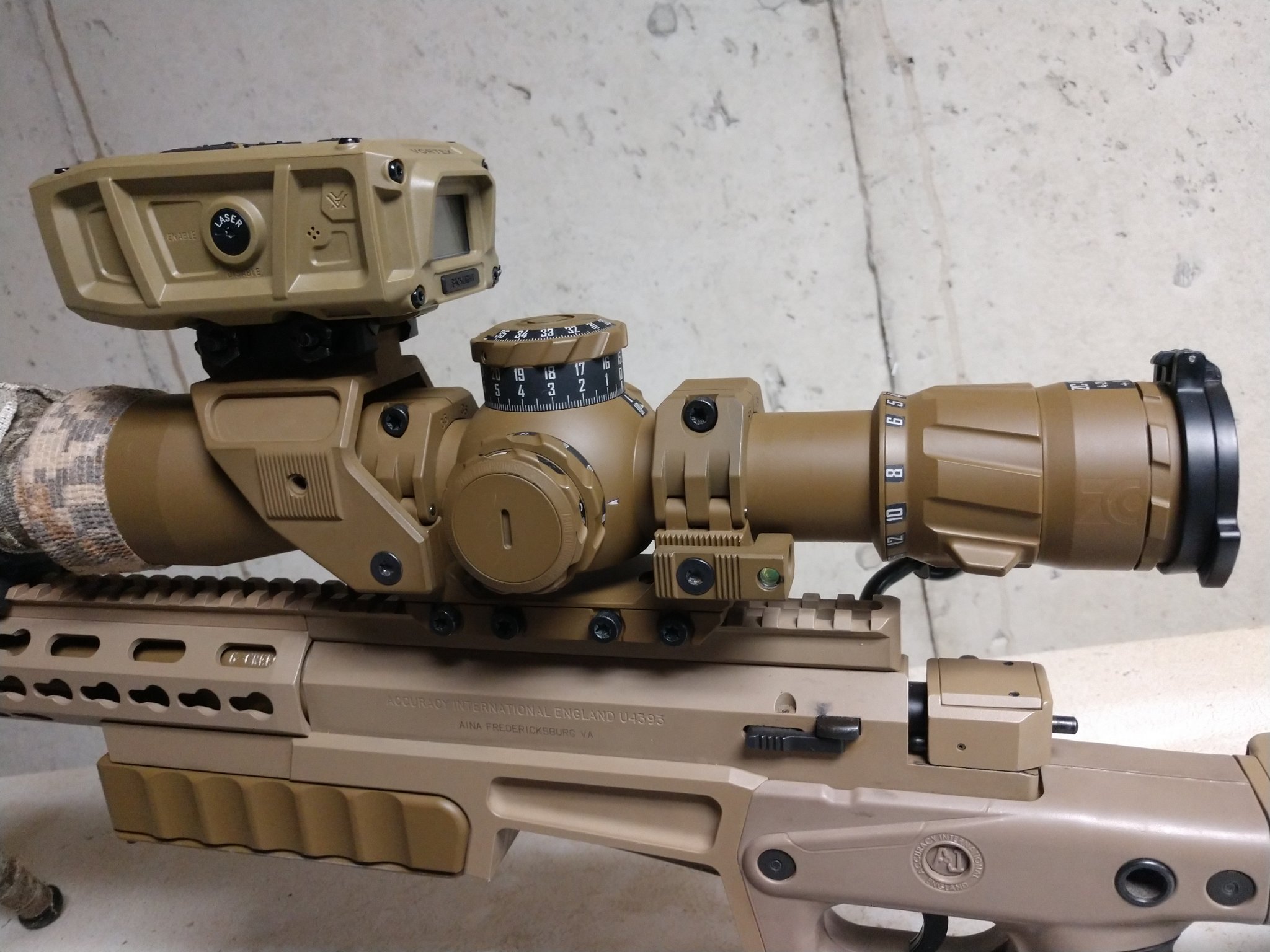

What mount mount/diving board setup is that for the scope. @Ordnance Locker
On his first pic, they appear to be Vortex. Here’s the 34mm version with the optional diving board.
On his AR, looks like a Vortex cantilever version of the same model.
Yup. It's also available in 30mm as well.

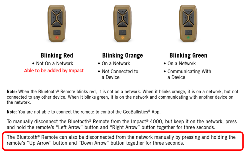

For the life of me I cannot get my remote to pair.
GeoB was upgraded when the unit and App paired, then I went though the pairing of the 4000. App shows GeoB and 4000 paired, and the devices (GeoB and 4000) show on the settings within the 4000 (also "Vortex" is showing as connected in Bluetooth on my iPotato).
I followed the instructions and went back to the HUD, then hit the BT icon, then the Impact ellipse, which shows the remote and the plus sign (I'm doing this while the remote is on and blinking yellow). There is no auto pairing of the remote so I hit the + by the remote icon and no devices come up.
I've done this and differing sequences about 87 times now. Can anyone tell me what I'm missing?
We are very sorry you are having this problem. I think I can help though. To connect the remote needs to be blinking red. Reset the remote by holding down the up and down buttons for a couple of seconds on the remote until it flashes red. Then it should connect when you
Unfortunately its a little difficult to tell the orange from the red. Its sutttle ,but there is a difference. Let me know if that works for you.

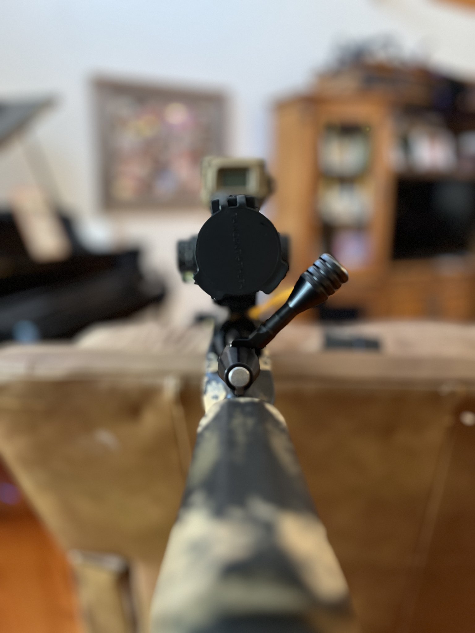

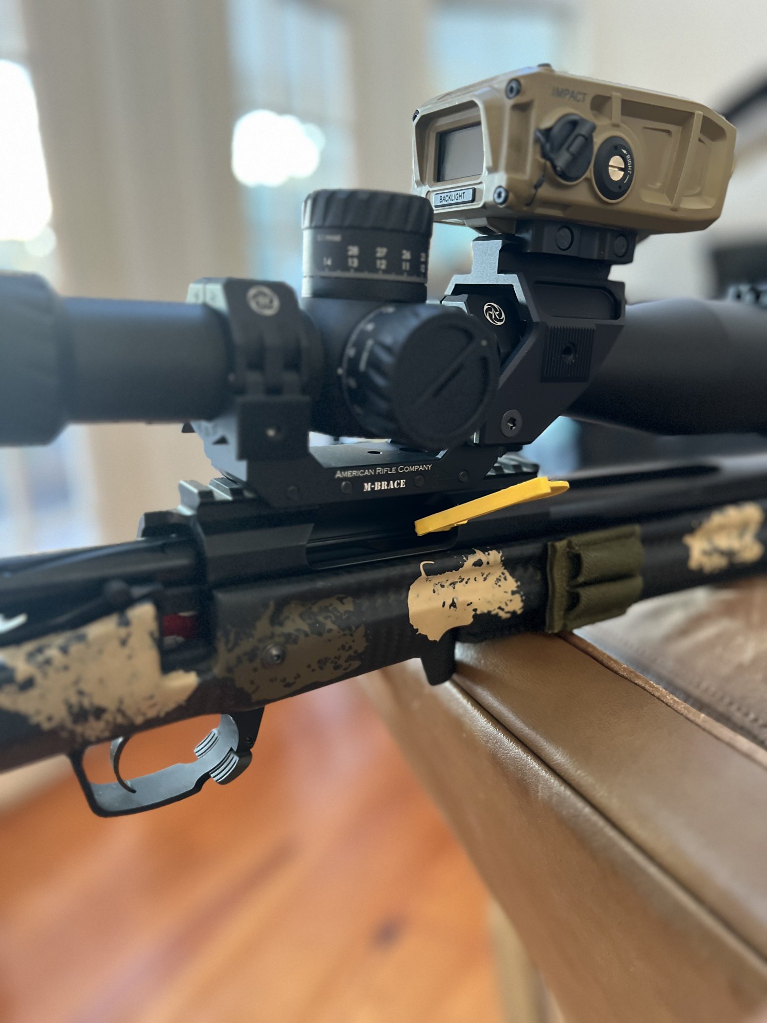

Anyone have a pic of it mounted on an Arc Mbrace bridge?
Since on an Mbrace one cannot change the height, I’m curious to see how high it sticks up vs other mounts.

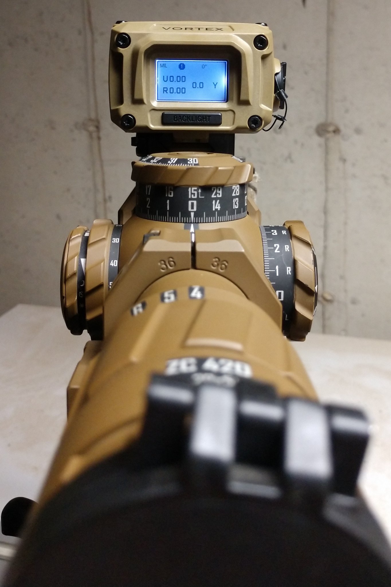

Here u go chief

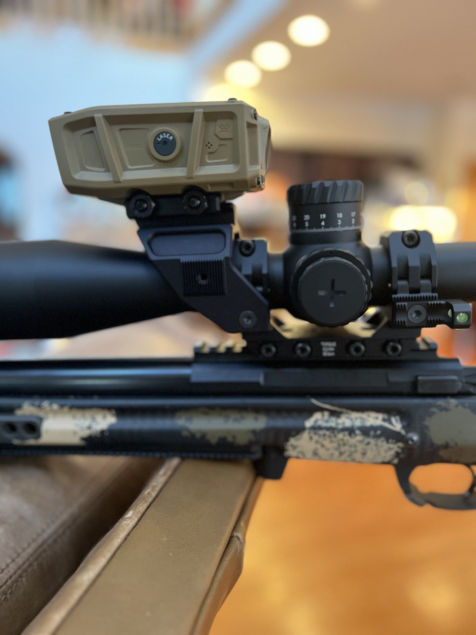

I’m warming up to this thing for my application.
Not a cerakoted ZCo but here’s a comparison to another scope with slightly taller turrets.
Reactions: carbonbased

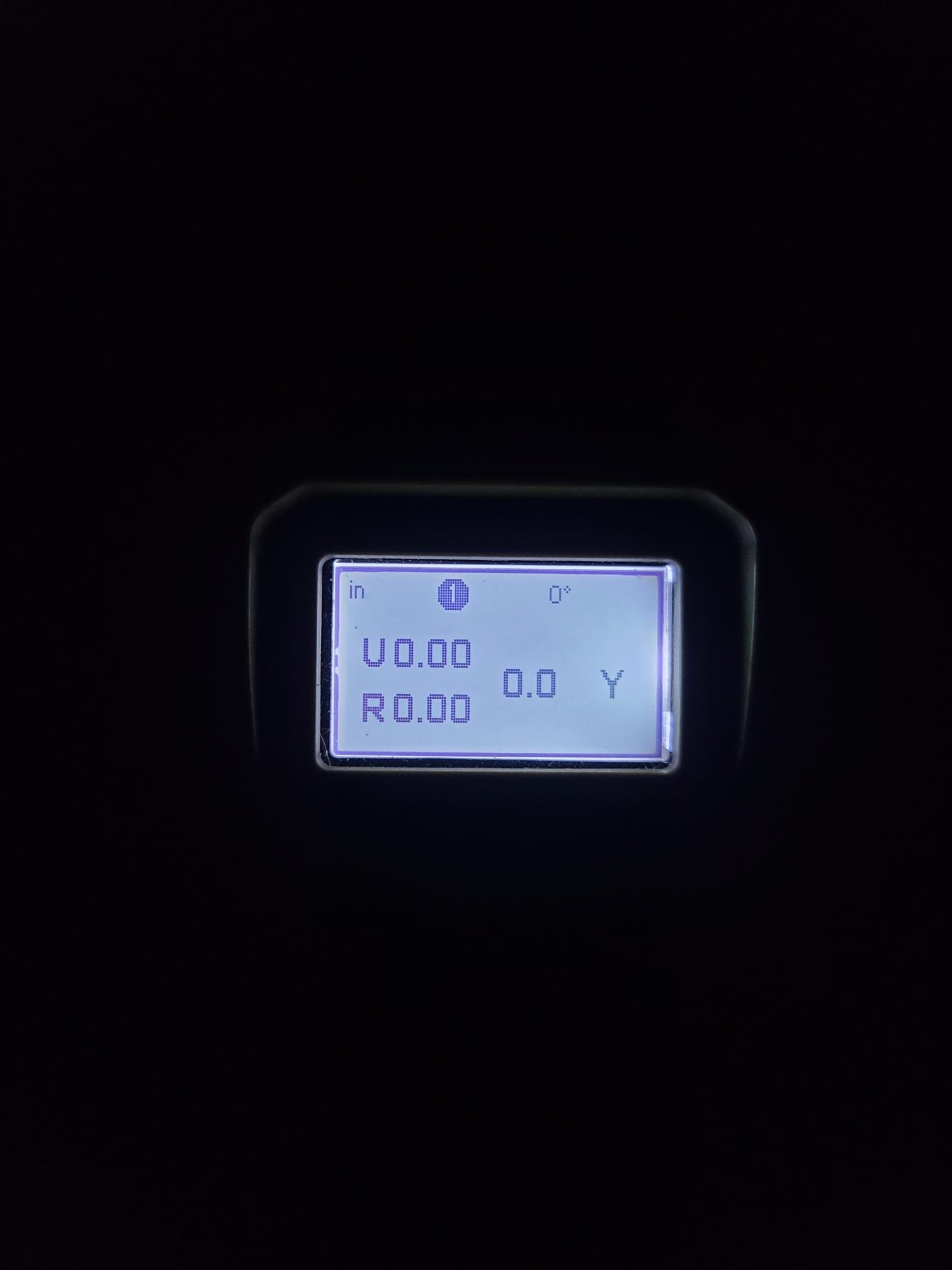

Just a heads up for those of you who shoot at night you might not be able to go that low.... The laser may or may not hit the back of the clip on

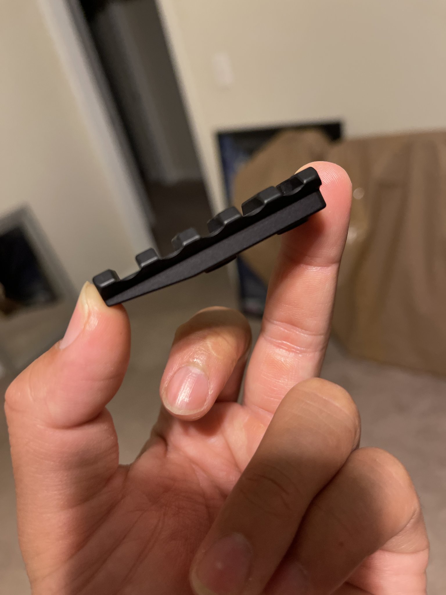

Which spuhr pn is this brah?
It's the Spuhr A-0019D Raptar Adapter - Low. I picked it up at Mile High. I also have the A-0029 adapter but it placed the unit higher than I would prefer for my use case. Sorry, don't think I took a picture but there must be some in the thread somewhere.
If anyone has a low mount they want to trade for a high one, hit me up.
Nah looks like a RAPTAR rail - low.
Winner, Winner, Chicken Dinner!
yep, my vis laser runs into the back of the PVS27. It sits lower than the other lasers though so it doesnt seem to be causing an issue with the ranging laser with the 27 mounted. I was all excited to just use the NV to zero the damn thing but it needs to be a cunt hair higher. If i was running a super low mount like some of these guys are discussing im pretty sure the ranging laser would be crashing into the back of it as well.

@Scott_at_Vortex is there any future possibility of giving the screen some lower intensity settings to facilitate low/no light use? A big, bright screen is not conducive to use in the dark. Ranging with a clip-on NV or thermal was a big driver behind the Radius suddenly becoming mega sought after over the last sixish years. Seriously though, BIG thanks to you guys for bringing this otherwise amazing device to market that many of us have been asking for!
I think someone mentioned it, but the backlight is optional. With the back light off we have been using a red head lamp or BNVD's.
Below is a pic of the display with the backlight on lowest setting in a blacked out/dark room for reference.
Reactions: Glassaholic
We have a no backlight option already
Just not a "dim" option
Thank you, I did not realize that was an option.
I think someone mentioned it, but the backlight is optional. With the back light off we have been using a red head lamp or BNVD's. With the back light off we have been using a red head lamp or BNVD's.
Thanks for the response, that does not look excessively bright in that pic.
I'm curious to hear the opinions of others as far as their impressions when using in the dark. Applying tint sticker to it like the poster above mentioned would indeed seem to be a cheap and likely effective solution as well.
Reactions: Scott Parks
It's not so bright that it's unusable, it just lights the rifle and your face up pretty well. The screen is still easily readable in the dark though.
