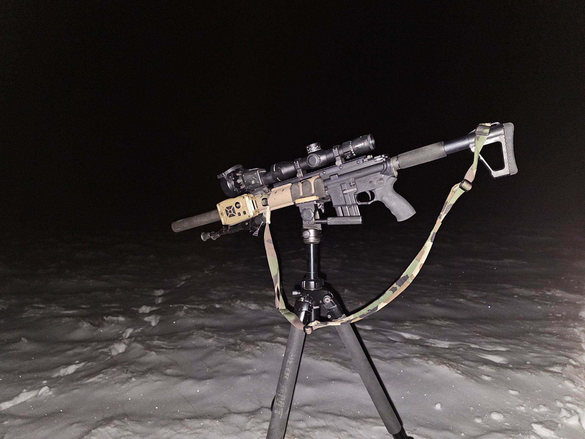

Back out again. Pitch black nights, having 2, 3% gel density filters stacked is still too bright. There was a noticeable glow on me when using it as coyotes came in according to my bunting partner.
Got a new pack of filters to try. 9% might be the ticket.
The unit when used in 10-20 degree weather takes about a full second to display distance and data regardless of distance. Battery life was good enough for a single battery with maybe 20min of run time total on 4 stands for the night. Worst part is finding the power button in the dark when they're coming in fast and worrying they can see me due to the brightness.
Ballistics were spot on for a 464yd standing tripod shot to bag me one solid center mass kill. New record. Readout read 2.7mil. Held 2.7mil. Heart shot. New distance record for me at night on coyotes.
I'm still happy with the unit but battery life in the cold, LCD screen lag in the cold and power/fire button location continue to be the largest problems with the impact 4000.
2 of 3 of these issues would be easily avoided with any sort of real night time t&e.
