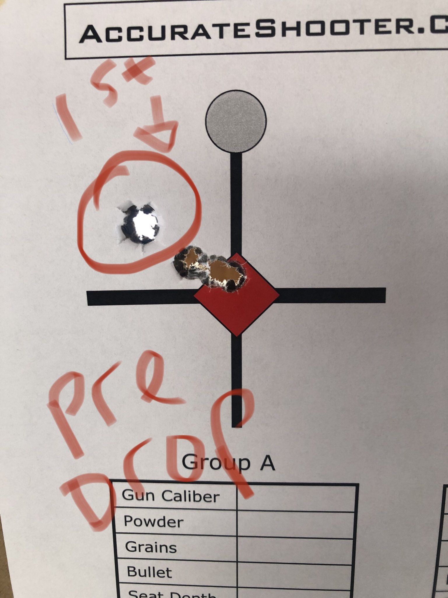

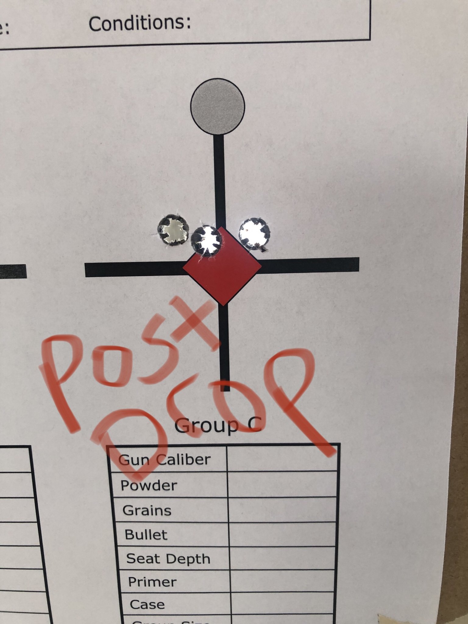

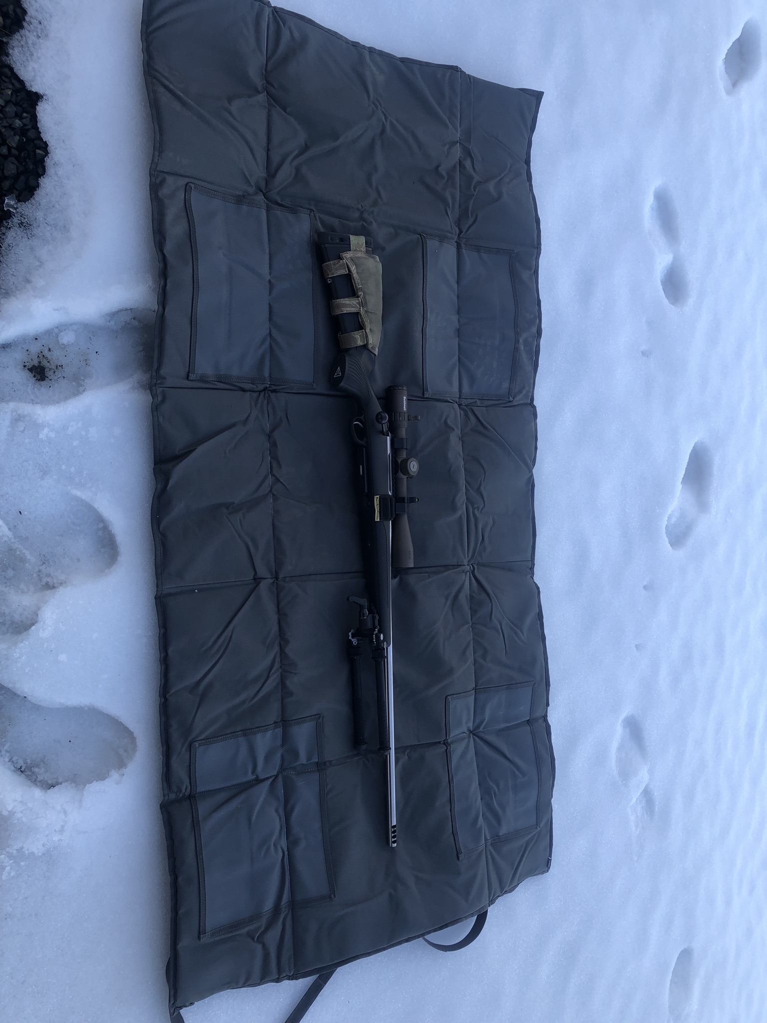

Getting back on topic regarding drop tests, I took my hunting rifle to the range over the weekend. Shot a 3 round group at 100, then decided to drop test it a total of 4 times, two on the left side and two on the right side and test it at 100 yds again.
Note: I completely dissembled the rifle a few weeks ago, gave it a light cleaning, and installed a pic rail for my new Atlas Cal bipod. So forgive the one flyer in the first group. Once the first shot was out of the way it grouped exactly as I had left it.
Rifle is a Tikka T3, 300 wsm, Benchmark barrel (around a 2b contour or something, slimmer profile but a little thicker than Tikka Sporter barrels). Factory stock, mountain tactical rail, seekins rings, and scope is a Bushnell LRTS 4.5-18. I used blue loctite and a Wheeler fat wrench to install. Handload ammo used (4831sc, CCI 250 primers, Nosler brass 2x fired, 212 eldx jumped .095).
First 4 rounds out of the rifle when I arrived at the range (first flyer post rifle clean and disassembly highlighted):
Then I dropped it from 18” a total of 4 times. Two on each side. Rifle landed on the side each time. Pic of rifle and drop zone. Essentially just my shooting mat on top of snow. Snow was on the hard side. A good 1” of crust on top.
After the drop I shot the following 3 shot group:
After that I proceeded to hit the 500, 600, 800, and 1,000 yds targets several times. I noticed no shift post drop.

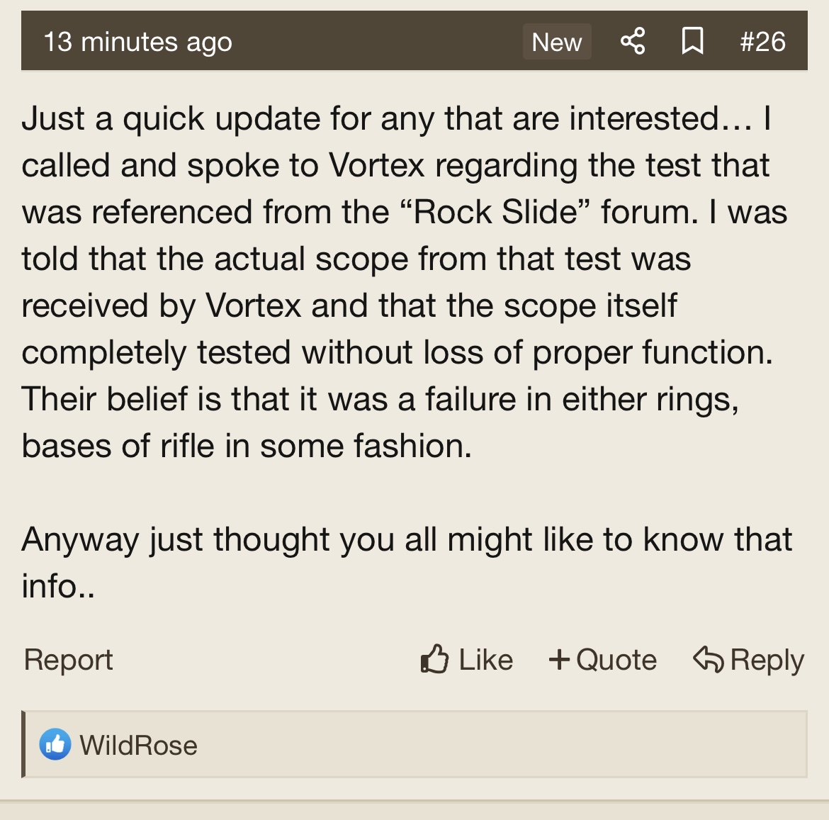

For anyone too slow to read it, that is not the actual Rokslide OP (scope tester) reporting back from Vortex.
That is som random 3rd party calling corporat HQ and being fed a line of BS, then going to multiple non Rokslide forums to "spread the word"
Nothing new in this CNN grade PR response is new information or verified in any way.
