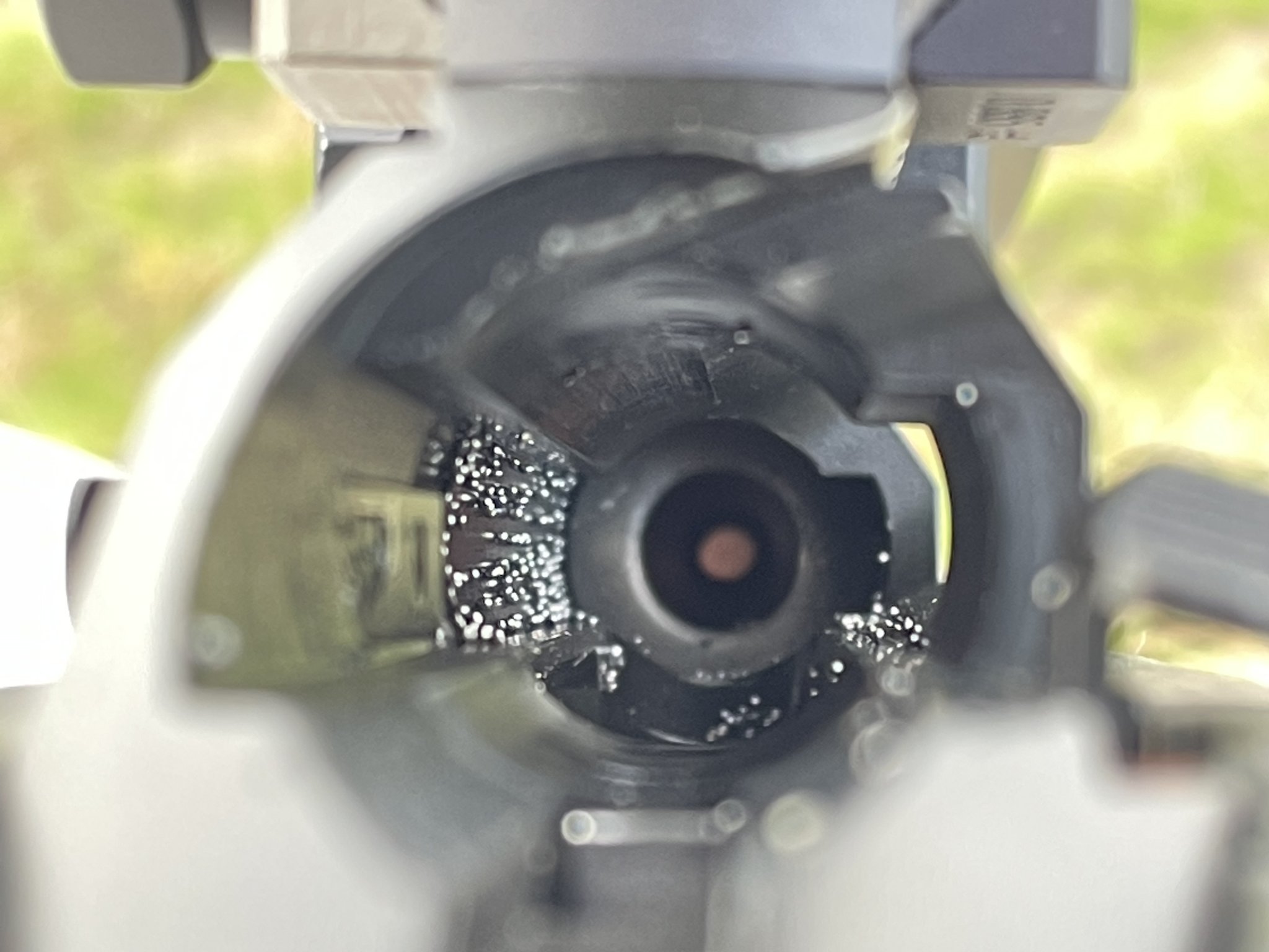

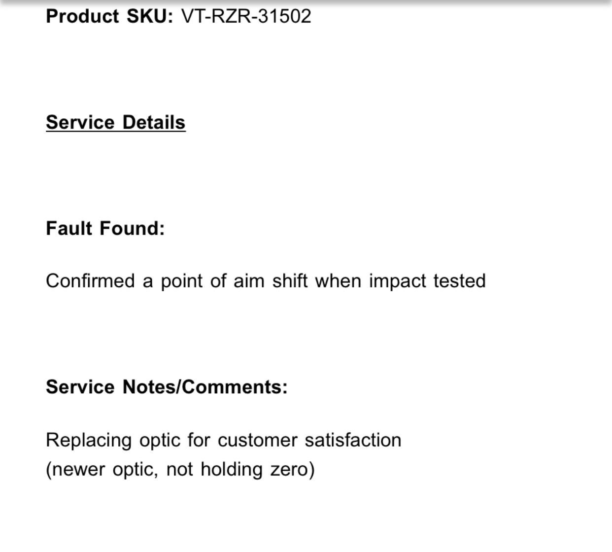

So here's an interesting update on the LHT that was tested on Rokslide.
Looks like some mounting issues were noted by the tech at Vortex when the optic was returned for repair..

"scope back from Vortex. Their communication was outstanding. I do have a VM into them to clarify something. But here is the email. We will listen to their mounting specification and retest."
We’ve received your riflescope, and run it through our full inspections and repair process. All optical and mechanical parameters have been verified, and the optic is now in perfect working condition! The riflescope is ready to head back to you, and if you’ve got any questions on the repair process, what we’ve found in diagnostics, or otherwise – simply shoot me an e-mail, or drop me a line. If I do not hear back from you by Monday, February 7th, I will send it back with my card in the box so you can call at anytime.
When an optic comes into Vortex, we completely eliminate all other variables such as the bases, rings, action screws, ammo, muzzle device etc. We focus on just the optic. The optic is ran through a series of tests and everything was verified. I had a chance to double check it as far as impact testing and tracking. It tracks perfect and doesn't deviate from zero at all. The equipment we have allows us to observe a shift as small as 1/4 MOA or .1 MRAD and I couldn't get it to shift at all, as it stands, outside of any rings or mounts.
I did want to discuss the mounting process you're using. Was this optic put through your Drop test or evaluation? I observed loctite/thread locker on the optic. Our torque specs are 15-18 inch-lbs with no loctite, so dry torque. If you use loctite, it's a lubricant and will lead to higher, unknown torque values. This then leads to a number of issues with an optic including trouble zeroing, holding zero, tracking etc. When you use a quality ring or mount, loctite isn't needed as those screws are under load and as long as they are torqued properly should not loosen.
We also observed some wear on the bottom of the scope, on the bell end or objective end housing. This may have been mounted tight to a barrel or rail etc. I wanted to dig into this further as it can certainly impact the consistency of your setup.
I'm happy to take this a step further for you if it helps restore confidence and mount the optic on a known rifle and set of rings, to our torque specs, and shoot some 3 shot groups in our indoor 100 yard range.
Please let me know if you'd like me to do that or if you'd like to discuss anything further on the phone.
Thank you again for choosing Vortex Optics!
All the Best,
I can't believe he put loktite on the rings😑

Vortex didn’t exactly say they did or did not fix the scope. The wording in the email is pretty careful.
“We’ve received your riflescope, and run it through our full inspections and repair process. All optical and mechanical parameters have been verified, and the optic is now in perfect working condition!”
Reactions: JDB55
Right, maybe I said that wrongly. I wasn't trying to say from my post they did or didn't fix it. My point was that from everything I've seen reported from users and from when I've even reached out(even though it wasn't for a broken scope) they've always taken care of an issue and admitted if something was wrong/needed to be fixed or been willing to have a conversation about a potential issue. That's my experience, but others may differ, I'm open to hearing that for sure.
