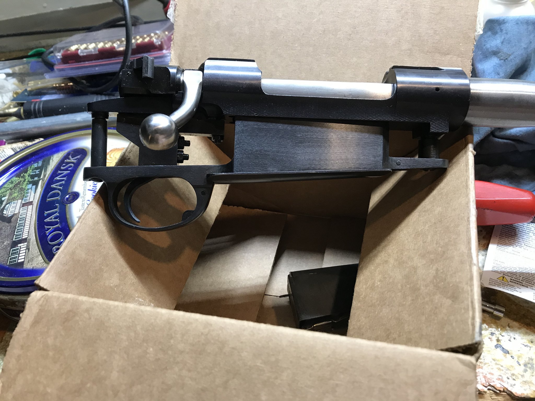

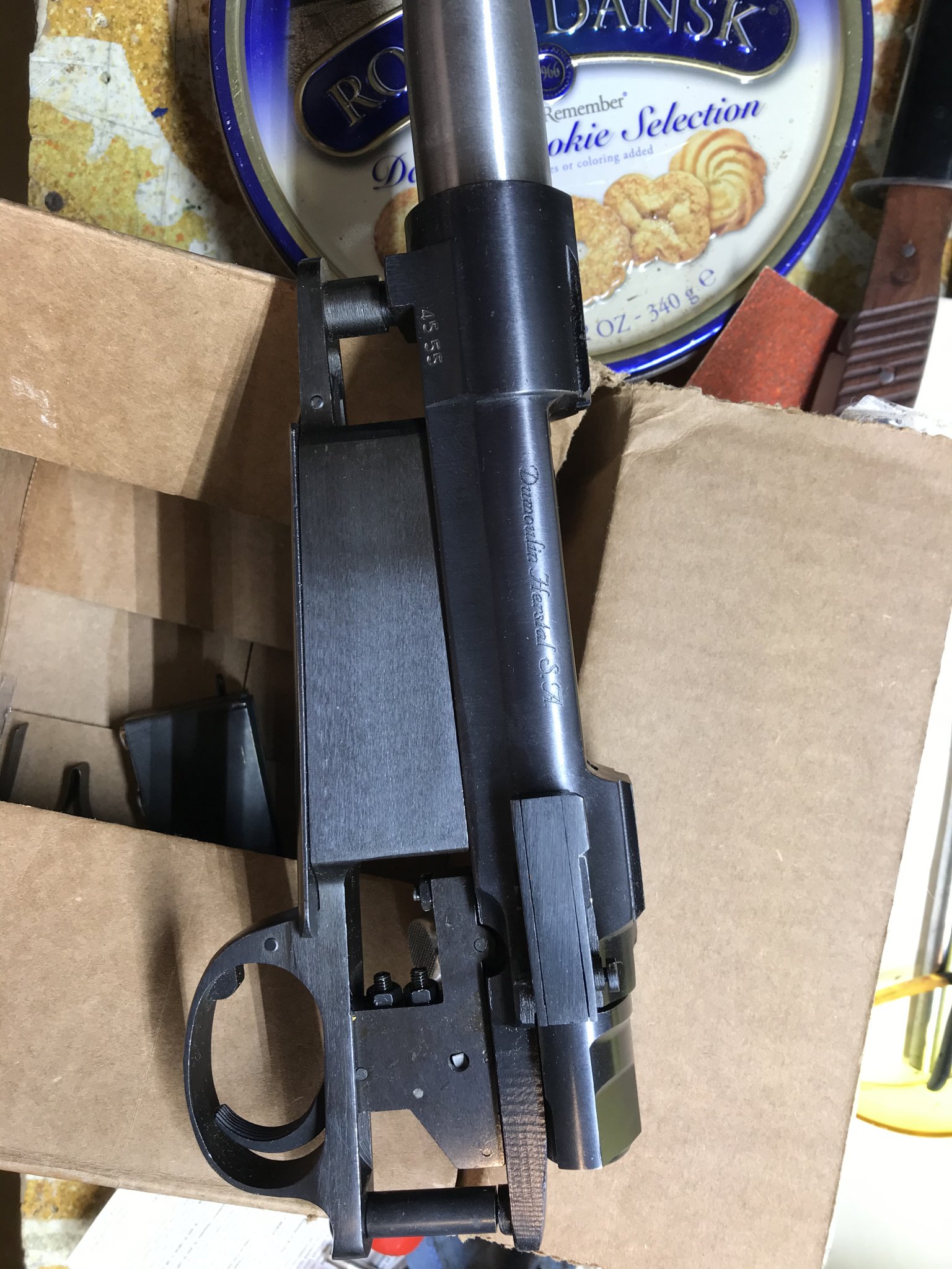

That moment we've all been waiting for... progress pictures!
I visited NECG today as they had done a wrist repair on a Birmingham Best SxS I bought a few years ago at Tulsa. Stunning gun I bought for nothing. Their repairs made it a stunning 'perfect' gun I bought for nothing!

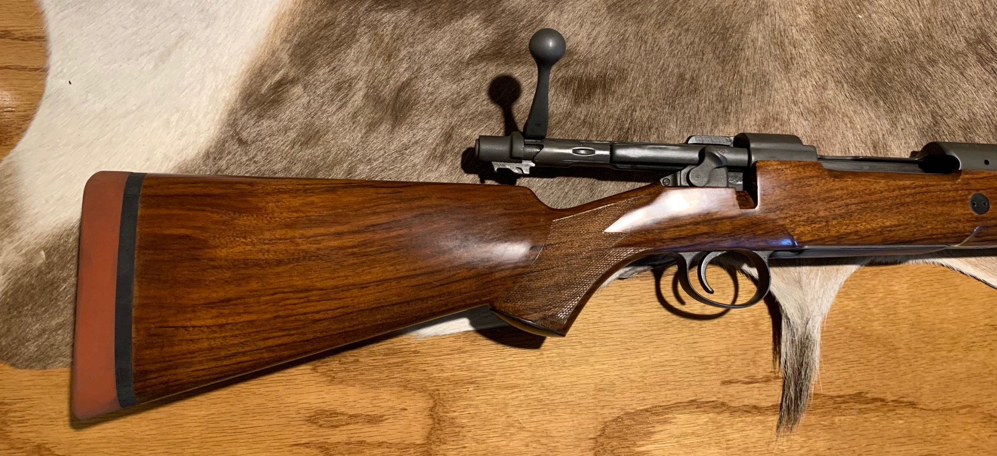

So back to the Capstick... you will remember that it had a semi-finished stock. No follower. No recoil lug. Big dent in stock. Metal in white (it still is).

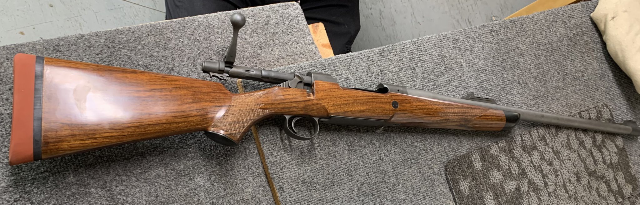

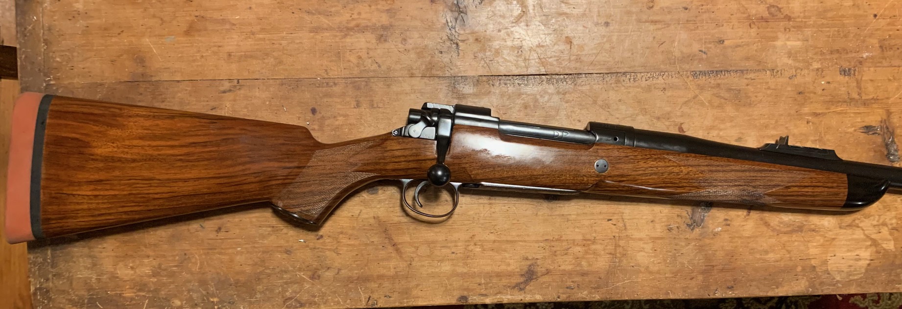

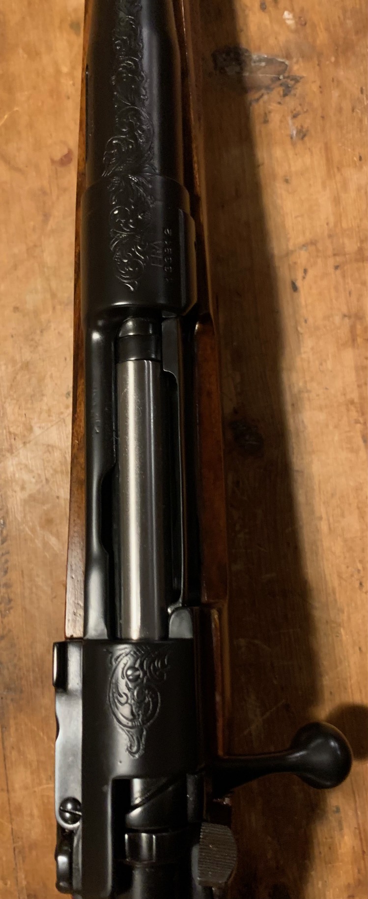

Here it is now. Stock reshaped subtly in the style of Rigby. Nicely checkered and recoil pad fitted. LOP fitted right to me. Absolutely comes right up to my cheek and eye. The gunsmith(s) at NECG are amazing!
When I first saw the wood, I thought it might be really plain and not very rich. I was wrong. Check out the finish! That's tru-oil applied by a mastr! Hubba hubba.
Action open. We have not finished any of the metal yet. But it is going to get rust-blued to be a semi-gloss classic 'english' blue. I don't think I am going to scope it. It's got a great set of rear express sights and a great front sight.

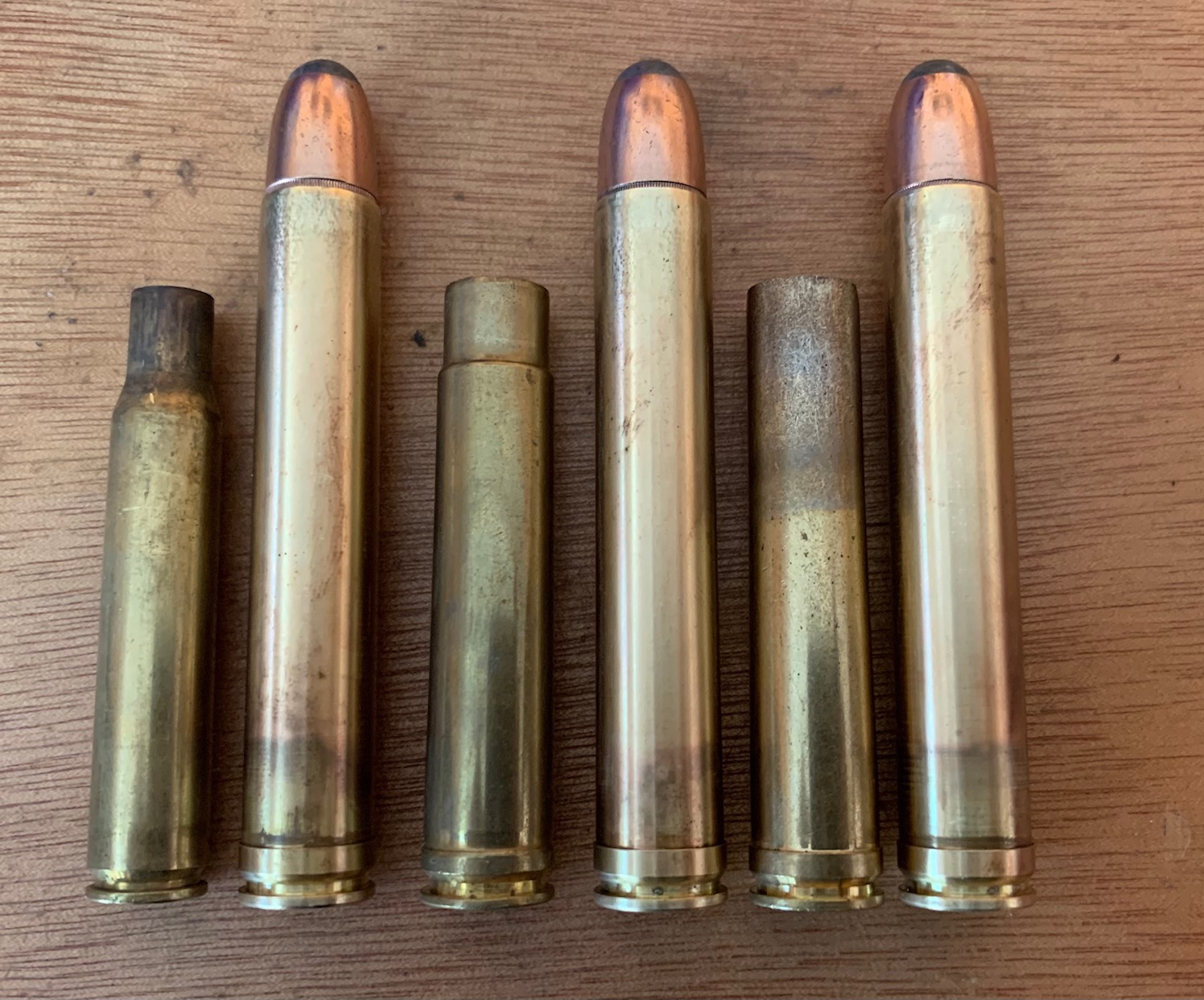

The next challenge is cartridges. The ones above are from Roberson, an amazing company. They make oddball brass like this from billet brass and the rounds are amazing. These are a 'bit' big on the OD when the bullets are seated. Part of it, I think, is that the case wall thickness is necessarily fairly robust from the machining (rather than drawing) process. This means that when the cartridges get a slight bulge in the sized case where the bullet is seated, this part of the cartridges is a 'hair' tight on my chamber. So I am going to polish off about .002" from my dummy cases to get a size. If I need to, I can set up a taper attachment and take a thin skim of the rest of them. I only have about 50 cases for this rifle. So modifying 50 is not a big deal. That or I need to find some original Kynoch cases. But they are rarer than rocking horse turds.
Anyway... that's the update. More as things progress. I have no idea what this has cost so far. But the rifle partial-project was dirt cheap. And the finished piece is going to be a gem. So I know it's worth it!

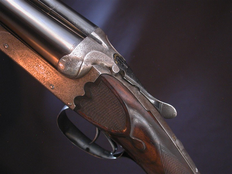

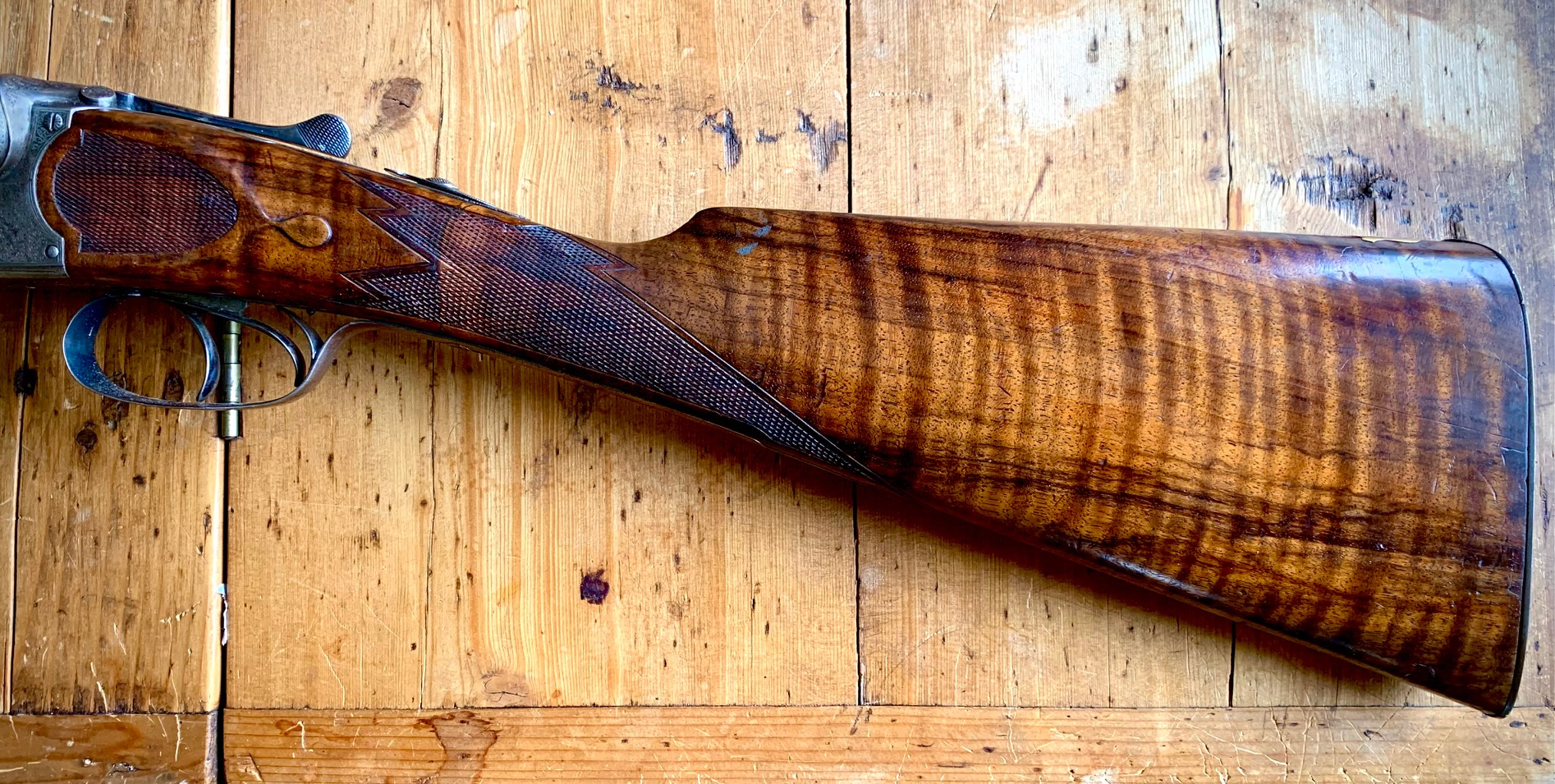

Very nice..... what about photos of the shotgun???
I'd be a lot happier with that grain through the wrist than grade 5 marble cake or similar - this is one rifle where function HAS to govern form.
I figured someone would ask.... Still having trouble with the name. I think it's RP Morris, Birmingham. Says "The gun that won the Field Trials" faintly. More later. It's not Moore, I don't think. I'll post a better set of photos for you guys to help with!
But look at that rose and scroll... If that was on a Purdey, it would be a $30K gun!
Look at the metalwork around the fences! Amazing! That's carved from a single block... Those aren't 'added.' That's a gunsmith with a file.
Anyway, I got it for $600 at Tulsa with a cracked stock. Spent $900 getting the stock fixed (invisible repair) and having the whole thing cleaned and tightened. It's light as a feather and perfect balance. No self-opener, but life is not perfect...

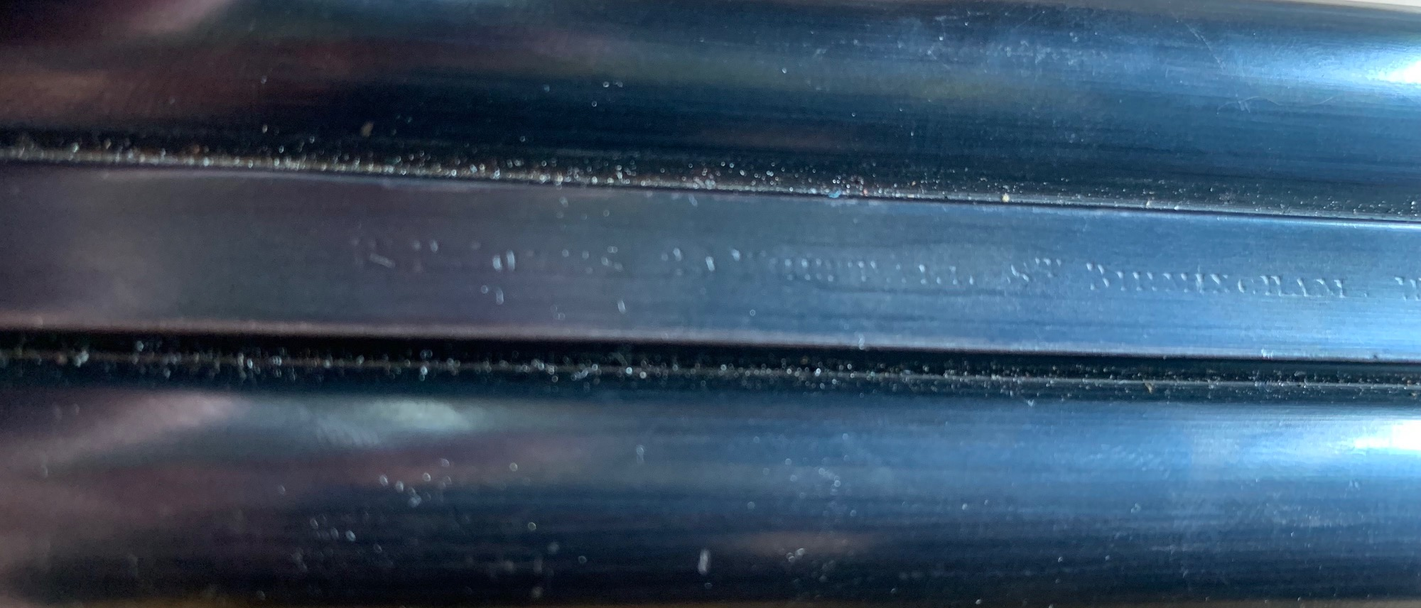

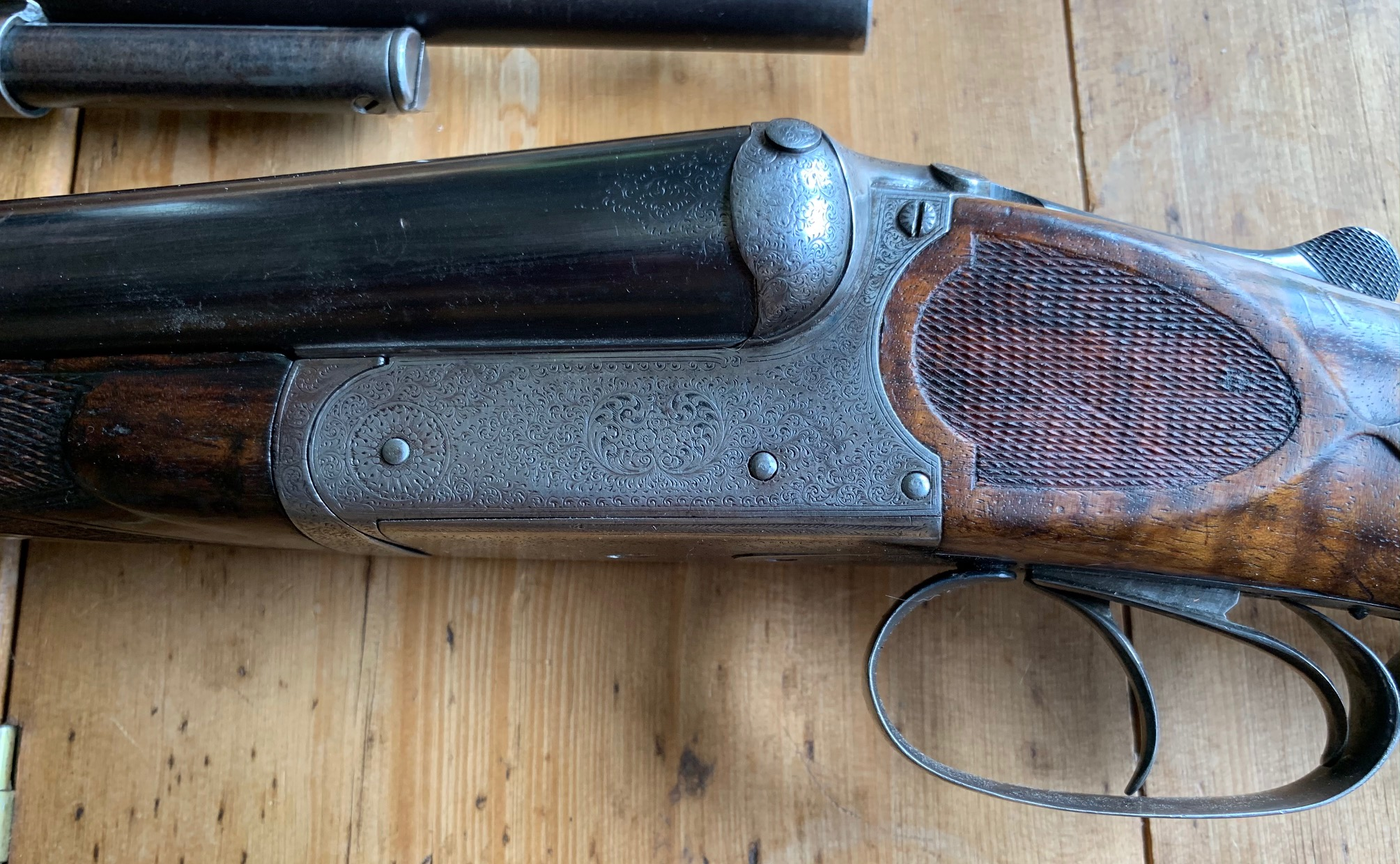

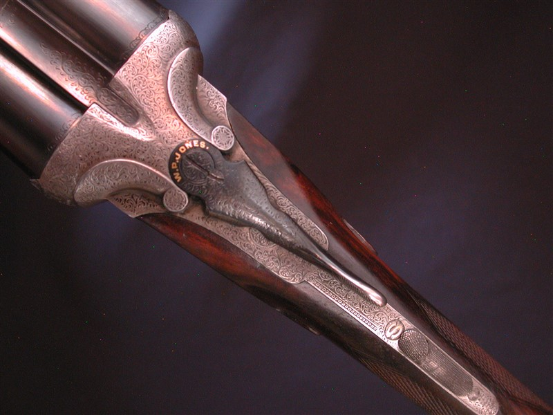

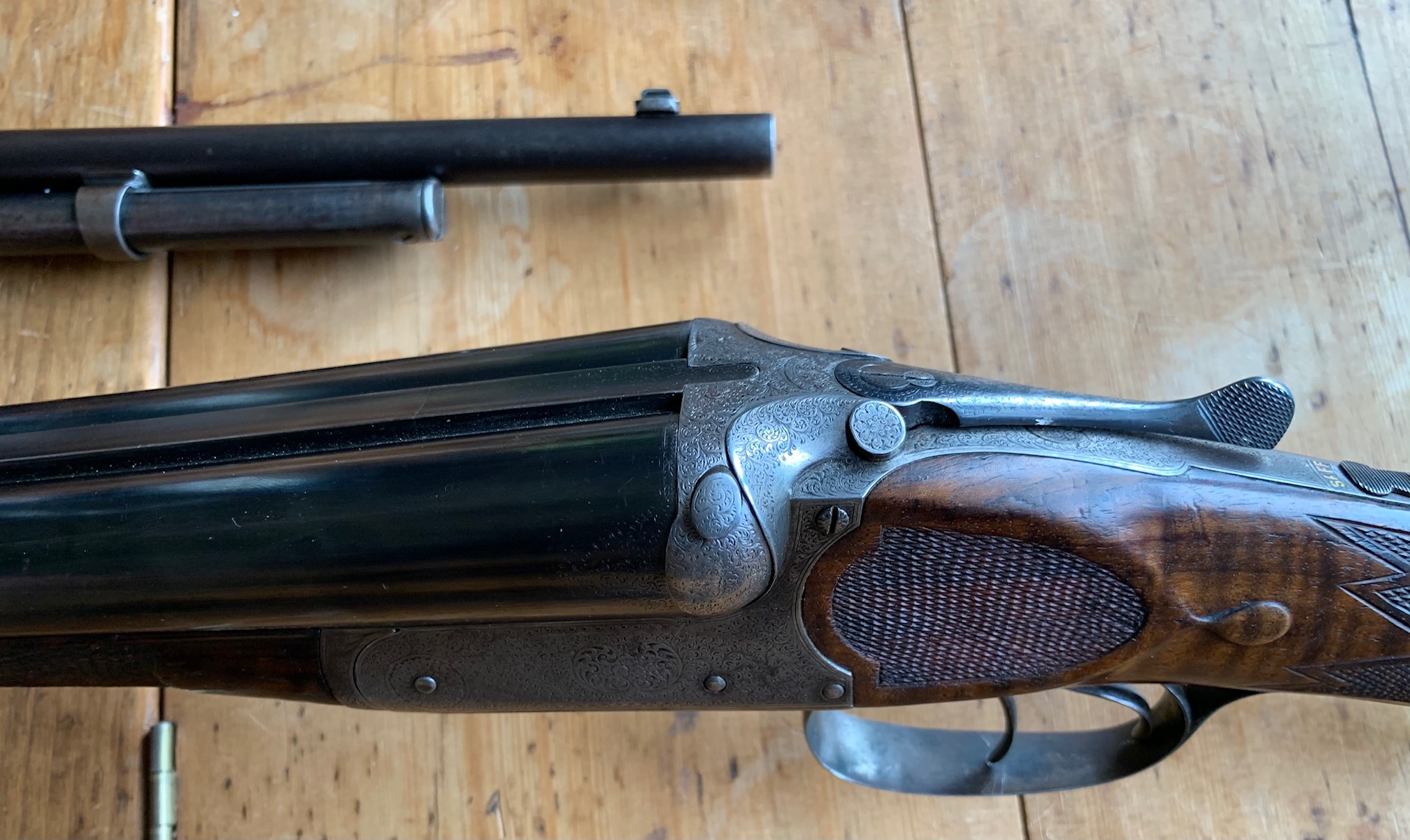

Here we go...
W.P. Jones, Birmingham.
WP JONES, BIRMINGHAM, BLE, 2 1/2", sleeved 28" choked IC/Full. 14 1/4" highly figured wood to unique, original horn butt plate. Art Deco style scalloped action has gone grey with clipped, carved fences with scroll carved top, third fastener and WP Jones inlaid in gold in a long slender top lever. The engraving on the bottom plate and trigger guard is quite soft and buffed overall. Drop checkered side panels with drop points accent the action/stock interface. The action and forend are noticeably diminutive and contribute very little to the weight of the gun. Very wieldy at 6lbs 2oz - the unique action and top drawer figure in the wood make this a fine specimen.
William P. Jones, was at 25 Whittall Street, Birmingham from 1891-1935. He was the son of William Jones, Gun & Riflemaker, 86 Litchfield Street, Birmingham (d.1828). Ribs say "Winner of Field Trials."

Could you get a shot of just the wrist and butt?

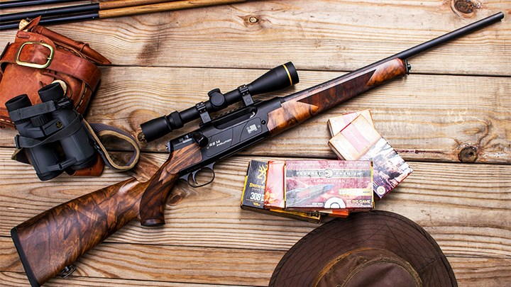

Added: This is a pic of a rifle in American Hunter. Even though it looks all marble cake claro, this is what Circassian Walnut looks like. Note the straight black lines from the back of the action through the wrist to to the butt. Where it then begins to look like Claro.

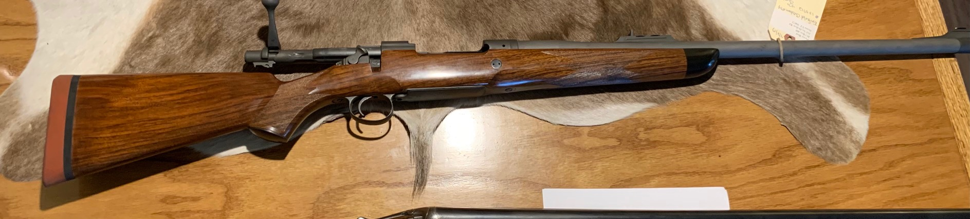

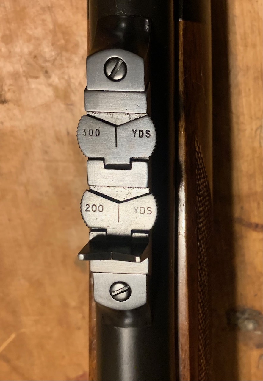

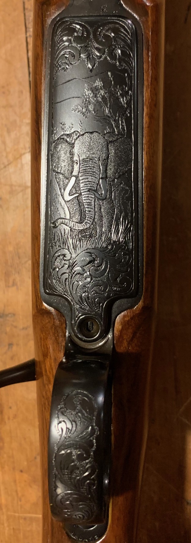

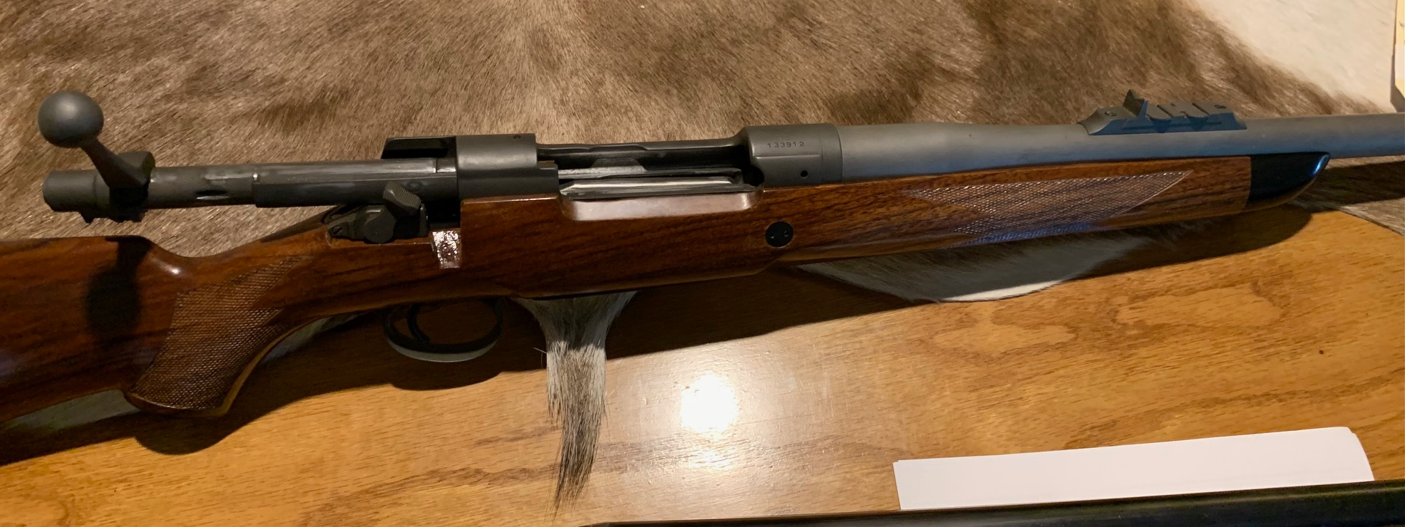

So 40 months after this adventure began... I picked up the finished rifle from Adams & Adams engravers... back from finishing at Turnbull! And all I can say is... this journey has been totally worth it! Scroll back to Page 1 and see what this started as! An incomplete $600 barreled action from Gunbroker... unknown maker (Turned out to be an Eddystone Remington Arsenal action). But the barrel and chambering work alone would have cost $600. So, what the heck. Oh and I blame @Son of Dorn because I was looking for a project rifle for him when I found this. Thanks Dorn!
Simple, but beautiful safari sight with pop-up blades. It's a .470 Capstick... a cannon. So no scope on this. Just an express sight.
Some mild engraving on the action top. Done by John Adams of Vershire, Vt. A master and a good friend. I try to always have 'something' in with him. Right now my 10mm.

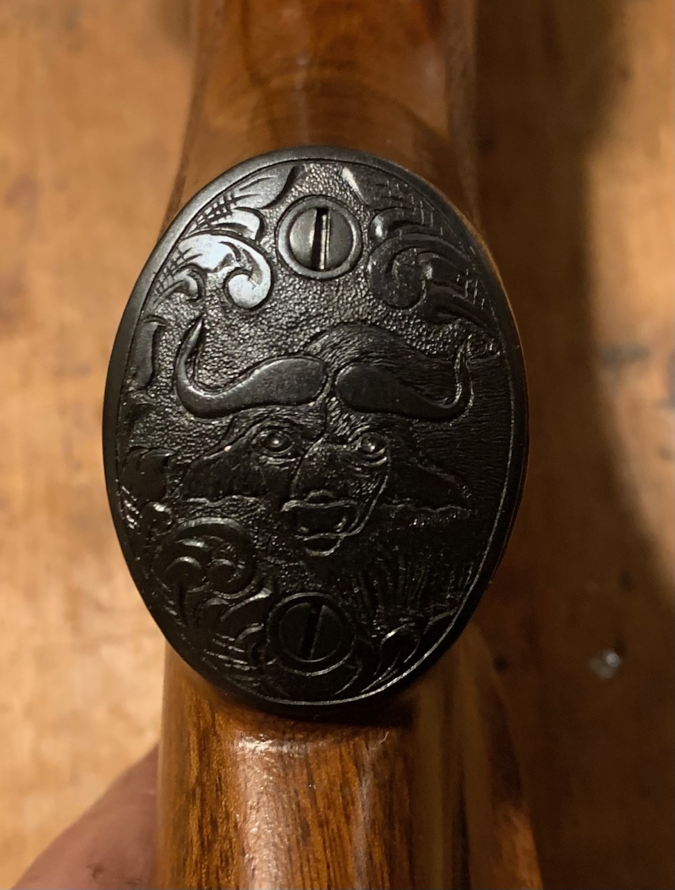

Grip cap (the whole rifle is in the style of Rigby) with M'Bogo on it. He doesn't look happy.
John had fun with the Hefalump! Much more intricate than I had thought he would do. I had sort of planned this build to be a 'working African Rifle...' but the sort of thing a successful and prosporous PH might have had. Not some 'client' showpiece. But a good working gun with a few 'personalizations' by its owner. But I think John Adams wanted to have some fun with this and did an amazing job. The elephant is incredible in the light and just has such a great personality! I think John just got in a groove and though it's more than I was looking for, I'm over the moon pleased with it!!! Wow!

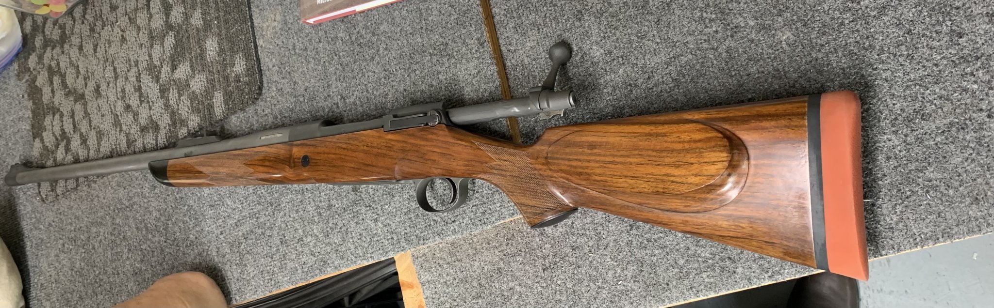

Here is the finished gun... cropped the barrel off because you can see it in earlier pictures. It's round and pointy. Anyhoo... as I mentioned, in the style of Rigby. I think the team out-Rigby'd Rigby to some extent!
Now that I have the gun back, I can finish the ammo. Some of the casings are older RCC and they are going to take a bit of work on my lathe to get them to chamber right with the boolits I have. But while lots of folks hated RCC, I loved working with them and 'finishing' my own ammo the way I wanted it. Too bad they went out of business (or are closed temporarily_.... because they fill a major need in the industry.
