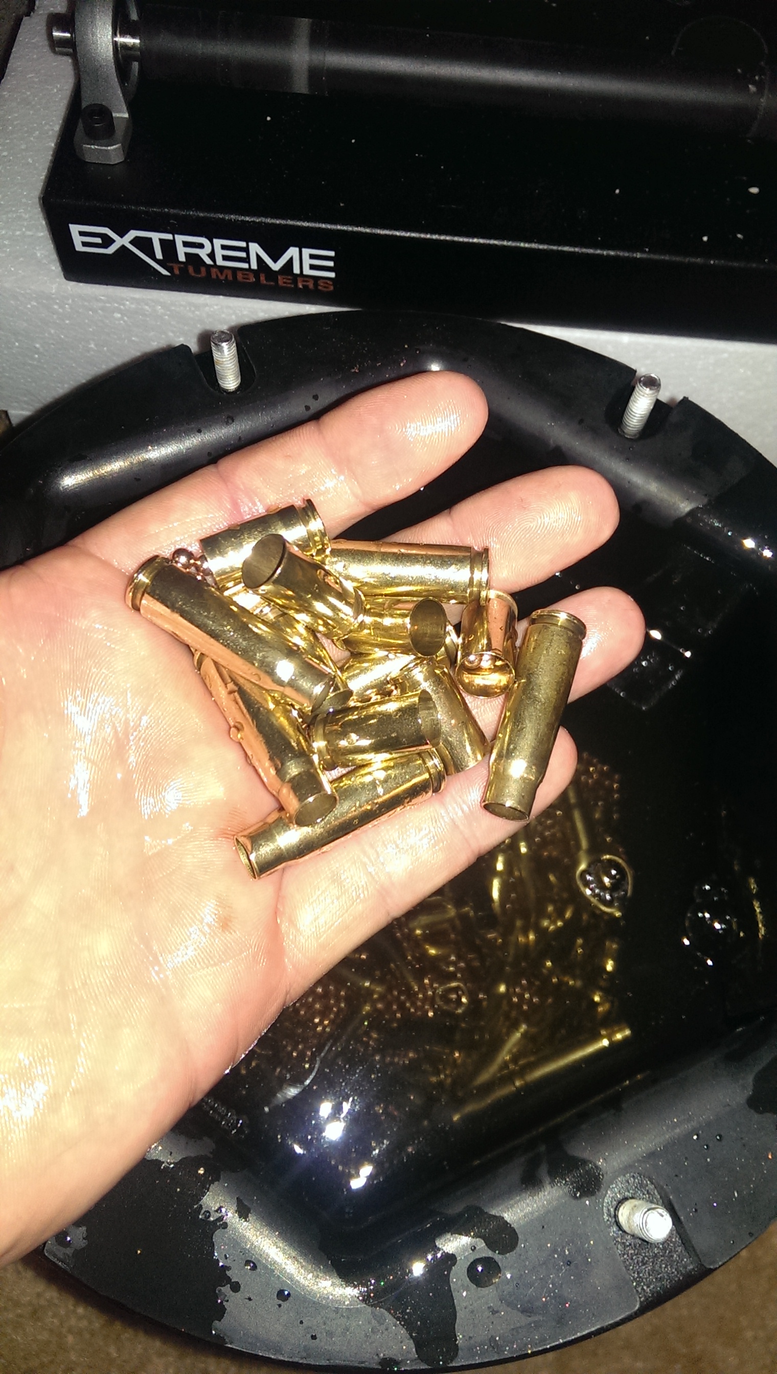

Well I ordered a Rebel 17 tumbler last week and received it a few days ago. Unfortunately, in my haste, I ordered just the tumbler, instead of the kit, complete with the Stainless pins. I called back and ordered the pins, which were supposed to arrive today, but seem to be lost in transit. So here I am, wanting to go shooting tomorrow afternoon, and have no way of cleaning my brass, or do I...
I took a short trip to my local walmart, and picked up the biggest container of .17 cal bbs that I could find. Just finished running some "test" brass (7.62 & .40) and I must say I'm impressed. The bbs do an excellent job, with the exception of the primer pockets. Have a look for yourself..
45 minutes of tumbling...
Not really to me, I run a uniforming tool through all of my rifle brass anyway...
Side note, I did notice that with the smaller 7.62x39 cases, the bb's get stuck inside as well. The pistol brass was no problem, but the bb's seemed to be wedged up in a few of the bottleneck cases. Tapping them with another case knocked them out pretty easily, but still somewhat of a bother.
Bottom line, brass is sparkly clean, just like with pins, and BBs are WAY cheaper! I'm actually considering running a blend of bb's and pins... wonder how that would turn out..
