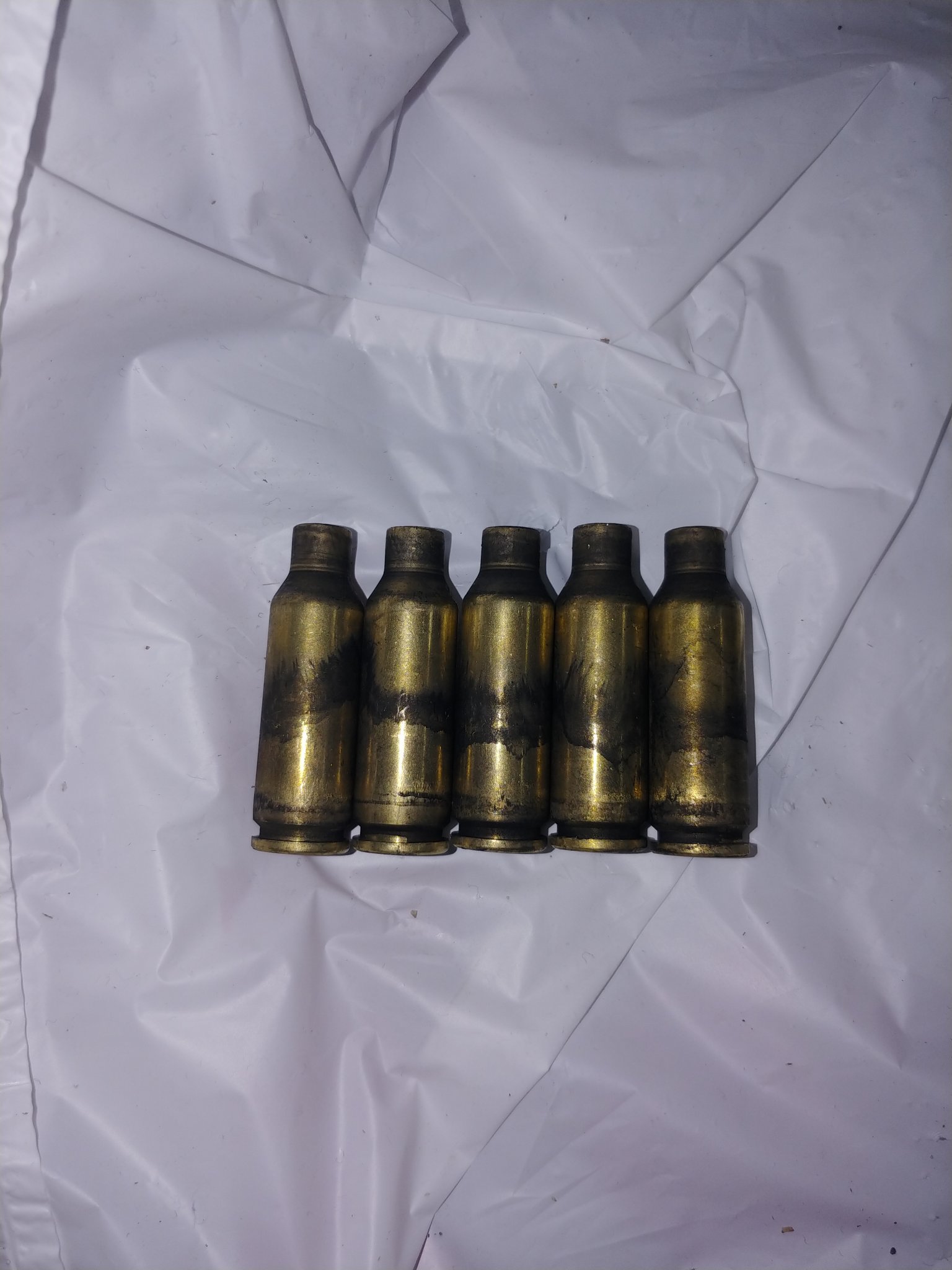

Suppressed 6ARC come out filthy, so wet tumble with pins/dawn/lemishine, rinse with distilled water, air dry, anneal then lube/size/decap/mandrel and then ultrasonic, or if I have a lot of cases I'll use the vibratory and compressed air afterwards.
Before and after;
OK, I'll play.
As with most of this stuff...it depends.
Unsupressed or bolt I'll anneal then lube/size/decap/mandrel then in the Chicom ultrasonic cleaner with distilled water and Creedmoor Sports Brass Cleaning Solution, rinse with distilled water and air dry, (I'm in AZ, it don't take long). Then they're ready for primer/powder/bullet.
View attachment 8128612Before and after;View attachment 8128611
Perfect example of , "whatever works for you" . Sometimes the cleaning process needs a boost .

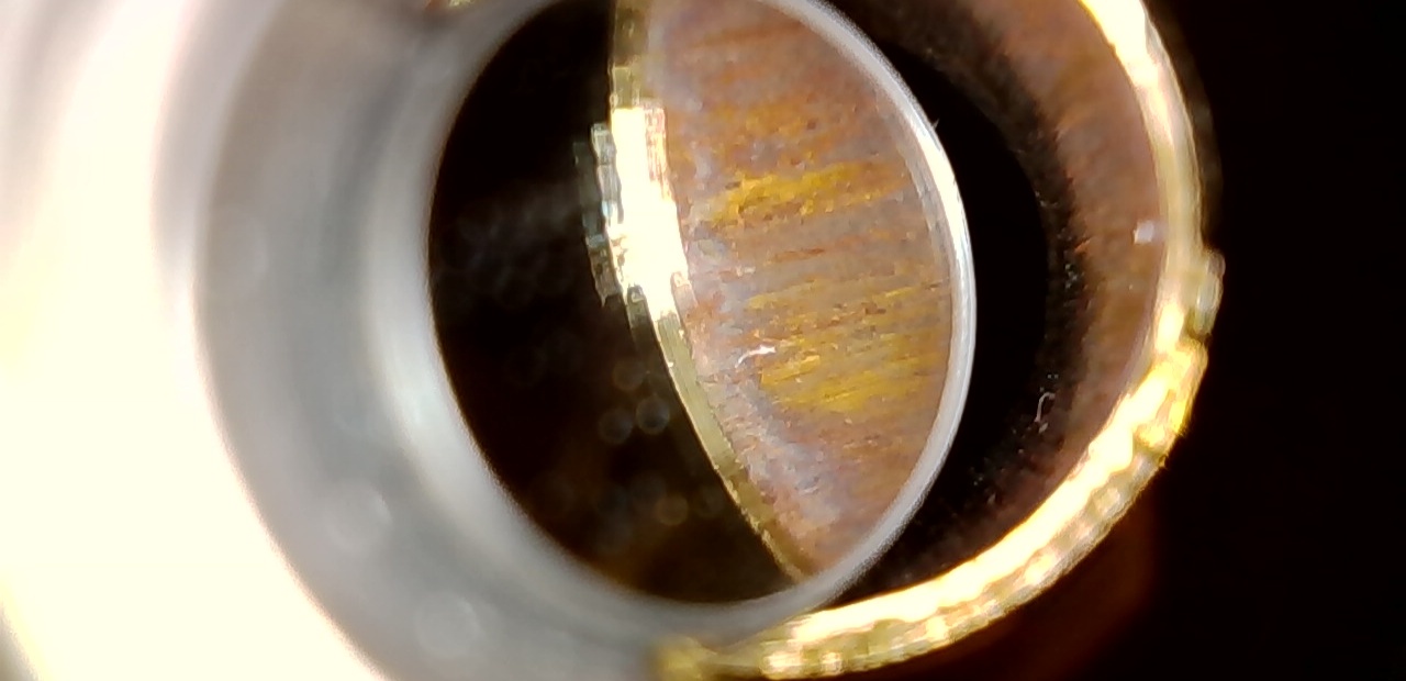

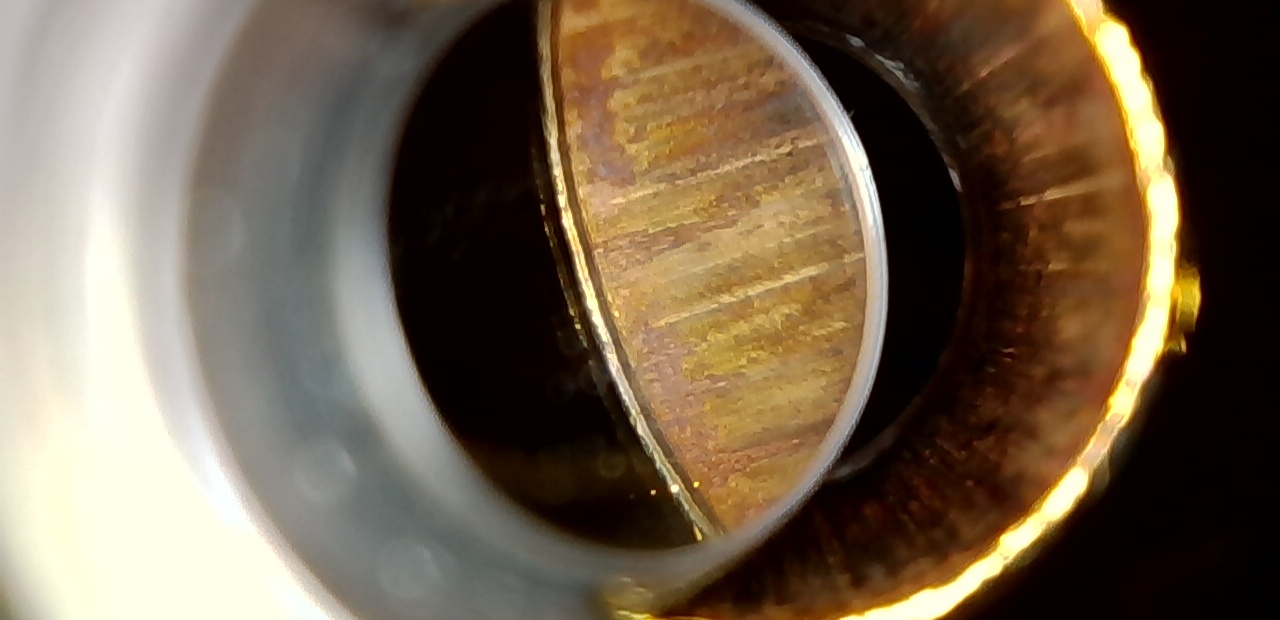

I've been wet tumbling without pins. Water, lemonishine and dish soap. 20 mins in the tumbler gets the brass clean enough for me.
However, it does bother me that even 20 minutes peens the edge of the case neck inward. Trimming that off removes more material than would be needed if not for the peening. Also it becomes critical to make sure you have a very good chamfer on the inside of the brass or seating problems will occur. And that's happened to me when I wore out my trimmer blade and didn't catch it quickly.
Im considering trying an ultrasonic next or even cutting back cleaning to only wiping off the outside of cases and hold off on tumbling until a few firings.
Heres a case after 20 min in the tumbler.
And this is after trimming.
