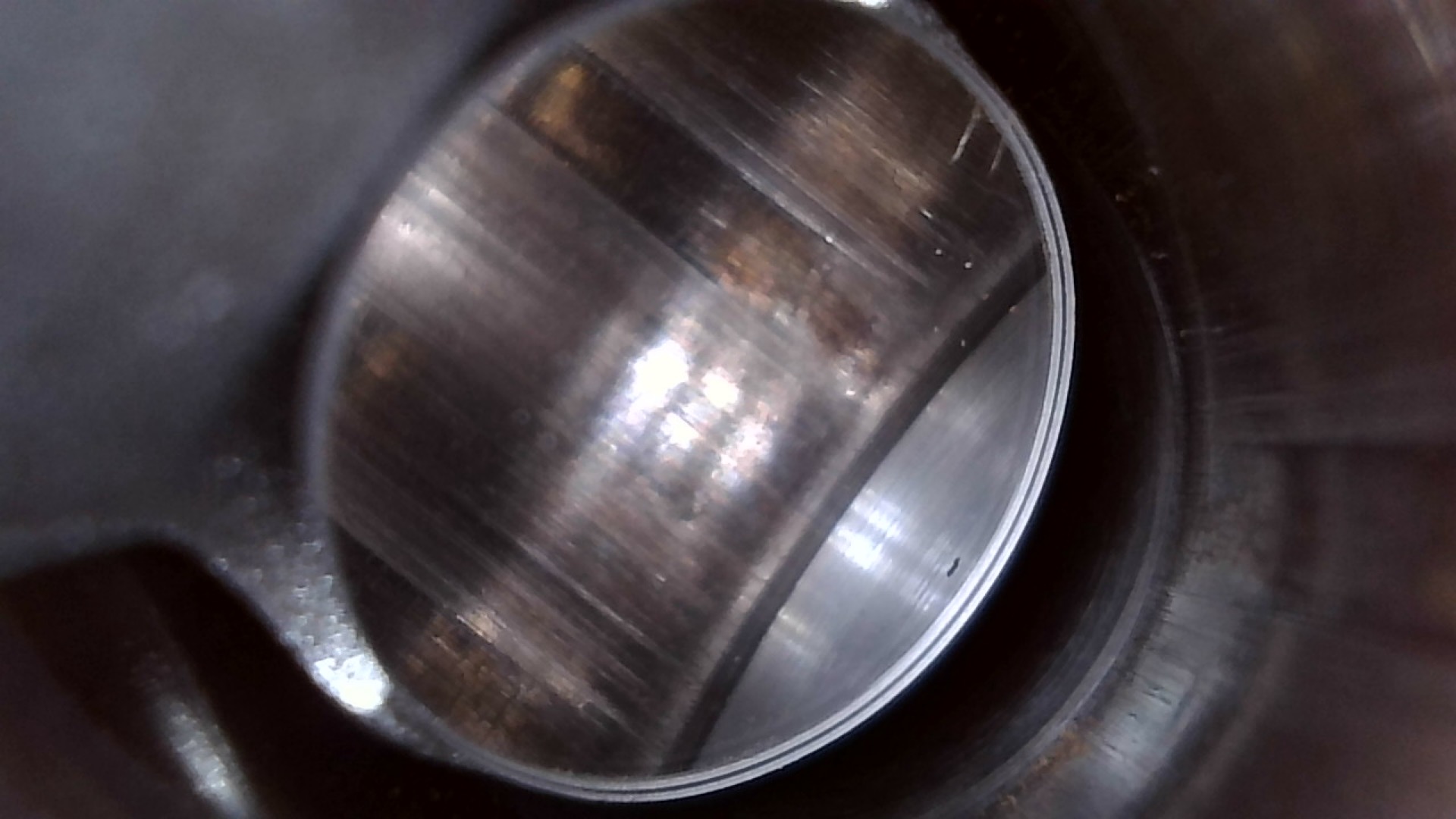

It's hilarious people think boretech is effective because patches come out clean.
Then you borescope the tube and see about 10-15 inches of hard carbon from the chamber.
Take your "clean" barrel and use a real solvent with mechanical scrubbing and all of a sudden patch looks like you ran it through a coal miners ass crack.
Ignorance is bliss.

Before I had a bore scope.
One season using Boretech C4 and Eliminator with bronze brushes, 1000 rounds on a 30 BR Kreiger.
After match, swab, brush, swab with C4. Soak for 24-36hrs.
Repeat same routine with Eliminator. Patches said bore was clean, patches lied. Result.
Threw the kitchen sink of cleaning products at this mess over several days, finally resorted to Iosso to get it back to bare metal.
Had a barrel that saw virtually nothing but Wipeout bore cleaner and nylon brushes, it was in even worse shape.
Best solvent I’ve used for short term cleaning is Montana Extreme Copper Killer. Use it between relays, and immediately after match. When I get home I break out the Thorroclean, 30-50 short strokes with a tight fitting patch from just in front of the leade to a couple inches down the bore where the heavy carbon is. Flush the Thorroclean out, dry patch until clean patches come out. Borescope to verify cleanliness.

The other thing is in 2025 when you can get a bore scope that will show you everything in your barrel for $100 or less there's no reason not to own one. We're spending $1000 on bipods, $4000 on optics, thousands on a rifle, $1000 on barrels and $600 on chronos the list goes on, but not $100 on a tool that will really tell you what is going on inside your barrel.
Probably because there's many ways to skin a cat, and it suggests that for many shooters having a rifle that's possibly not "clean to the metal" isn't impacting their guns performance enough to matter (to them), or question if something is wrong with their rifles. Given the hide probably has a large concentration of guys that can shoot with precision gear (granted not in the benchrest world level) it would suggest that for the majority of hide users, most cleaning practices.......are working pretty well. It's kind of like lubes, you'll see guys swear by 50 different lubes which again says to me that as long as you use it, and apply it right, it's probably going to work fine. Even though some might work better than others, it's not enough to make enough difference for most people to notice, and it's certainly not ruining guns. If it was, over the years everyone would be using the same stuff, because everything else would ruin stuff.
If you watch Frank Green and Eric C's podcast they talk about cleaning, and they both use very different methods (everyone should the info in there is gold). Frank's seems to be much less harsh (#9, 40x, no brushes, etc.) and Eric is clearly using some harsher stuff like CLR, Lasso etc. Those methods are pretty heavily at opposite ends of the spectrum, but both are clearly getting good results without barrel damage. They also both clearly are not in the camp of not cleaning the barrels for long periods of time. For awhile I think we often heard so much stuff about how overcleaning kills barrels, that we've made a whole group of shooters that never clean them, or use nothing but a bore snake. Both of them clearly are not in the camp of shooting till the accuracy falls off, because by that time there's so much junk in the barrel, you either have to use drastic measures to get it out, or when you do clean it, the gun will only shoot really well for 20-30 rounds and drops off again cause it's still 95% too fowled to perform when you started and those 20-30 rounds are all it takes to push it too far again.
Interesting take. Appreciate the dialog. Will watch that video later on.
any suggestions on a borescope? I never grabbed one because it seems like Hawkeye was the goto but expensive...
Hey I know that guy! LOL!
Again guys there are 10 different ways to skin this cat. If you have a system/method you use and your getting the barrel cleaning/maintaining the system... then that doesn't mean the guy on the line next to you is doing it better. Could be doing it worse.
As long as your not wrecking the stick... I've got nothing to say.
Not cleaning at all though? That's not an option. You will get to a point and it's depending on caliber... where you get to a point of no return. You lose the accuracy due to carbon or copper fouling build up and or both... than a normal cleaning session isn't going to possibly bring it back. Why let it get to that point?
I commented about a month or two ago... we are rebuilding a local PD's rifles (not the guns with the messed barrel installs we've been fixing) and when they brought us the first group of 5 they asked if we could look at one rifle in particular. I said, "Sure. What's up? Most of the guns they told me shoot around 1-1.5moa. All of them had Obermeyer sticks on them. So I looked at the first one and said, "I don't see anything really wrong with it other than it needs a good cleaning." Also my comment to them was... I guessed the barrel had 1500 not more than 2500 rounds on it. I told them I'd bet any of them my next paycheck that if I cleaned it good the accuracy would come right back.
So I asked, "How and what are you guys cleaning with?" They said, and I quote... "We don't clean at all! We're not allowed to by the previous guy in charge. Only allowed to run a oiled patch down the bore if they got caught out in the rain." All I could do was shake my head!
So the barrels had been on the guns for a good 10 years + with no cleaning other than a oiled patch down the bore once in a while.
So we got into cleaning and the whole cold bore/accuracy stuff.
Later, Frank
Bartlein Barrels
