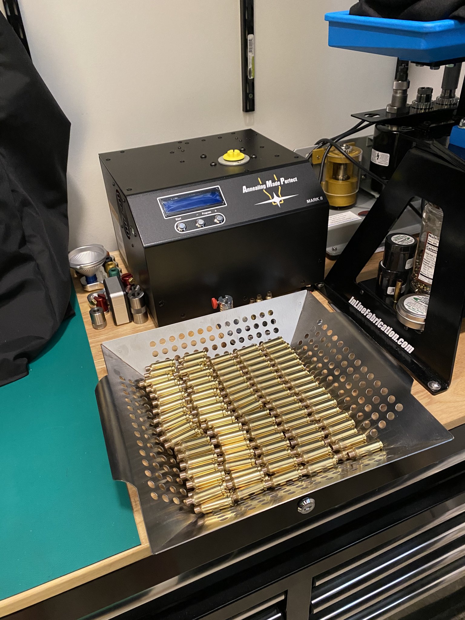

I finally got all of my precision and finalizing work inside, pretty happy with it. Not being in the garage the temperature is now controlled inside and the A&D FX120i responds much better now. Not to mention the dust has cut down drastically. It's also nice being warm in the winter, that little buddy heater could only do so much.

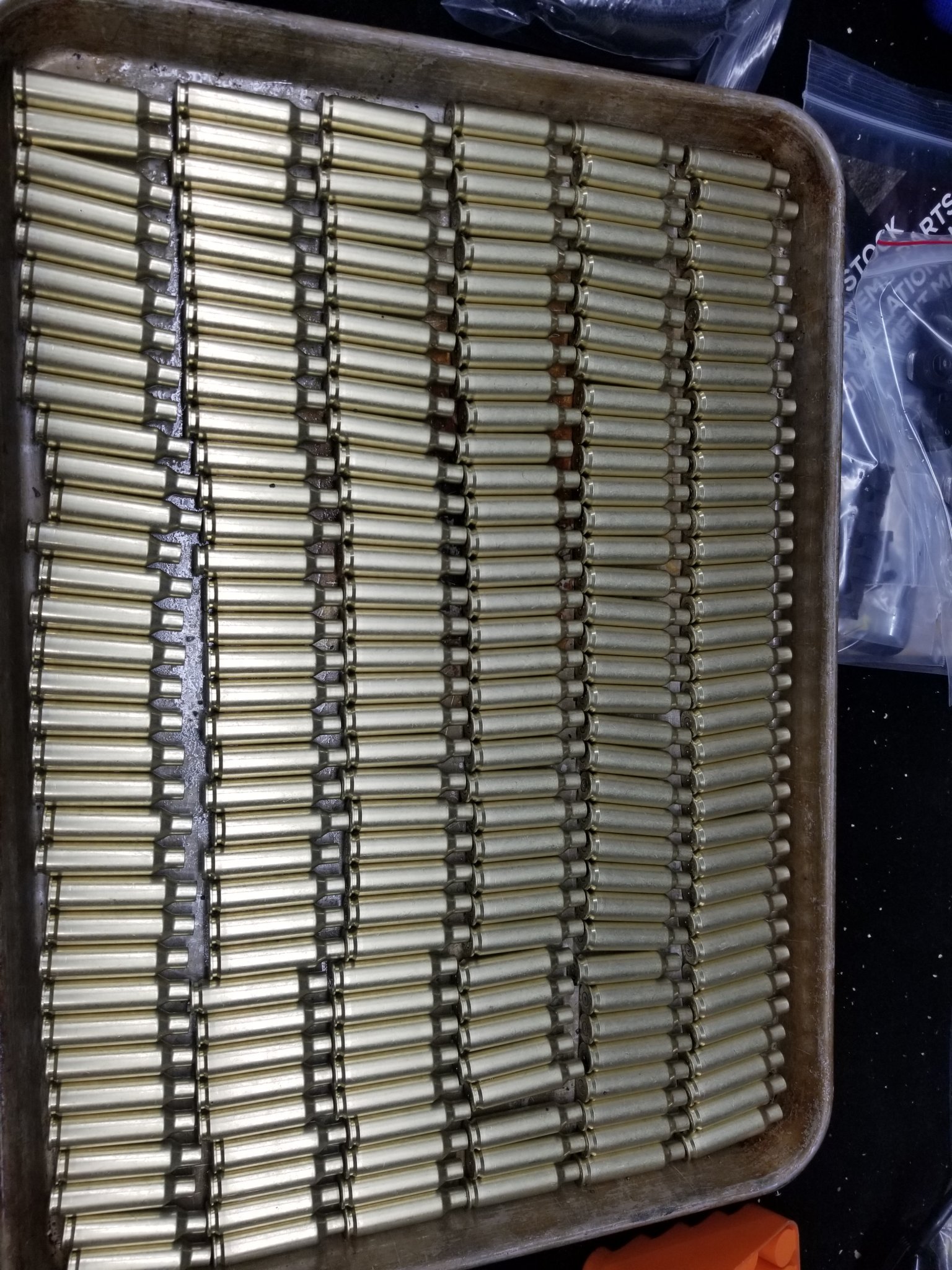

    de primed 400 rounds by hand lol and cleaned the primer pockets again by hand but only 3100 left to go god help me lol
    can see i am going to have to automate at least this part as soon as I can .

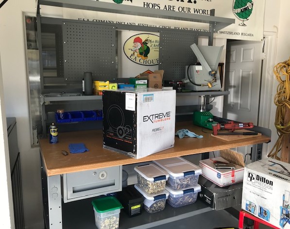

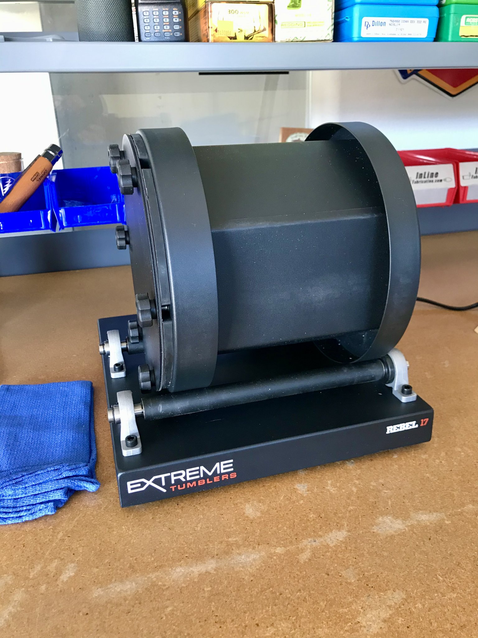

    Continuing to get the new reloading space set up. My wife bought a tumbler for me that showed up yesterday so I'll be setting that up this weekend and get started on some brass prep. Spent a lot of time reading the debate over wet vs. dry tumbling and decided to start with a wet tumbler. I've been slowly accumulating tools and equipment to upgrade (several items from the PX here) and scored the bench from a friend show was making some changes at his business. Its a U-Line packaging table so has a lot of bolt-ons available.
    I added a second shelf on the back last weekend - still need to adjust things and I'll likely lower the top shelf a bit. Also considering the light kit that has arm and an LED fixture that mounts to the top of the uprights on the back of the bench. Not sure what I'll do with the pegboard as I prefer tools put away in a tool chest. I'm waiting on a quick change mount from Inline for the new Dillon 750 and my old single stage. Looking forward to getting the presses mounted so I can get going. Its in the garage so I'll still store powder and a lot of other things inside where the temp is more stable.

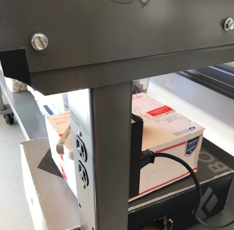

    I also added an optional extension outlet. The legs are pre-punched for outlets. I was pleasantly surprised that it had outlet on both side of the box and a switch on the back to shut off the outlet. I might get another one.
    That’s an awesome bench!

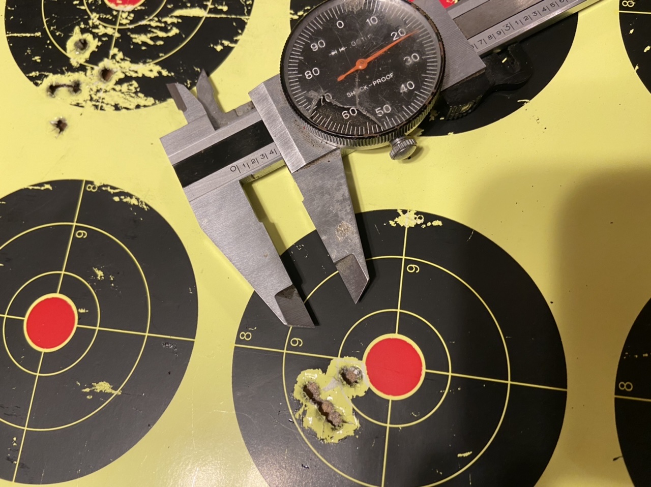

    The 223 77gn seconds I got from midway have a giant BTO variance so sorting 1k of them out. Getting extreme spreads of .040

    It’s more about them not fitting inside of the mag if I seated them all to the same length. Found 150 that were .020-.030 longer than normal. with those 77s you need to seat them as long as you can.
    and I do use that AR and those loads in a more precision type roll. I got em to shoot pretty well. And the gun does get shot out to 500-600 yards a lot.
    23.6gn imr 8208 xbr with those 77gn factory seconds463F3F40-CB2A-4A3E-8CAB-0EDEFA20293D.jpeg
