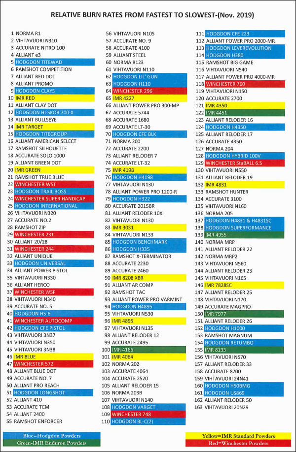

First of it I have got.
Reportably not as good as varget but very close in burn chart.
Supposedly a reasonable varget replacement for some calibers.
(223, 6.5g, 308)
Just be careful it's 21 powders up on the burn chart from varget. Closer to IMR 8208 XBR burn rate.

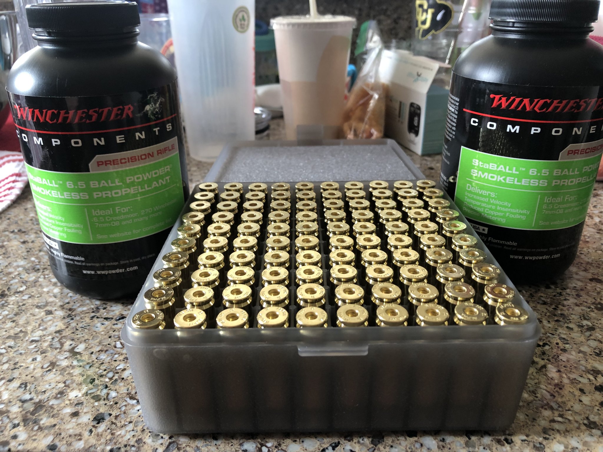

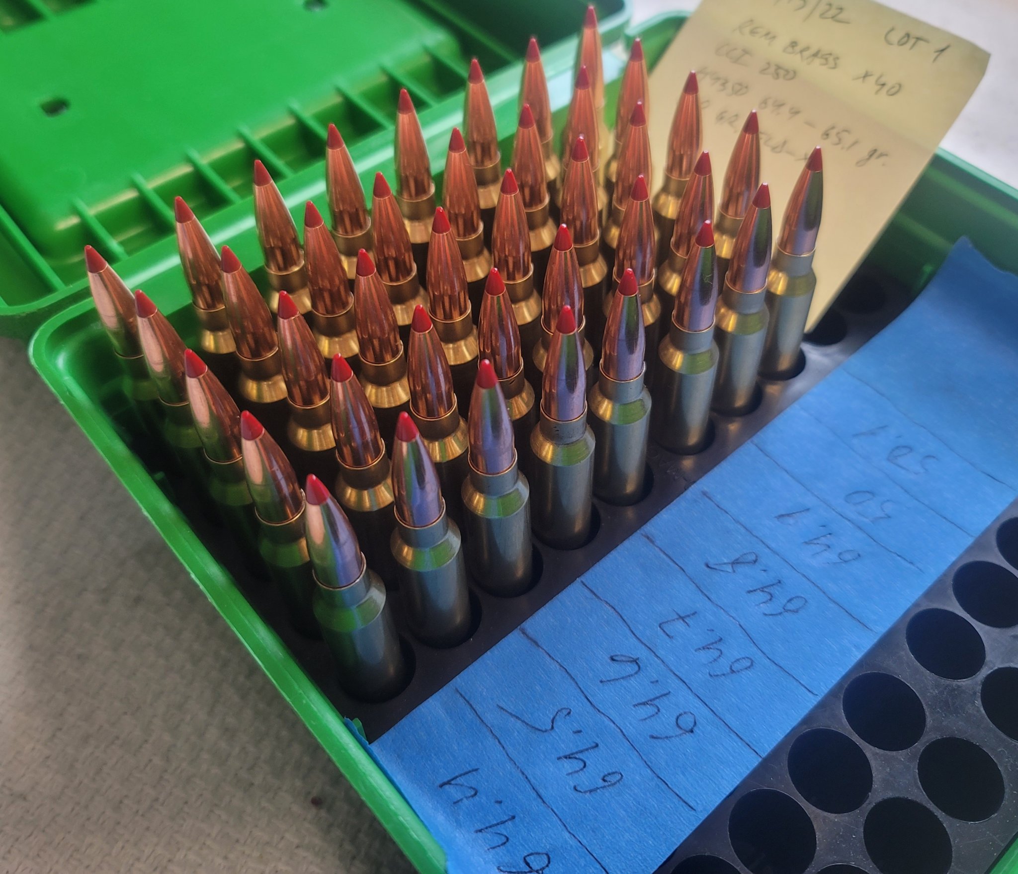

Well yesterday, I primed charged and loaded 40 Lapua 6.5 CM cases. I was using the charge that provided good velocity and great accuracy for the Norma 130 grain Golden bullets. So, we will see how they work out. These were once fired cases and no issues was noted Except for one case. It had a fairly serious burr on the outside of the neck. I grabbed a file a file and smoothed it out. Where it would get a burr, I have no ideal. The rest of the loading pricess went very smoothly.
Today Brenda Lea reminded me she wanted some more .38 special rounds loaded. So, I was piddling around in the loading room, getting cases in the cleaner. Since I was cleaning some, I though I would check around to see if other cases needed to be cleaned and prepped. I checkouted out several boxes of fired rounds and came across an unmarked box of of 6.5 Creedmoor Cases. They were Hornady cases, all marked 6.5 Creedmoor. So, I pulled one to see if they already had a pass through the cleaner. Looking at it, it just did not look right. I pulled another case and the case neck just seemed wider on the second case. I looked in the mouth and sure enough, the first case I pulled was necked to 6MM.
Now I ask, what are the odds, that the very first case I pulled was not a 6.5 case? 50 -1? More than 50-1? As I said, it was labeled 6.5.
Caveat, since these were range pickup cases, all had been fired, This is not a factory error.
Wow my bad, mind was thinking varget for some reason.
Absolutely closer to xbr 8208. That my 6.5g likes.
Can't even remember what I was thinking for the varget now?

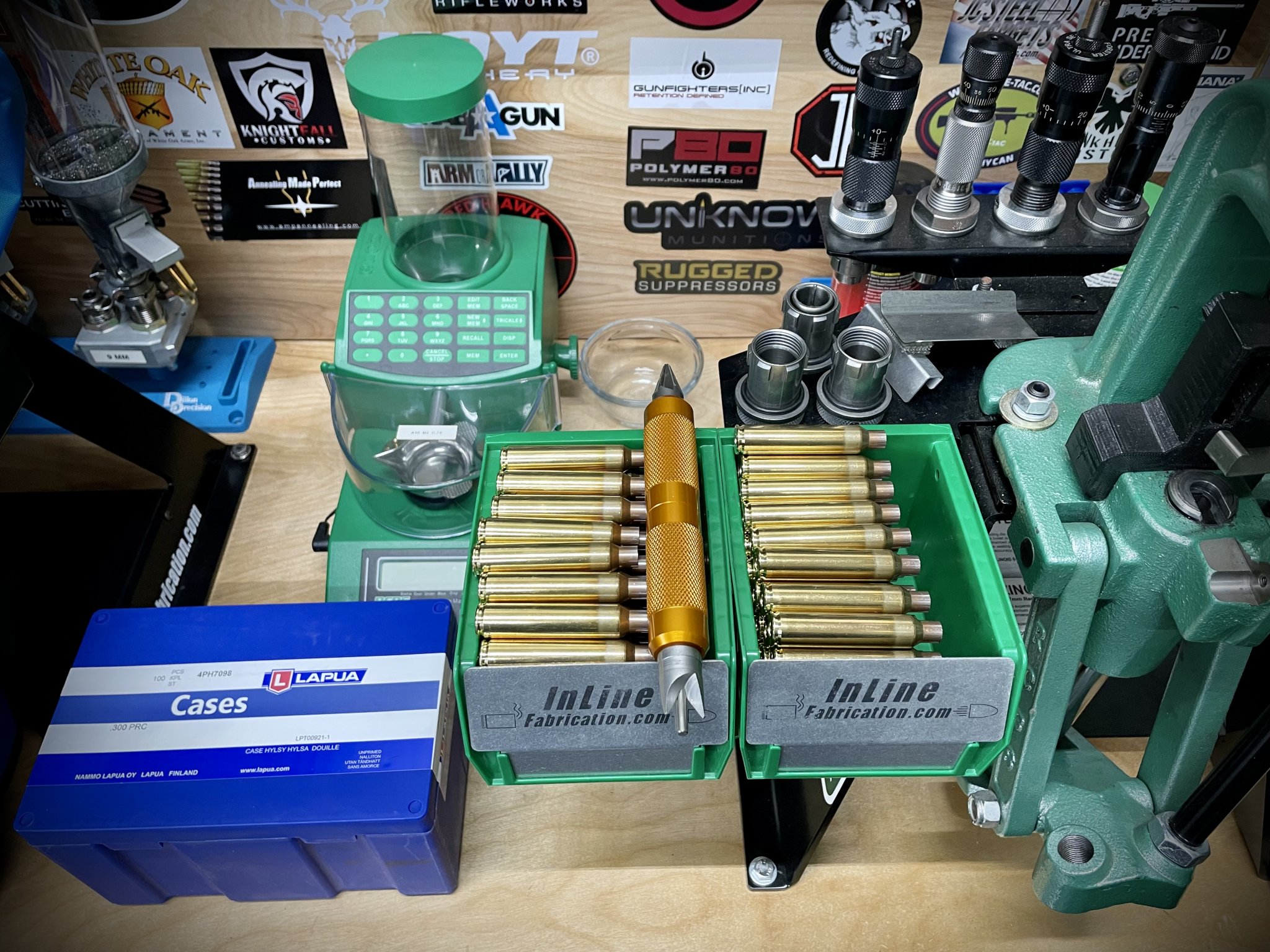

Just false shouldered 300 pieces of BR for the new dasher barrel.

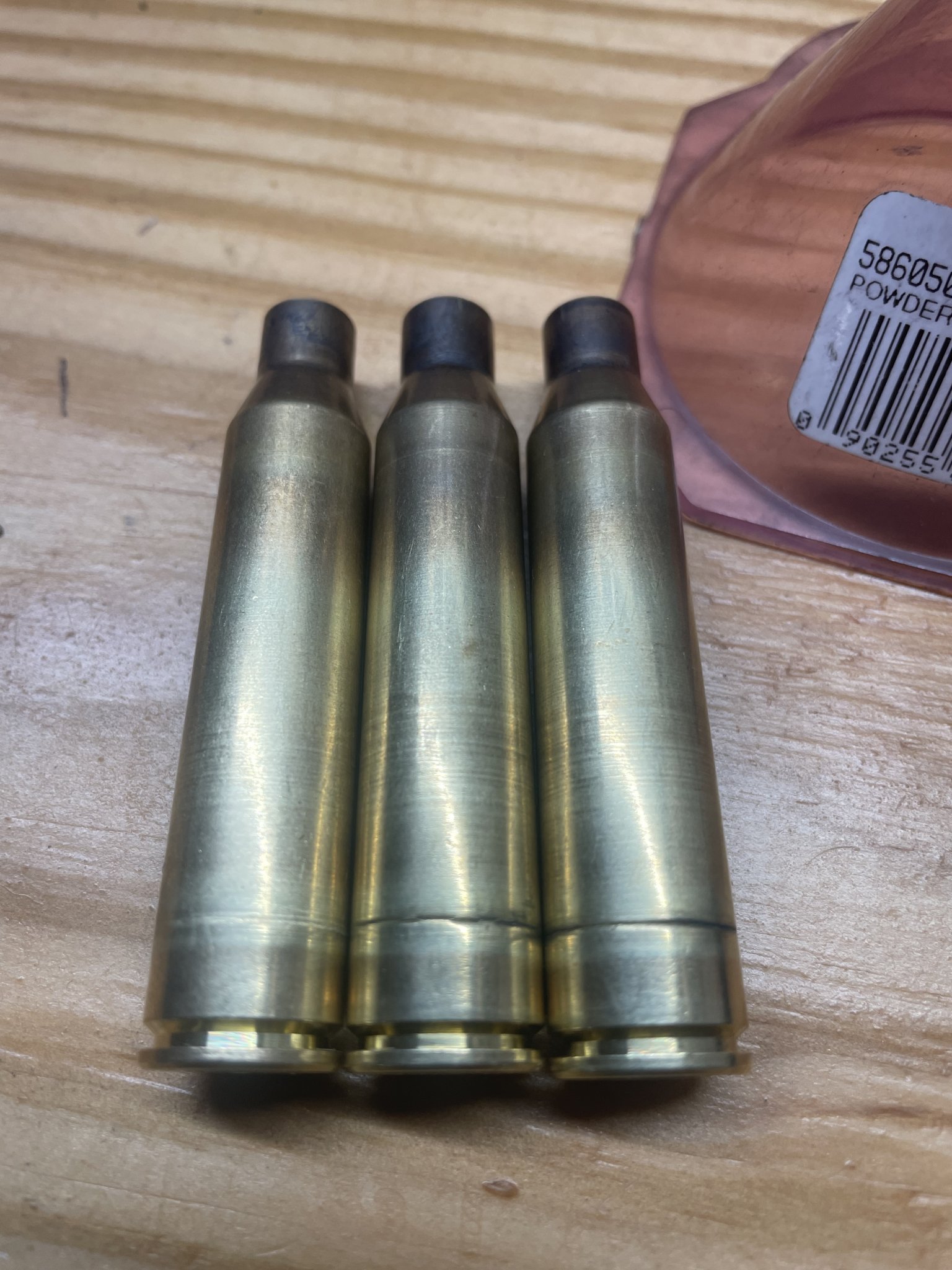

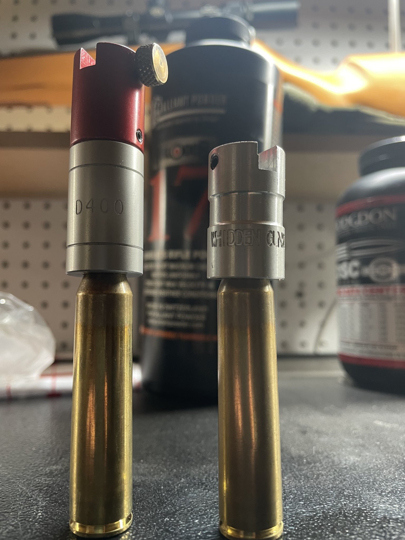

I over sized 22 pieces of 338 lapua brass.
My lock ring worked loose and I measured shoulders with a Hornady headspace gauge forgetting I have a Whidden shoulder bump gauge. I bumped them back per my notes. Ended up being about 8-10 thousandths bump once I checked with my whidden.
I fixed my very expensive fuck up.
My lock ring worked loose and I measured shoulders with a Hornady headspace gauge forgetting I have a Whidden shoulder bump gauge. I bumped them back per my notes. Ended up being about 8 thousandths bump once I checked with my whidden.
I don't totally follow, can you explain?
My die lock ring loosened up. I noticed it when my rounds were hard to chamber, so I checked my notes and set it back up with the measurements I had written down.
I used a Hornady headspace gauge to measure the shoulder bump, but my original measurements were used with a whidden shoulder bump gauge that I totally forgot about using, mainly because I haven’t used it in 5 years. The Hornady gauge measures on a different spot on the shoulder than the whidden. So I ended up bumping the shoulders a lot farther than I wanted. As you can see, I found the problem at the range yesterday. I stopped after those three and now going to pull the rest of the ammo and scrap the brass.
Reactions: Snuby642
I used a Hornady headspace gauge to measure the shoulder bump, but my original measurements were used with a whidden shoulder bump gauge that I totally forgot about using, mainly because I haven’t used it in 5 years. The Hornady gauge measures on a different spot on the shoulder than the whidden. So I ended up bumping the shoulders a lot farther than I wanted. As you can see, I found the problem at the range yesterday. I stopped after those three and now going to pull the rest of the ammo and scrap the brass. View attachment 7840048
I think you are using the wrong gauge for a 338 LM, Hornady doesn't list a gauge for 338 LM and that gauge is sitting too high on the shoulder.
Yes, I know. My assumption and my bad memory screwed me big time.
I picked the biggest gauge I had and assumed that’s what I used to measure them. It was all screwed up. I figured it out when I was looking for a bigger gauge and I stumbled across my whidden gauge, then a lightbulb went off and I instantly said, what a dumbass no wonder I fucked it all up. I’m glad I found the whidden because afterwards I knew the problem and it wasn’t something I was going to have to chase my tail over.
Assuming and bad memory cost me about 70$ in brass. Lol

Pull the bullets and seat them to a light jam.
Fire them and the shoulder will move forward safely.
You can also neck them up and then back down, creating a false shoulder. It will accomplish the same thing.

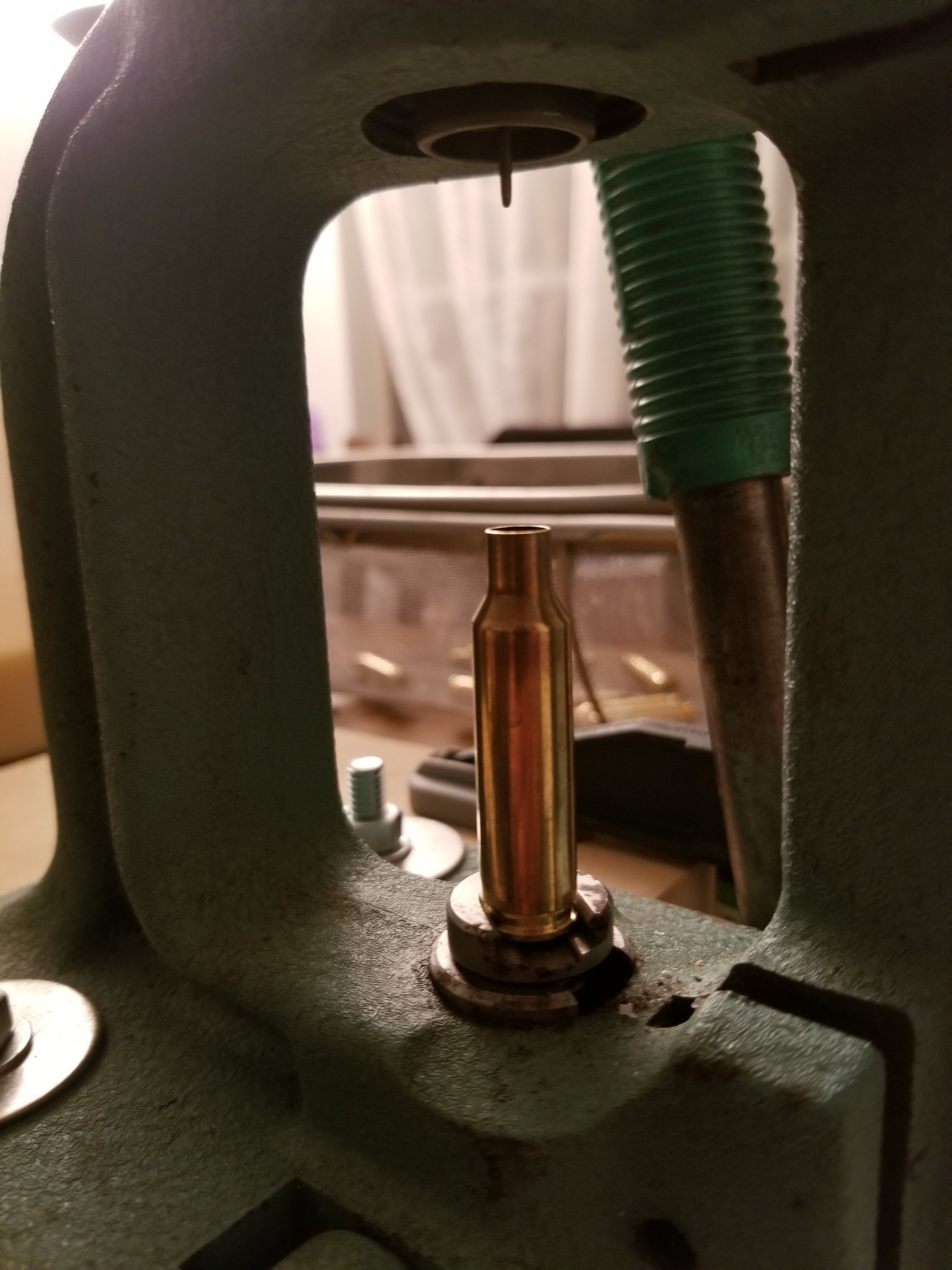

Scrubbed the absolute dog shit out of my dasher barrel, soaking it now, took 200 ish pieces of brass out of the tumbler and got them ready to anneal, broke down and boxed up the AI to send to FL for a make over, and organized some powder I just received yesterday and today.

About the shoulder bump and the case head separations above - this is what I though you meant, but I'm surprised that setting them back too far led to case head separation on the next firing. WOW! I'm storing that away in memory.
Reactions: Gohring65
You got to put it all in perspective. Depending on your chamber, you got the initial stretch from your first firing from new, then three other firings after that, I set up initially with .002” set back and they grow slightly each time. Then I set them back 8-10 thousandths and shot a full house load of h1000 and that stretched them back to my chamber spec. So a combination of mutable firings with two big stretch firings one when new and one after a few case trimmings.

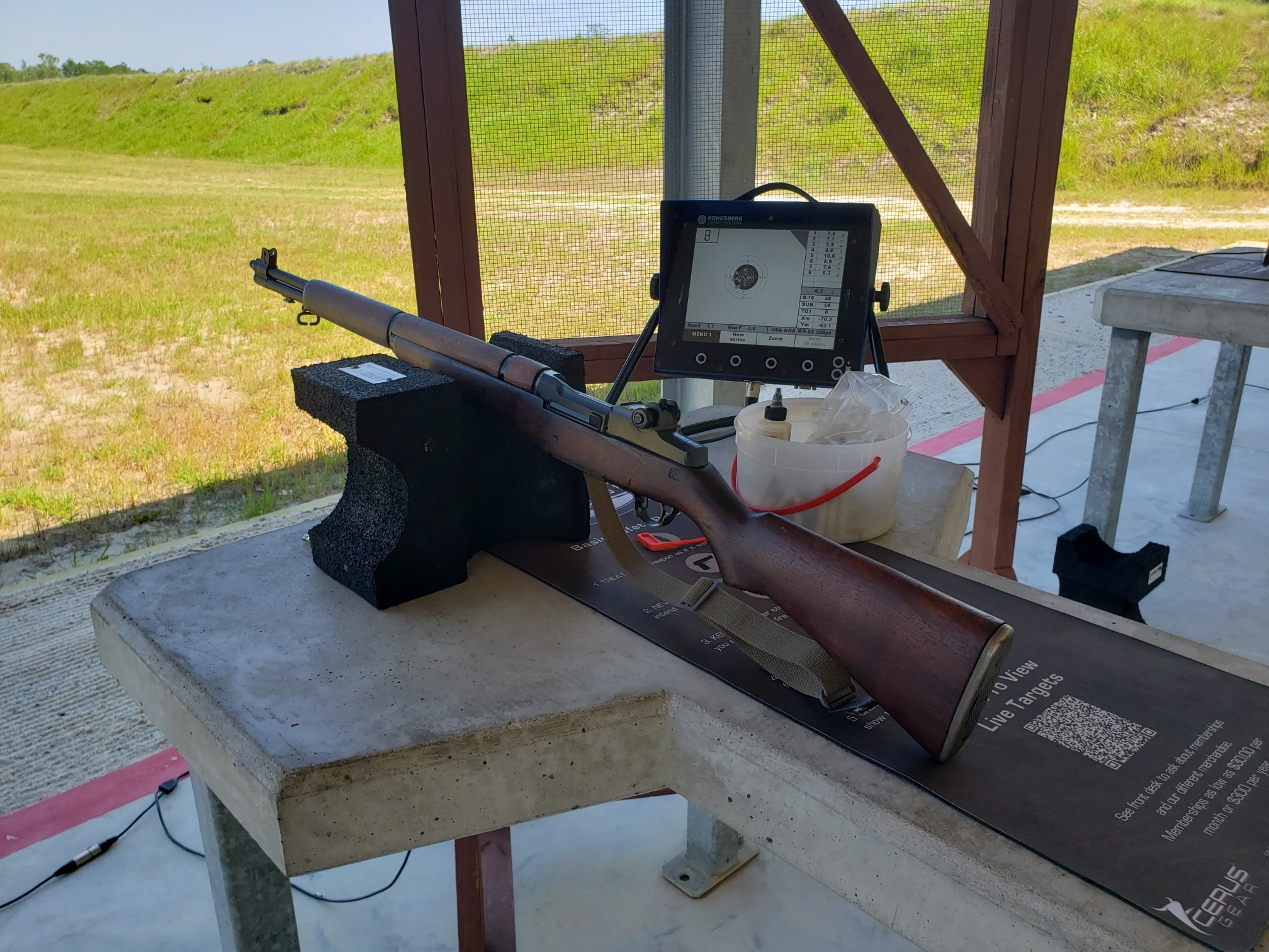

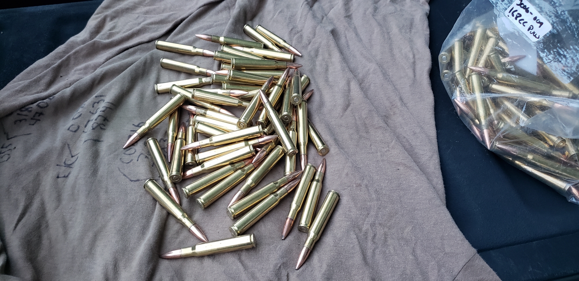

Continuing my run of 30.06 for the GIs. Have used up the reclaimed components and moved into the stockpile. Measured all 1000pcs of 1x brass and been loading as I went. Have loaded 3-400 and shot close to 100.
Range only goes to 200 but it's the only show in town.
The M1 Garand is Still one of my most favorite Rifles to shoot.
In the early 70s my dad and I had a boat docked at the NJ Shore and I kept an M1 on the boat. I had it Armoloyed to stop rust.

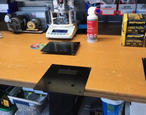

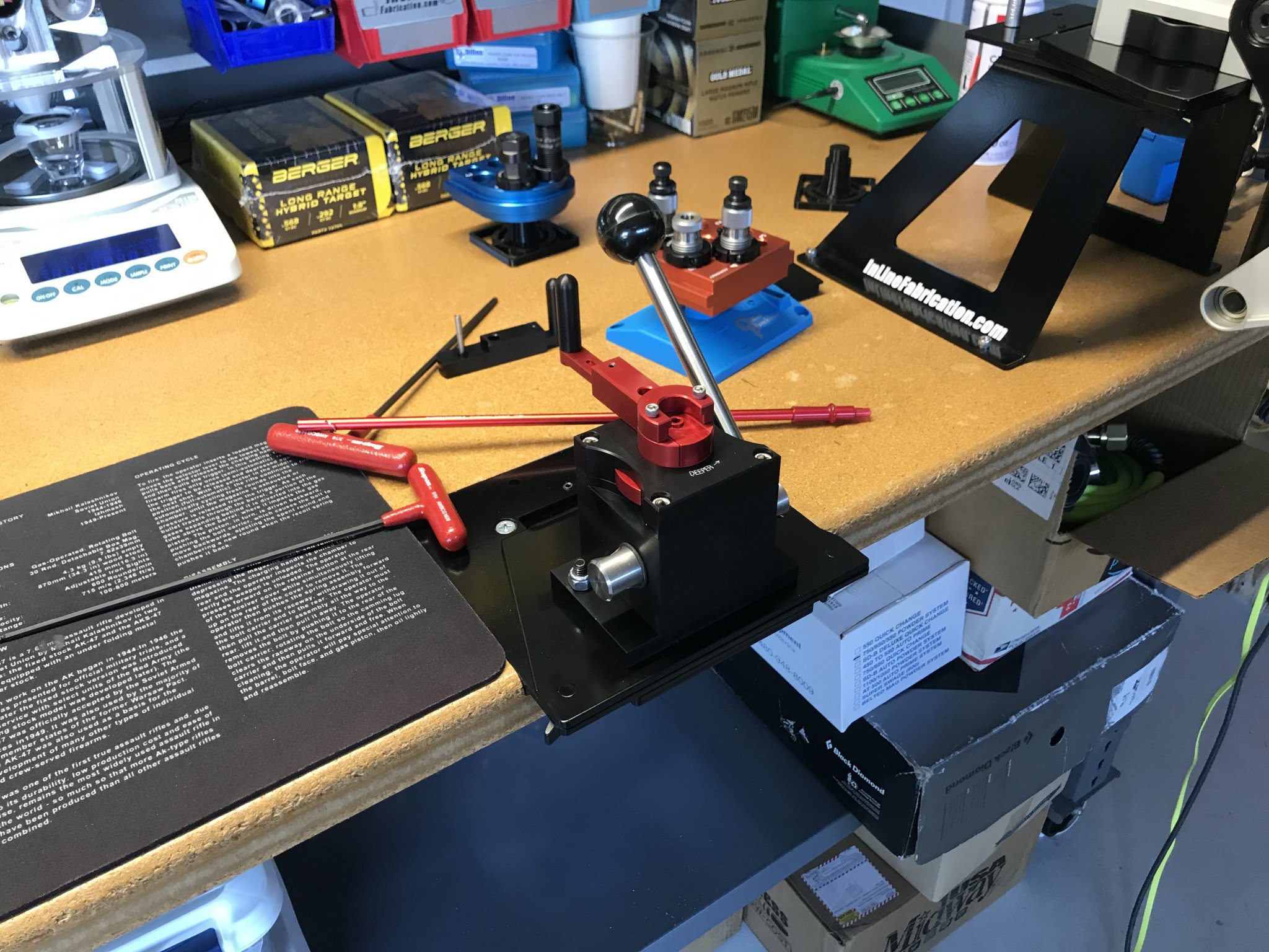

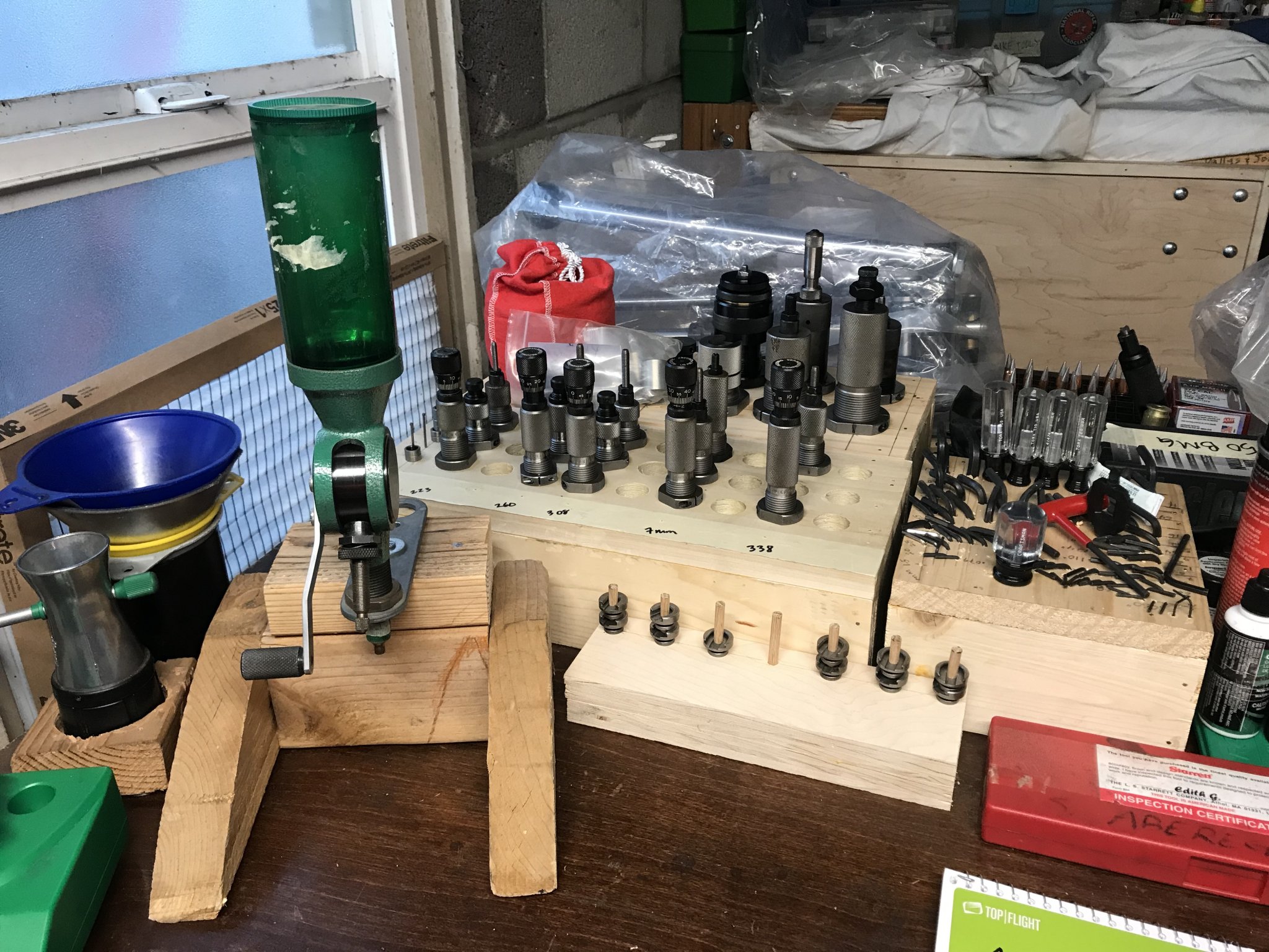

Got my Inline Fabrication flush mount bolted down. Unpacked the CPS and mounted it to the base plate.
Shellholders should be here any day and we’ll how this thing works…
Also have a plate for the SAC Multi-Base on which I have my Barrel Vise. Don’t use it much so no need to have it taking up bench space.

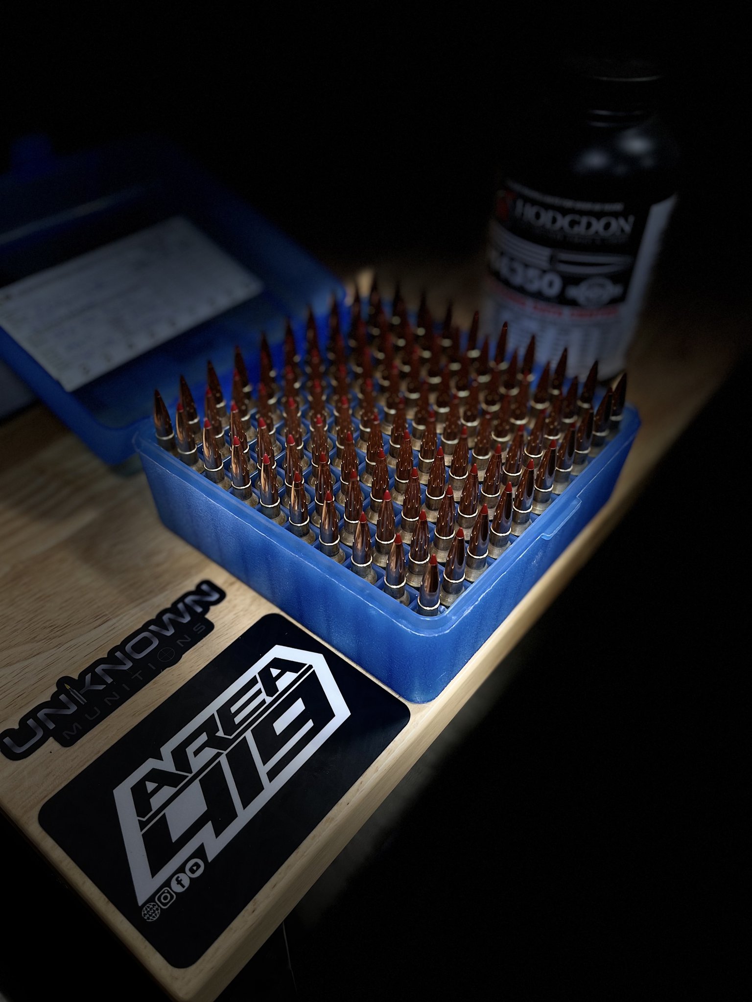

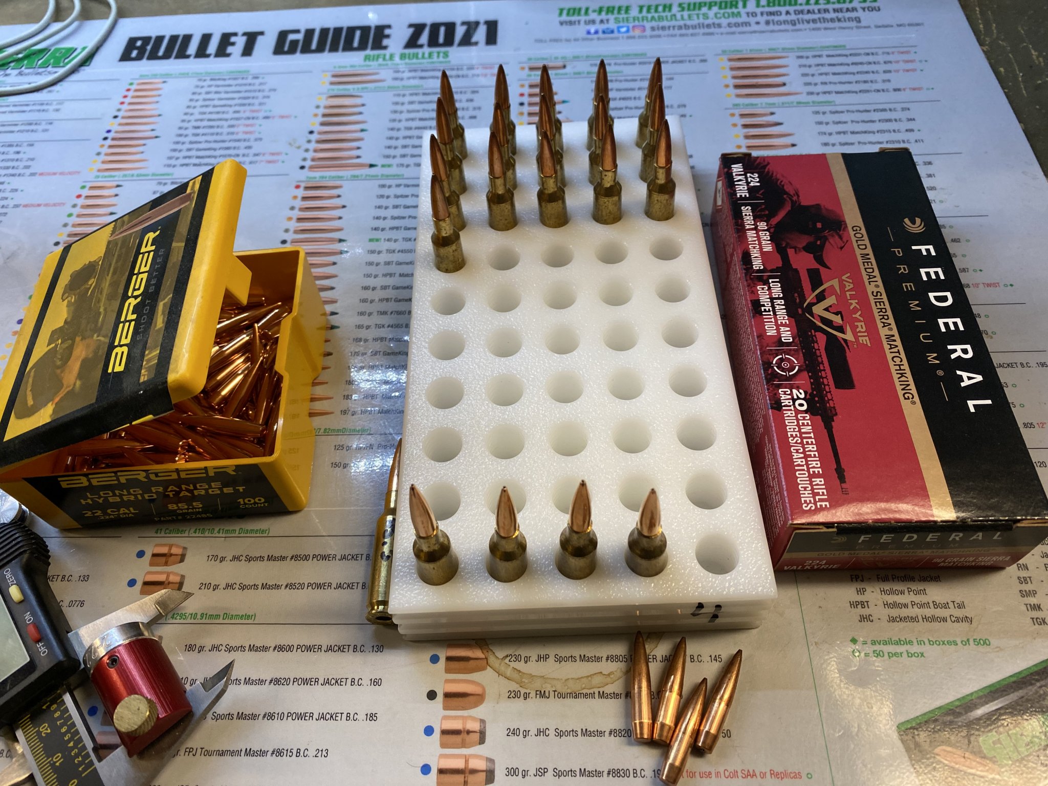

This may be stupid and futile but I’m gonna to try it anyway……

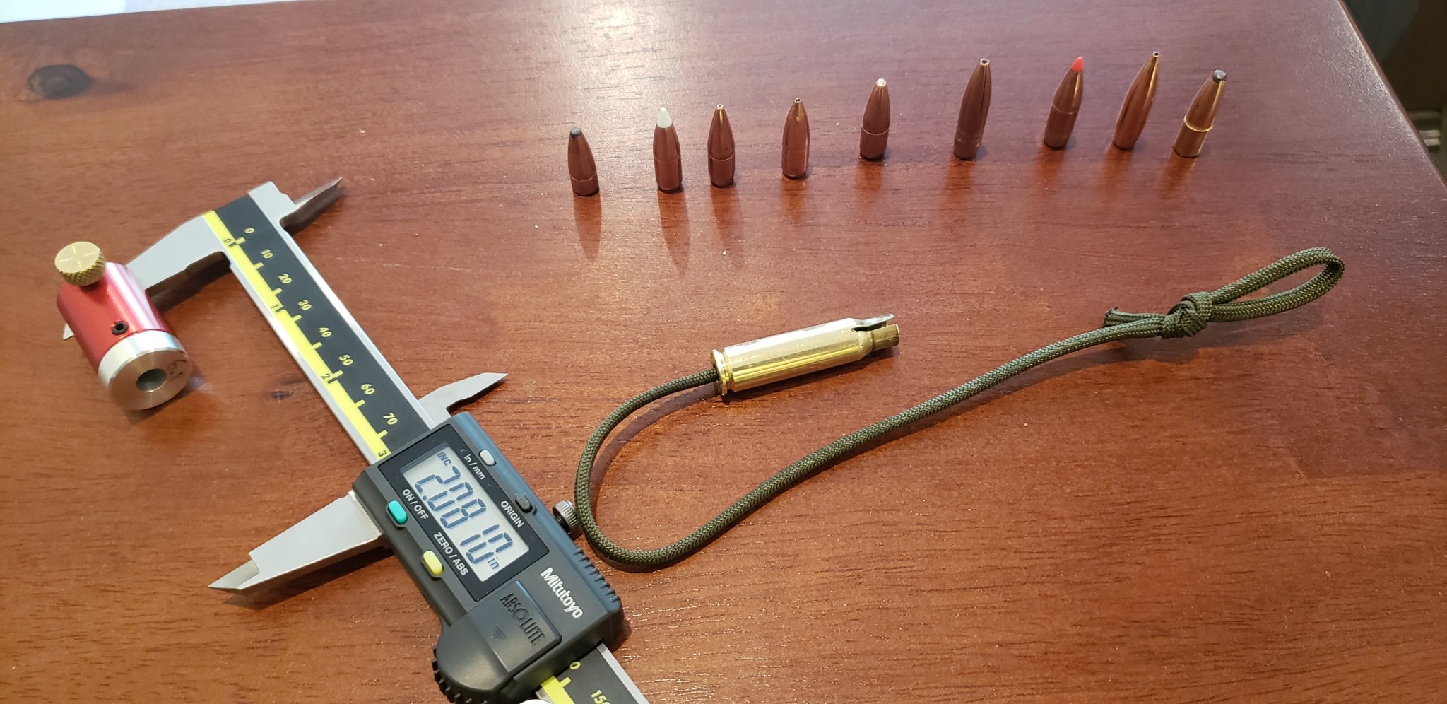

Pulling 90SMKs from loaded Federal 224 Valkyrie rounds and seating 85.5 Berger Hybrid Target bullets. I got this idea from one of our Maximum Leader’s podcasts. Modern Mexican Match, I’d guess.
These will be for my ridiculous LRI 224 Valkyrie bolt gun build with a ton of freebore.
I’ve had decent luck with 90VLDs over RL17 and very little luck at all with 90SMKs. I had this loaded stuff left over from my former 224V gas gun so……
Left: 224V 85.5 Berger Mexican match
Right: 224V Federal 90SMK
I’m gonna chrono it this Sunday and give it a try at 1K.

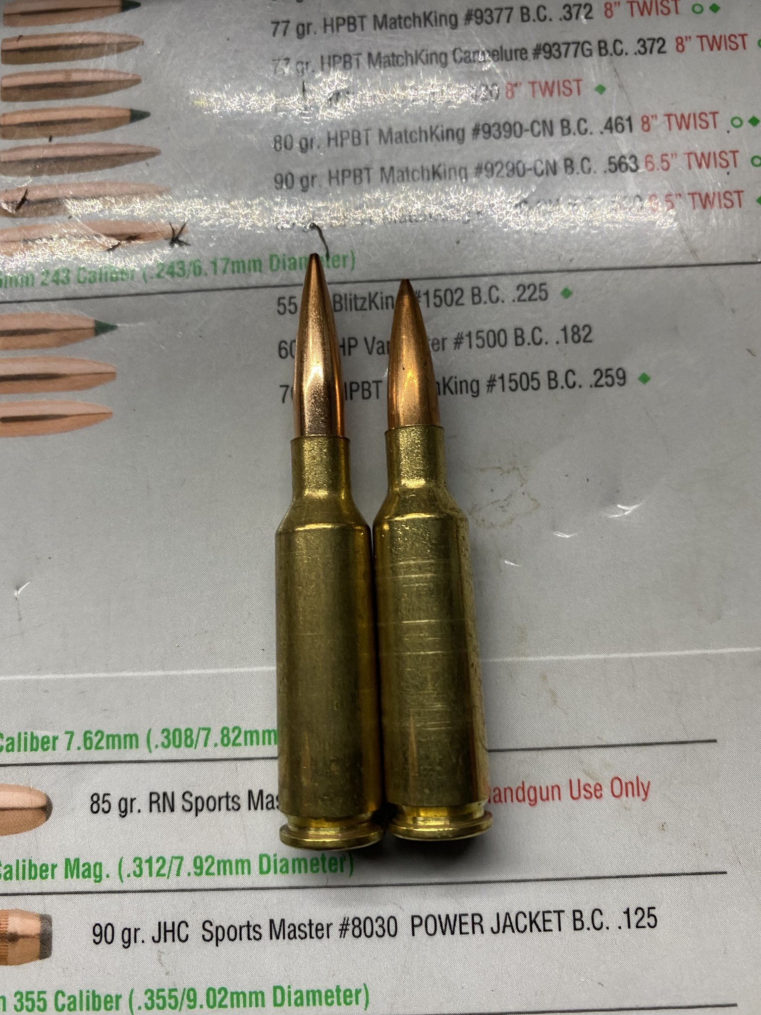

Those necks need to be chamfered something serious on the outside.
