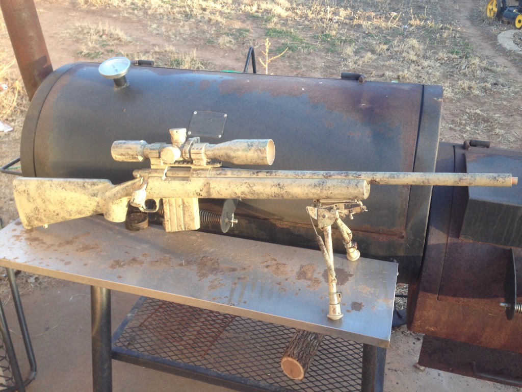

Started off with a Boyds "Tacticool" stock. Sanded it with 320 grit sand paper and all the way up to 1k grit sandpaper. Prepped and cleaned off the wood and used some regular old Krylon primer. Primed it with gray 2 coats, and let dry for a day. Painted it with some Krylon Ultra-Flat Camo Green paint. I put on between 3-5 coats of the green or so. I let it dry quite a bit between coats over the span of a day. After paint was set and dry, the next day I sprayed it with Krylon Webbing paint. When you do the webbing paint, play with it first so you know what to expect or it'll get really thick and thin in places. I use REALLY fast motions with it and do it slowly with quick arm movements. After I go the webbing where I wanted it, I let it dry for a couple of hours or so, and come back in and flatten it on the stock with my hand. Rub off any extra webbing that may be there before clear coating it. After all is done, I clear it with Matte clear Krylon about 3-5 coats again. This is what I think the key of making the Krylon jobs look good. After they are all cleared, its really quite durable. I have a Savage 11 TH XP .308 that has held up under numerous hunting trips, and taken some hard knocks. I'll post up a before, during, and after pic, as well as the savage.
And the .22 before and after.
This was right after I was done with the webbing. Hadn't had a chance to clear it yet.
And all done with no optics on it yet.

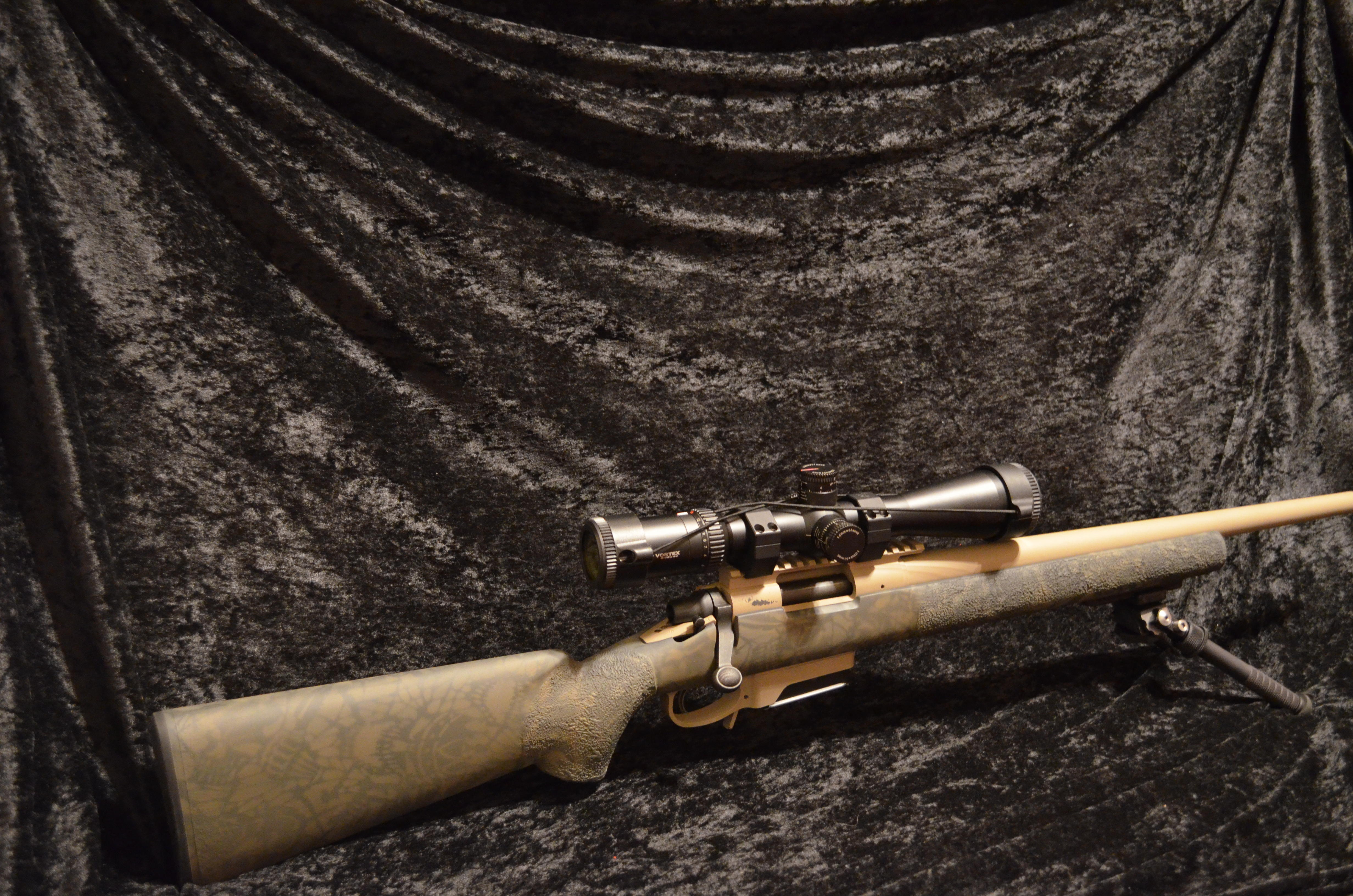

Brand new, right out of the box.
Disassembled and thoroughly cleaned, base of automotive primer.
Base coat of Rustoleum flat khaki.
Base coat accents of Rustoleum flat sage, dry and reassembled.
Hand painted to mimic the sage brush camo shirts in the photos.

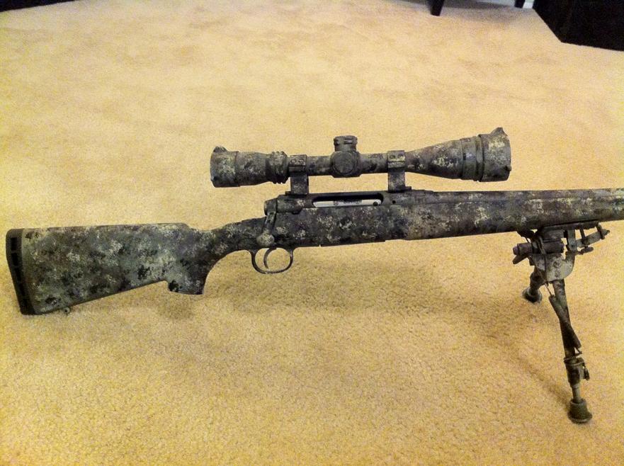

Krylon, flat black, dark grey, and white, sprayed into a plastic bowl and sponged on with small sponges, took me less than 20 minutes.

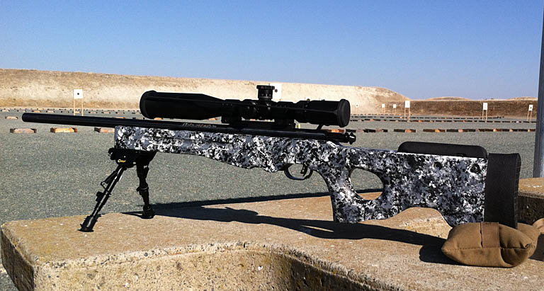

AICS stock Kryloned with OD green, FDE, and black. Finished with a clear coat. Used stencils that I drew and cut out. Holding up very well.

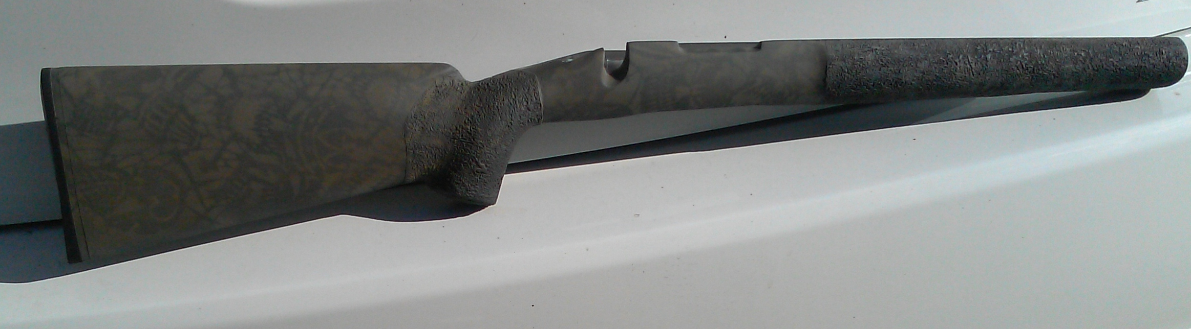

I have rattle can'd my HS over eight times (from gap, needle, sponge, web), finally found something I really like.
The Rustoleum multicolor texture in desert bisque
It has a bit of texture for a good grip and has tiny flecks of black and white for contrast. Blends in nicely with my type of shooting, but not too tacti-tard.
Stuff drys enough to handle within a few hours, give it three days before you handle enough to fire.
Tips, the stuff has tiny particles, so prepare for overspray, it gets EVERYWHERE.
Looks like it goes on clear, but it builds up. So if you are covering a dark stock, might want to prime it first.
Do several passes and let dry in between. Again, it may not look like it is covering anything, but it firms up.
Be very careful with handling as it builds a small layer on your stock, you can dent it easily while it is drying.
Other than that, it is good to go, not shiny and will cover minor scratches or imperfections on your stock.

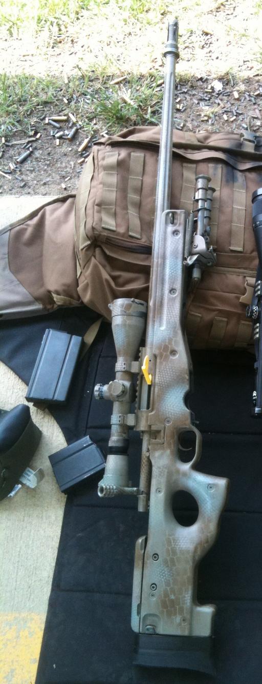

I used rustoleum camo with Bulldog adhesion promoter. I did a sage green base. Then did some snake skin camo. Then did some grass pattern camo.
Then I did some matte clear. Thought it turned out pretty good
