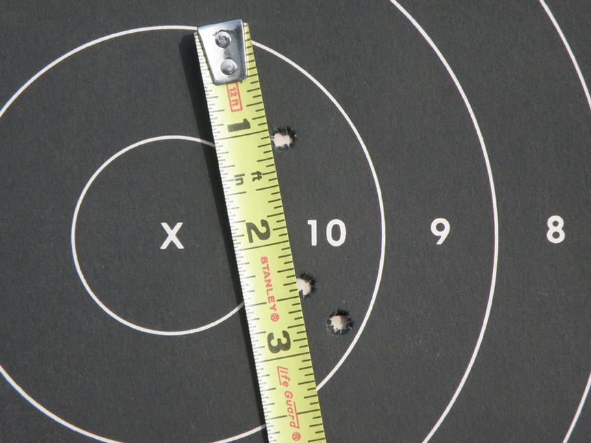

I had a Bushmaster DCM that would shoot 10 shot groups under 1/2". As for a bolt gun my hunting rifle I had built for antelopes is a 6mm Norma BR. Here is the first 400 yd. target I shot to see if I was on the paper when testing my custom turret. Then the .375" 5 shot group it shot at 200 yds. Oh, sorry about me bragging. Kevin Rayhill of Stockade Gunstocks built me a real shooter.

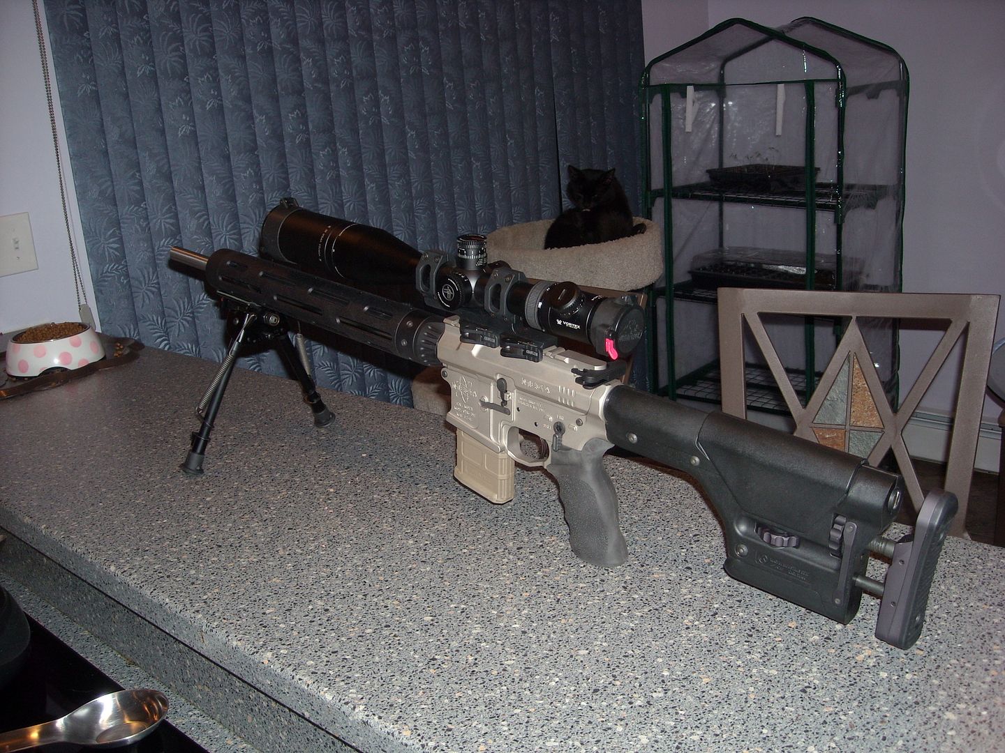

I have this (Krieger) barrel on a Mega build and it is super accurate. I am confident it is a 1/2 MOA gun when I do my part. All top quality internals and billet upper and lower. My friend has a JP and it is nearly as accurate. That said, I have had a bunch of ARs and this is the only one that has shot this well for me. I think there is a little luck involved when you are simply swapping out parts.
