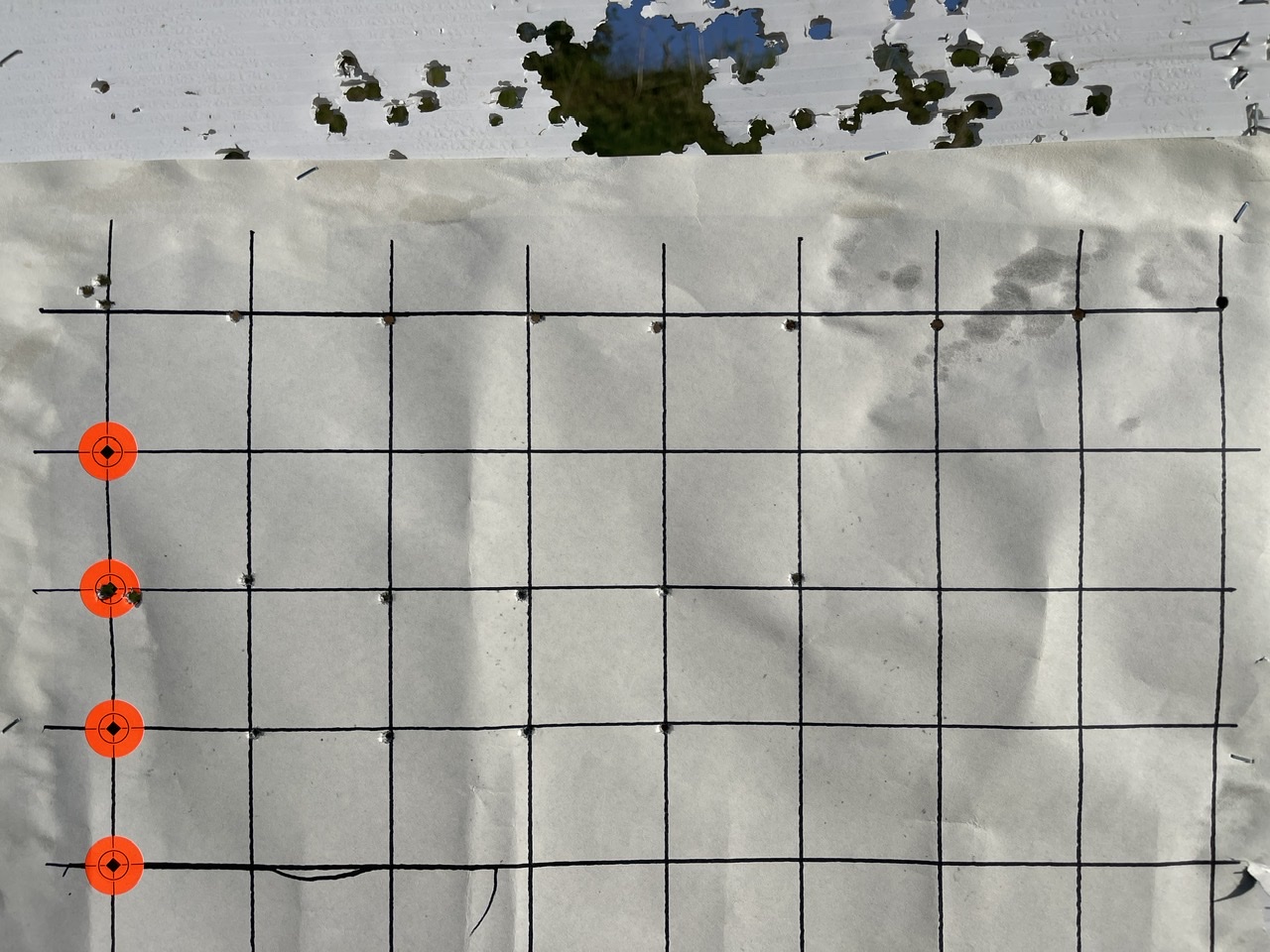

This is from my zero session today with a new lot of ammo I’m trying. The left column was for sighting. I did 17 consecutive shots at the intersecting lines (50y). A little sloppy on the rear bag but I’m pretty satisfied and should be good to go for this weekend’s match. I don’t really zero with groups anymore.
This is much better than wasting a box of 50 on a group. I only see 2 shots on the paper that might not have hit a 1/4” Kyl at 50.
Reactions: 021411
The Grid, it's way more entertaining than groups, eh? :cool:
Groups are for adjusting y'er scope to current ammo and conditions.
Hitting what ya' aim at is the reason for rifles in the first place. ;)
Thanks for The Grid post. Give credit where credit’s due. 😎

Can CCI SV produce tight groups at 50 yards? Sure, sometimes.
Is CCI SV capable of precision paper punching at 50 yards?
Not with the cartridges I've seen lately. Wonder how they'd do on the Grid?
Sounds like something that ought to be attempted.
Especially by a rifle that "likes" CCI SV. Any takers?
