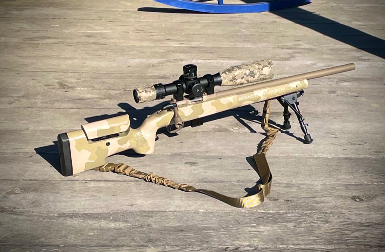

I can offer my opinion. Based on my PRS rifle and multiple data sources. Rifle is a Sako Quad Custom with Lilja bbl using a Arken SH4 6-24x FFP MIL optic. Lapua CX ammo. Most outside of the test center data was shot as 5shot groups measured center to center from bipod & rear bag on a bench or prone. In general I consider match accuracy at 50y to be 0.25" c-c with match grade ammo. Some rifles will on occasion do better but few (none) can do better "All day long". The only factory rifles in this class are Annies and Winchester 52's (maybe VuDoo?), I think of VuDoo as more of a factory custom than a true production rifle. To print 1/4" c-c you have to print 12mm edge to edge which is how the Lapua test center measures 10shot groups at 50 & 100 meters (55-110y). 10 shot groups are statistically larger and the 10% longer distance also tends to make them bigger.
For the Sako, the ammo I am currently using printed 10 shots into 17.42mm @ 50m and 34.62mm @ 100m (0.46" and 1.14" c-c). I am usually able to hit a 1" and 1.5" plate prone at 100y. To hit a 1" plate at least on the edge means I must shoot inside of a 1.45" circle. That is about the capability of the Sako. My factory CZ457 VPT is about 1mm larger groups with the same ammo.
I have never made a habit of shooting paper at 200y or further but have on few occasions. At 200y if you can group 2.5" or less you are doing really well. That is what the Sako does in good calm conditions. At these longer ranges the wind becomes much more of a factor as does spin drift. Spin drift is more about hitting the tgt since it is a deviation but more or less constant in one direction. Groups at this range become oblong in the vertical due to ammo inconsistency.
At 200y we shoot a 6" plate (easy) and a 3" plate, less easy. I find both to be very doable with the Sako. We also have shot a bird shaped plate about the size of Robin at 185y and found head shots on it from a bench to be a chip shot. Not sure if that means much.
Next is 300y. We are shooting a 8" plate at that distance. I find it the hardest to get on tgt due to a bunch of factors but once dialed in, I can ring that plate 9 of 10 shots. Wind being a big factor here and am assuming the wind remains steady that long. I can see hits on steel or holes in paper at 300y with this optic and usually the hits are centered well most of the time. In past PRS matches we were shooting 6" plates at 293y and hitting them often (not all the time). 8" or even 6" at 300y is not really great accuracy but I have never attempted groups at that distance on paper.
Finally, 400y. Our 400y range is really a few yds less than that. We have a full sized IPSC plate and a KYL plate rack with the largest being 10" the next is 8" and the smallest is 2". I can hit the IPSC plate every time but the 10" and 8" round plates are much much harder and become an act of random luck in my opinion. If you shoot at them long enough, you will hit one every now and again but it is tough.
This weekend, I am taking the Quad to our local range and trying it out past 400y. Hoping to get out to 500y before I run out of up elevation and hold over capacity. We will see.

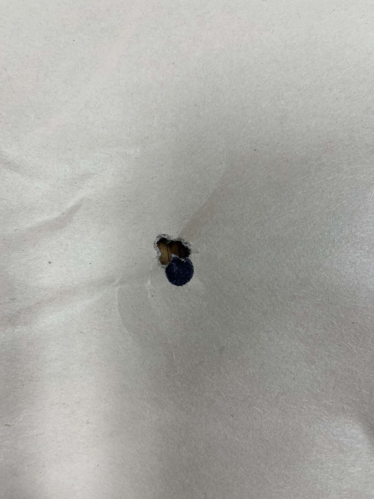

Cci SV at 50 yards seems pretty decent to me? .3” for ammo that’s $35 a brick works for me
And after all that discussion, what it comes down to is....
there are only four companies that I have found, that are capable
of producing rimfire ammunition that can be expected to produce consistent accuracy,
Eley, RWS, SK/Lapua and Fiocchi Italia. Their best is intended for use in precision shooting.
All the rest manufacture rimfire ammunition for hunting, offhand and close range shooting,
where the lack of quality control doesn't seriously affect the results.
If it goes bang and clears the barrel, good en
Not sure we can that exception grouping though can we.
In Liam Neesons book on 22lr CofG and drag coefficients, pg 69, he categorically states that CCI SV cannot shoot groups anyone would deem satisfactory, one must buy ammo from 1 of the big 4 manufacturers to stand any chance of shooting a group that even remotely resembles accuracy.
I bet you'll find your shifty ammo throws a few high/low fliers in the 500 brick, which automatically disqualifies it from even an accuracy standard one would even deem "good enough for the price".
Reactions: JBoomhauer
Was that group right above it, also CCI SV? Is it .3" consistently on multiple groups?
That was SK high velocity match, unfortunately my CZ doesn’t like it at all.
The CCI SV was typically .3” - .6” had a few that were .7” but I had a 15mph gusty cross breeze. Would I run cci standard in match? Probably not. When I really want to get the Max out of my rifle will I grab the CCI? No. But is it pretty good ammo for $35 a brick? Hell yeah!

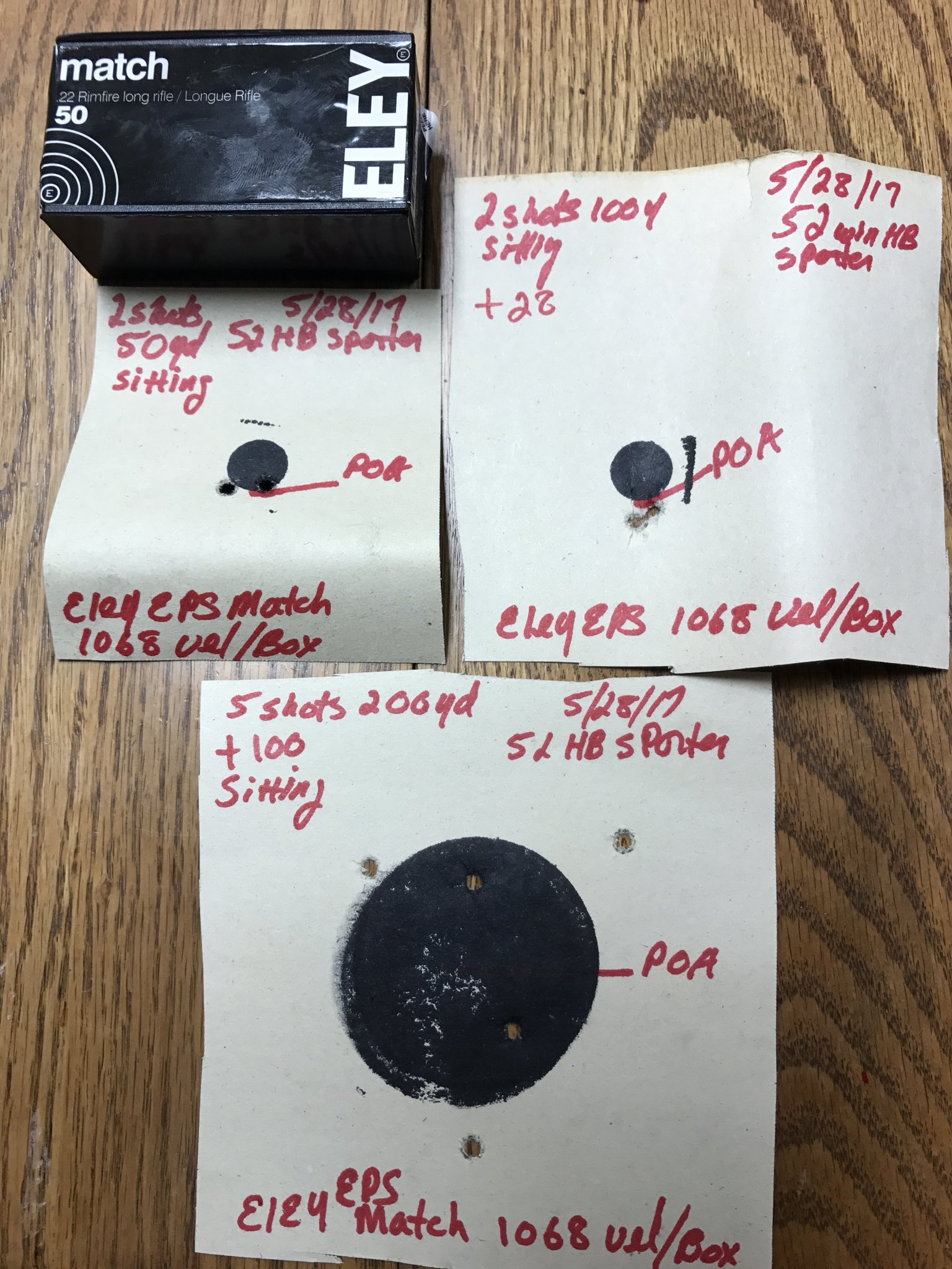

I’ll add a few examples shot with Eley Match and Eley Tenex ammo. First one is 200 yard group with no allowance for wind. I was gathering data for a custom reticule in my Unertl. Note lack of vertical dispersion. Second is a 100 yard group with Tenex shot on a calm evening. Next are some data verification groups shot on a calm evening prior to a squirrel hunt. They were shot on one target at the ranges listed and were the only shots fired. @justin amateur will call them selected groups or “wallet groups”. I do not agree. In calm conditions this is how the rifle shoots. Justin needs to get a good 52 C and lose some of that negativity. 😂

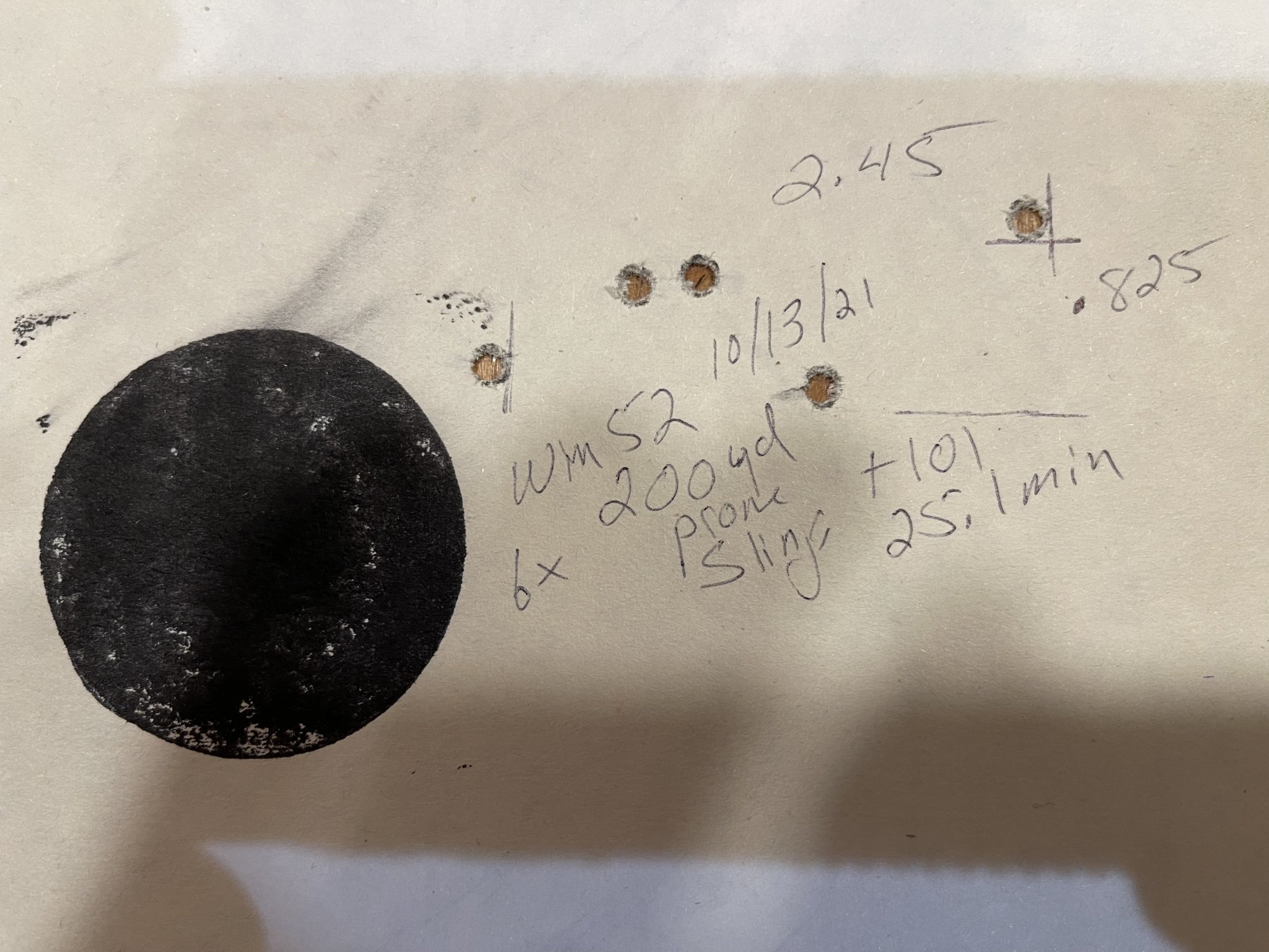

All groups shot prone or sitting
with tight sling.
