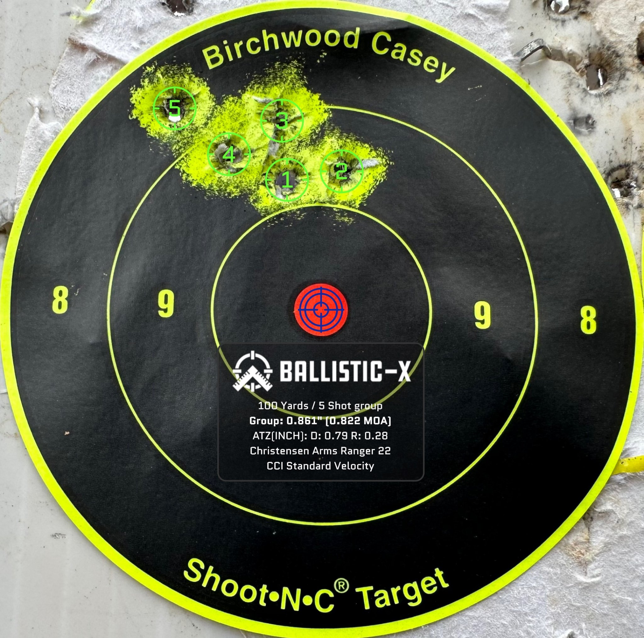

Whats a "good" 100 yard group size?
OP @*Face* what is your intentions for this rifle? Is it just shooting for fun or are you competing with it for NRL22, PRS Rim Fire, Benchrest or something else?

For me and my discipline (NRL22/ PRS RimFire) I want my ammo to be 1" or better at 100Y and carry MOA or better to 300y I also know weather is going to vary that. I also know my targets are going to be 2X MOA for the average 100Y and beyond. This means I have to practice my positional shooting groups and keep my NPA, Trigger Press and breathing consistent and build a solid position to shoot from.

At this time I have 2 different lots my rifle is shooting. Eley 10X and RWS R50. I go to Lapua test center in Feb or March of 24 and im sure I'll find more. If not ill get another test brick and go that rout for R50 again.

I just started shooting out to 100 yards and getting used to the distance. My best 5shot group of the day was ~0.5" using SK standard plus. The rest were between 0.75 - 1.00"
I know I'd be better off using something like SK long range, but I can't find any at the moment..so SK standard is I have currently to practice with.
IMO, 5-shots sub-MOA constitutes "pretty good" for a rimfire .22LR, given the inconsistency in rimfire ammo production.
Christensen Arms Ranger 22 with cheap bulk CCI Standard Velocity ammo...
Ballistic-X-Export-2023-05-21 18:08:42.528914.jpg
