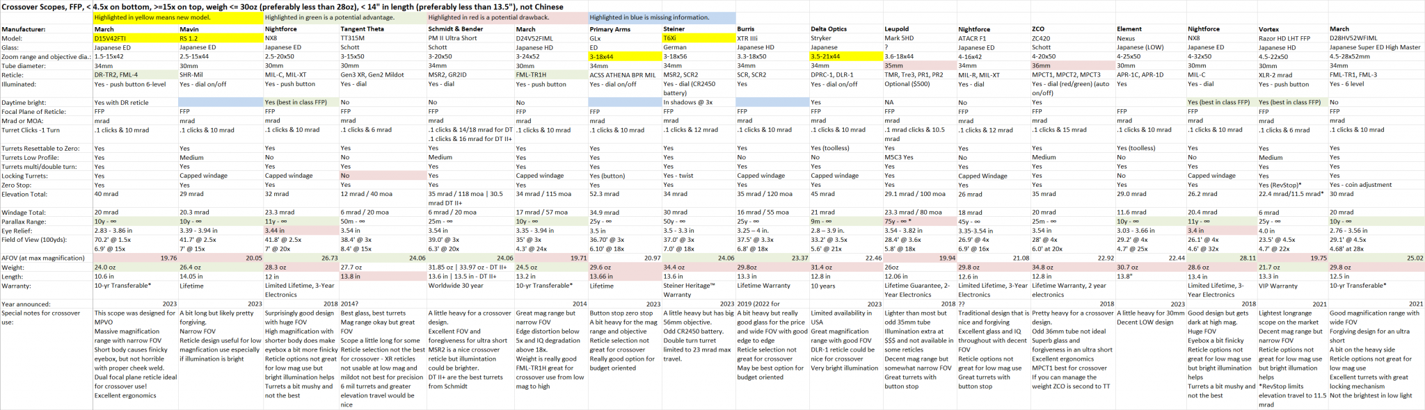

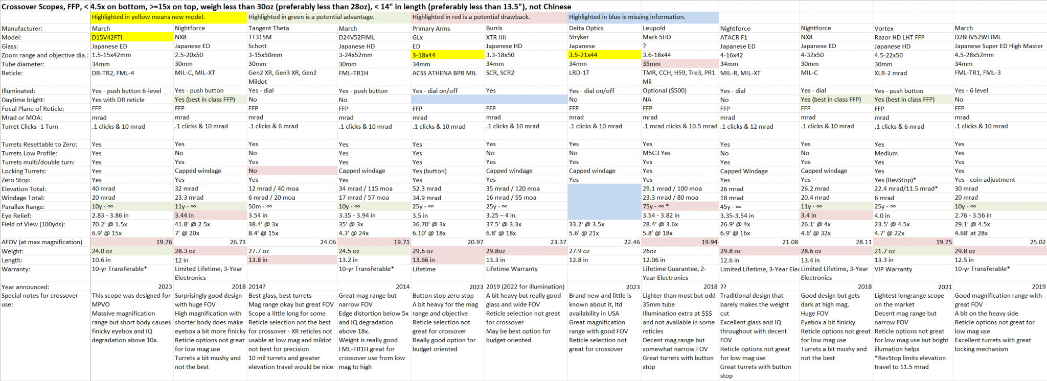

    Spreadsheet of scopes that meet the following criteria:
    • FFP Hash Reticle
    • 4.5x or less at bottom magnification
    • 15x or more at top magnification
    • Weigh 30 ounces or less (preferably under 28oz)
    • Length less than 14 inches (preferably under 13.5")
    • Not manufactured in China (if you need to ask you haven't been paying attention)
    I have ordered these by bottom magnification at far left and increasing up to 4.5x on far right

    Okay, I've put together my spreadsheet, this is what I've come up with so far, let me know what I am missing, but keep in mind it has to meet the following criteria:
    • FFP Hash Reticle
    I have written about crossover scopes extensively over the last few years and spent a ton of time trying to persuade manufacturers to address this category. I was sufficiently annoying that a my Vortex contact called me up a while back and said something along the lines of "here is your f-ing scope and stop harassing me". That's how I got the HD-LHT 4.5-22x50 a year before it was announced.
    This is the category of a riflescope I really like and, given a choice, use most of the time. I have always seen all of them and quite a few more that are not in your table. They come and go. Some stay. Which ones are staying here permanently?
    Tangent Theta TT315M 3-15x50
    Vortex Razor HD-LHT 4.5-22x50
    Tract Toric 2.5-15x44
    Delta Stryker 3.5-21x44 has not been here very long, so we'll see. I like the configuration and it is going onto a pronghorn hunt with me shortly, so we'll see how it does. It might be staying too.
    Burris XTR3i 3.3-18x50 is here as well and I like it. It might stay as well, but we'll see.
    ILya
    I just wish the Burris was a bit thicker on the bottom end. It's great on the top but I could live with a slightly more intrusive ret at 18 power if the low end was more usable. Without illumination it's hardly there at all. Anyone else find the Philippine model to have better glass and controls vs the USA made models? Mines superior. Excellent crossover scope though. I also am fond of the athlon ares etr 3-18.
