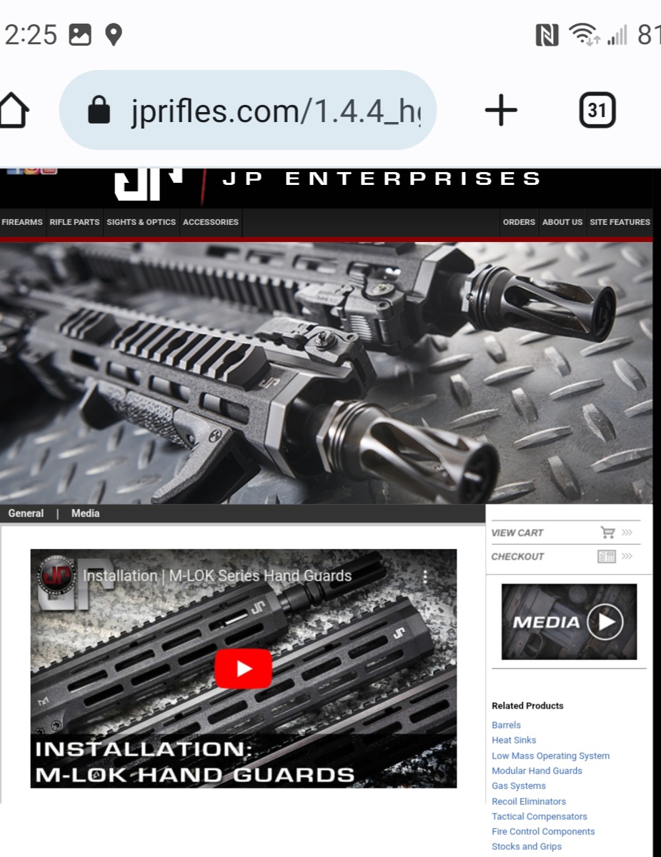

And in regards to JP you need to look again on their website they now make a Mlok Handguard that is pretty damn sexy looking that can be paired with their small frame receivers that have side charge or dual charge options.

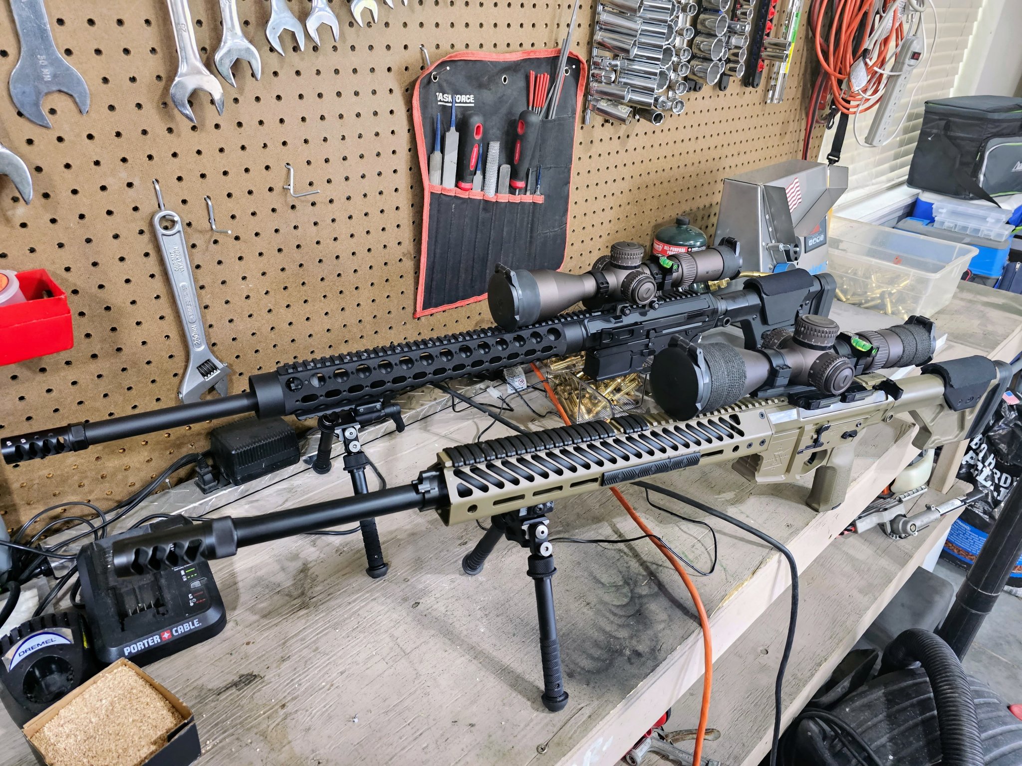

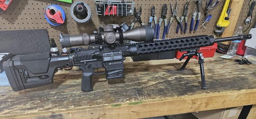

This is my new Gucci Small Frame AR, just finished her today. I'll take her for a test drive tomorrow.
JP SCR11/SCI20.
JP LMOS BCG with Young Chrome HMB Bolt.
JP SCS.
JP .875 Adjustable Gas Block.
CLE Bartlein 20" .223 / 1-7.7 Twist / CLE Match Chmber / Rifle gas / 5/8x24 Treads / White Oak Competition Barrel Extension.
Triggertech Diamond Single Stage.
American Precision Arms Adjustable Muzzle Brake.
MagPul PRS Lite
Compared to its Big Brother in 6.5CM
JP SCR11/SCI20.
JP SCS.
MagPul PRS Lite
Please post about results after test drive.

What is your logic to opt for a low mass carrier as opposed to a regular one? Less reciprocating mass to allow for better follow up/spot trace and impacts would be my guess, curious to hear yours.
It's what I had in my spare parts box...lol
Yes in a competition setting it would definitely shine but It really just produces a smoother operating rifle that is already heavier than most so when you combine lighter operating parts with a heavy precision based AR It's just a joy to shoot.
There's so many aspects of the builds I do that really fine tune the system as a whole through a careful collection of specialized parts. Just looking at the barrel alone...
4 Groove
1-7.7 Twist
CLE Match Chmber
Rife Length gas
Custom Contour based off of the M110
5/8x24 Threads
11° Target Crown
Every aspect has been hand picked for the highest level of precision possible.
