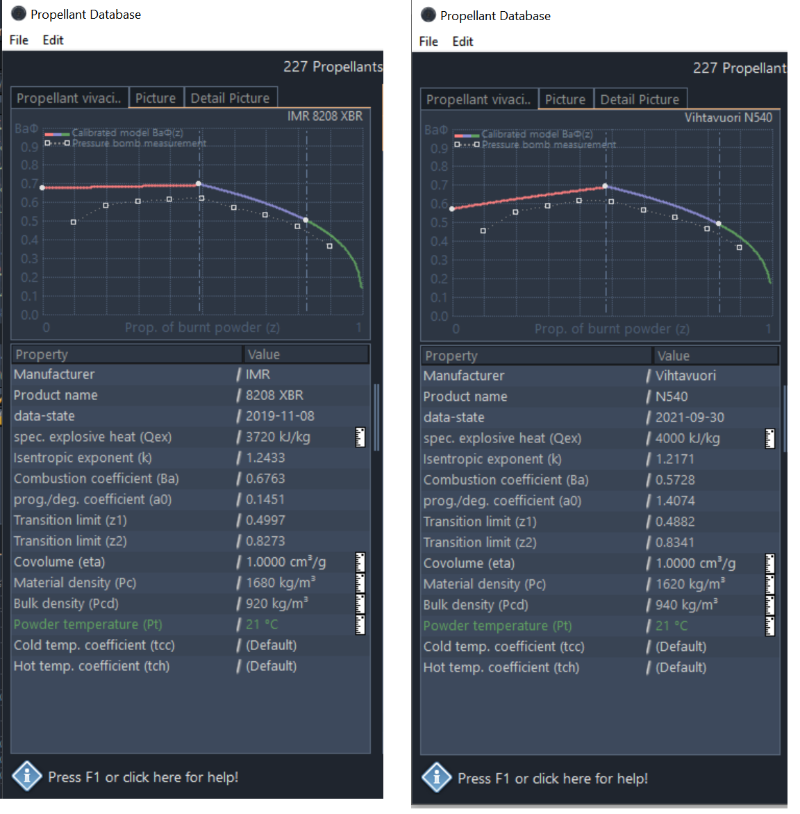

Another thing is that the chart can be quite misguiding
For example it shows that N540 is a bit slower than XBR but in Quickload and GRT it's very close (at least in Dasher/Grendel sized case).
Powder burn rates aren't linear and theres a lot of variables ( single, double base, flake, ball, granule size, density, temperature, effect when compressed, etc etc)
I'd never select a powder/charge just by looking at the chart.
