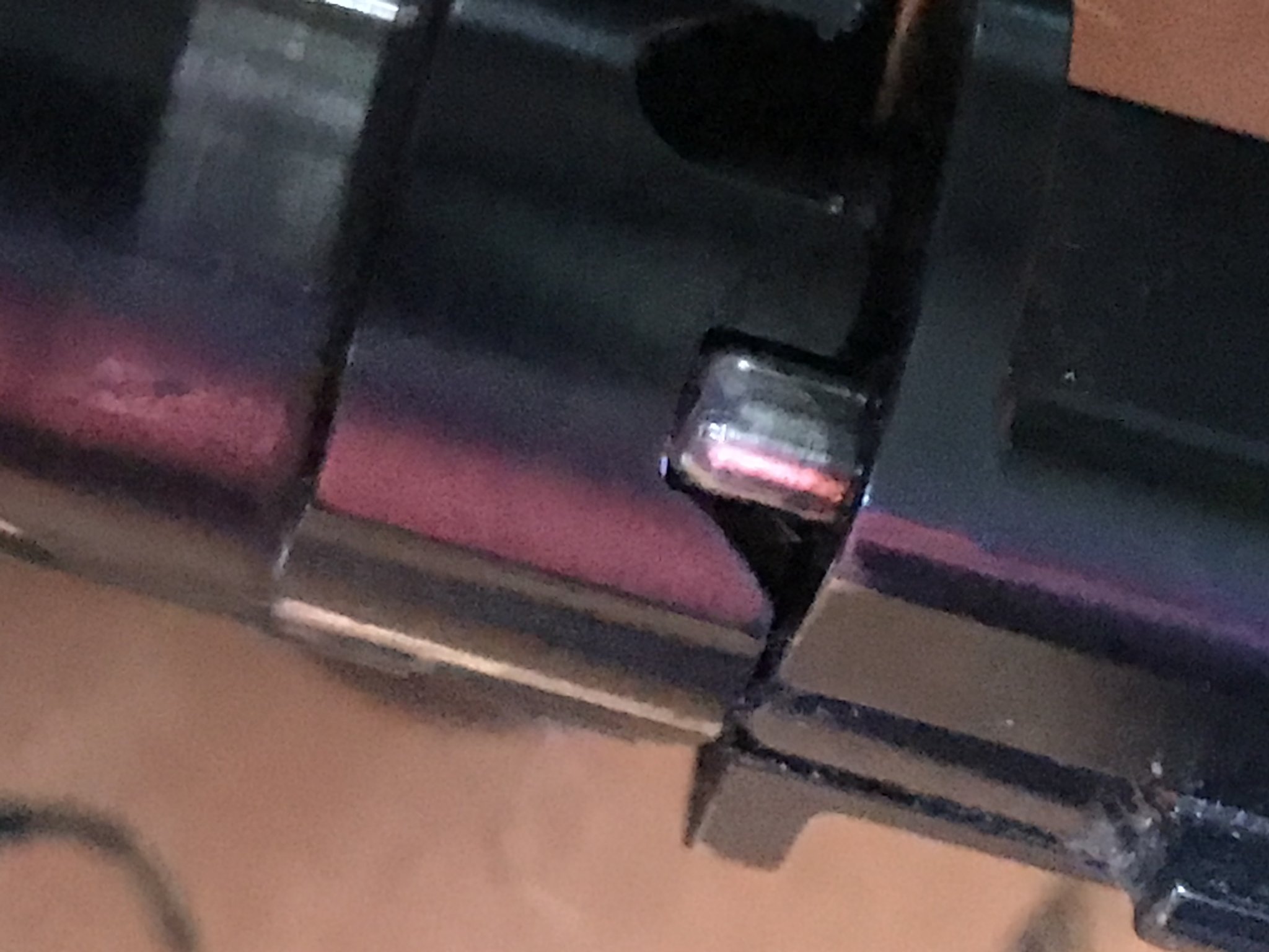

EXTRACTOR TUNING: Yes, you can round the bottom corner off the extractor, ever so slightly so that the case more easily snaps under the extractor.

I can't find the pictures of how to tune the extractor. It is somewhere in this very long thread I started on the Nucleus when it first came out. My search voodoo isn't working right now.
Edit to add that it is just a tiny, tiny bit off the first corner that hits the case. I can get some pics and video up if guys would like to see how all this operates together.

Can any of you guys find the pics or instructions for the mods to the Nuke, like the plunger mod and the extractor tuning? I have seen them, but I spent 10 minutes trying to find them again and couldn't.
I want to be able to find them easily again when it comes up, like in this thread. The original Nucleus Order thread has more than 25 pages, lol.
I don’t have a pic of the extractor mod but it’s easy.
I slightly round the entry area that is behind the hook and break the edge at the bottom of the hook.
My second magnum face bolt head/extractor was already slightly profiled in that manner compared to my original 308 bolt head/extractor.
