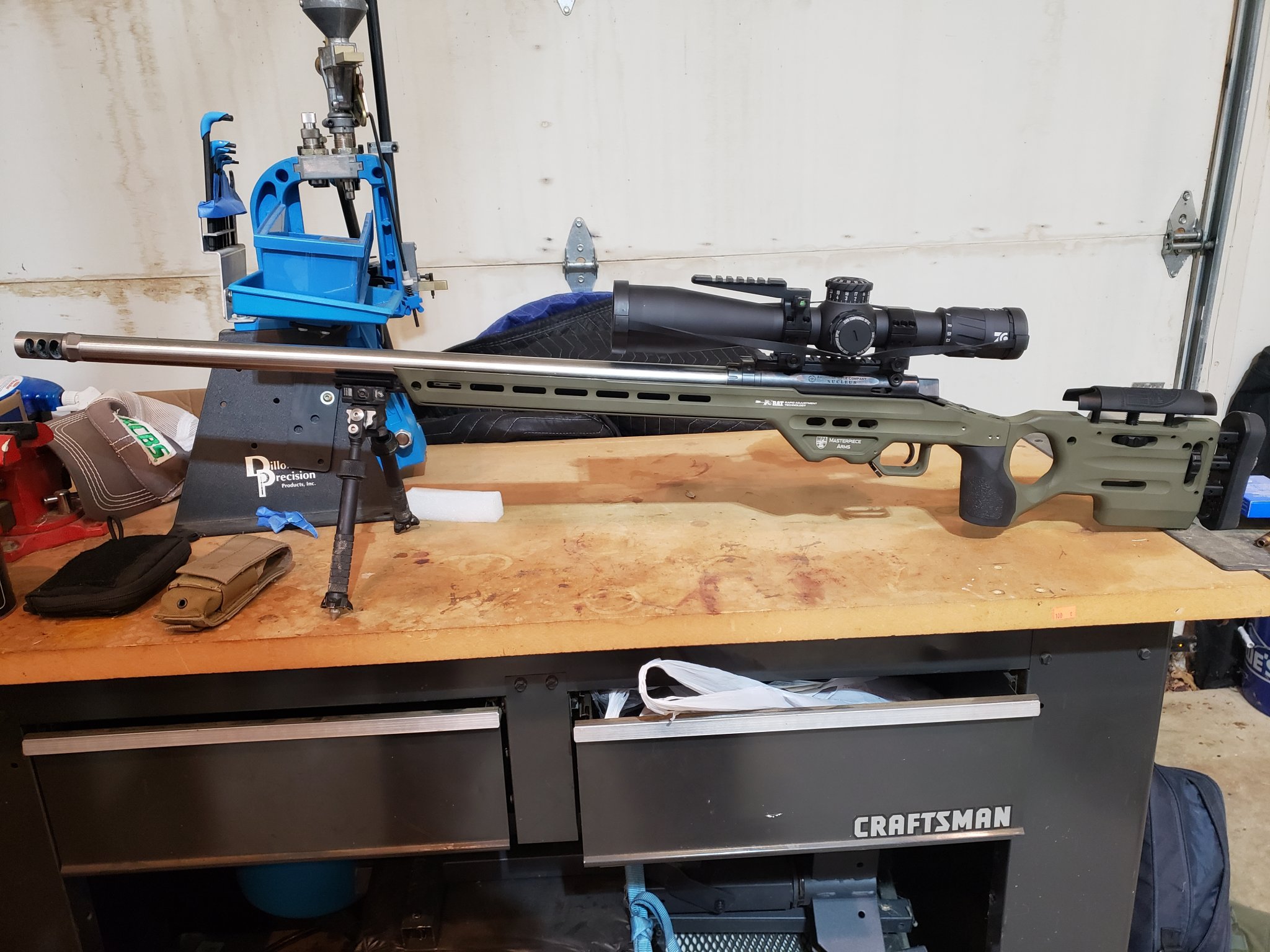

I have to admit, I have a soft spot for ARC actions.Got a pretty early Gen 1 Nuke on the original prebuy, and has been my main PRS rig since I received it. Running it with a Hawk Hill prefit, Barloc, original spring, amd Huber Trigger. Put it in a MPA Matrix and topped it with a ZCO this winter.
I'm about 1600 rounds on the action, with no major action failures.
