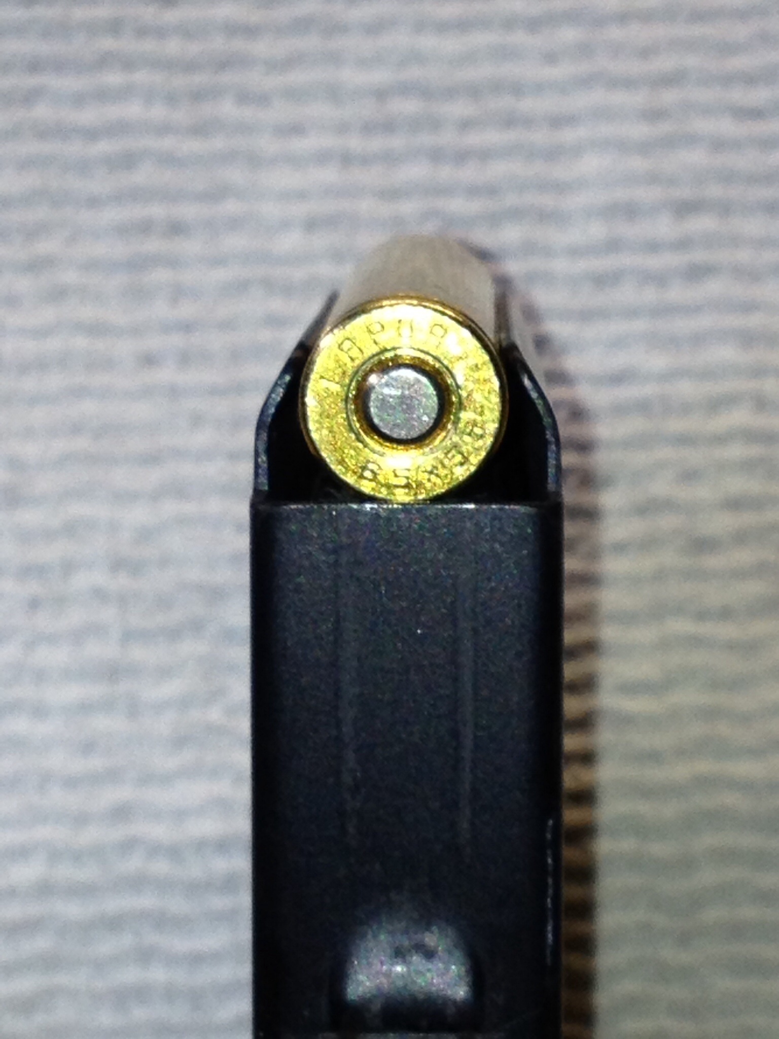

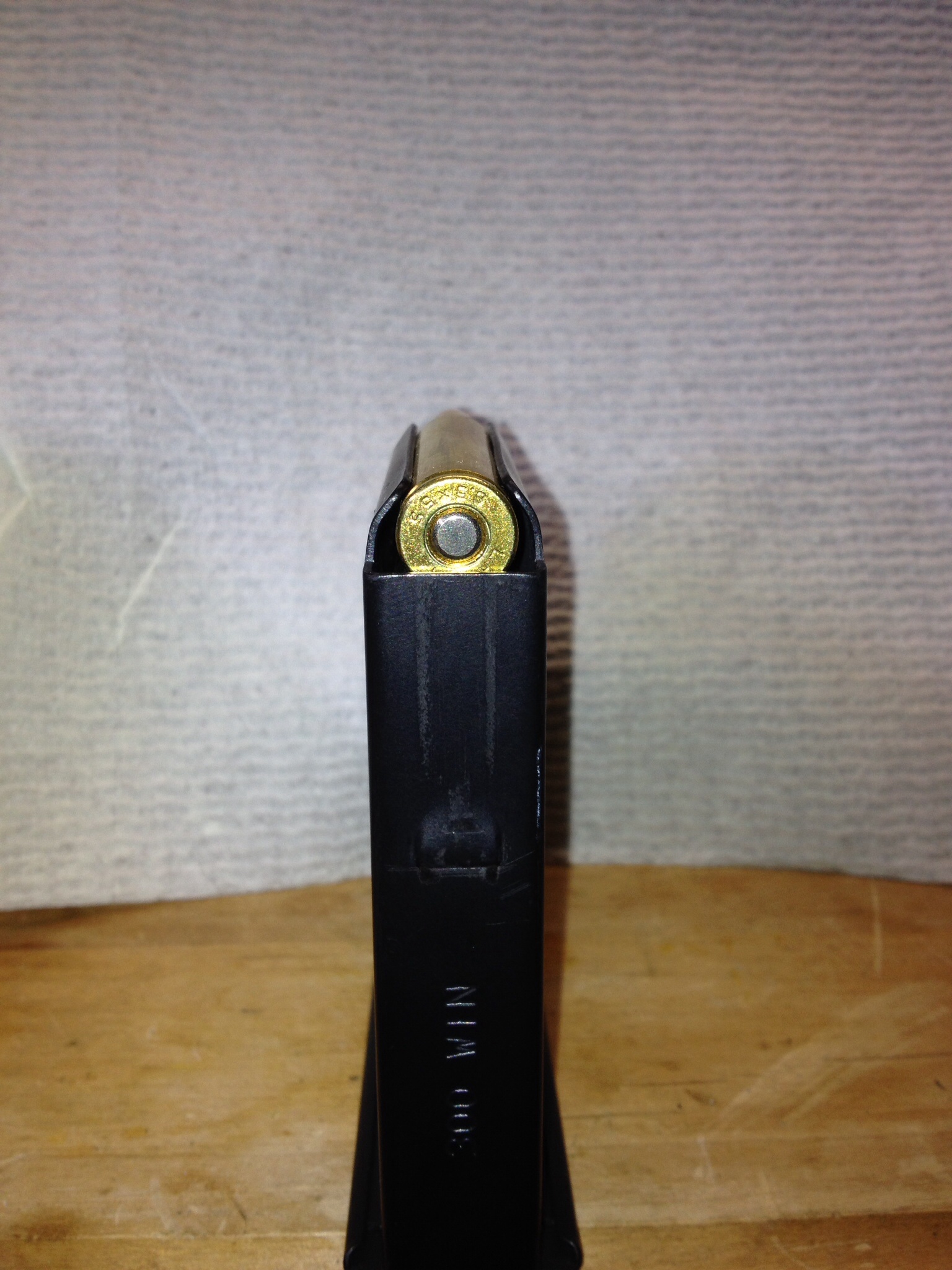

I am building a swede too, and can't visualize mod - what does the feed lip look like after tweaking? thanks
This is what the magazine will look like before and after. Tweak the lips a bit so that the case doesn't slip backwards.

I used a small rubber mallet. Tap lightly and don't beat the shit out of it and you will fine. I didn't have any pliers that would fit between the feed lips but I suppose that would work too.
Do you insert anything in the mag? Meaning just a thought about using a block of wood for the length of the magazine, but topped off with a 6.5x55 case so as to form it better?
No, I didn't use anything. I did one mag where I flipped it over and pressed each feed lip against the work bench and gave the bottom several taps with the hammer. That worked too. The feed lips are stiff enough to bend evenly on each side.
