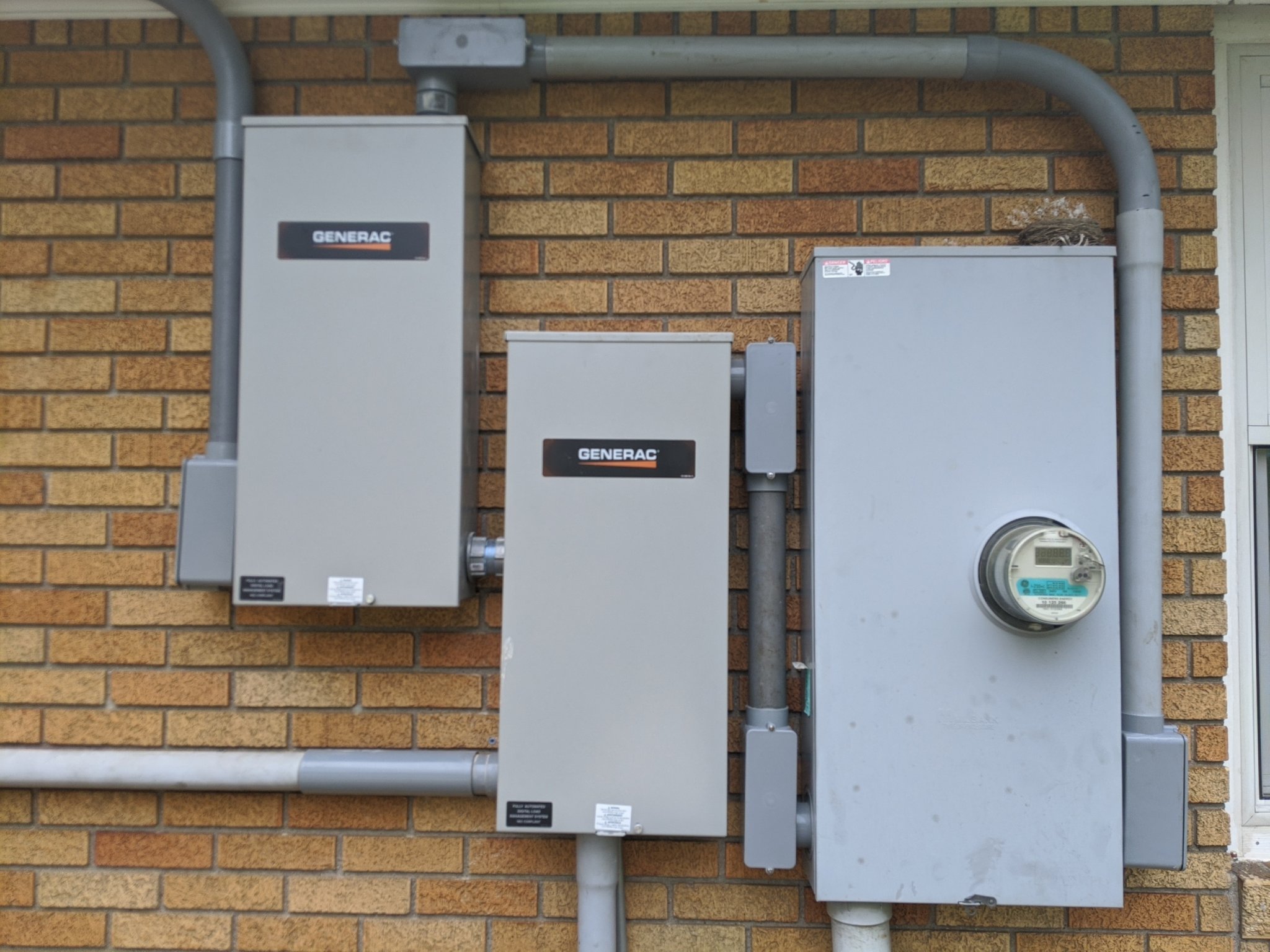

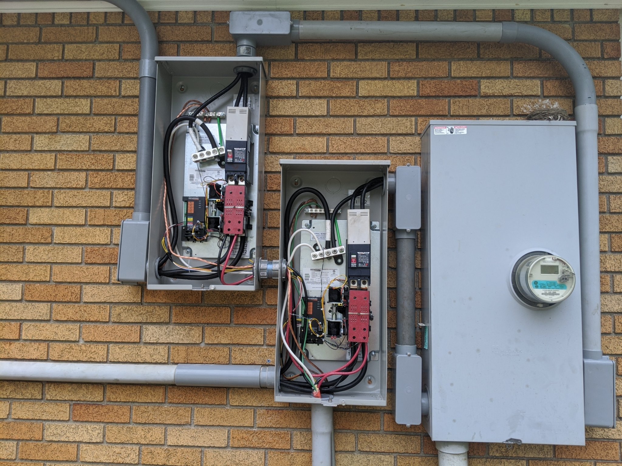

I did my entire install. The unit with one 200A transfer switch was ~$4000, then I added another 200A for the shop ($700). There is probably another $800-1000 in all the other miscellaneous material for running propane to the unit (including a larger supply line from my tank), wiring from the unit to the transfer switches, and redoing the wiring from the meter pan to the existing service disconnects (I have a Class 320 service drop to the house and shop, so everything is 2x). Figure about 40 hours of total time in the various install tasks, which saved me $3000 compared to the quoted full install from a local dealer. Everyone can decide for himself whether that's a good trade-off. It was a good project to keep my sons and I out of trouble for a few weeks.
My main regret is not making the appropriate accommodations when I redid the service entrance and propane supply during a big remodel about eight years before installing the generator. I would have saved myself from doing much of this work twice.

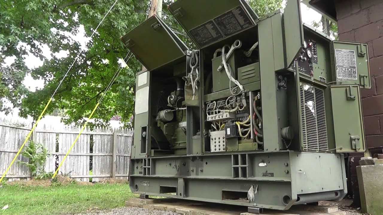

I have a Kohler 10Kva Kohler diesel (Kubota)genset. Came out of an offshore racing trailer with less than 300 hours. My main electrical panel is in the heated shop, house is fed by it, and the genset sits right next to it on industrial caster wheels. When power goes out, I just wheel near the overhead door and run flexible exhaust pipe under it. Sips fuel and powers heat, well and AC no problem. Best part is by being a DIY guys on cost me $800.00 bucks.
Reactions: BAMCIS and MadDuner

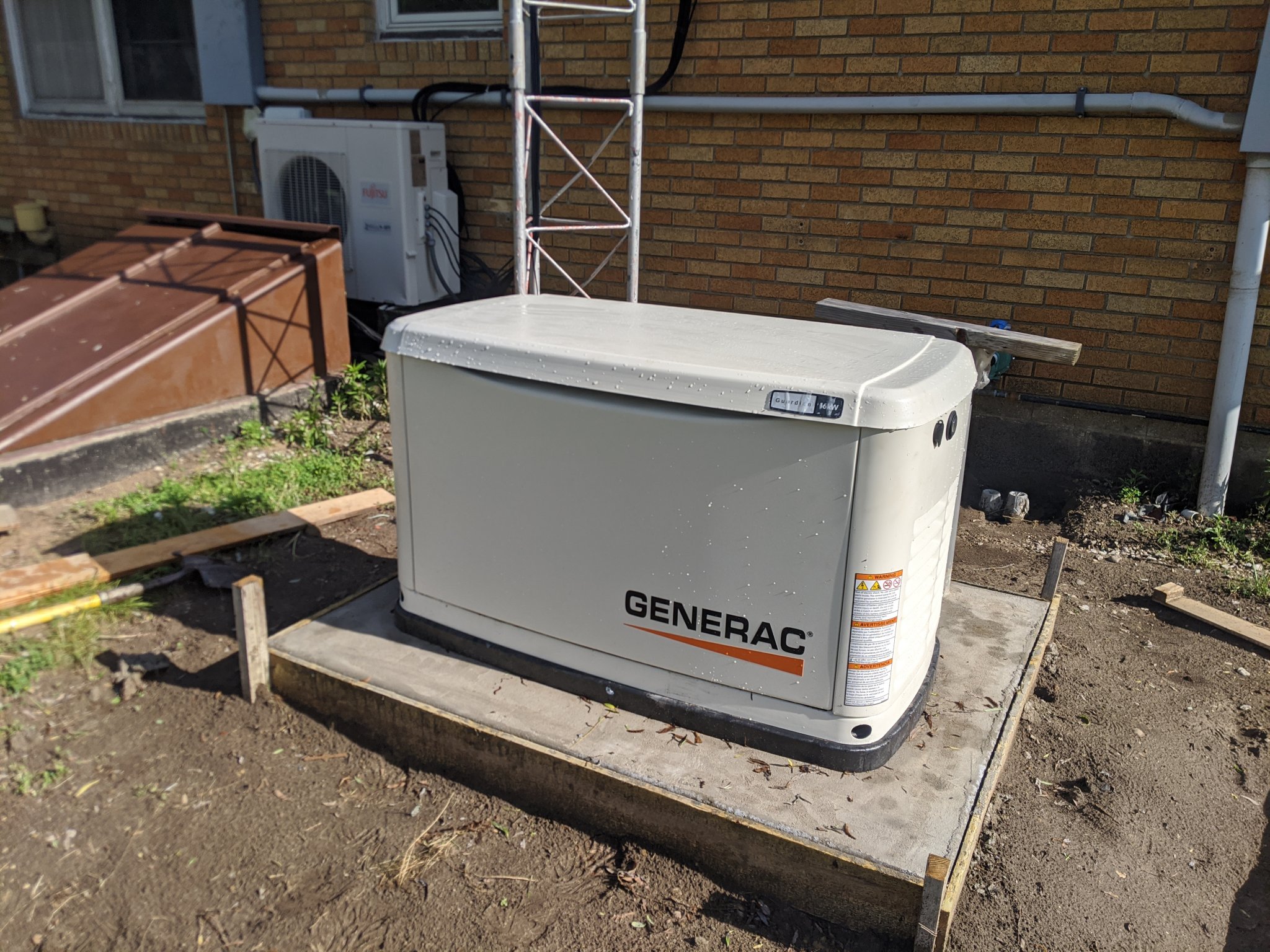

I have a Generac 22 kw generator with a whole house transfer switch that runs everything in the house. I'm fortunate to be able to use my Town's natural gas service as opposed to a tank. You might want to download the maintenance manual for the specific unit your interested in to get an idea about normal service. I perform the service on my unit which is not frequent or difficult. Best of luck with your selection.
