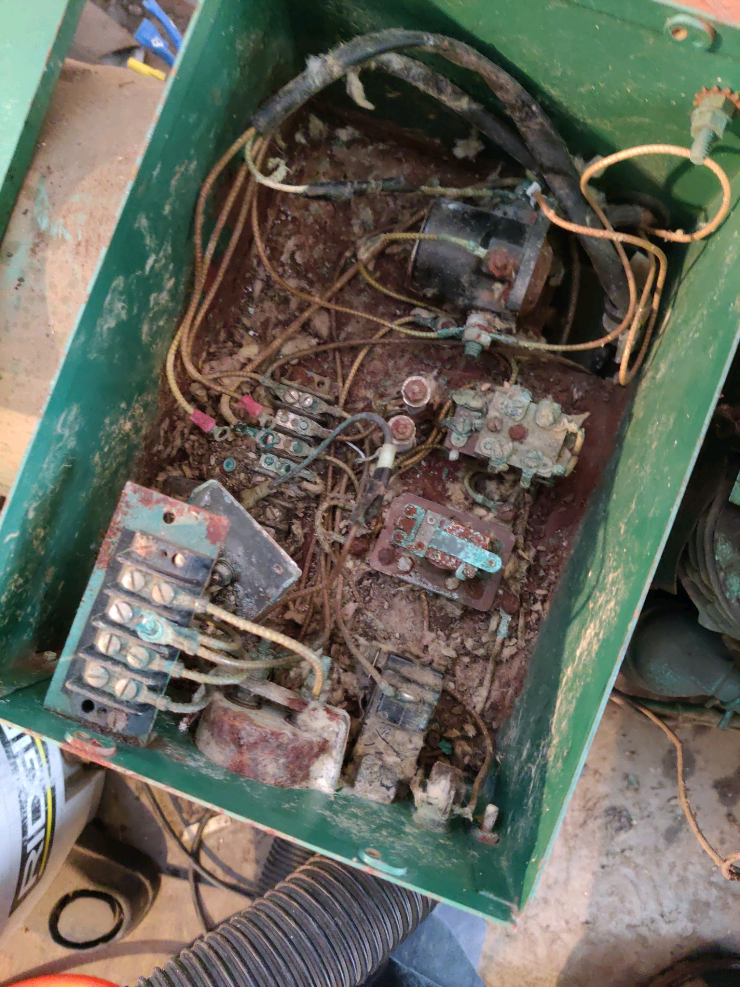

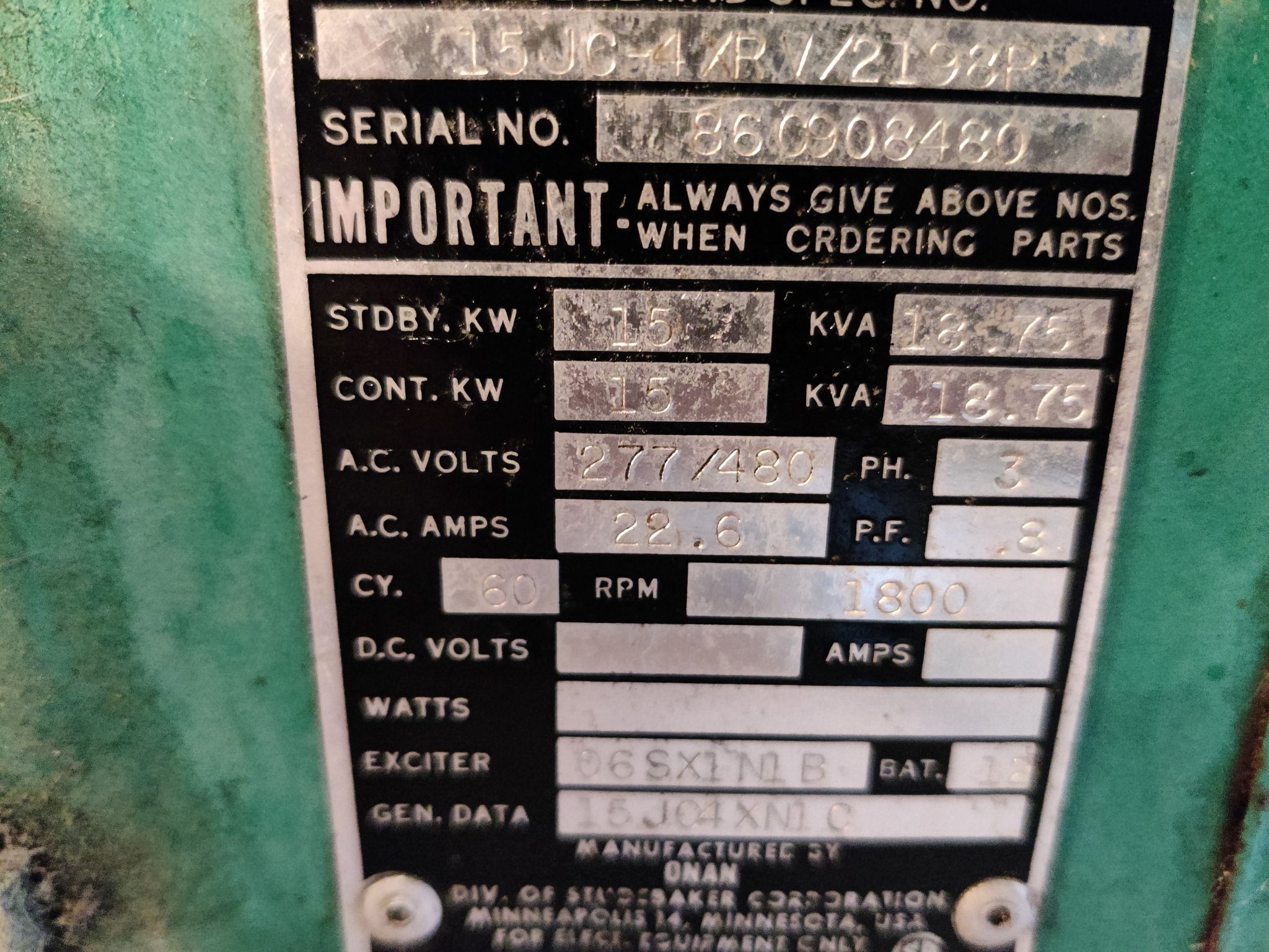

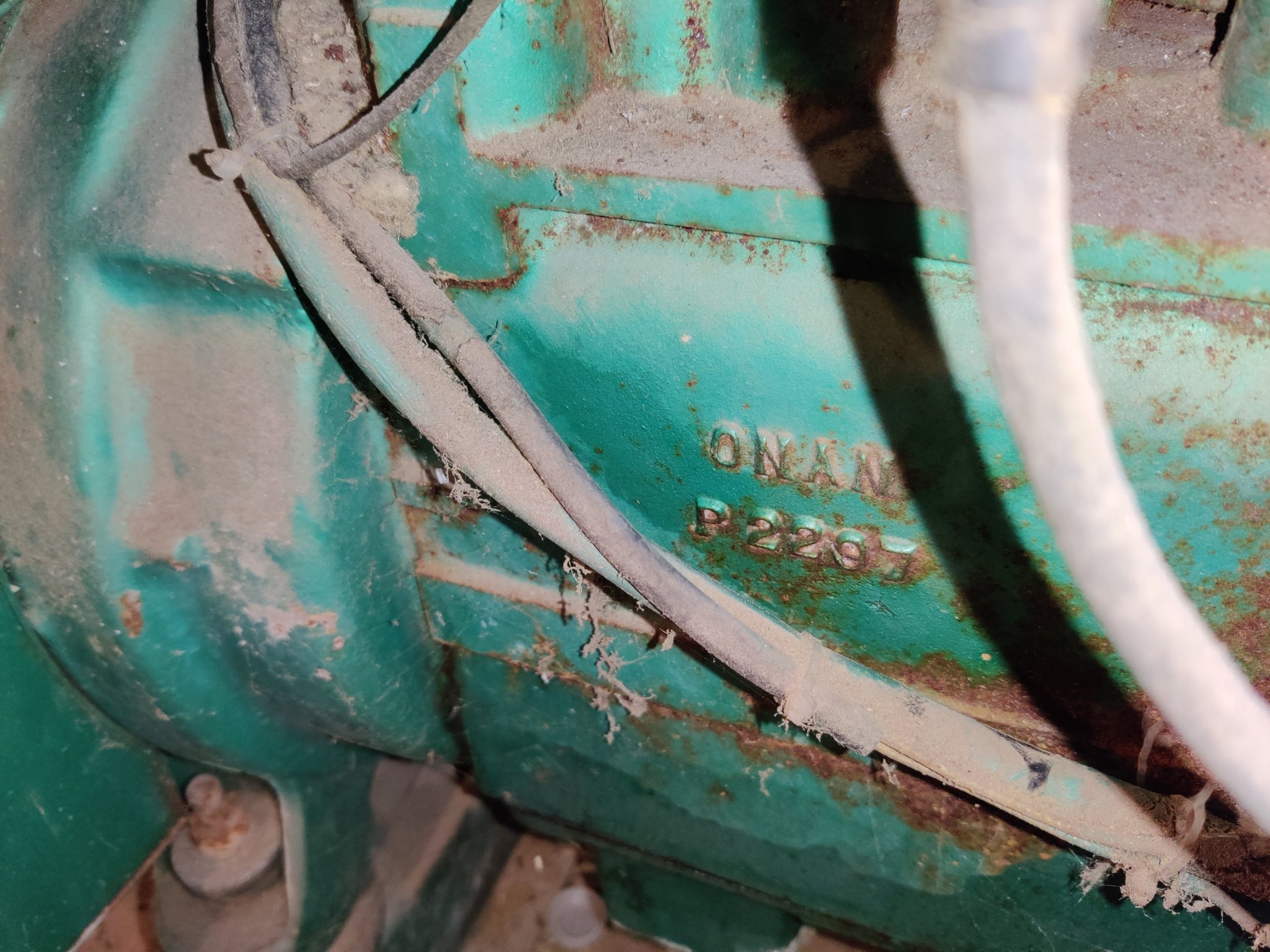

New here, looking for help.
I have a older Onan 15kw propane generator. It's been sitting in my barn since I moved in over 7yrs ago. Never had to use it so was going to try and sell it but the box where you start it from.....I opened it up and mice have completely destroyed all the internal electrical components. does anyone know where I can find a new box, or new internals so I can rebuild it?
Thanks.
Onan would be a great start.
Find a local authorized service company.
