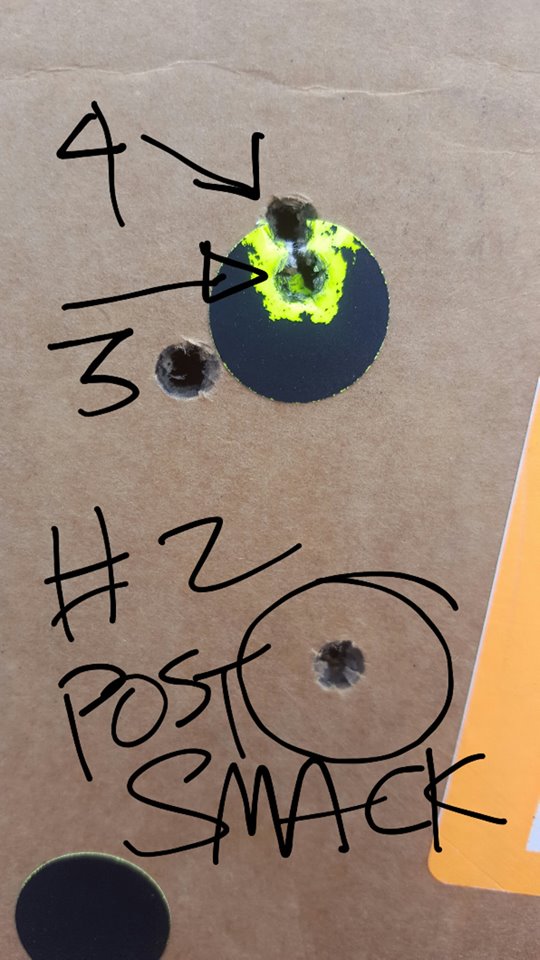

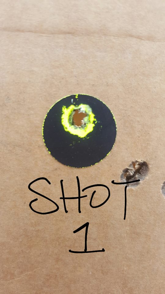

So, I didn't do a whole lot of testing, cause one really solid whack moved mine. Who knows if it is Barloc, rifle chassis not bedded, or what. This happened.
#1 is my first shot into the dot.
whacked barrel really hard
#2 is my second shot at a new dot (down low)
#3 and 4 were follow up and were back on the new dot.
I guess the moral of the story is really smashing your barrel can change POI. But, for me one shot put it right back. I never had any issues at matches, and didn't recognize any issues from tossing the rifle in the back seat of the truck in a soft case.
7040897
7040898
View attachment 7040897View attachment 7040898
Pretty substantial move.
Interesting as it tried to migrate back.

I am surprised ARC has been silent on this. I think a few hours in their shop would determine if normal banging around would change anything.
When I installed mine before this issue came up, I torqued and loosened the Barloc several times to stretch, form or whatever you might call it, the threads. I do the same when installing AR barrels.
I wonder if the POI shift can be eliminated by retorquing after shooting a few rounds to get everything settled in.
I’ve yet to do a bang test on any of my 4 barrels or my buddies Barloc setup but there is no doubt they can shoot if semi taken care of. This group was shot with a savage Pre-Fit and Barloc barrel nut from a new shooter on his second time out shooting at my range with factory ammo. I wonder if there there is any POI variation between a Barloc shouldered barrel and savage Pre-Fit style with Barloc nut and everything else being equal?

Maybe - but probably not. It’s an axial cone and they will move. And then attempt to recenter themselves.
It’s worse the closer to the center the main cone contact patch is.
One thing that may cause this behavior to abate is by machining steps in the cones.
Or using a different surface finish. Or going the other way and lubing the interface.
Mine was well lubed on all surfaces with Break Free upon installation. I haven't tried banging it and don't plan to make any changes on that rifle unless there is a factory fix from ARC.
