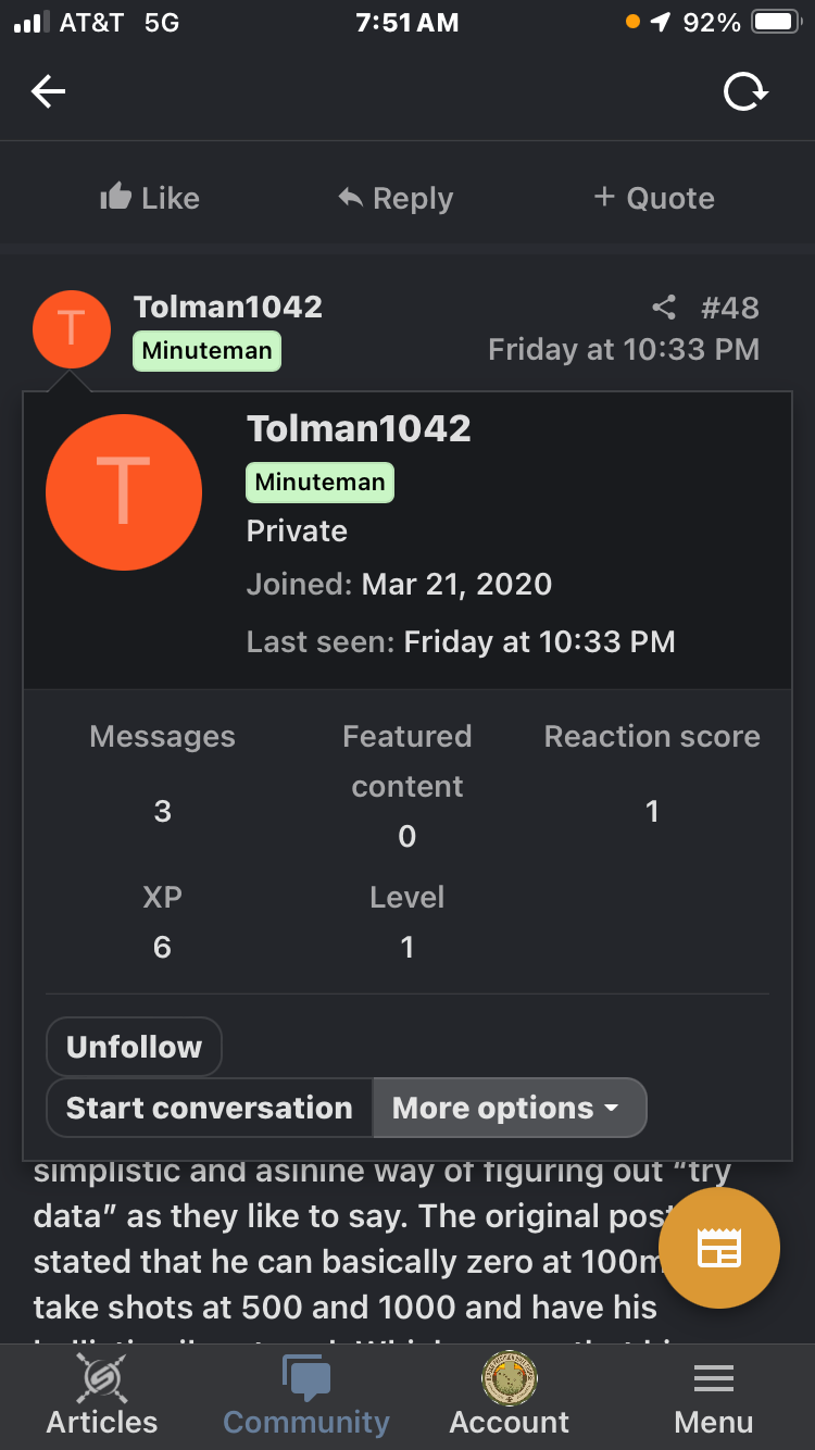

You must be the guy we use as an example in the classroom who claims to know his data "without ever firing a shot". We'll refer to you as @Tolman1042 from now on and you'll be famous.I have been reading a bunch of posts on GB and the more things like this that I read the more I believe the people who developed GB don’t actually understand how to use a ballistic solver. And because they can’t use a ballistic solver like AB they have developed the most simplistic and asinine way of figuring out “try data” as they like to say. The original poster stated that he can basically zero at 100m, then take shots at 500 and 1000 and have his ballistic silver trued. Which means that his ballistic solver will have accurate holds for any distance out to subsonic and you claim that he wastes too much time in his solver? You waste way more time firing at every even hundred yard line and doing your GB math which will inevitably almost always be wrong. Maybe it won’t be wrong enough to put you off target (depending on the size of the target) but it will still be wrong. There are so many more things than gravity that matter and the way you are selling this does a huge disservice to those that want to be able to go out and shoot accurately at varying distances. Here’s a simple example: if someone use your GB for a 6.5CM on their “home range” and it is 60 degrees outside their data at 1000 will be 10.7 mils. So they went thru your ridiculous table and wasted a minimum of 20 rounds (if everything works out perfectly and they get 2 solid hits on the waterline using your math) getting all of their “non-theoretical” real-life hits at every even hundred yard line. So the shooter now has everything written down and “knows” that 10.7 mils gets hits at 1000m. Now he comes back to his “home range” and goes to shoot at the same 1000m target and puts 10.7 mils on it and misses high because the temperature is now 90 degrees and he only needs to hold 10.3 mils to hit the 12” circle at 1000m. And high misses are always harder to see than low misses, so he might just think it’s wind to begin with because you claim this GB works. And then he wastes a bunch more shots before he figures it out. Whereas if the shooter just learned how to use a ballistic solver and use it correctly, he wouldn’t have this issue. I have been shooting for 2 decades, and however this might have been useful 2 decades ago, it is utterly ridiculous to pretend that this is something that plays any role in shooting today. I am a huge fan of Applied Ballistics, but I would be willing to say that any notable ballistics solver is better than this. Just pick one and learn how to use it (AB, GeoBallistics, strelok, 4dof) and you will never go wrong. Ballistic solvers aren’t theory, this stupid GB is “theory”. Ballistics solvers use advanced equations of projectiles in motion to develop a ballistic trajectory and they do it extremely well. There’s a reason special operations use Applied Ballistics; it’s because it works to give you a solution that will hit your target. Ballistic solvers take into account temperature, humidity, barometric pressure, the zero distance, muzzle velocity, bullet weight, diameter and form factor (shape), ballistic coefficient, gyroscopic stability, angle of attack of the projectile, pitch, yaw, aerodynamic jump, wind, inclination angle, air density, etc. Ballistic solvers work, you put in good information and they spit out good holds, period. Don’t let people who developed a poor idea to help them boost their teaching career and make money off of the poor idea tell you that ballistic solvers are some useless “theory” and act as if their simple math is going to save you time and ammunition. Because it won’t, ballistic solvers that are used properly will save you much more time and ammunition over the ridiculous Gravity Ballistics 3rd grade math problem. Ballistic solvers will also help you miss less, allow you to compare different calibers, bullets, muzzle velocities, etc without ever even having to fire a shot. You can also use them to see how different variables will affect your holds. Ballistic solvers have so many uses that you could literally write a book talking about all of the advantages of them.

@Lowlight, we found him. LOL
