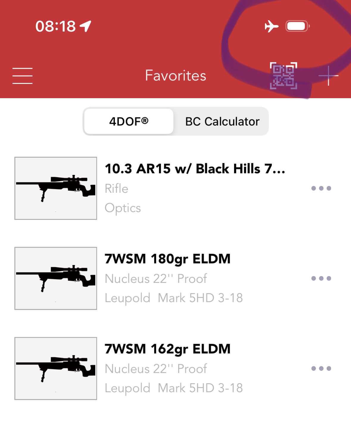

4DOF (on mobile) also requires an internet connection. So if you are in bum fucked Egypt you are just fucked
Click “continue without account” ;)

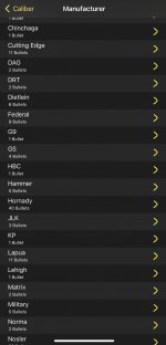

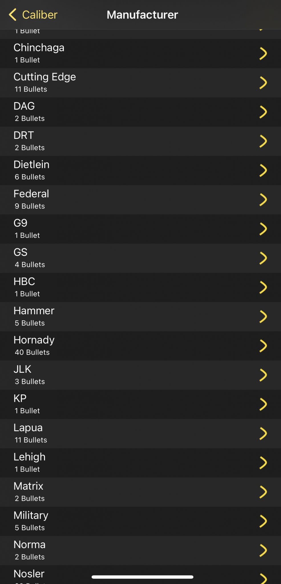

4. 4DOF has less choice than AB (eg the 4DOF kestrel has restricted functionality, less projectiles in the library).

I think 4dof has Sierra, Berger, lapua and like two others and are limited on projectiles for those.
