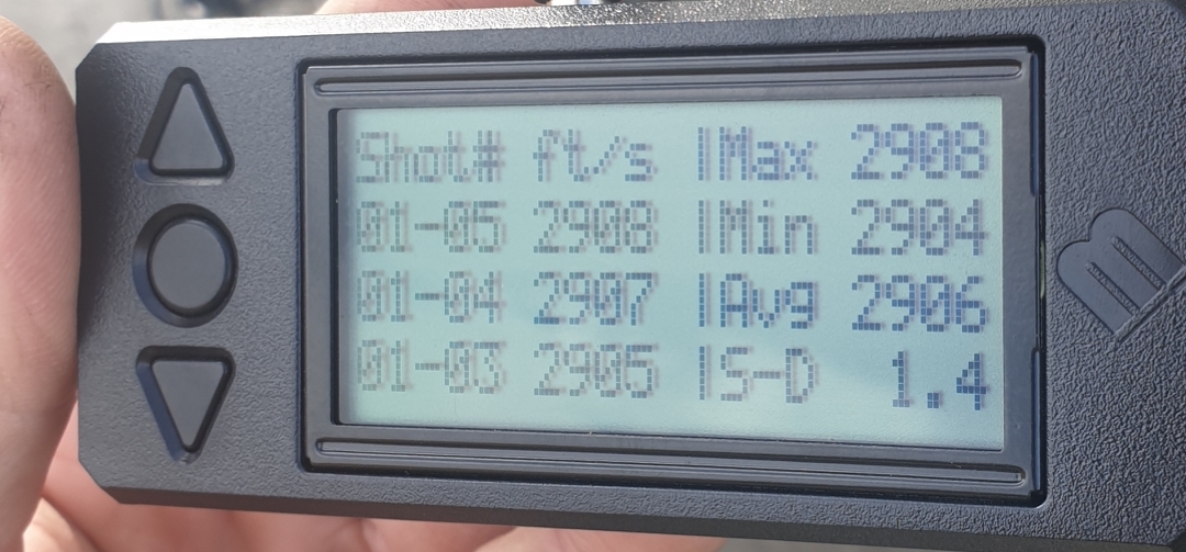

    changed primer from cci to federal 215 and that improved the speed were getting 2689 fps on the 300 grain.

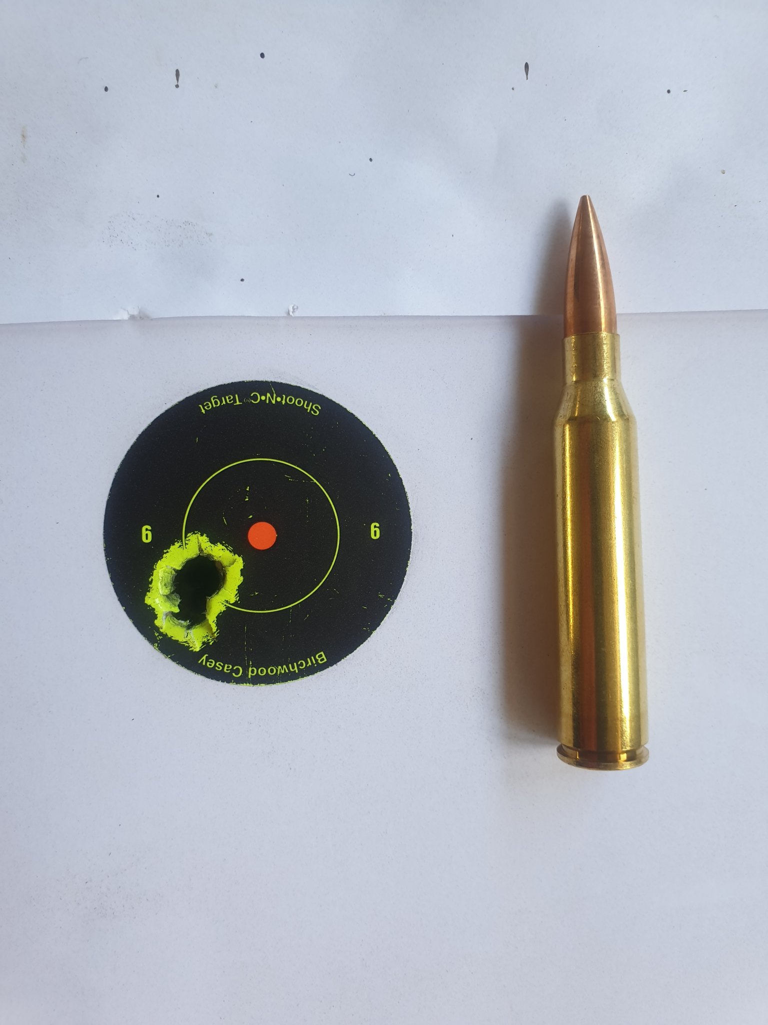

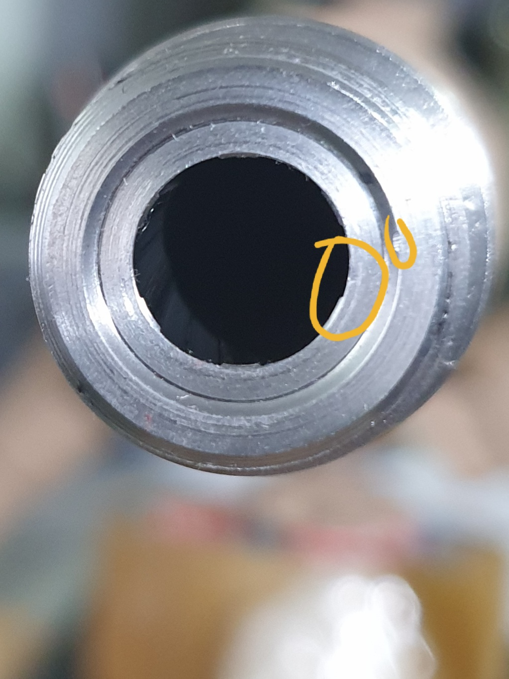

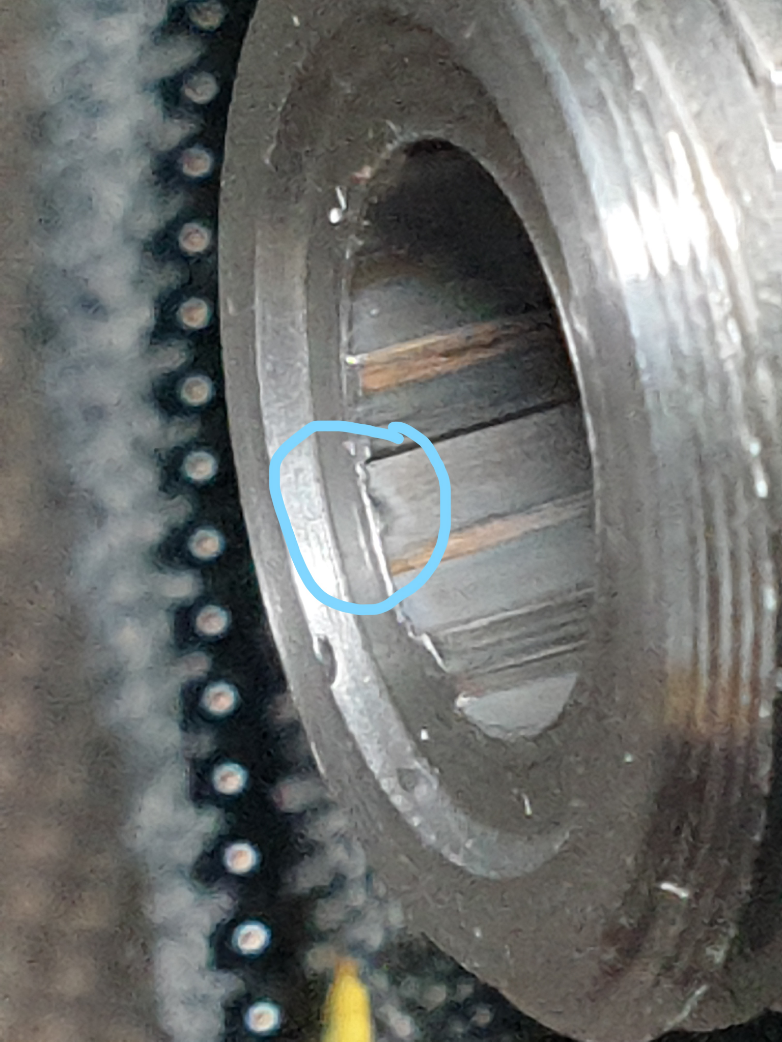

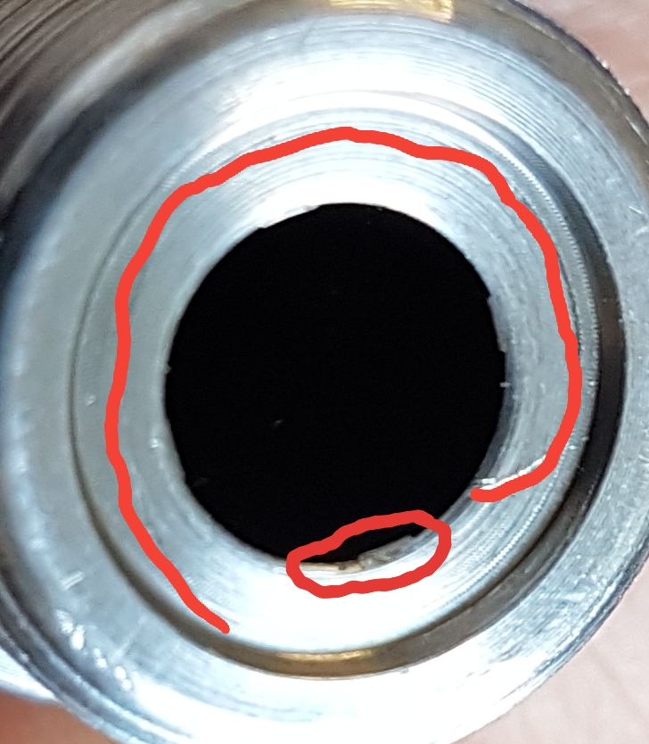

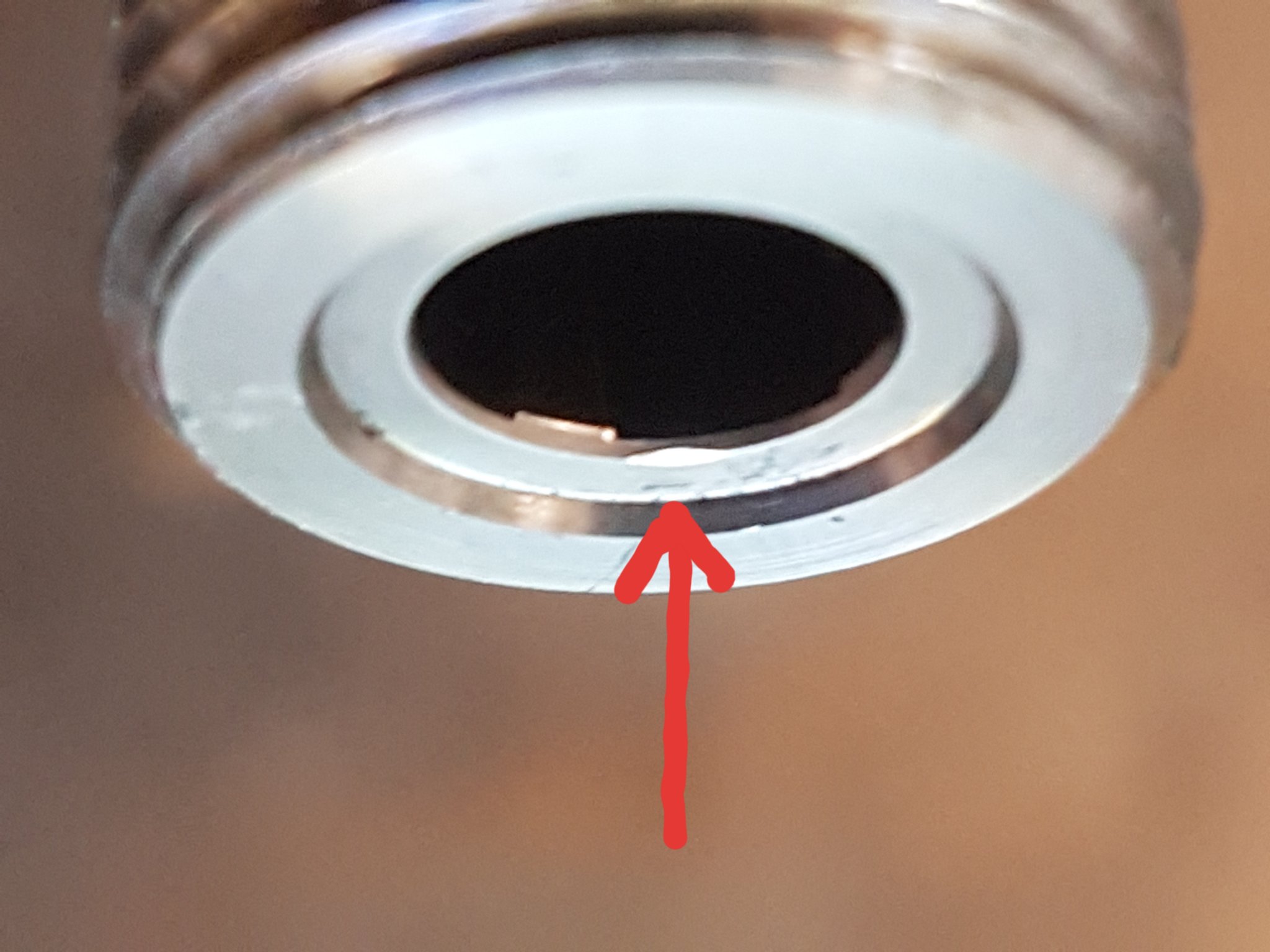

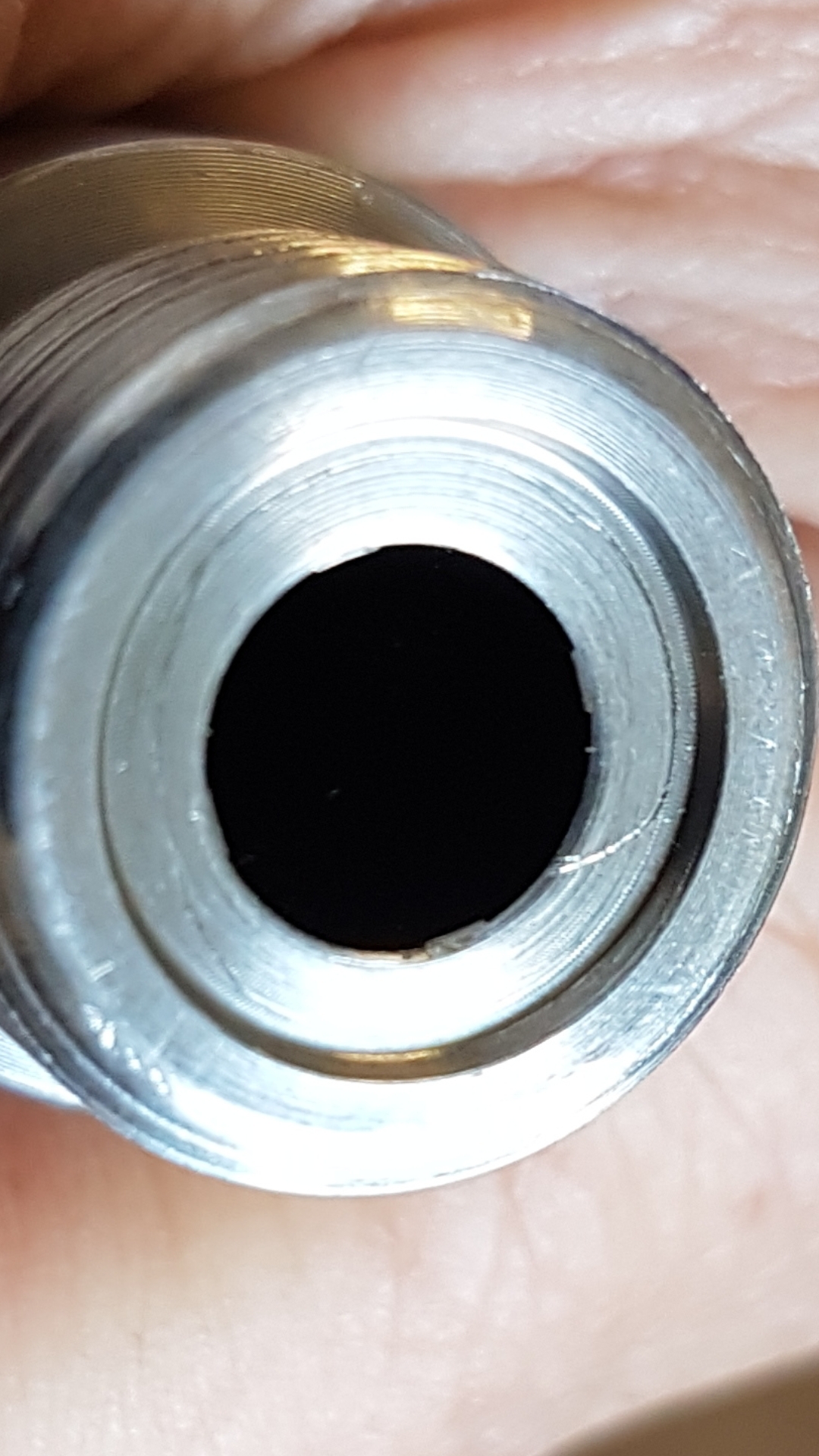

    I did not notice an powder residue (i had this question asked) on the fired cases.
    but i did notice an extraction mark on the case. will take pictures and put up for you guys to see.
    it was doing this from the beginning just didn't think much of it then. Now it is marking the Lapua cases.

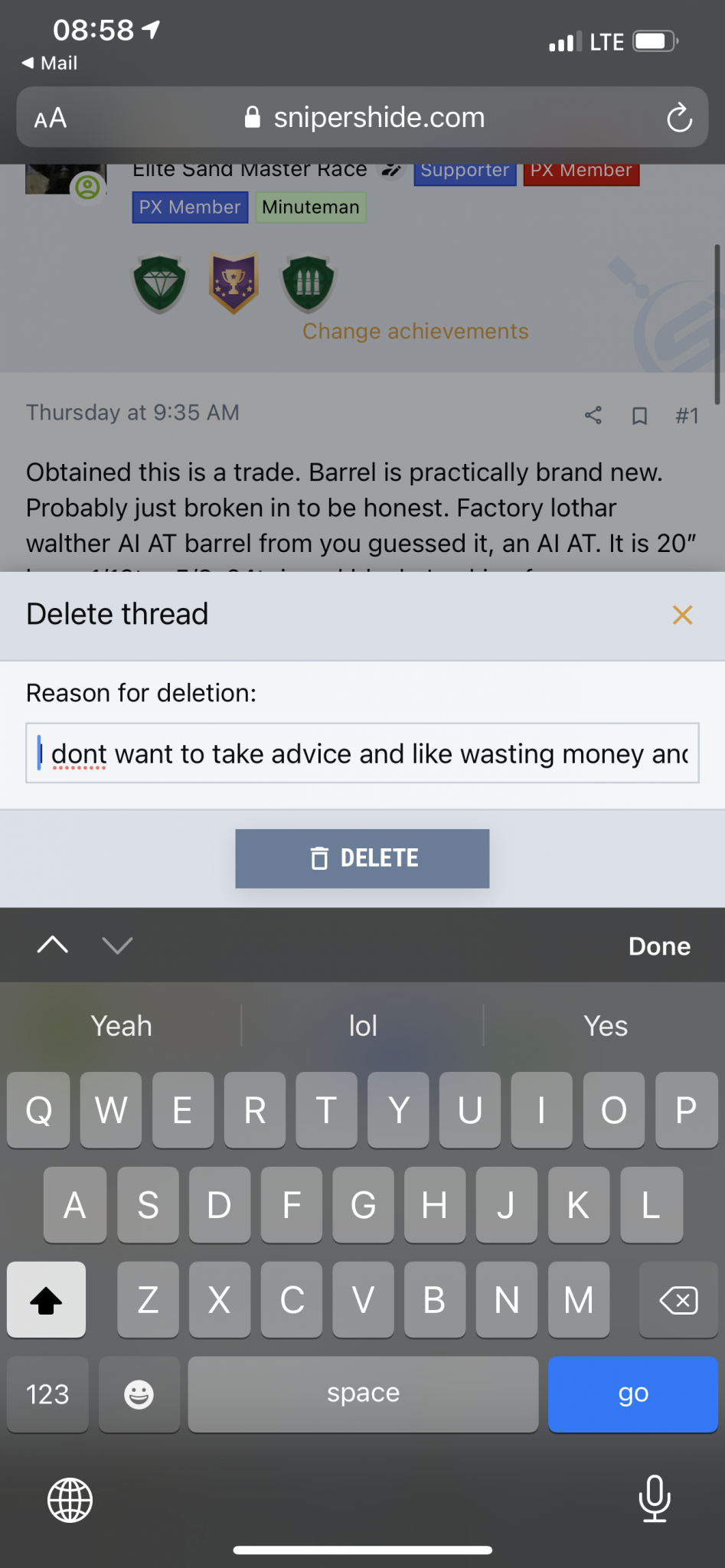

    you know what you are wright i should tap out.

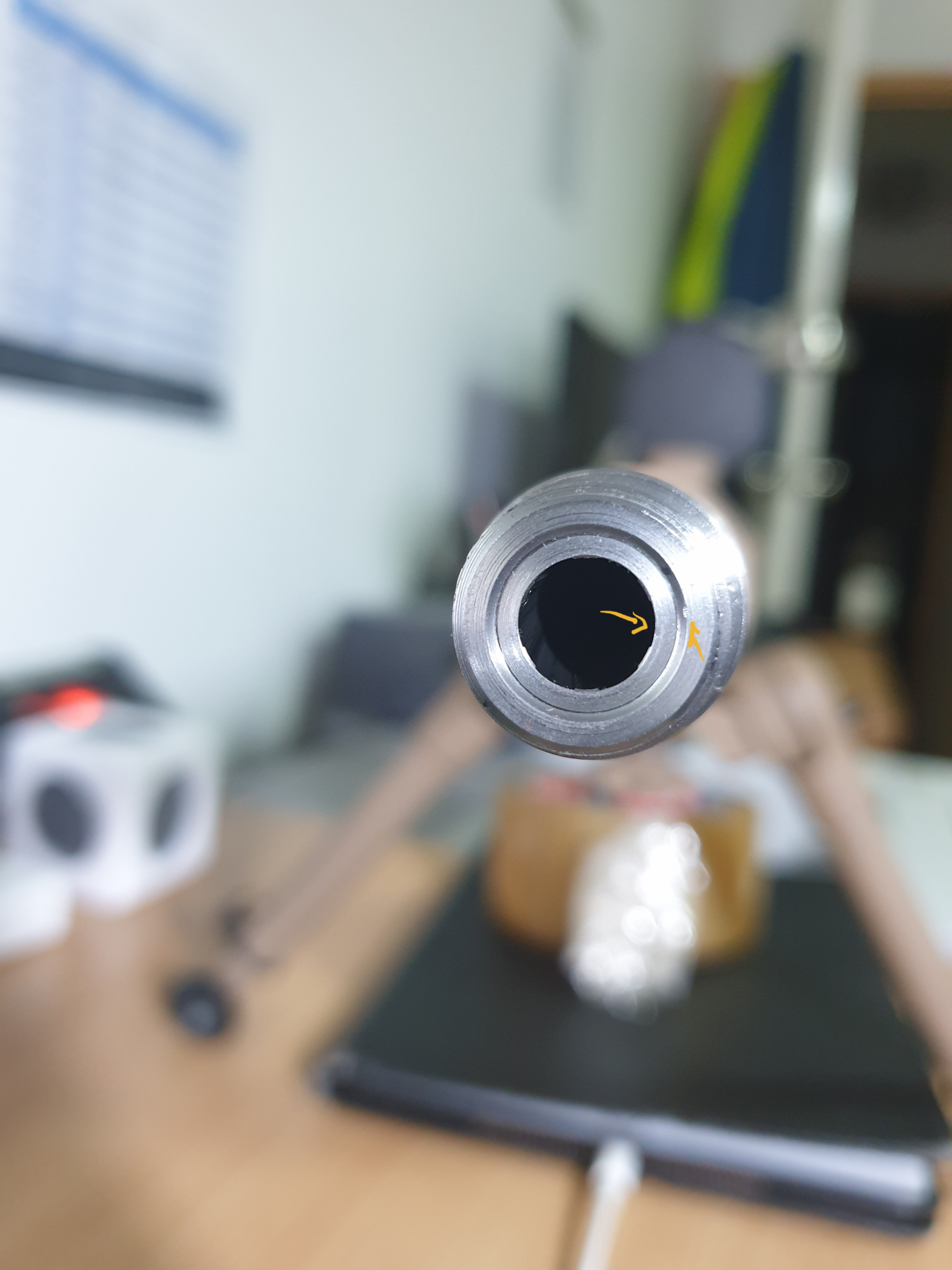

    i had a look at the crown and saw a very small dint not as big. I will take a pic and send.
    You can tell me what you think

    ok we did 3 shot groups (shoot 3 rounds, load another three alter powder and shoot again) we shot all day.
    it would shoot two shots with in an inch (from center to center) and then the 3rd would pull off a bit and make it about an inch to two inches edge to edge (not center)
    The last test we did is the load that i am going to use this weekend.
    3 shots would just make an inch 1 moa. We measured that group center to center and it was .6 (just over half inch).
    we didn't really care to be exact. just load and see how they grouped.
    did not take an pictures. Will take pictures this weekend.
    i always like to do 5 shot groups but the wanted 3.

    Yea I get your obsession over small groups but if further load development didn’t result in any improvement and it consistently shoots .6-.7ish and otherwise functions as it should, no visible defects in the barrel, I’d roll with it.
    Spend your time shooting at the distances that cartridge was meant for vs agonizing over group sizes at 100m.

    Haha, that group looked like it was shot out of an old school pistol grip mossburg 12 gauge from the hip. I was referring to the .6” group he shot more recently with hand loads as mentioned in his post I quoted.

    it doesn't look that bad. but it looks like the blast hits it a bit and it is slowly burning it
    just ammo at this test
    the barrel was taken of and cleaned the contact area.
    That is it.
    Oh we did find that the seating die that i had was bad. concentricity way out.
    So we used their dies. Did 3 round loads changing just powder weight.
    then found a consistent group. (not the best but group about .6)
    Still testing though.
    That is the story up to now.
    oh i also got some Redding dies for it.

    i am not able to get online as often as i would like.
    it will probably be more like two weeks before I can answer some times.
    I don't really have much to share yet apart from that others shot the gun and got the same bad results.
    I did get some info about a crown and barrel issue that a member had.
    I had looked at the crown but i was not too sure as what would be not good.
    so I have put some pics up with markings.
    This Saturday i will get some testing done (swap the scope over and see how that goes).
    it is late here now so i will call it a day.

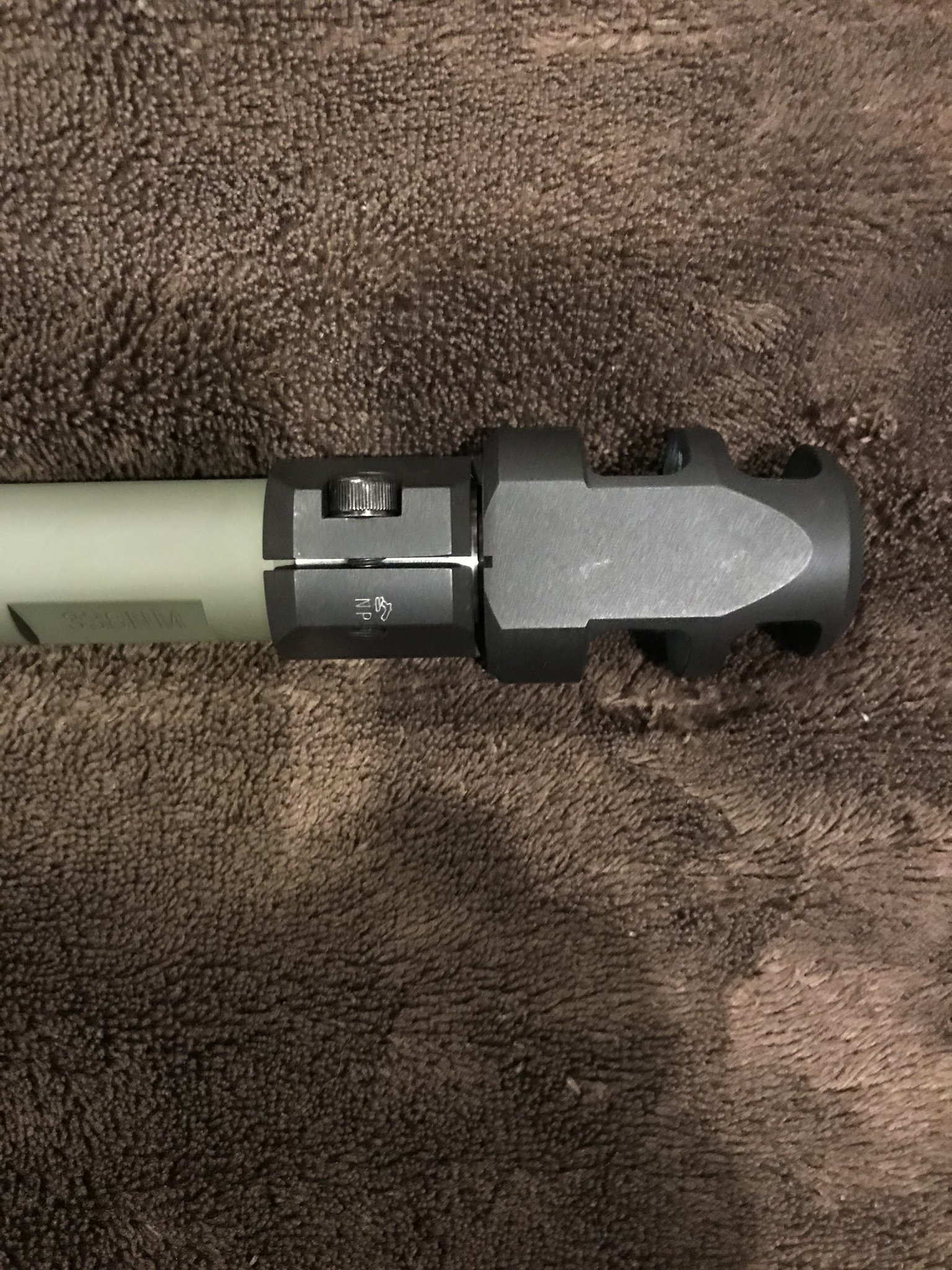

    It appears that the threading on your barrel is substantially different than mine.
    Mine is a Dave Tooley .338 LM barrel made for the PSR.
    Our barrels are supposed to be interchangeable, but the treading on yours looks different than any PSR or AXMC barrel I’ve seen.
    His pic is showing the crown, yours is the shank/tenon

    Stop wasting your time with 285-300g projectiles, your rifle clearly doesn't like them. I tried 285ELDs in my AX338 and they shot like shit (almost 1.5-2" at 100m).
    Factory 250g Swiss RUAG, my AX338 does this all day, every day...
