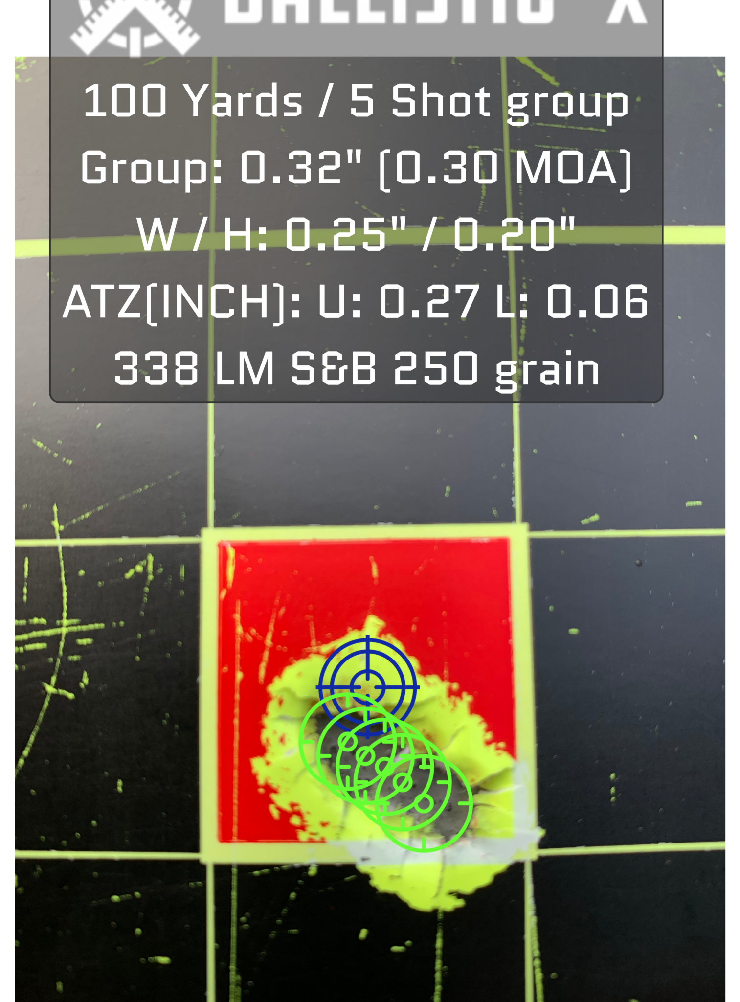

Factory 250g Swiss RUAG, my AX338 does this all day, every day...
With bottom of the barrel S&B 250 grain ammo
Not saying it does this every time but it is pretty damn close. If I use high end Bergers with 250 grain scenarios, I have shot 0.3 MOA at 300 yards on more than a couple of occasions. I don't reload.

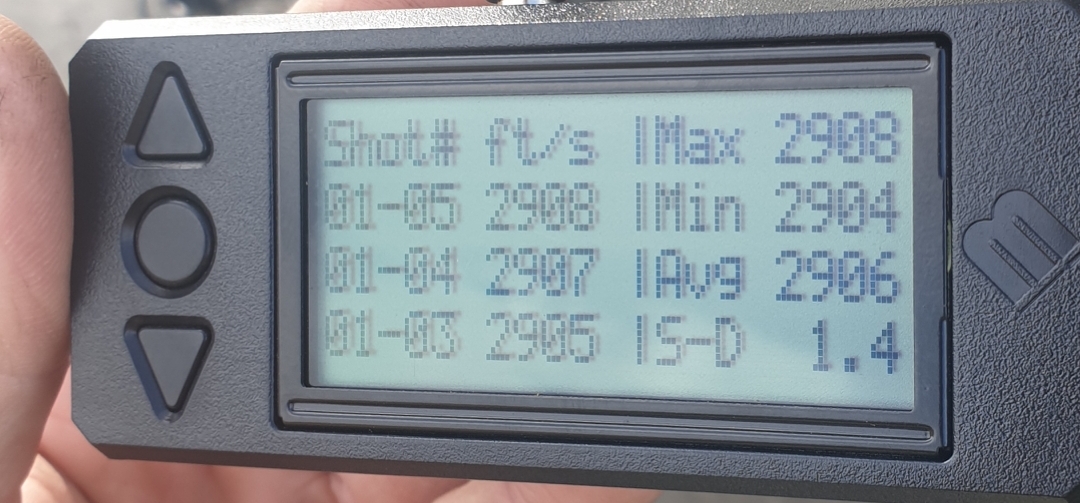

And that's not running fast, that is the normal expected factory 250g speed.
Try listening to AI owners who have 338LMs and experience.
XYZ bullets are very relevant. I could never get the 285s (factory or handloads) to shoot. At best they were 1.5" at 100m, and it had nothing to do with the rifle or my shooting ability (got a few Army International Medals).
Combine a projectile that doesn't shoot well with an inexperienced shooter and you have terrible groups.
FYI our Military along with many others use 250g projectiles in their 338LM Sniper Rifles. Do the math, slow high BC doesn't equal better.
As for my AIs 'Pet' handload I'm shooting 250g SMKs at 2985fps with an SD of 3.

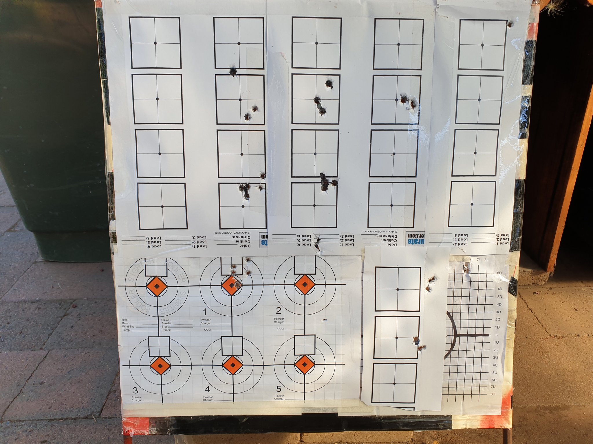

Ok getting so light projectiles 250grain and 265 that I have.
Did some 300 grain loads as per the previous test last Sunday.
This what it shot now
To take the shooter out of the equation three of us are shooting it. Two are competition shooters.
I want to thank Harveyn for coming out and having a try and helping.
This time it shot a lot better.
The only thing that has been changed has been the barrel taken off and then screwed back on.
The muzzle break has been taken off and on.
It has now shot more than 120 rounds.
From the left:
Second row second box and 3rd are with norma 300 grain. I shot the second box that was my fault must have pulled the last shot.
The fourth row second box and 3rd box are my loads of 300 grain Sierra. I shot the 3rd box.
The 2 boxs at the bottom right are 3 shots each of the 265 grain projectil (my load).
Anyway it is shooting realy better than before.
We all have no idea why it is shooting this way now.
The only thing is maybe the barrel cleaned out or fitted correctly with the refit.
For now that is it.
Oh shot the gong at 512 meters. Did 5 shots and got 5 hits ( they said the gong is 6inches i will go next week and measure it ).
Waiting for some factory ammo 250grain.

Yep would be good.
I am starting to think it might have been me. But it did the same to another shooter. But it has been getting better.
Now it shoots better.
I give up I have no idea.
I got 5 shots at the 6 inch gong at 512 meters so that is ok.
Will try lighter projectiles too.
I looked at the crown again and that has smoothed out a lot.
I have no idea but will check the next 100 rounds. It is much better now.
Thanks for the suggestions. A lot of the boys recommend going lighter and I will go for the lighter.

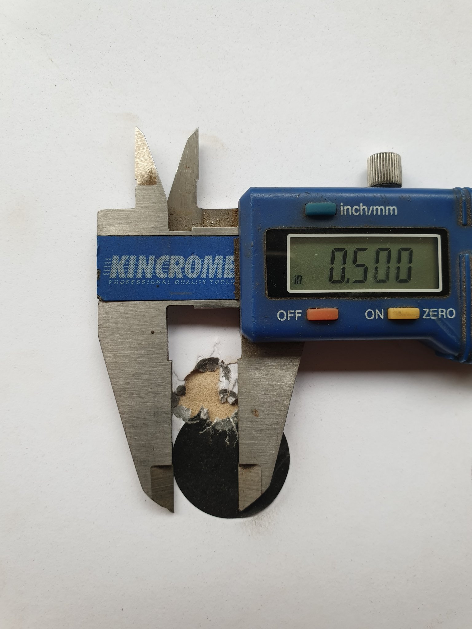

Sorry some one asked the size of the squares
I just measured them now
They are 55mm squares.
The circles are 3 inch diameter and the square top one in the circle is one inch (4 smaller squares one).
