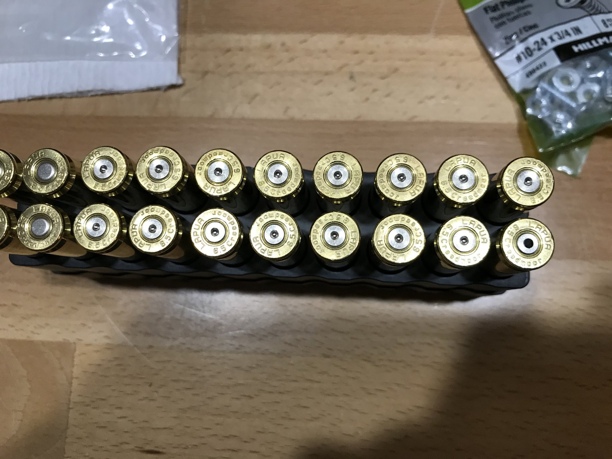

I’m no help. I had one of mine out in 6.5 config today trying out the Berger factory 144gr load. I’m guessing I ran into the Large Firing Pin issue. These jokers averaged 2878 MV (high of 2897) with a 144gr bullet in a FACTORY 6.5 load. Check out the bottom row, far right. You can see right through it
I’m no help. I had one of mine out in 6.5 config today trying out the Berger factory 144gr load. I’m guessing I ran into the Large Firing Pin issue. These jokers averaged 2878 MV (high of 2897) with a 144gr bullet in a FACTORY 6.5 load. Check out the bottom row, far right. You can see right through it View attachment 7563558
And super light primer strikes on the four rounds on the left! 😱

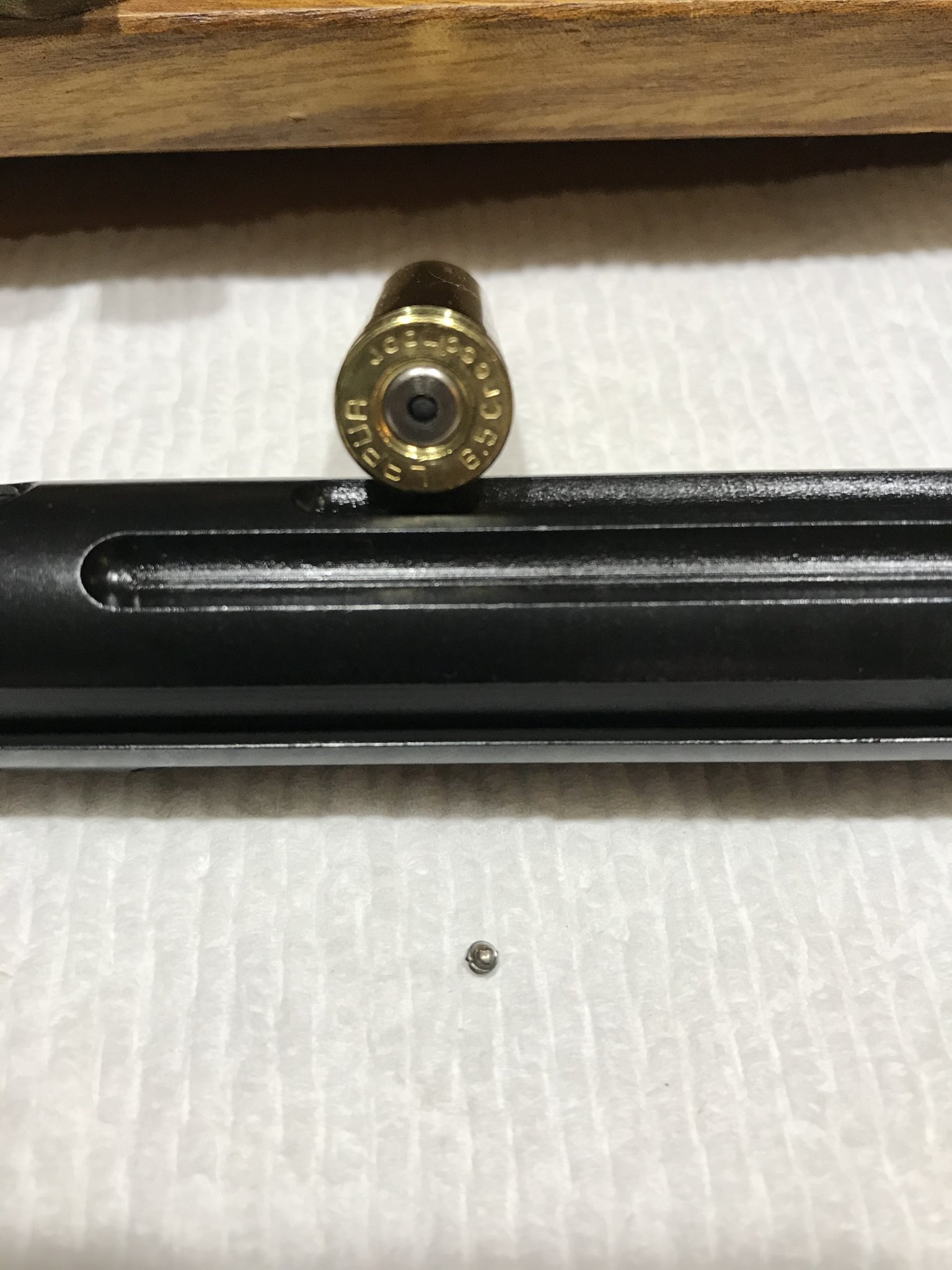

And I found this little guy (foreground) hanging out inside the bolt when I got home. On one round the trigger failed to reset. I had no clue why, never had an issue with an AI trigger before. (I was unaware of the blown primer until I was collecting brass after the session - got no indication of when it happened). I had chambered a round mid-shot string and the trigger wasn't set. Odd - so I ejected the round, completely cycling the bolt, and re-checked it. Still no trigger. Re-cycled the bolt AND safety through their full range of positions and suddenly the trigger was back to normal. I re-loaded and continued the session without further trouble. As I said, I found the blown primer after the session was over, packing up. I figured that was definitely the cause of the trigger issue, but not exactly how. I was thinking pressure issues. On the way home I was telling @tnichols about it and he guessed a piece of the primer might be inside the bolt. "Yup, bet you're right!" Got home and removed the FP assembly, and Voila!
Check your firing pin tip... Really good chance you flame cut it

Yep, I didn’t get one to begin with because it seemed most of the problems were with 6.5x47 or really hot handloads. I was only planning on (comparatively mild) factory 6.5 CM loads and a LFP 308 bolt body was available at the time so I got it. Have put maybe 100-150 rounds of Hornady 140 ELDM through it with no trouble. But dang! These Berger factory rounds are pushing a 144 faster than a lot of .260 loads. Wasn’t counting on that...
