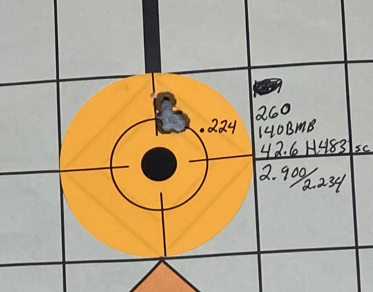

I have a savage 12. It shoots fine, sure, .75moa with my 6.5cm handloads. Running it though, that's a different story. Occasional feeding problems, frequent extraction problems. Sure, I can try to run it in a match, but I have zero confidence in it not tripping me up and make me hate life.
