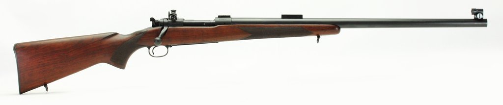

Winchester M70

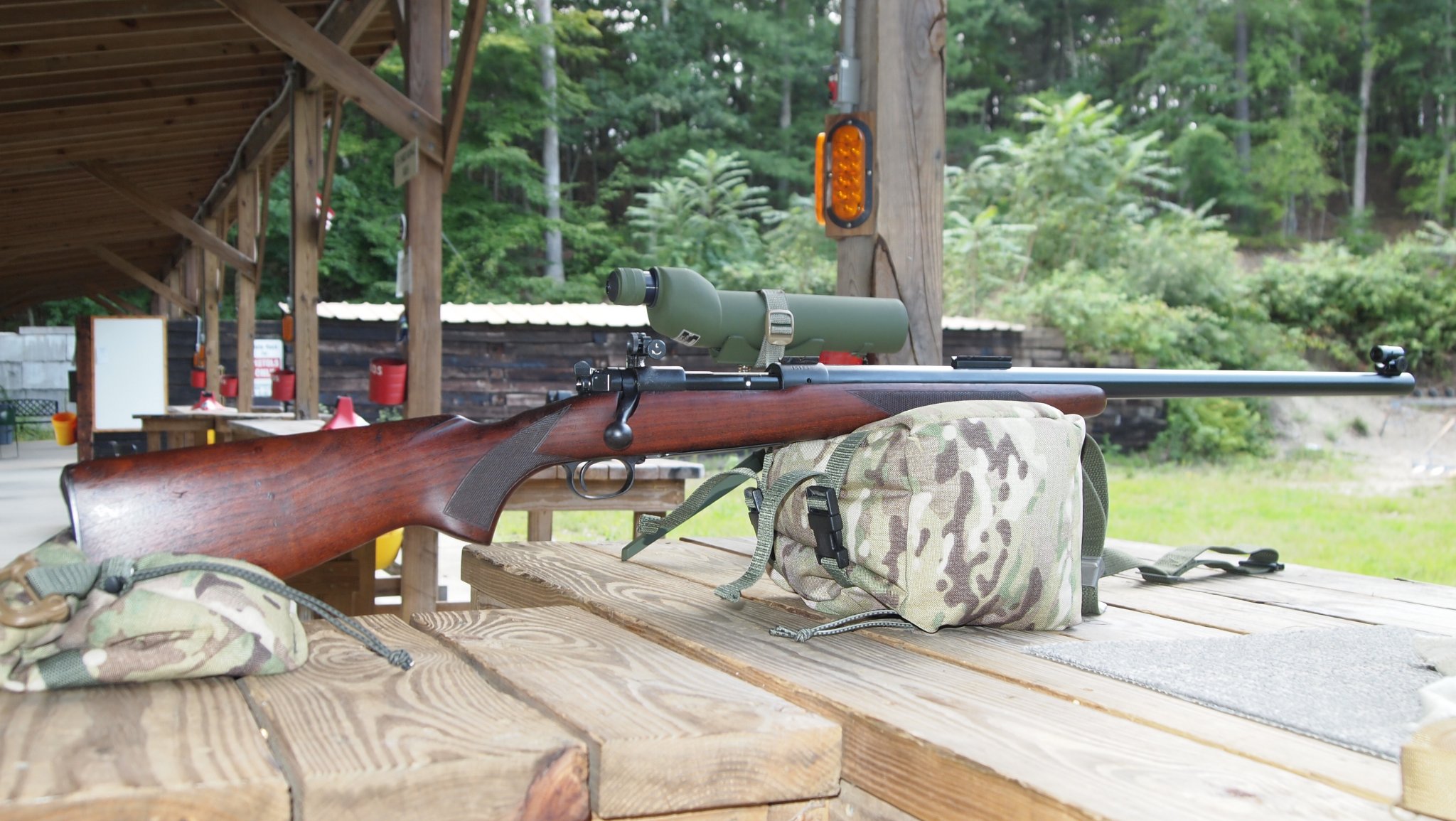

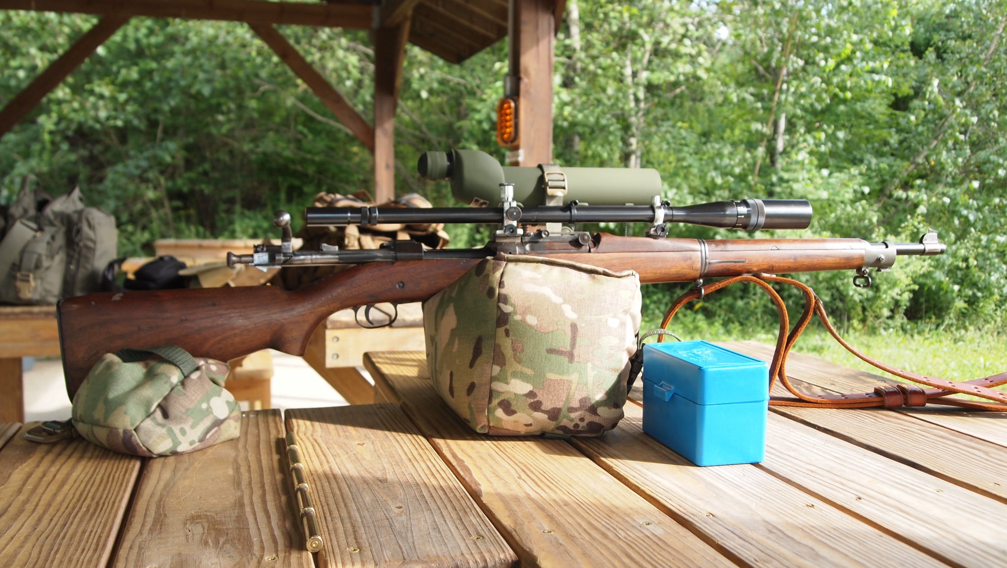

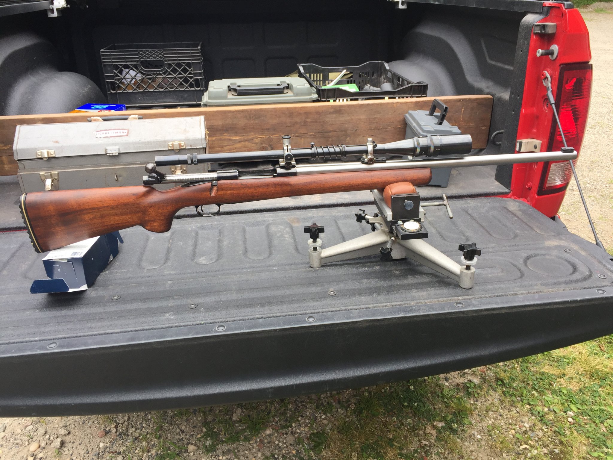

My M70, it's a post 64, Douglas bbl 30-06 Unertyl scope. Just had the barrel done so I need to coat it.
Pictures please...
Very nice.
You have the scope I have been searching for. What magnification?
USMC rifle teams left many of their barrels in the raw.

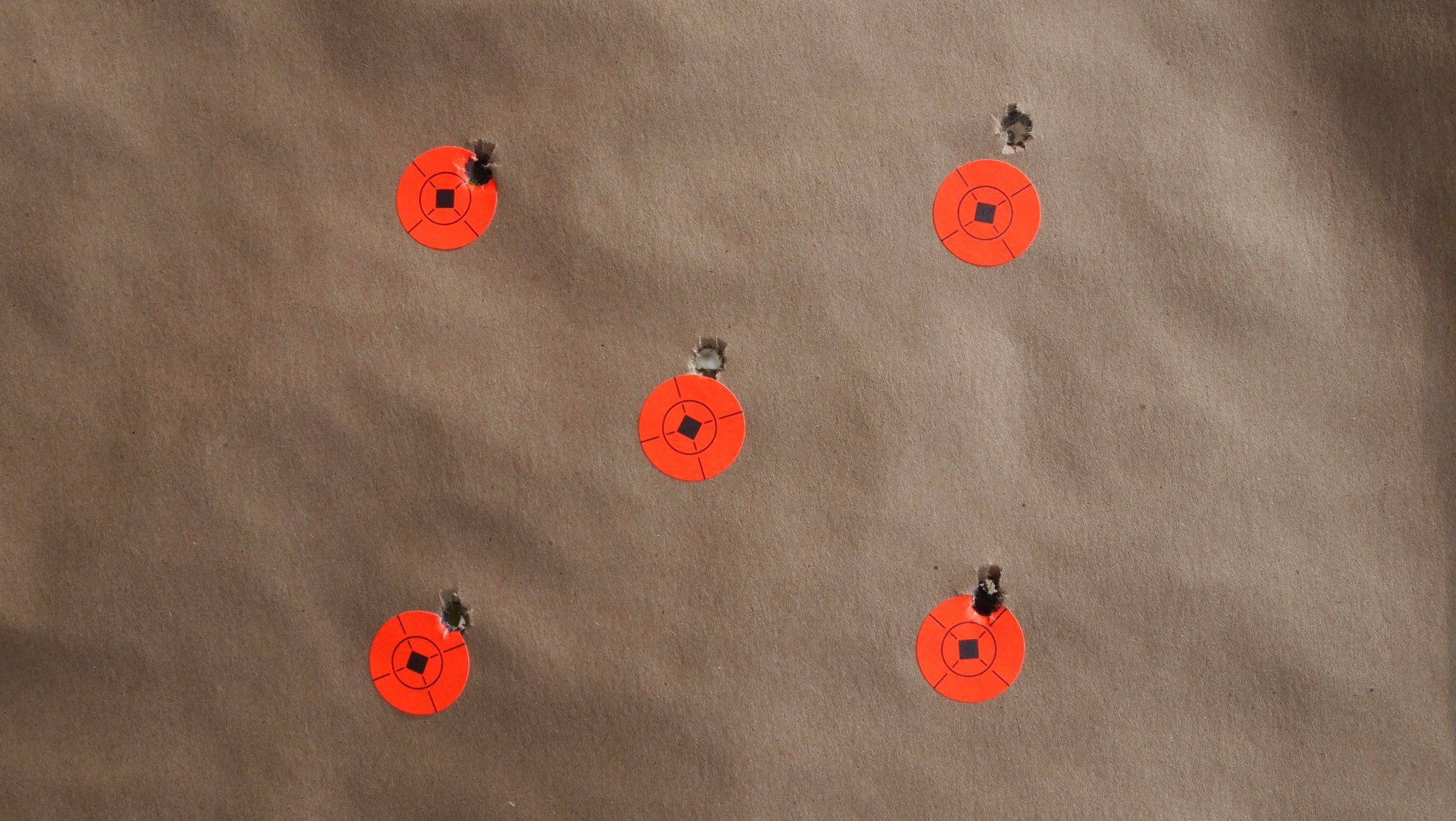

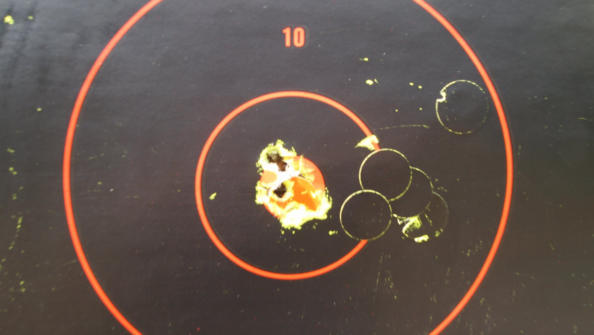

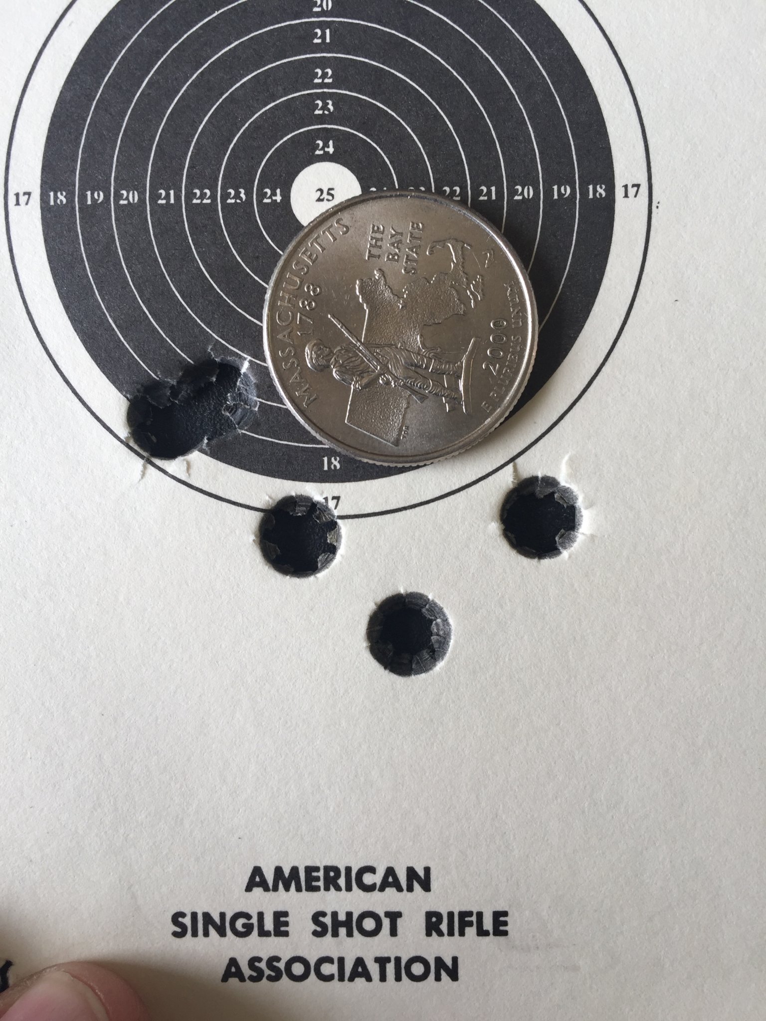

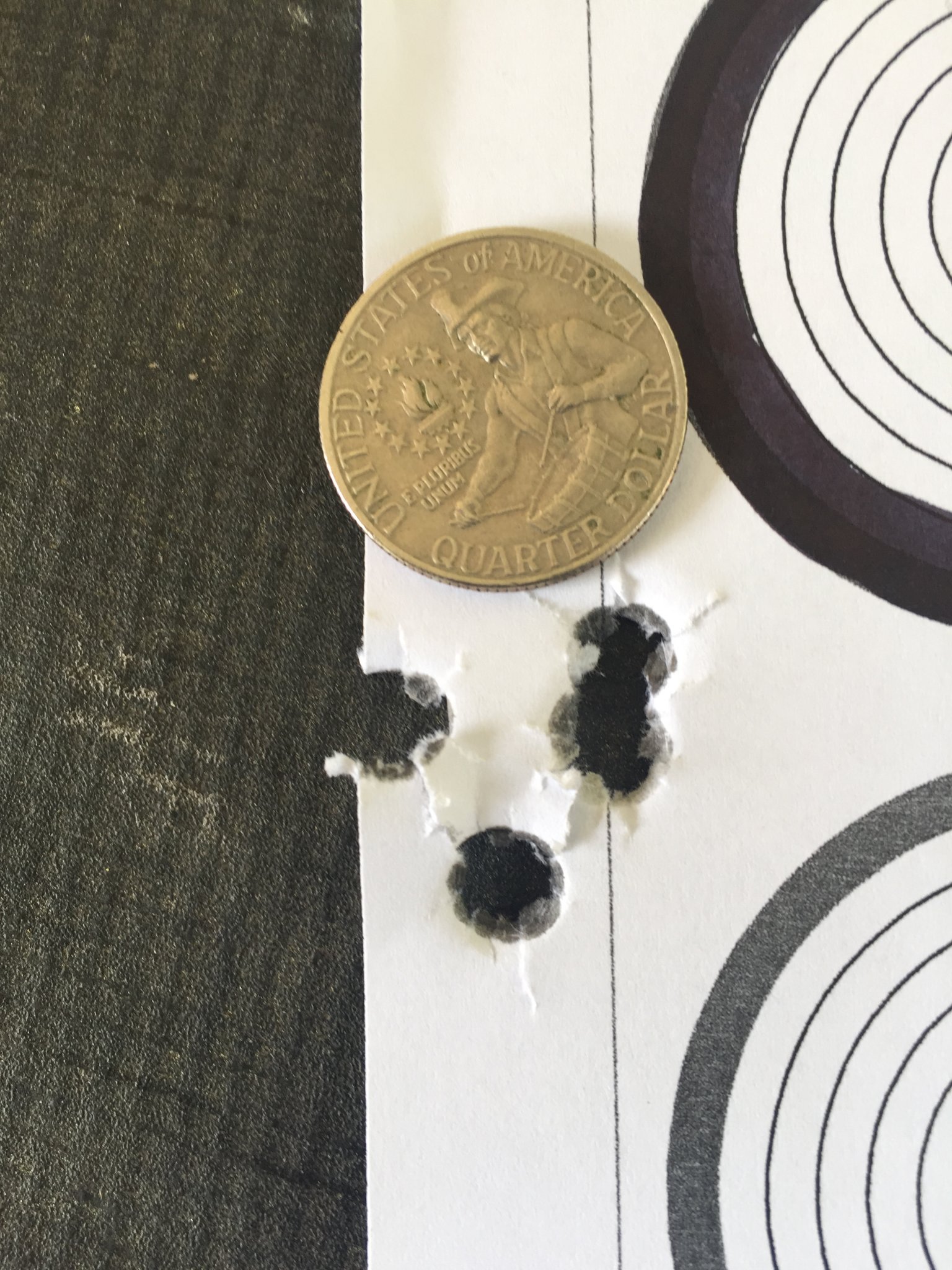

The first target is 168 smk and 47.4 gr 4064View attachment 6916838
This is LC Match
I go a little bit lighter with the powder load under a 168 but certainly yours does just fine at 47.4.

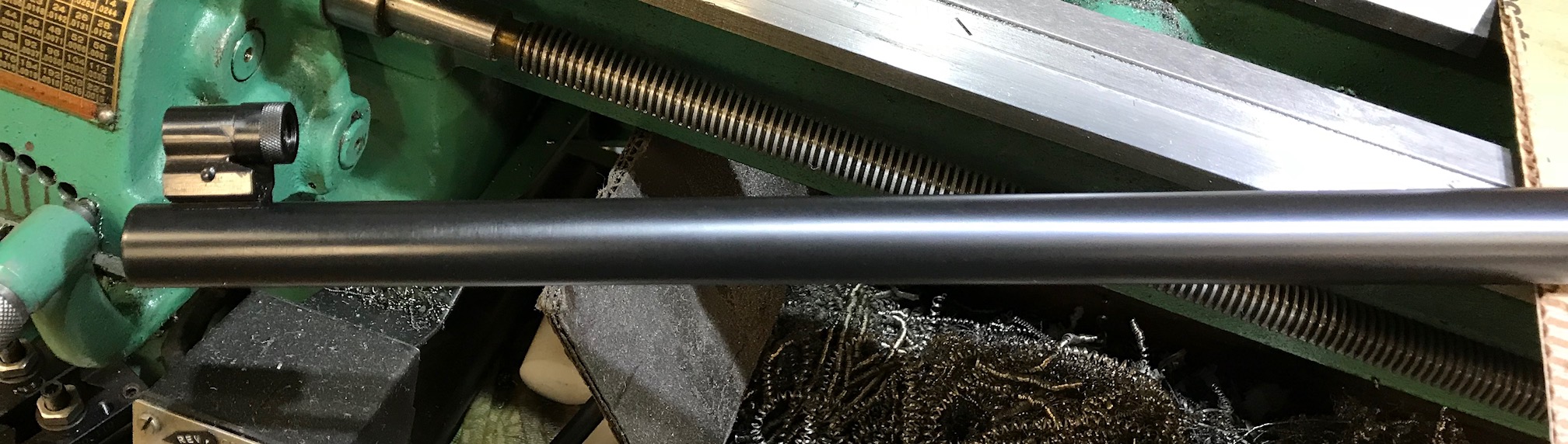

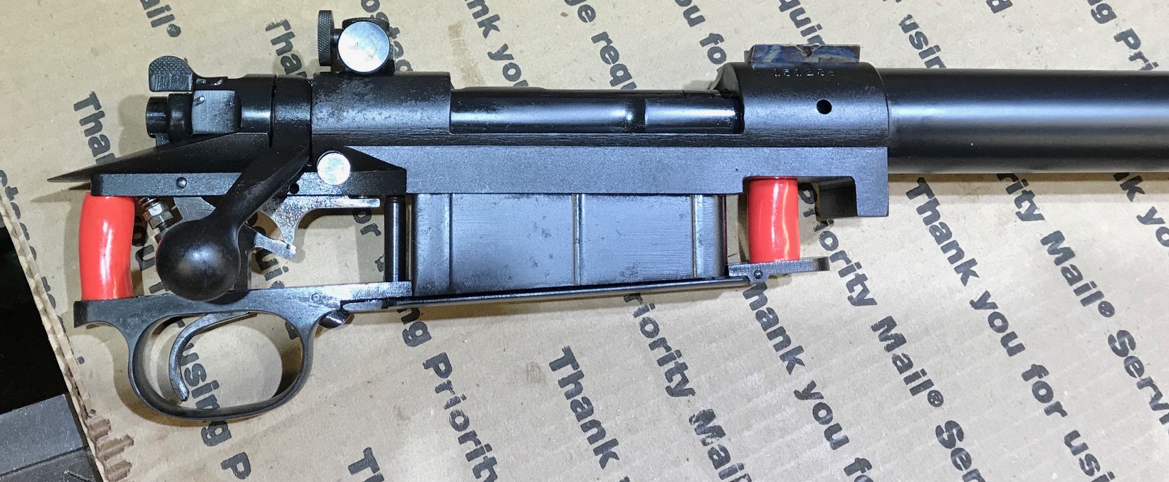

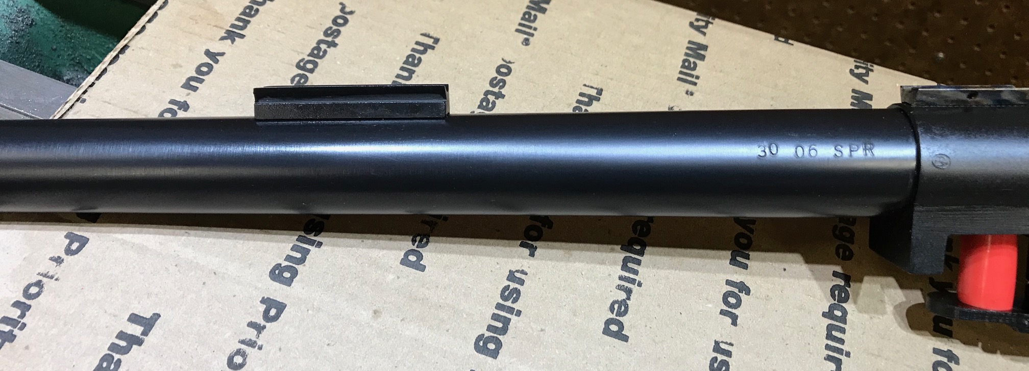

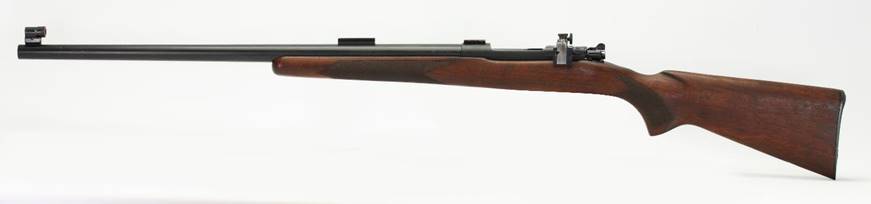

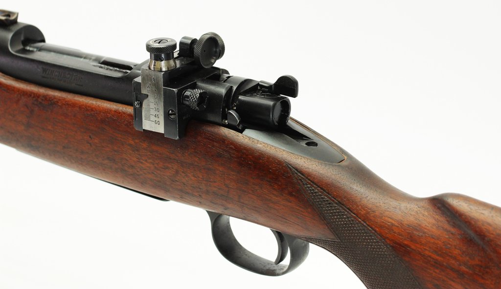

Barreled action is done. The fresh bluing kind of accentuated some pitting from its previous life. I probably could have done a better shopping job on my donor rifle but this one has a good story as my daughter and I had a fun morning eating breakfast and shooting clay pigeons when I came upon it so many months ago.
Fitting to the stock is the only thing remaining.
I really like it. The pitting just authenticates it.

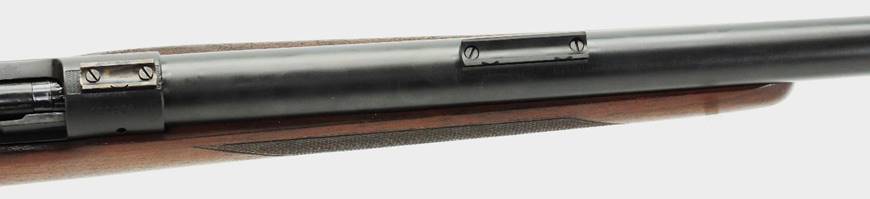

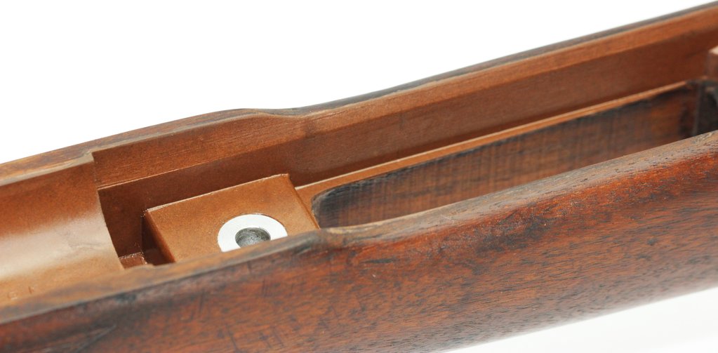

Are you having the front screw bedded? Or, not using it?
The barrel tension adjustment screw?

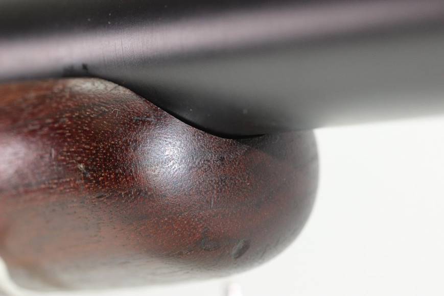

Seems the USMC just used a dummy screw/nut and left the barrel completely free floated. Ill be doing same. The Douglas has not been dovetailed for the tension adjustment.
Unlike USMC I am asking the builder to install pilars and bed the receiver.

Looks exactly as I had hoped. I feared that big Douglas would have required too much wood removal from the forend but its exactly as I hoped it would be.

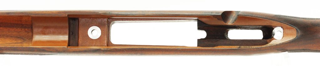

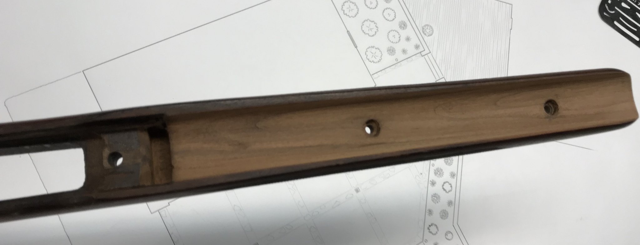

Yes, the tension screw. I would have supposed you would leave it free floated, but wasn't sure.

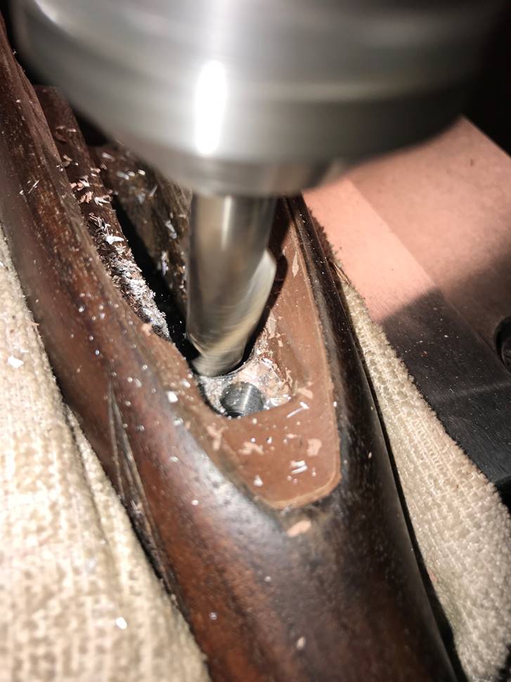

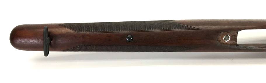

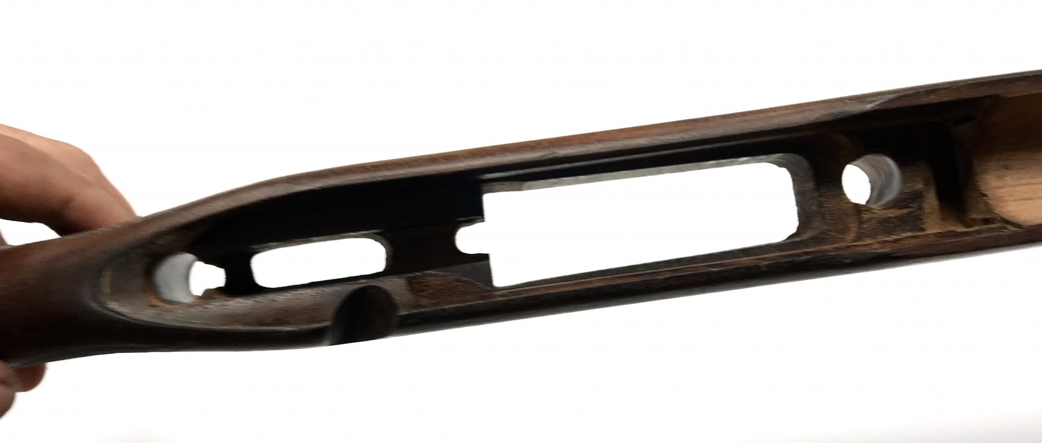

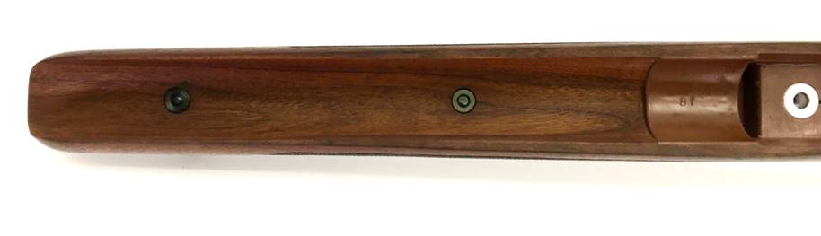

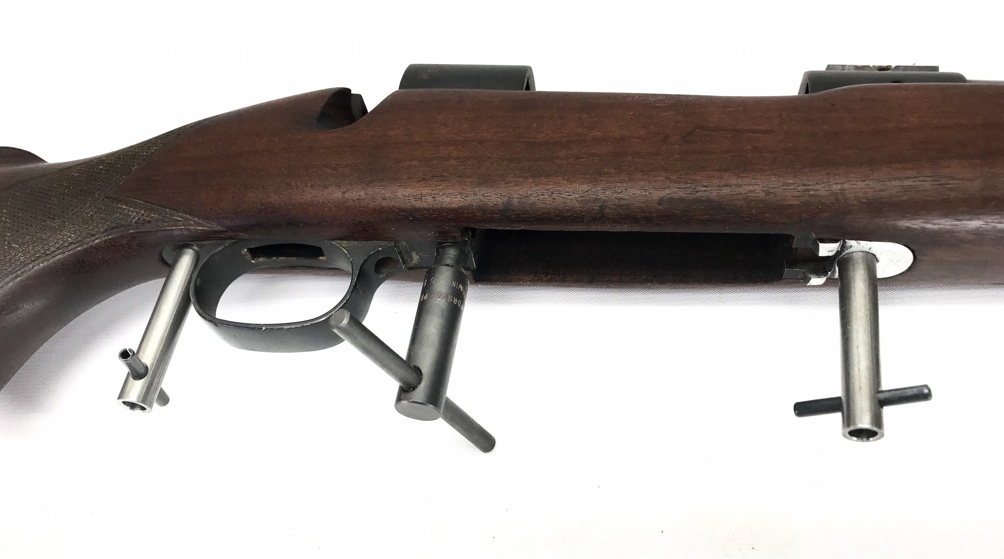

Forend is complete to allow free float...

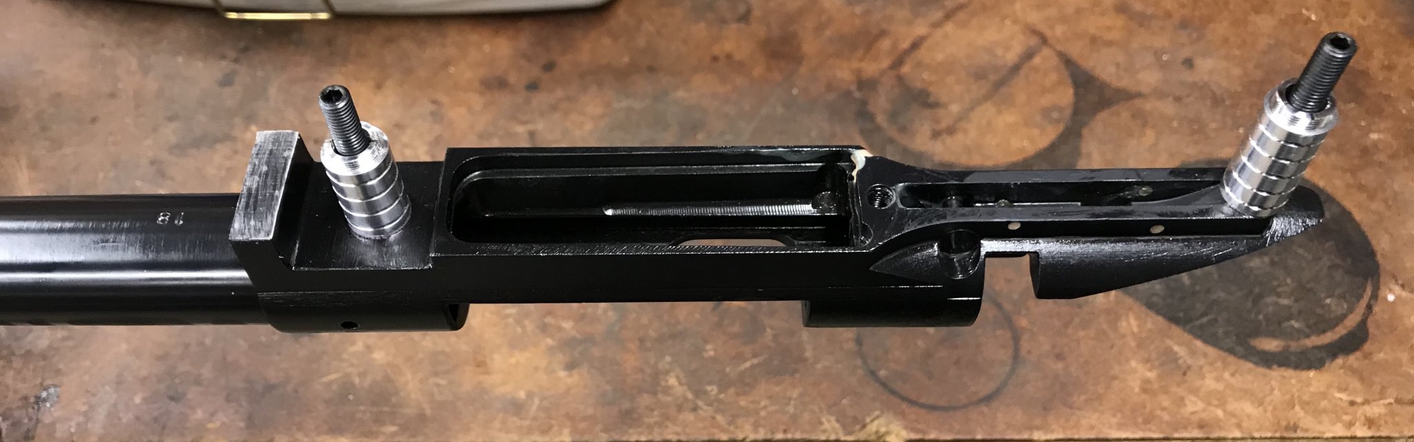

Action screw bores are opened up for pillars.
Rear pillar will flow into trigger slot so the trigger slot will be remachined when the bedding is cured.

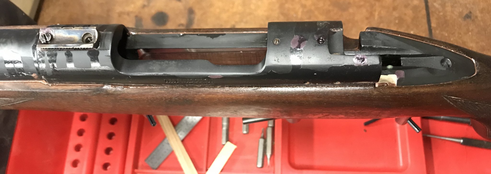

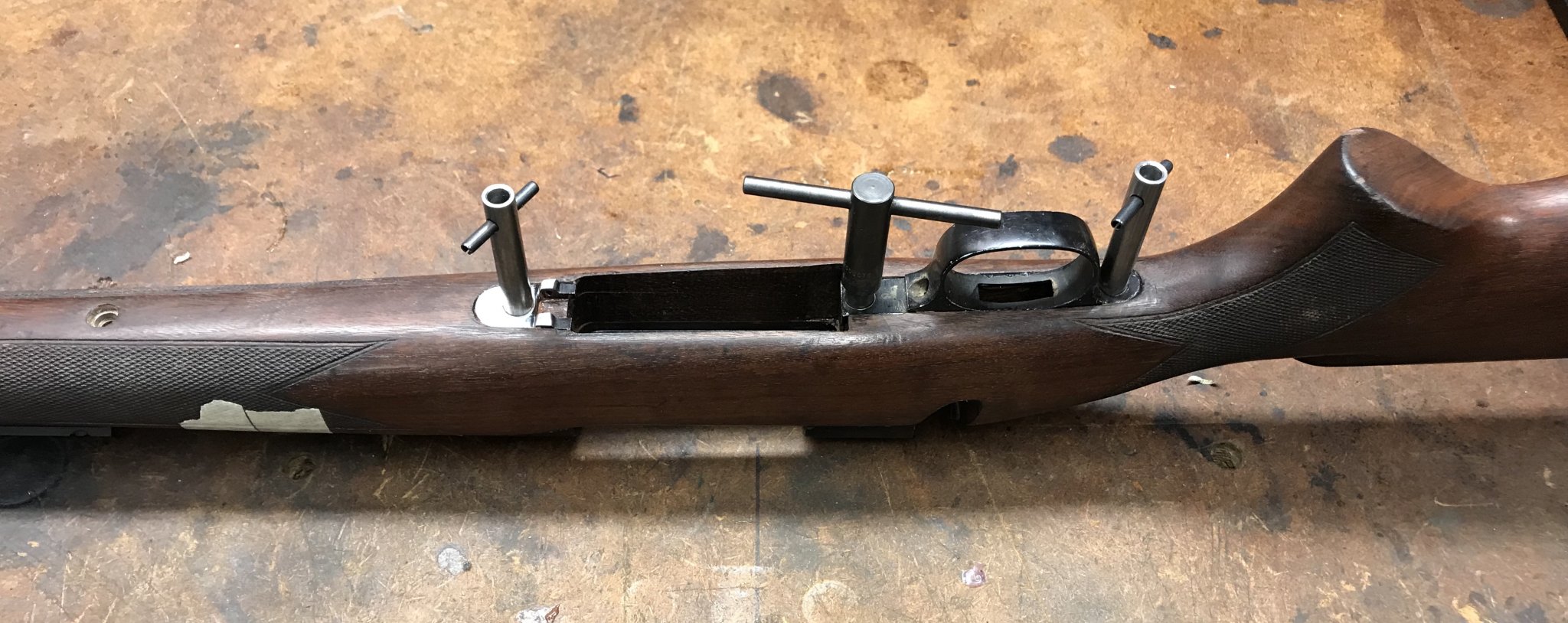

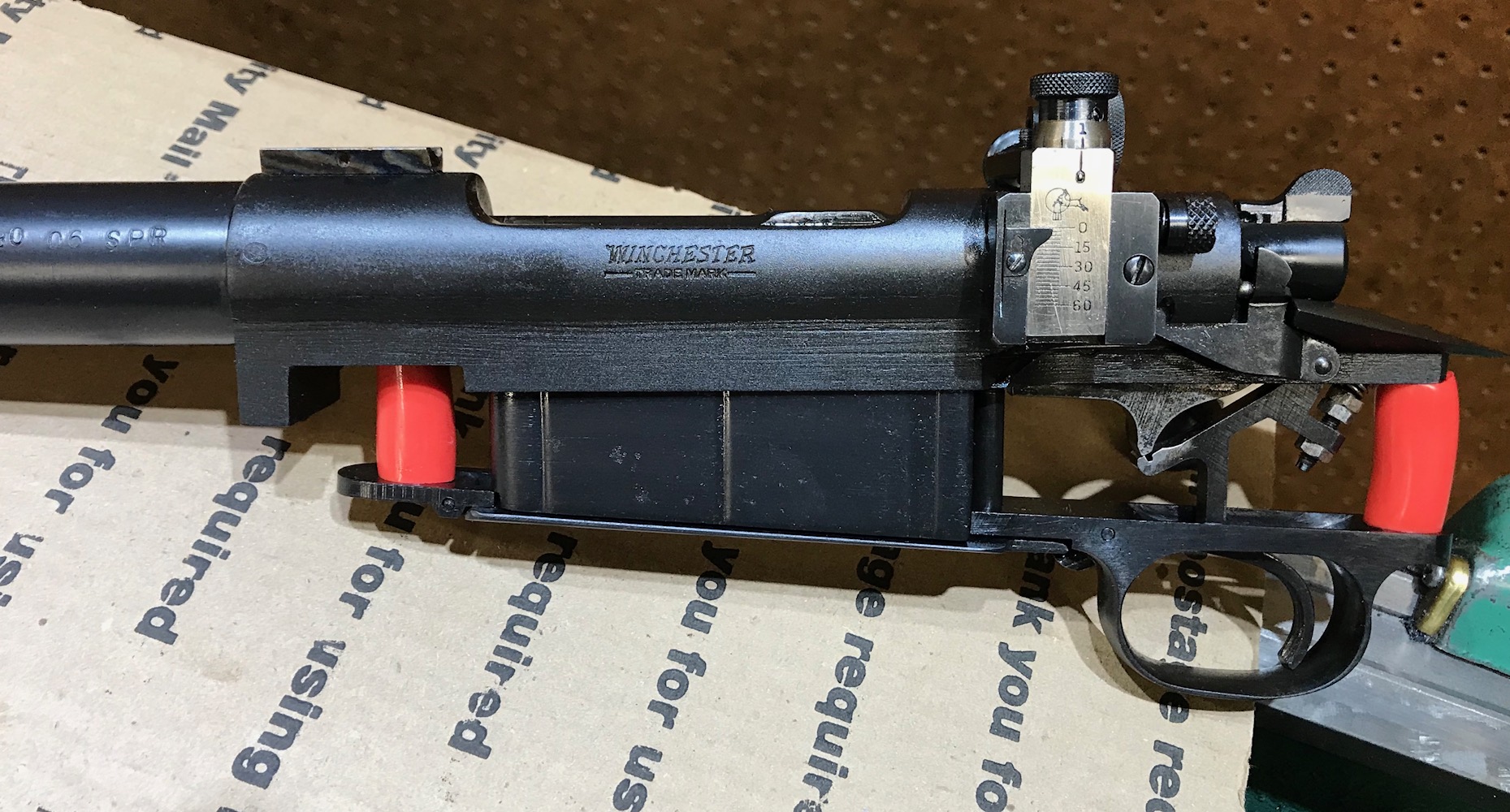

Mocking up the action to make sure all is well before the goo gets applied....

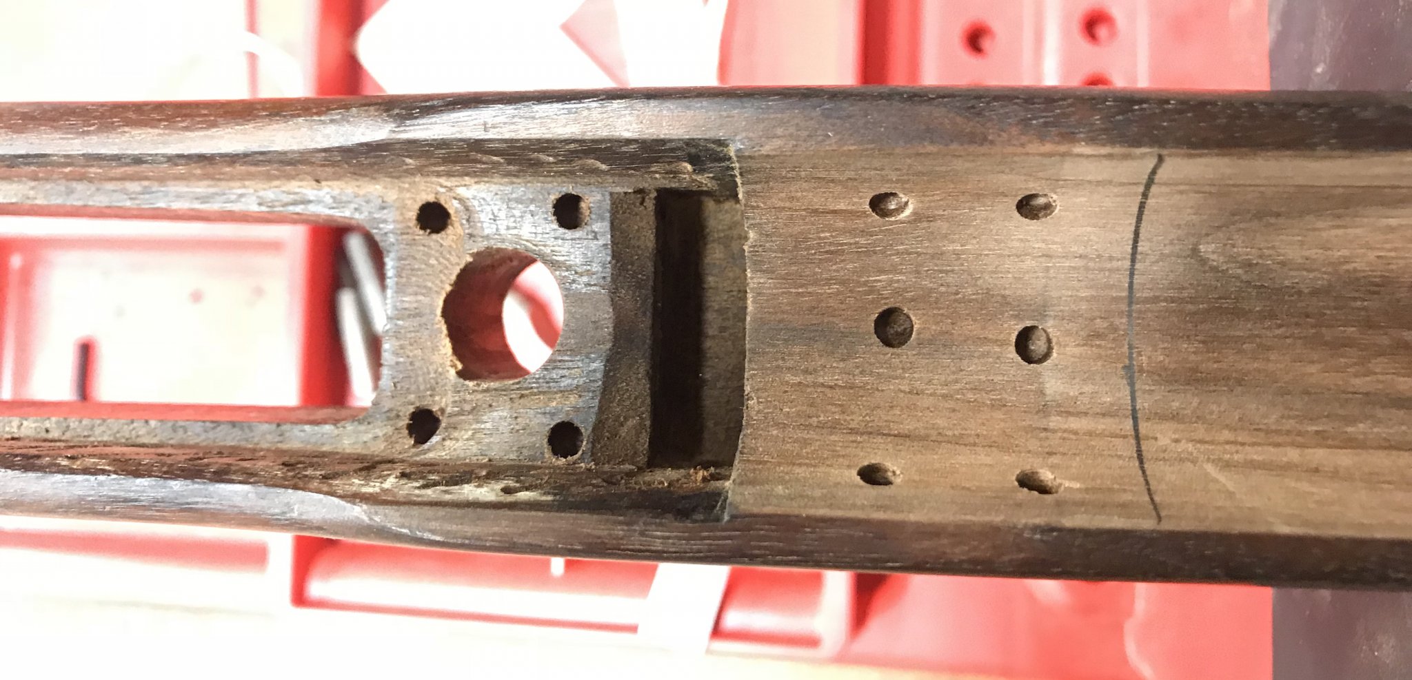

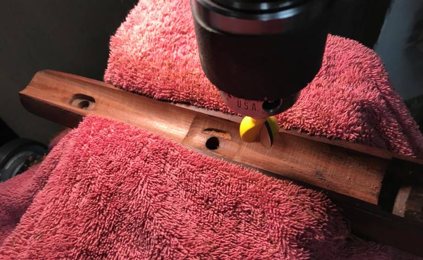

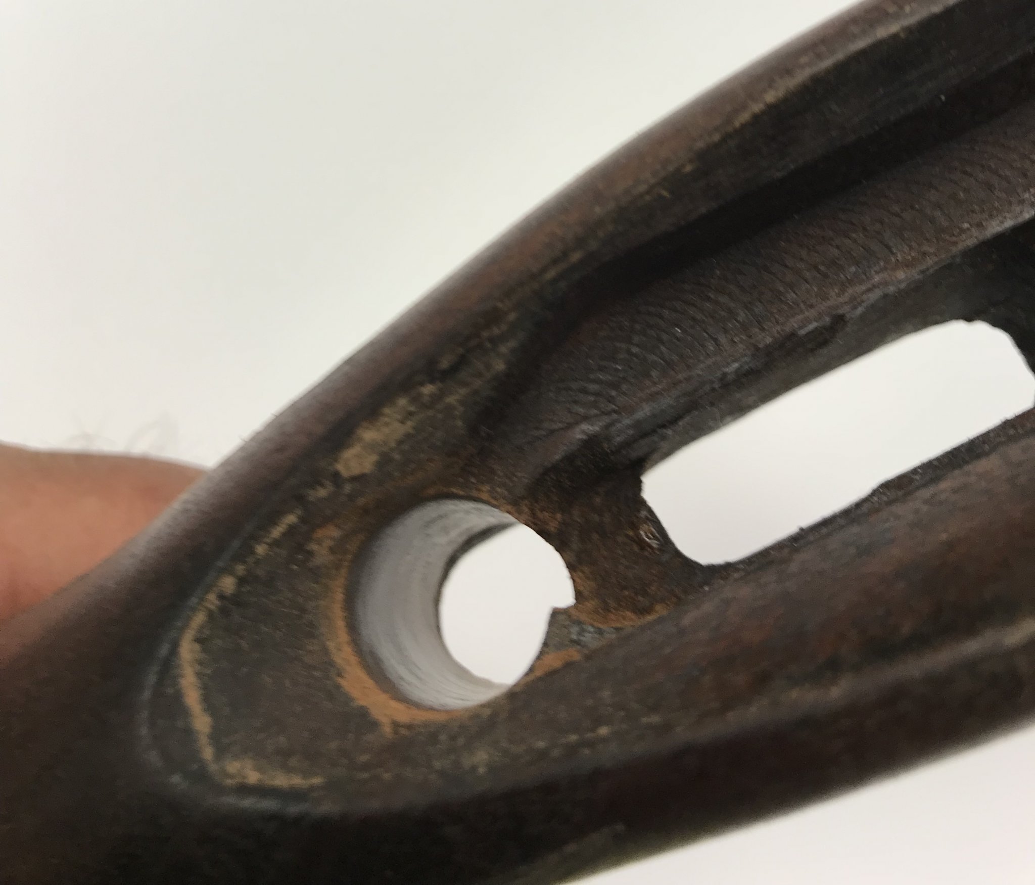

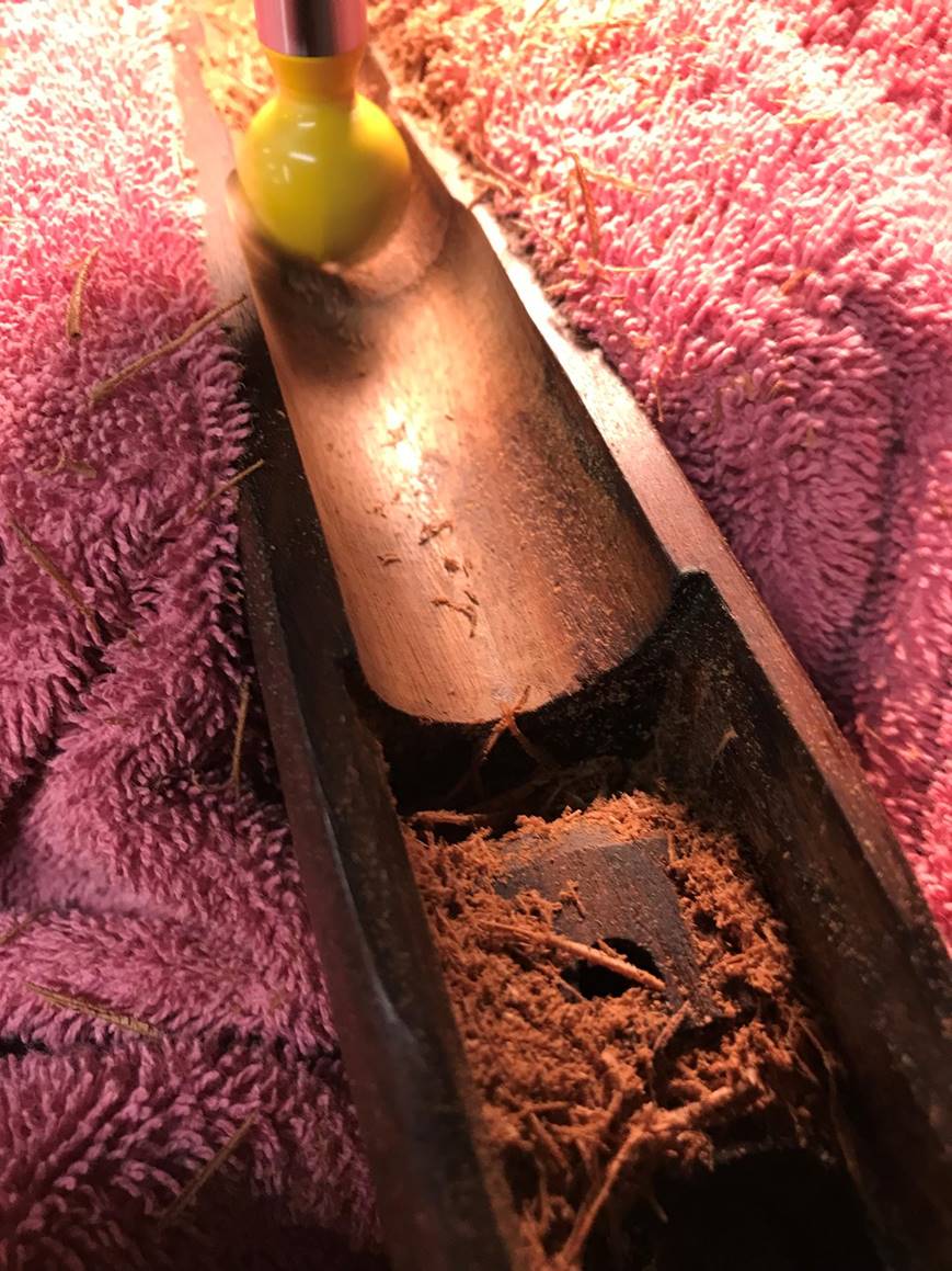

Drilled some holes for the bedding to key into, roughed up the inside milling for same purpose. Bedding will include first 1.5 inches of barrel...
fetch

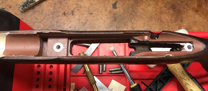

Action is buttered up with no stickum...
fetch
Edges cleaned up after squeeze out. Looks like Justin uses an Acra Glass in brown.
fetch
Bottom metal bedded in...
fetch
Should be cured today.
Stand by....

The bedding as first exposed with clay dams in place...
fetch
Milling the rear pillar to restore the trigger slot...
fetch

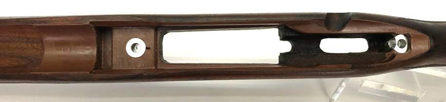

The finished heart and soul....
fetch

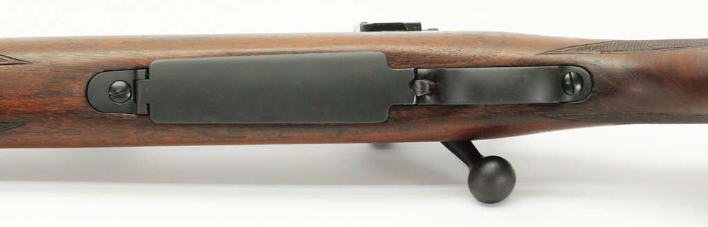

Justin used some Super Grade parts to blind screw the adjustment screw hole...
fetch
From the underside...
fetch

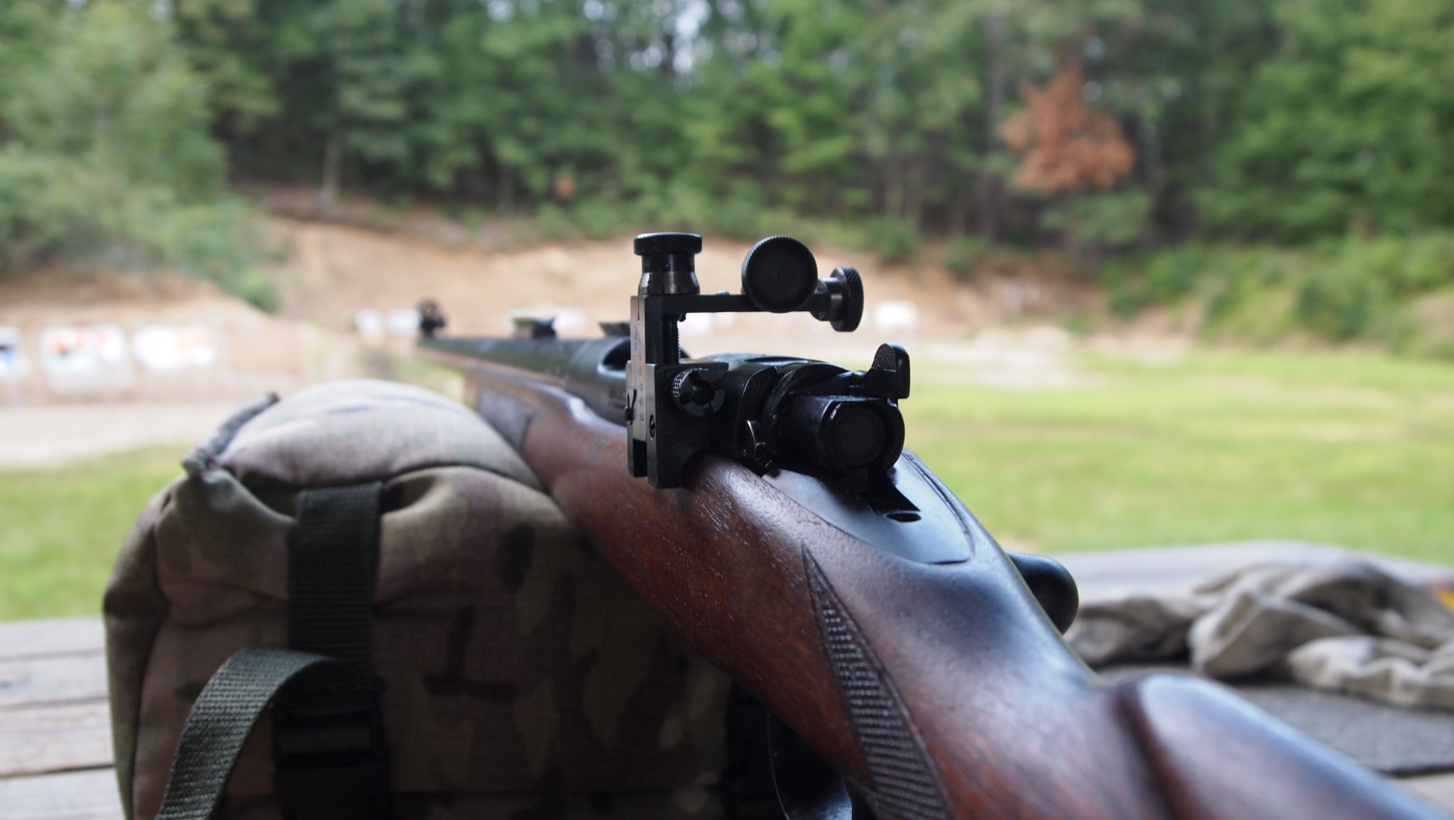

Im thinking abou how to scope this rifle.
Ill have to get Justin a pciture with the Unertl and I want to shoot it in that configuration. Ill pull the Unertl off my '03. It is built in the Marine configuration except for the clear anodized mounts and its a 10X....
but every time I bring out the Unertl scoped gun I feel like I am holding a fragile Faberge' egg. I dont understand how the Marines carried these in combat other than they had the security of knowing any breakage they would go to supply and get a new one. Still their lives depended on the scope, especially on the Mode7 as there was no second sight system readily available.
I want my M70 to be more user friendly.
Im giving strong consideration to this....
Credit to USMCSGT0331 for that photo.
Pretty sure Carlos Hathcock stated his ideal sniper would have been the M70 with the Redfield 3-9X from the M700.
I have a line on a Leupold Vietnam commemorative 3-9X. It has a useable mil dot reticle. I could get my zero and use holdovers for everything else.
The durability makes it an actual rifle I could take to the woods without having to treat like fine china.
It would actually be a suitable Alaska gun with a half decent hunting scope and the ability to have a secondary sight. The rear slide of the Lyman sight should be able to be removed and the scope base will install while leaving the base of the reciever sight in place. If a scope breaks remove the Redfield base and re install the reciever sight slide and front globe - good to go.
Just as a matter of curiosity here, do any of you torque your action screws? If so how much torque do you use. My stock is bedded without pillars, I've been getting fliers out of the groups when I shoot. I'm thinking maybe I have the screws too tight.
Thanks
Kevin
Thanks
Kevin
Ive done some testing with another bedded/pillared woodstock rifle and found that there is a sweet spot.
My testing here....
https://www.m40rifle.com/forum/m40/2048-torque-test
For this M70 Justin suggested 30 inch pounds front, than 30 inch pounds tang with just hand tight (15 inch pounds) on the middle trigger guard screw.
General consensus is front screw gets set to desired torque first than tang last but for my M40 the best group worked with tang first than recoil lug last.
With Springfield '03s/rifles without pillars you should be carefull approaching/exceeding 40 inch pounds to avoid crushing wood.

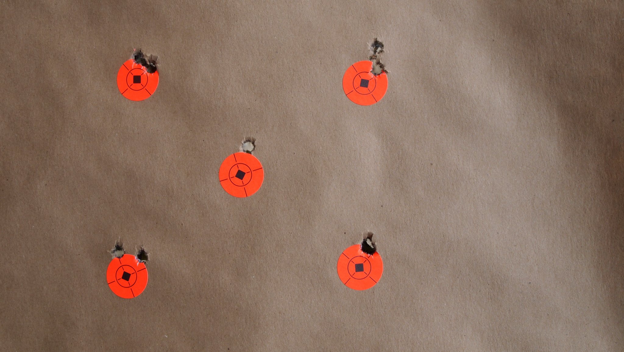

First 15 shots today....7 pounds of barrel certainly tames the 30-06. Much nicer to shoot in this form than when it had a pencil barrel.
Only had enough time to take a few shots at 25 yards to ensure Id be on paper when I get to shoot one hundred next week.
First three shots...#1 low, #2 still low with what I thought was 1 foot of up elevation and #3 in the orange after cranking on four times what I thought I needed because at 25 yards 1/4 MOA is a pretty small adjustment....
Fire up a group....
Shoot 5 one inch dots. The consistency of impact bodes well for this gun...
Make an adjustment and try four more rounds....
I screwed the pooch by pussing out and not moving the full 4X of the required MOA.
This rifle is destined for a scope. Im not liking how high I have to run the rear Lyman but this is the right sight for me as I didnt want to remove wood and its only intended to get me 300 yards if need be. A WSH rear sight would be more appropriate with that big barrel/sight block combination but that is not what I wanted.
