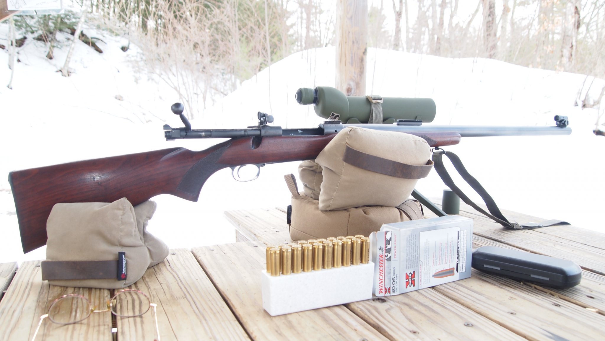

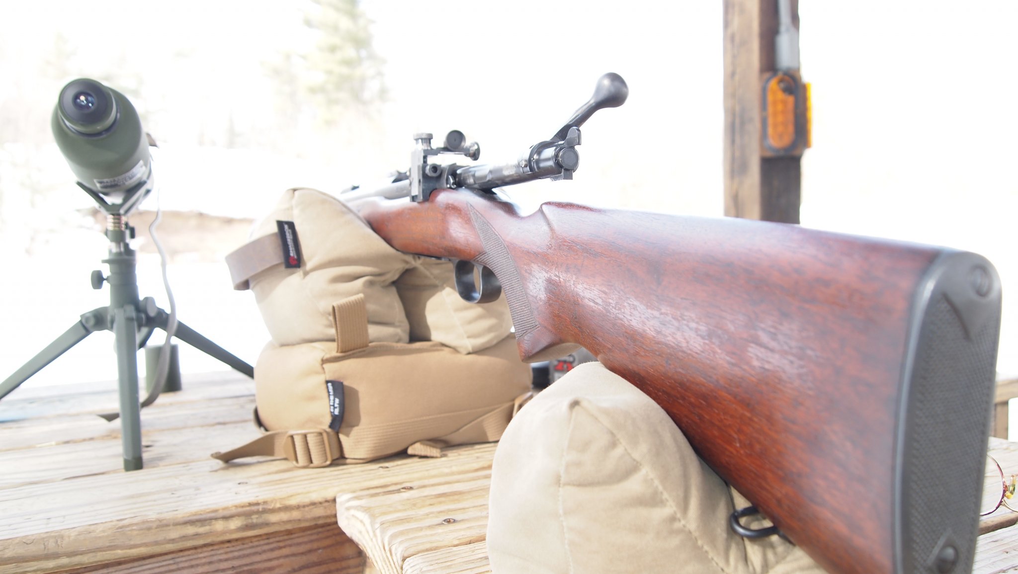

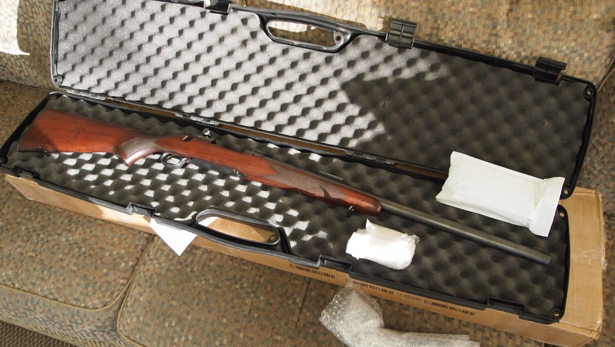

    Locked away.....
    Will pick it up tomorrow.

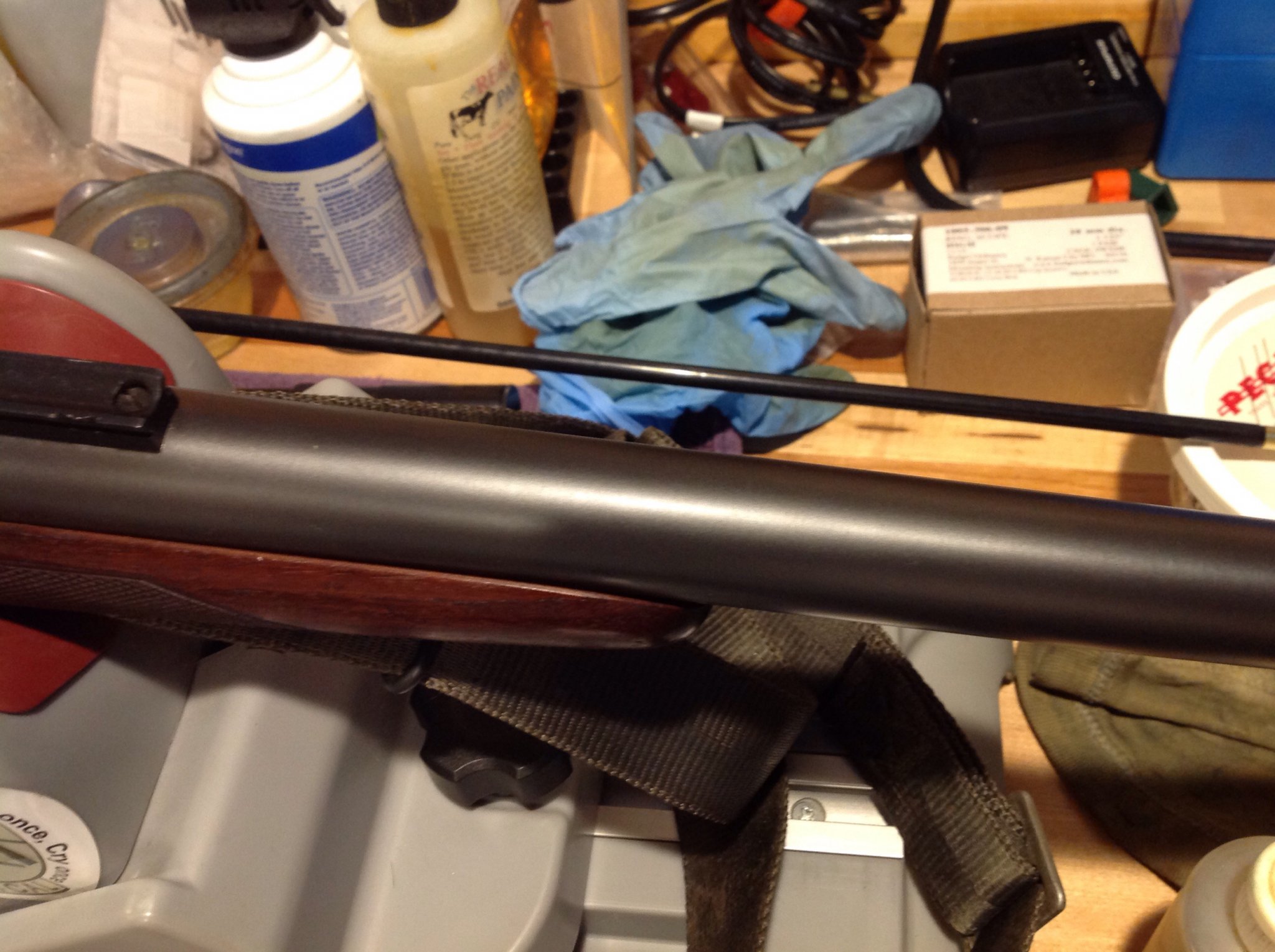

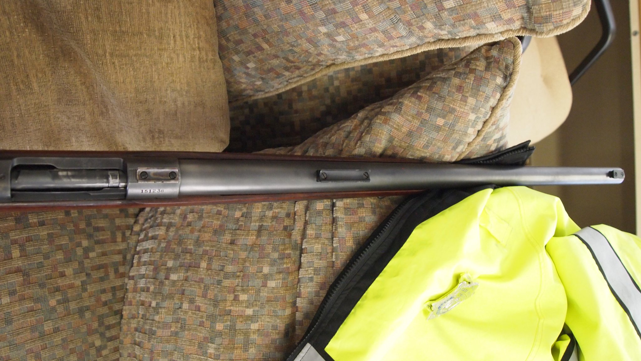

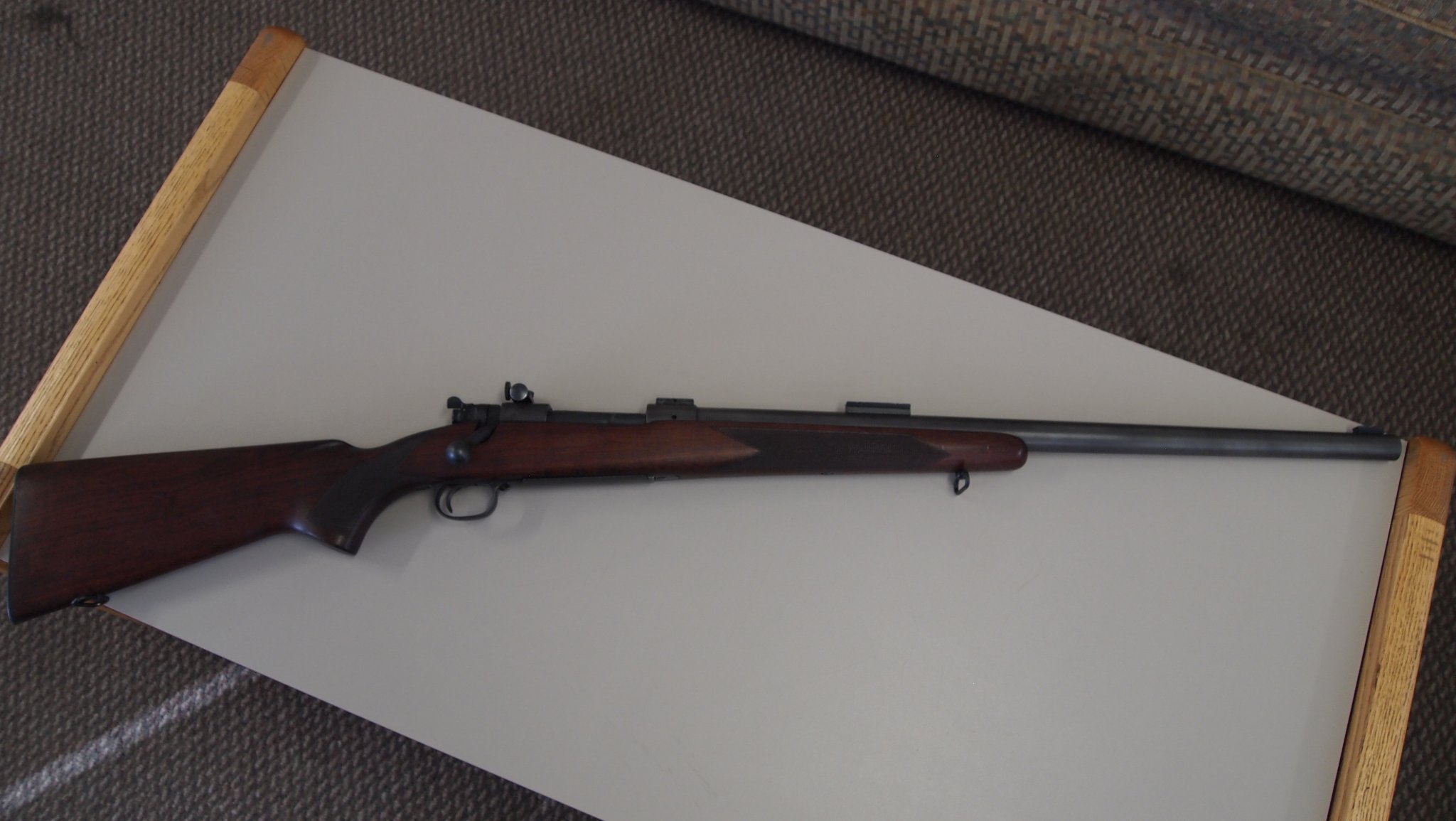

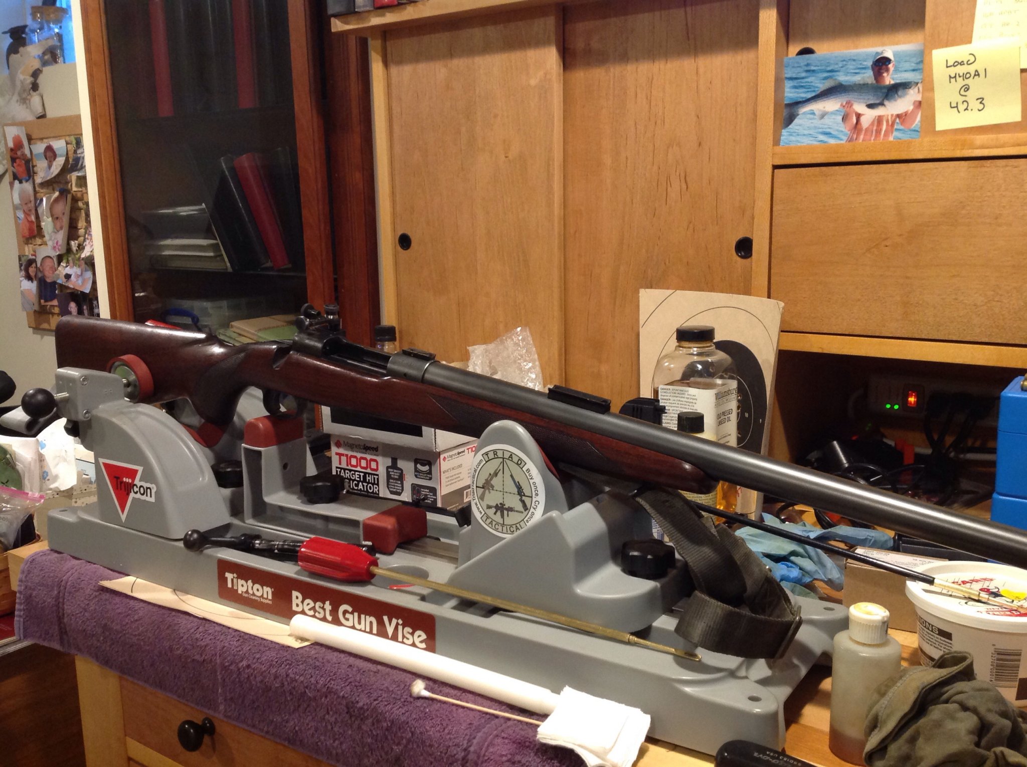

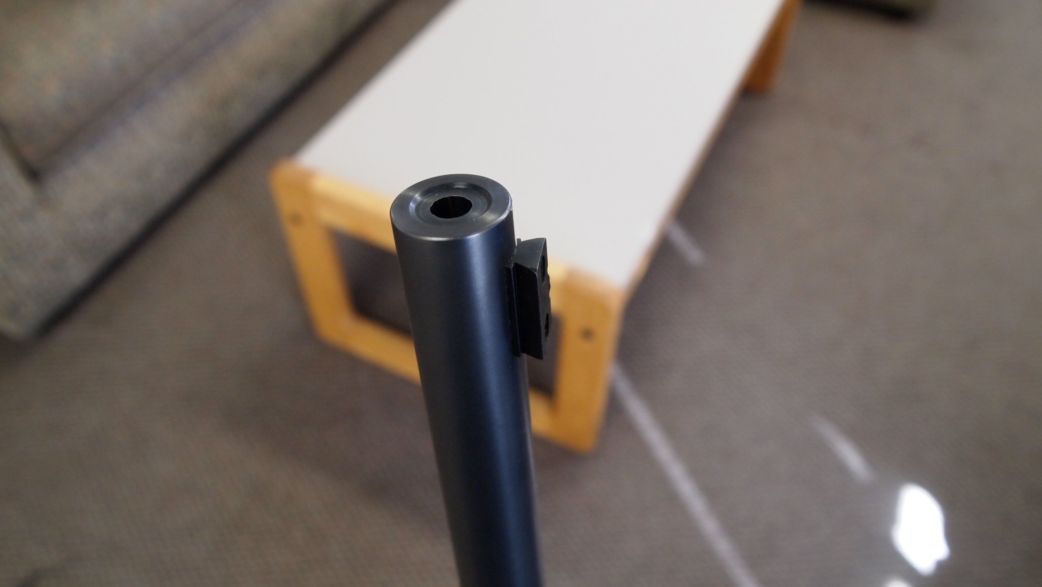

    That barrel looks fatter than I recall.
    It looks like a cannon in a chippendale furniture carriage.
    Still feels pretty "svelt" though....little nose heavy but not excessively so.

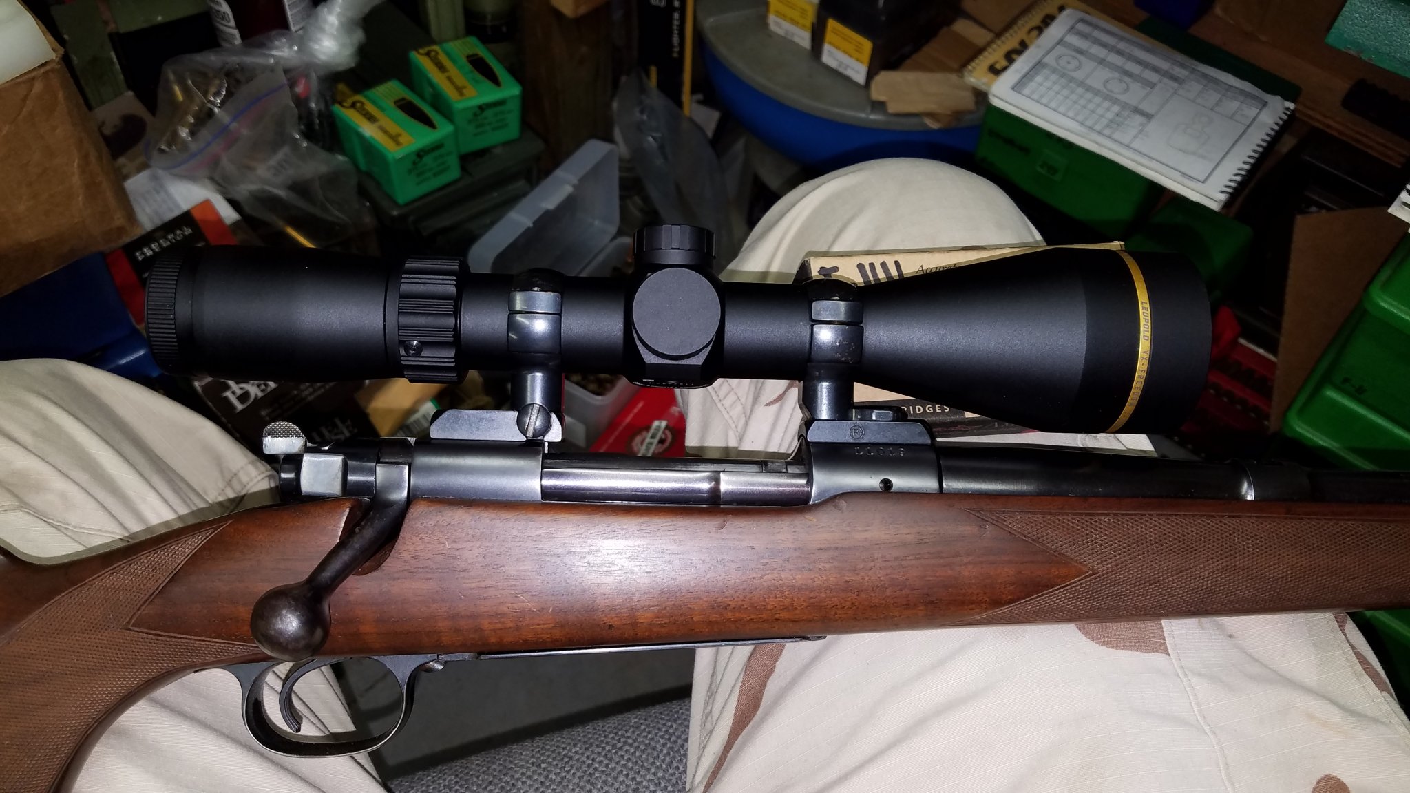

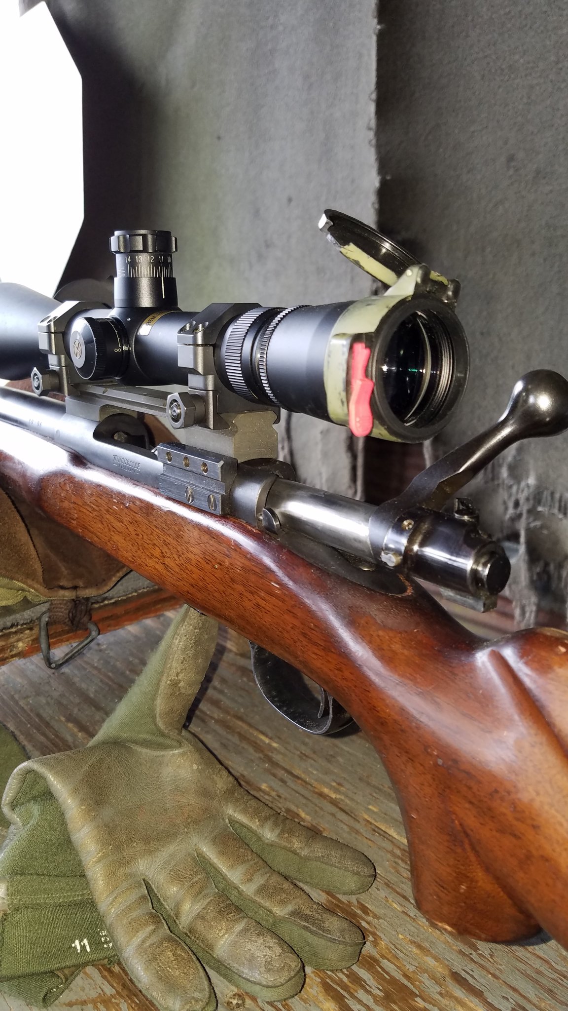

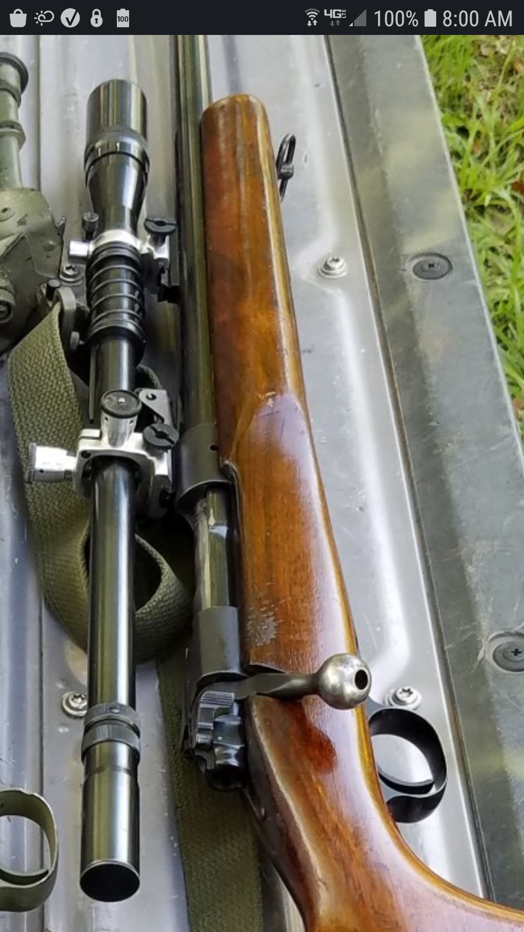

    Here's my 1937 with a new hunting scope... sorry PM, not trying to steal...
    Then, thanks to this thread, 63 had to come out this a.m....
    That 11 on the turret means it's on 26 minutes...
    And at 800 with 168's with vvN550... 15mph twitchy..

    But they sure hold nice in a field hold position, being nose heavy, and that stock just fits the hand soooo nice, and it just rolls right back into you when it goes boom, and when you ride the recoil back down, somehow, it's still pointing "right there"...
    I love those historical tools of the trade...
    I love the "stealing".
    Man that 37 looks to be brand new...very nice...Id be afraid to hunt it but it is what it was meant to do.
    I hope mine will shoot as nice as the 63, actually the rifle probably will, the question is will the shooter.
    Probably take two hours at end of shift on Tuesday and sight in the irons. I want to actually take the time to set all the screws and have a good zero so after I pull the slide and replace it with a blank if needs be in teh future I can reverse it and expect the irons to shoot.
    Ill mount the Unertl for my first scope, maybe only scope.
    Ive been toying with the idea of either using my Weaver T-10 or a Leupold M40 repro.
    Putting a mil dot reticle in the Weaver would make an incredible match if not Leupold would be next best. Still though Unertl for the cool.

    56 has the unertl. It's fun to shoot a little, then its not...
    Std mounts, 100 to 600 ok... just have to add wind adjustments as you go up, when the tube "shrinks away" from the adjuster when moving up. That's annoying at times.
    If I want to shoot 600 to 1000, I have to change the rear scope mount to a higher one, and that gets old....
    Since I love shooting these tools, it's why I have the leupold on 63. 63 is on barrel 4... such as it is.
    37 and 56 are original barrels. 37 goes out a couple times a year, just to remember. And PM, the stock is a late 50's refinish.
    56 and unertl. Been here b4 on sh.

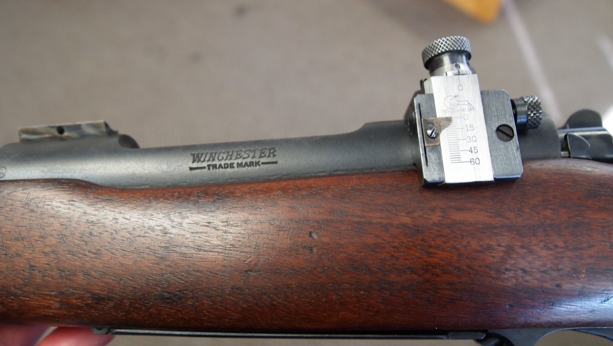

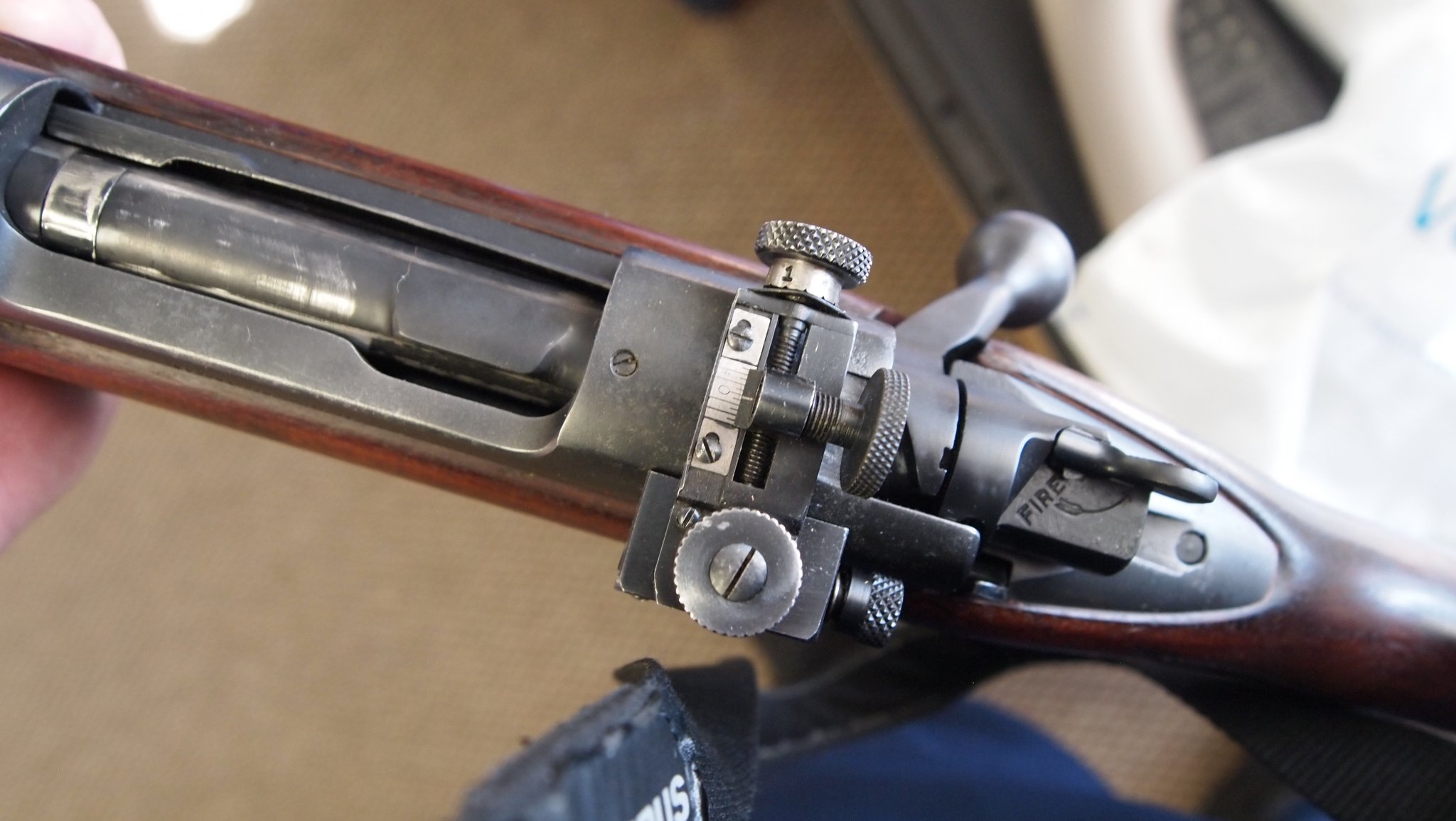

    What's the side mount rear sight base you have there? Is that a redfield base?
    pmclaine
    Gunny Sergeant
    PX Member
  • Nov 6, 2011
    22,175
    33,844
    53
    MA
    Lyman 48 WSH.
    I had a Lyman 48 WS on there but came across a high....there is a little bit of dog leg on the aperture arm to allow a bit more range with a heavy barrel rifle.
    I still have a beautiful condition Lyman 48 WS now to figure what I will do with.

    My WJS is in better shape than the one pictured on the rifle, a little bit later in production, nice target knobs not the craptastic hunter series stuff. Should be a picture of it somewhere in these pages.
    Nice thing about the short slide WJS 48s is no impact to a standard stock. Some others may require notching wood.
    Im really happy with myself for finding a short slide blank so I can remove the aperture arm and keep the base clean of debris. Found it while recovering from an appendectomy with a lot of time to spare......made that whole procedure worth while.
    At 100 yards wearing the Unertl I cant keep the eye aperture mounted on its 100 yard zero it will interfere. The blank will solve that as it was meant to be done.

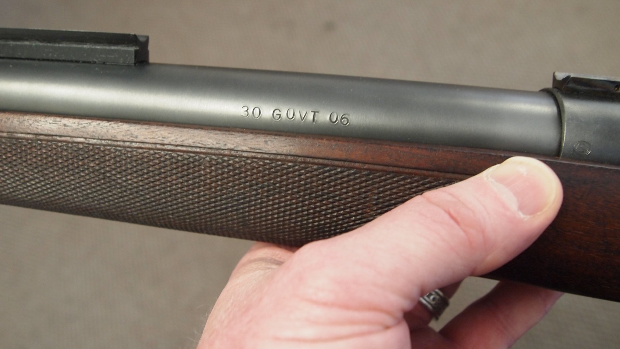

    Just keep in mind my rifle is a tribute gun only......1952 or so receiver that I added a pre war safety to, no clip slot, bedding, pillars, lots of incorrect.
    @cplnorton really added some great knowledge n here though to help me get the camouflage as close as I could.
    Im really loving the blue on the new barrel.....think it's a different spec than the original.....almost translucent allowing bare metal to shine through looks weather worn.....I like it.

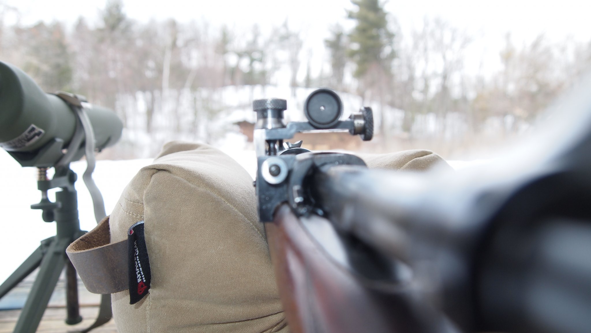

    Going to use a circle front cite aperture for sight in today. My front sight globe is a Winchester 105A. Ive been lucky to find all the available insert options - small circle, medium circle and post.
    The stupid inserts are impossible to find. A Lyman 77 is the way to go up front.

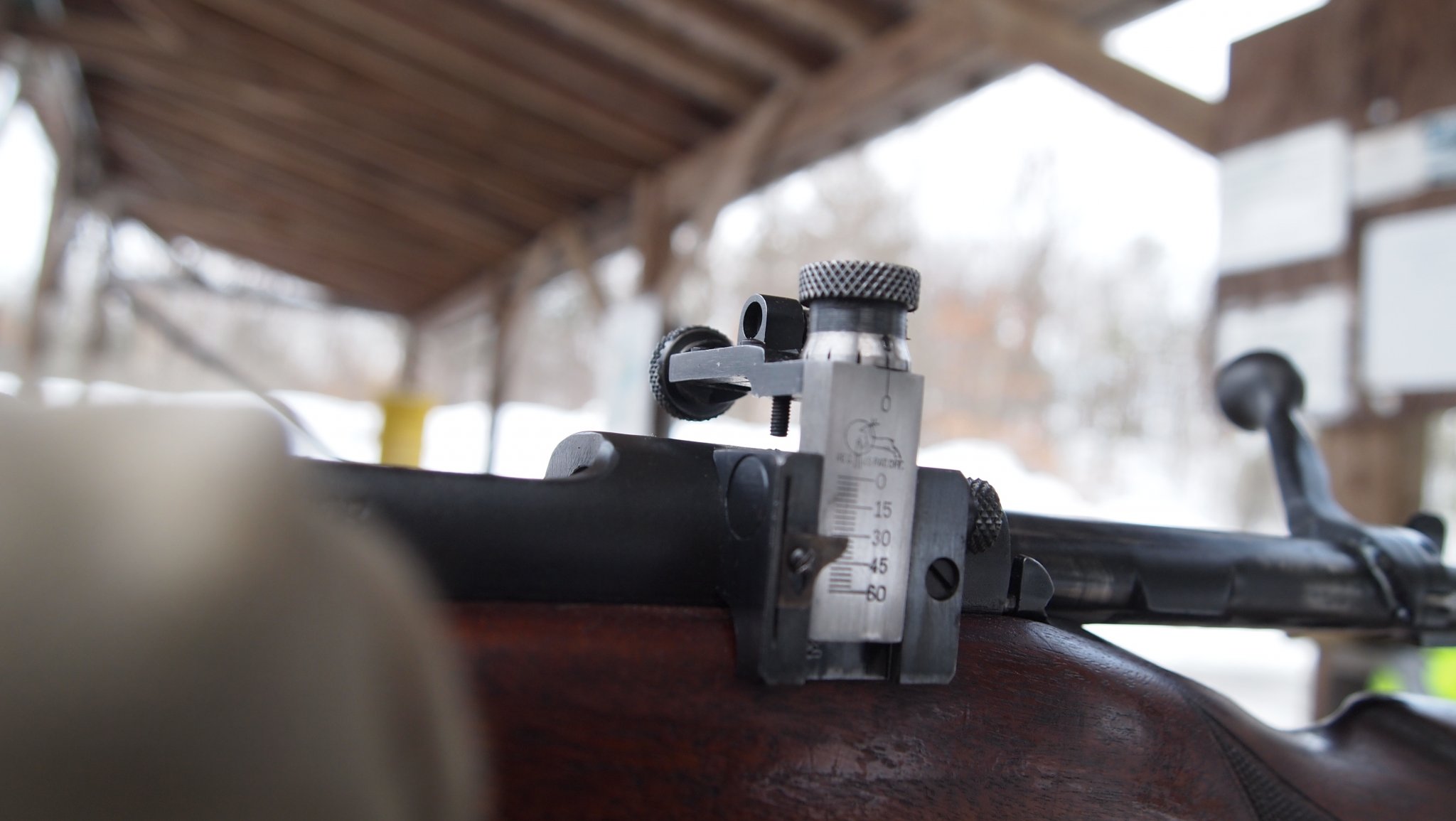

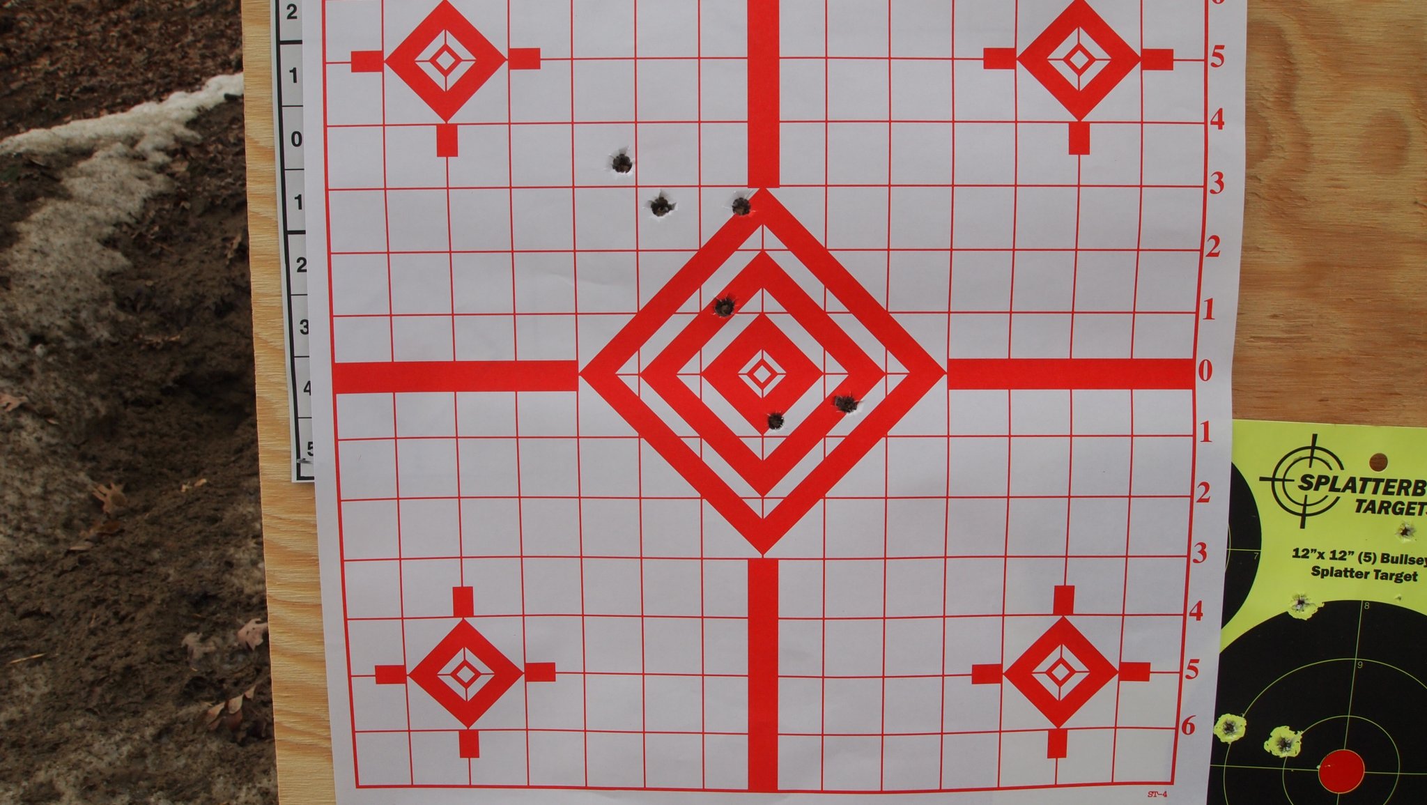

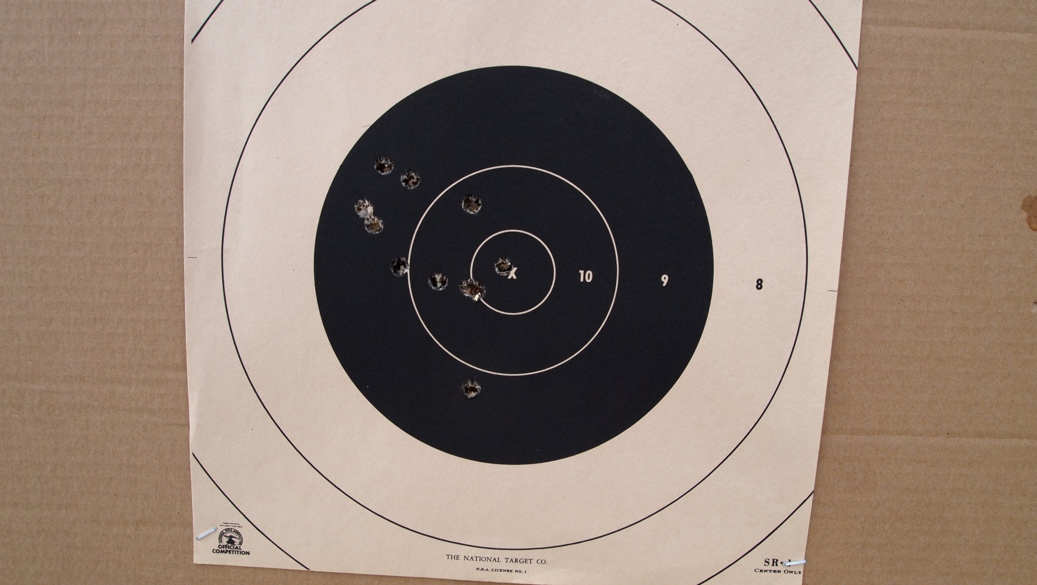

    Got on paper at 25 with Winchester 150 grain soft points.
    First 6 at 100 with 150 grain soft points...
    Switch to FGMM 168s and play with sights....
    Last 10 shots of FGMM....
    Everything functioned fine. I added 1/2 inch of elevation before casing the rifle.

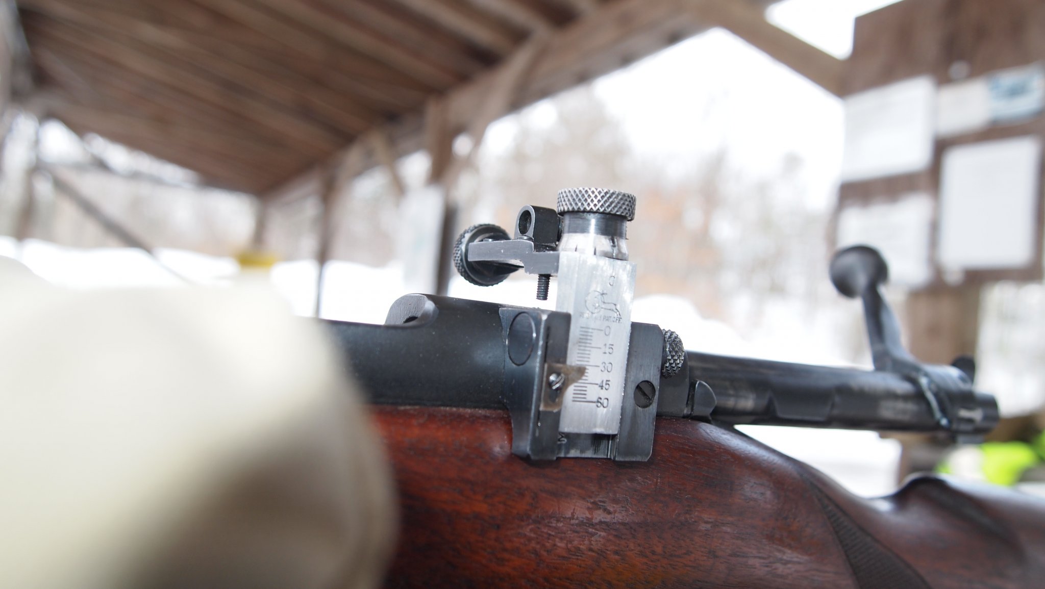

    Love the Lyman sights, like little computers, slip the turrets, a zero stop, you can zero windage.
    I think I need a higher Front sight Block though. Im losing 1/2 my possible 60 MOA of elevation adjustment...

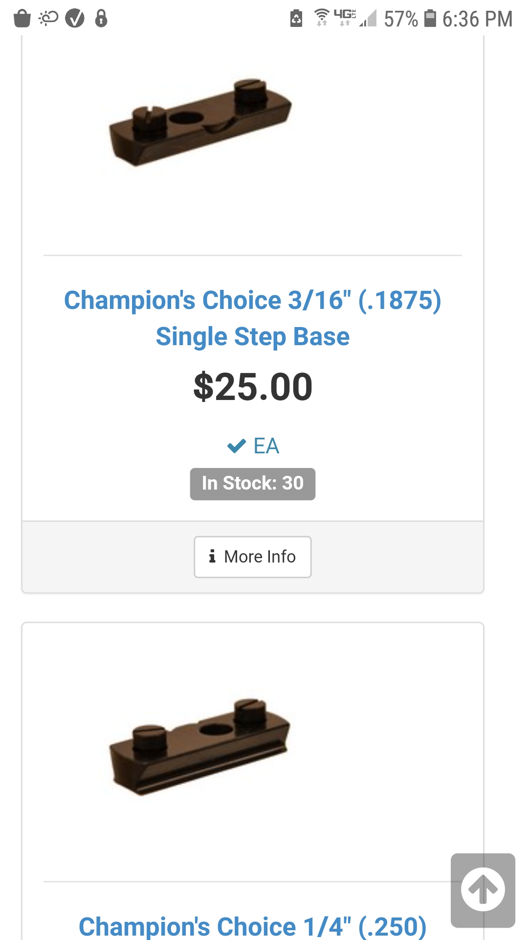

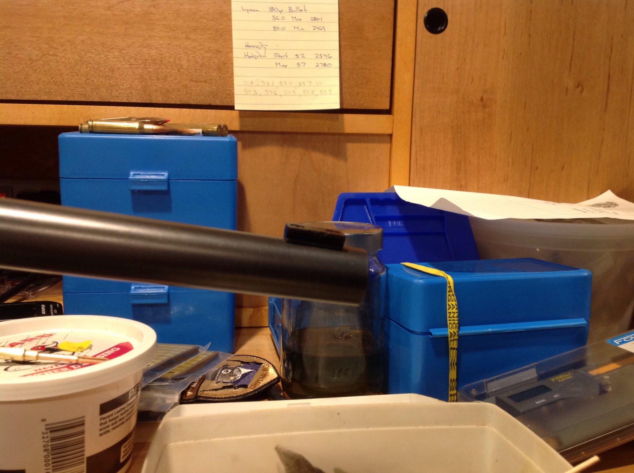

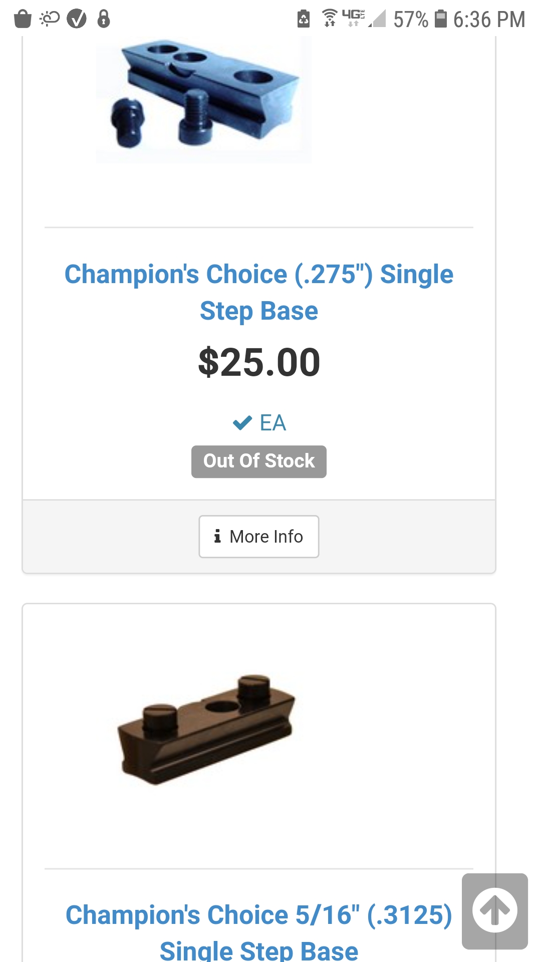

    I have hundreds of bases so can find one that will work.
    Ill measure what I have for front base height.
    Ill measure distance from peep to center of FSB.
    We will use magic to figure out how much taller the FSB has to be to equal 30 MOA at 100 yards.
    It cant be as hard as earning a doctorate.

    Im rusty...not shooting as much these days and the eyes are not what they used to be.......excuses though this rifle will make tighter groups.

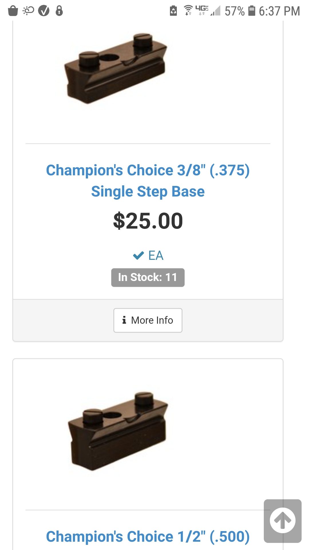

    Current sight base is .204 tall over the barrel. From peep I get 28.5 inches to center of FSB.
    Getting a cleaning....
    pre64win
    Jul 29, 2018
    14
    24

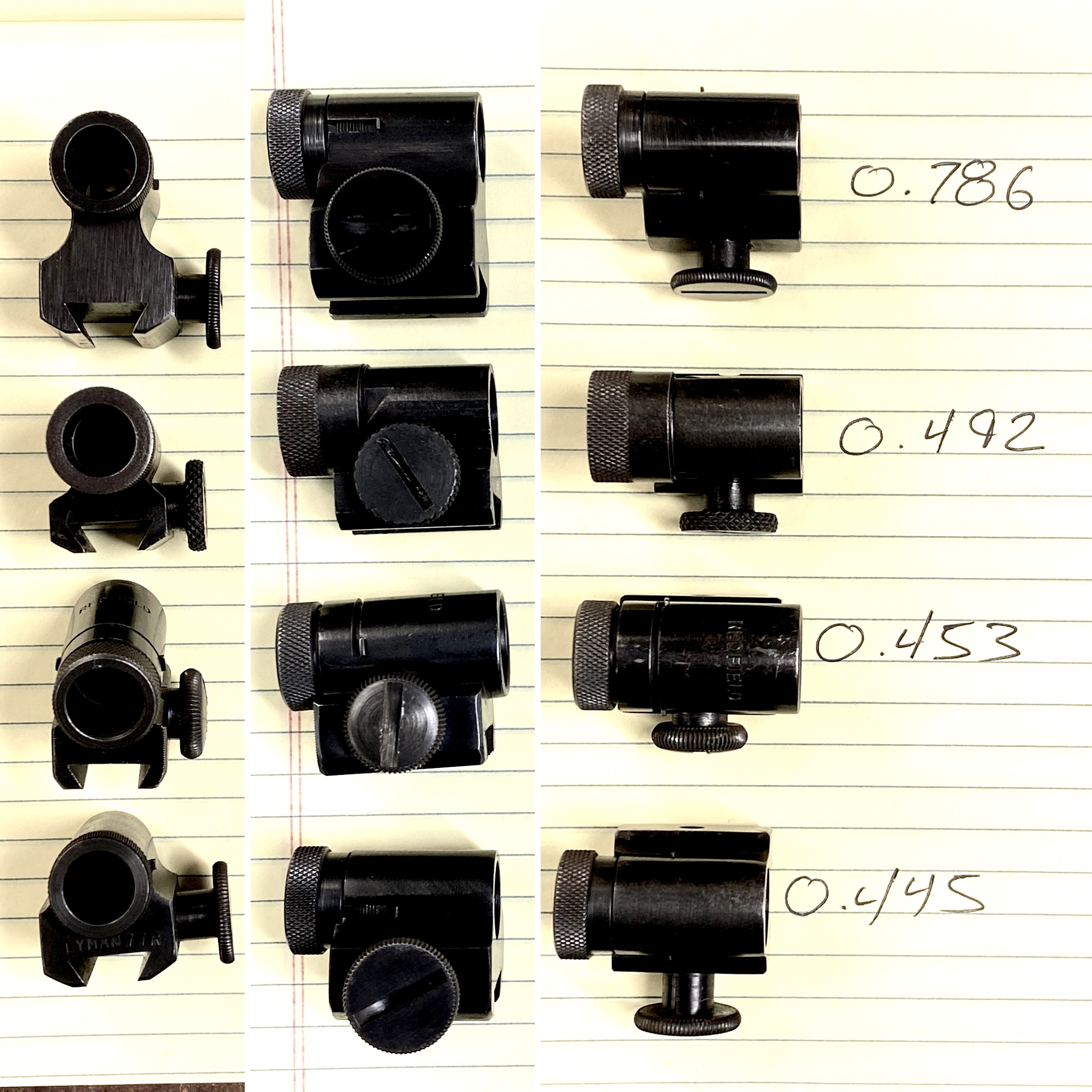

    Let me see what I have for a lower front globe sight. Measure the distance from the base of your 105 to the center of the sight insert.
    pre64win
    Jul 29, 2018
    14
    24
    And for what it’s worth - I don’t have a front block that is enough lower to make much difference. Only about 0.025” lower. I think your best bet is to find a much lower front sight.

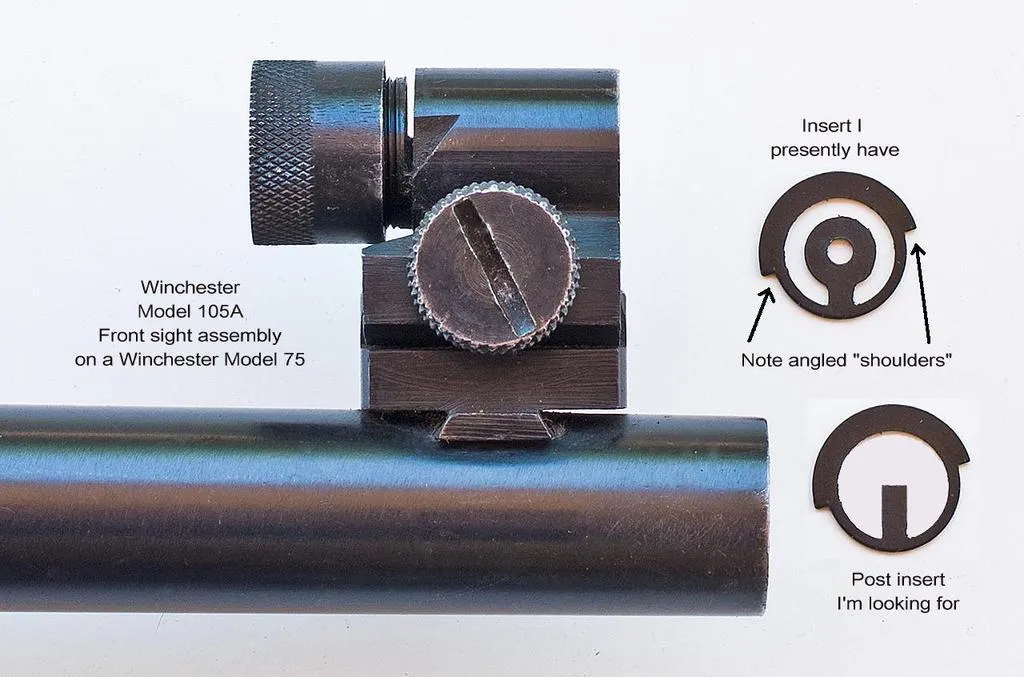

    If you wanna lower that rear sight, you need a LOWER front base.
    Man where were you when I made that mistake with that fat chick in the bar?
    From mating area where front sight sits on the front sight block to center of globe is .475.
    It looks like it's a pretty low sight, I think originally for Win 75T .22 caliber.
    Im not married to it.....if there is a lower sight block and a lower Lyman 77 to take some of the awkward height out of the rear I'll do it.

    Unsure if Lyman 77 comes in a lower height than R.
    Some comparisons between a 77 and a 105A.......
    I disagree with the Lyman being a better made globe.....only better because inserts are available.
    The Winchester sight is sweet with the medieval knurled knob set tight to the sight base.
    pre64win
    Jul 29, 2018
    14
    24
    Here is what I have. Top to bottom:
    Lyman 77 - 0.786”
    Winchester - 0.492”
    Redfield - 0.453”
    Lyman 77 - 0.445”
    If you want one of these, I’ll ship it out.

    I believe I have the base you need. I'm not where I can send pics right now, but, I'm pretty sure I've got it.
    I know I have several of the lowest mounts they made, and they are lower than the one in your pic.
    Let me get squared away, should b able to put it in the mail tomorrow.
    These are your height options....
    Pretty much std from 1936 to now.
    • Love
    Reactions: sandwarrior

    The lowest 77 you have Justin at .445 would be +\- .03 inches lower than what I have......
    I don't think there is a sight block lower than what I have that would still allow an unmodified globe dovetail to fit.....Steve Earle has a 3/16 (.1875).
    .03 lower sight at 3600 inches with a 28.5 inch radius should equal about 3.7 inches of impact change.....
    Does that sound right?
    Wonder how that equates on my rear Lyman 48 - 14 to 15, 1/4 MOA adjustments down?
    Can you guys confirm the math while I put my socks back on?

    I ain't a math person.... nwas...
    But I will give you a .1875 that you can use to experiment and find out.
    There is a sight chart in the 56 shooters Bible that tells the height poi changes, but, I'm not gonna be near it for maybe a day or so.
    Lyman 77 - 0.786”
    Winchester - 0.492”
    Redfield - 0.453”
    Lyman 77 - 0.445”
    I'd insist on paying.
    Perhaps the .445 sight and J-huskys lower base will give me enough to at least set the zero indicator and allow the zero stop screw to hit the receiver block.
    I probably need what would equate to 20 MOA Im guessing.
    Very helpful.
    Steve Earle is local and he makes a 3/16 inch block and he will have the screws. I'll call him to see if he has a base in stock. If not I may take you up on that.
    Thank you.
