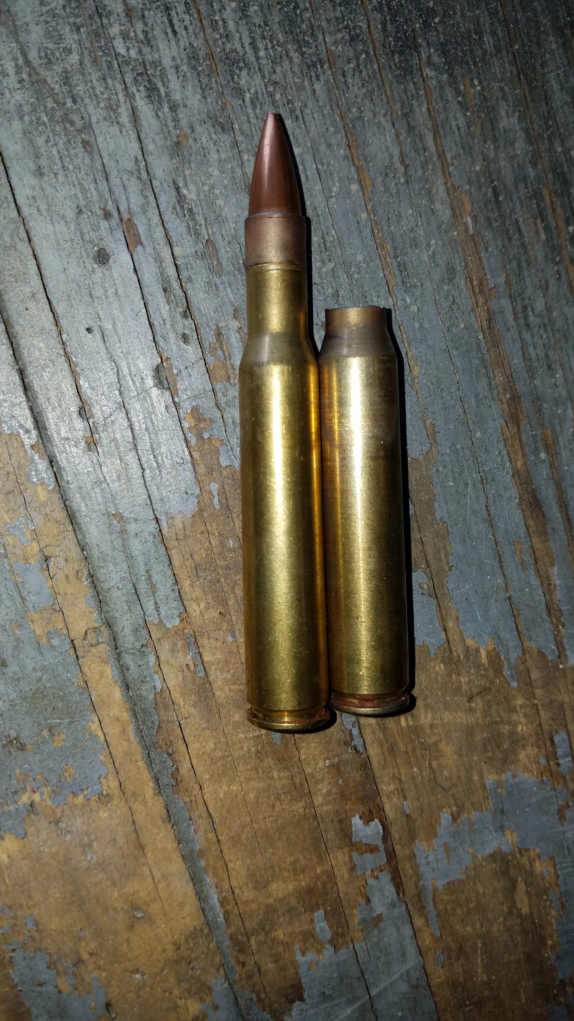

I also went to the range today with a prewar kinda, kinda similar to Phil's device...
But I had a problem... from some 35 year old reloads from the high-power days. Glad Phil isn't seeing this with his ammo...
So.... Phil, pleeeeezzz post some good pics soon...
We waitin....
Holy cold weld Batman....

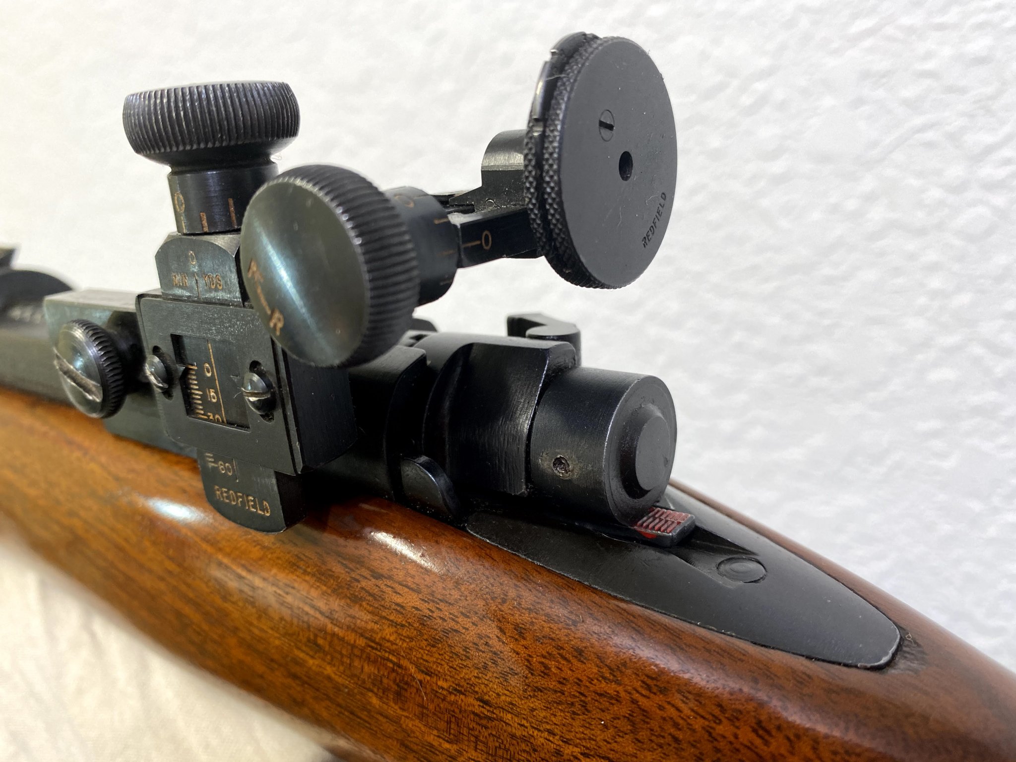

What my sights look like now....
I had a Lyman peep sight on my black powder rifle, absolute magic.
Nice thing is the inserts are readily available.
I used a post insert today instead of the front circle aperture last time I went out.
I usually shoot either equally well.

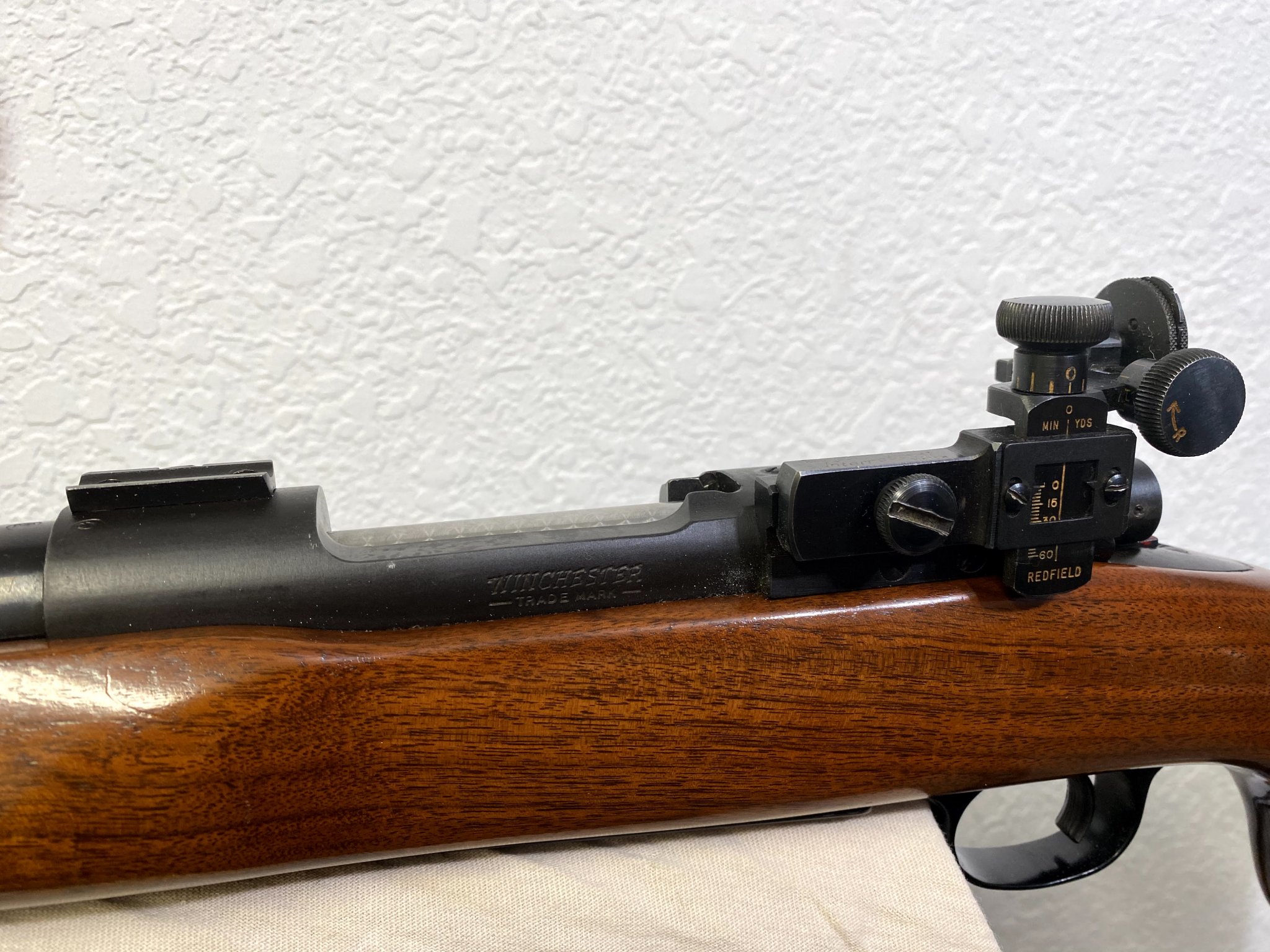

When I took the rear off I compared it to a WJS and noted that the other sight has a smaller rear aperture. That would have helped me today...I like small rears.
Doubt Ill ever shoot the irons again but I couldnt have the rifle without them.

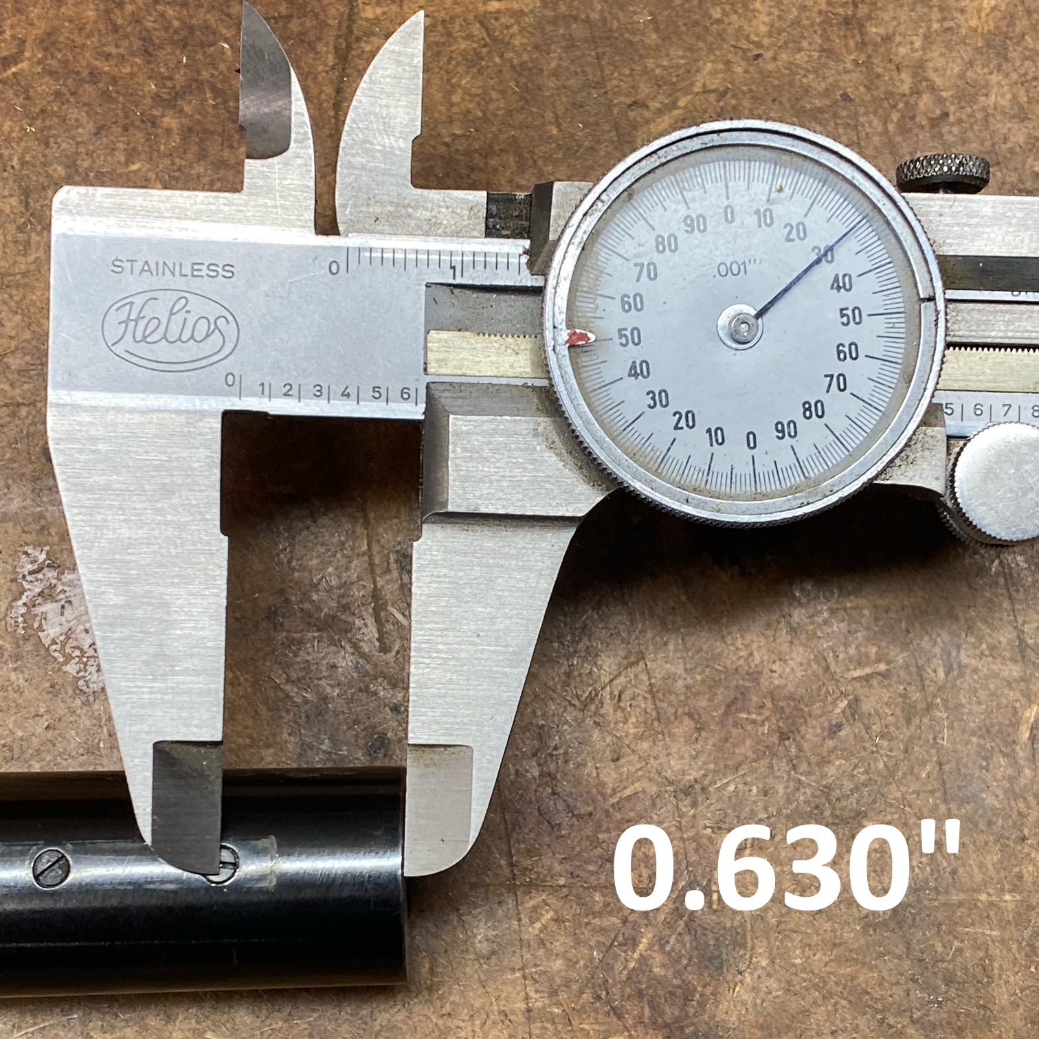

I have a pre-war, 4 digit serial made in 1937, modified to a USMC clone with Douglas barrel by TBA. Only thing is it still needs a d&t for the front sight block.
Anyone have a measurement from the muzzle to the front of the block or muzzle to center of the first hole? Are they 6-48 threads?
My Van Orden has not been recrowned and measures 0.630" from the face of the muzzle to the center of the first hole. I would be surprised if there is not a bit of variation on this dimension if measured across a host of barrels, but that is at least one datapoint that should work for you.
Reactions: Charger442
6-48 thread screws correct?

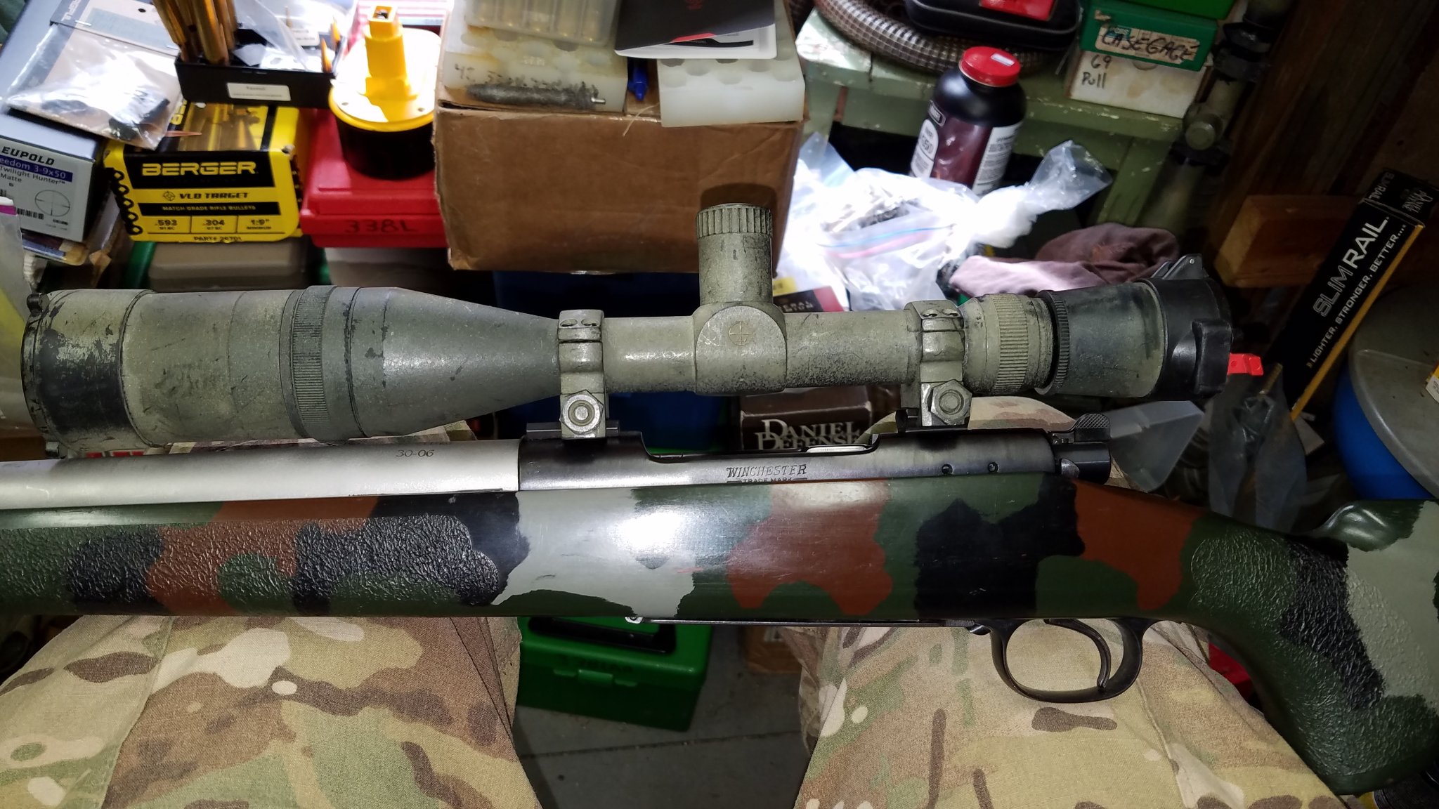

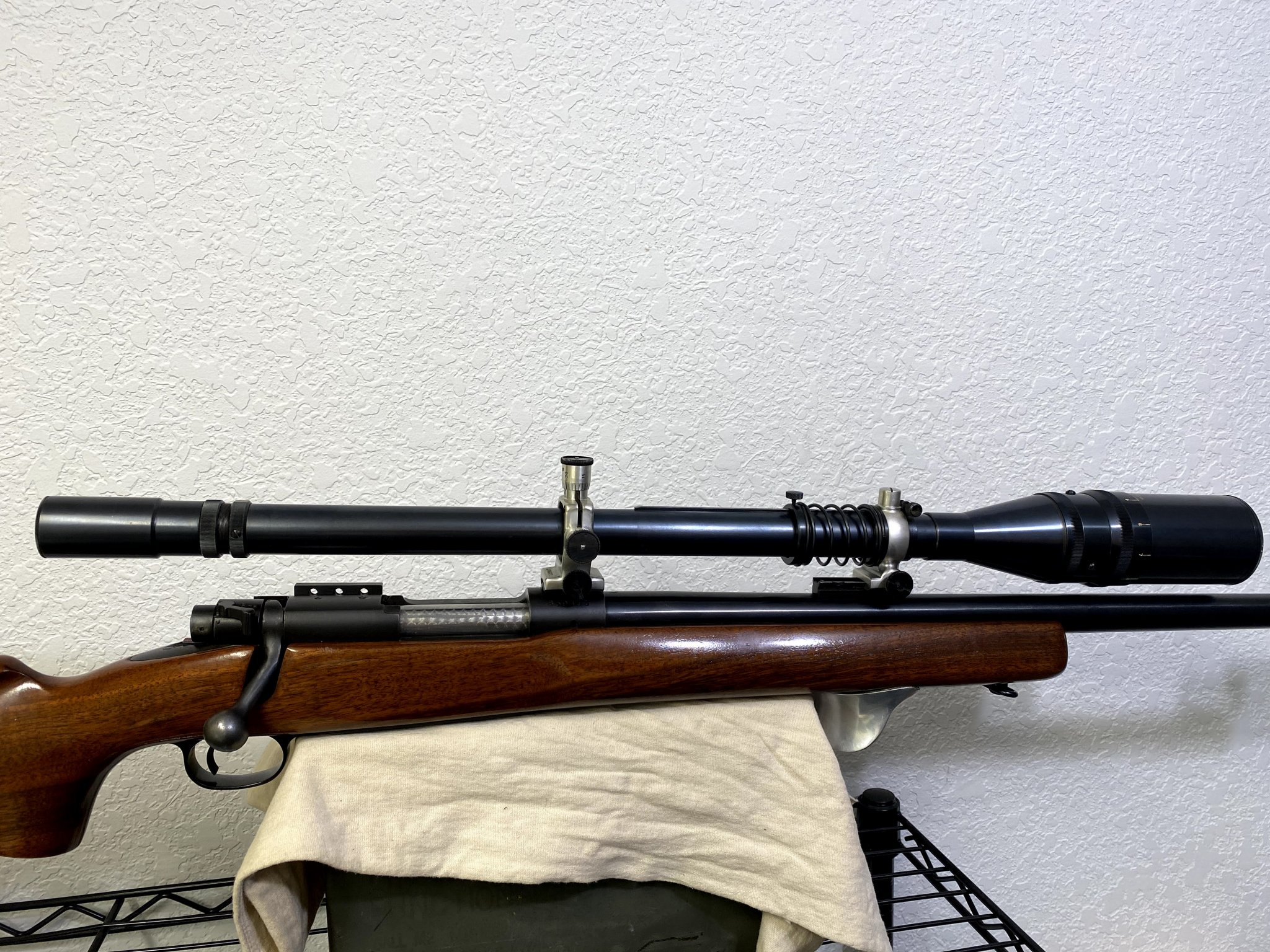

Beautiful day today.....took two hours of earned personal time to zero the Unertl under windless 60 degree sunny skies....
The good.....Beautiful rifle...
Wanted to initial sight in at 25 yards....too many bodies so I went to 100. Worked on a good slow bore sight. Looked down barrel centered target, looked through scope I was two target boards right. Way more than I was expecting. Try again, still right. Try adjusting the windage I took all the right out of it I could and was still 1 foot or so away.
Removed scope, made extra sure the screw shafts were secure in their half moons.
No shots fired. Why waste the FGMM?
My suspicions are Dec 10, 2017 and shooting shotgun with my daughter may have been the worst shooting experience of my life.
In the next 45 minutes while I drive home please come up with theories how my sliding the Unertl on the mounts was done incorrectly and its not some other possibility.

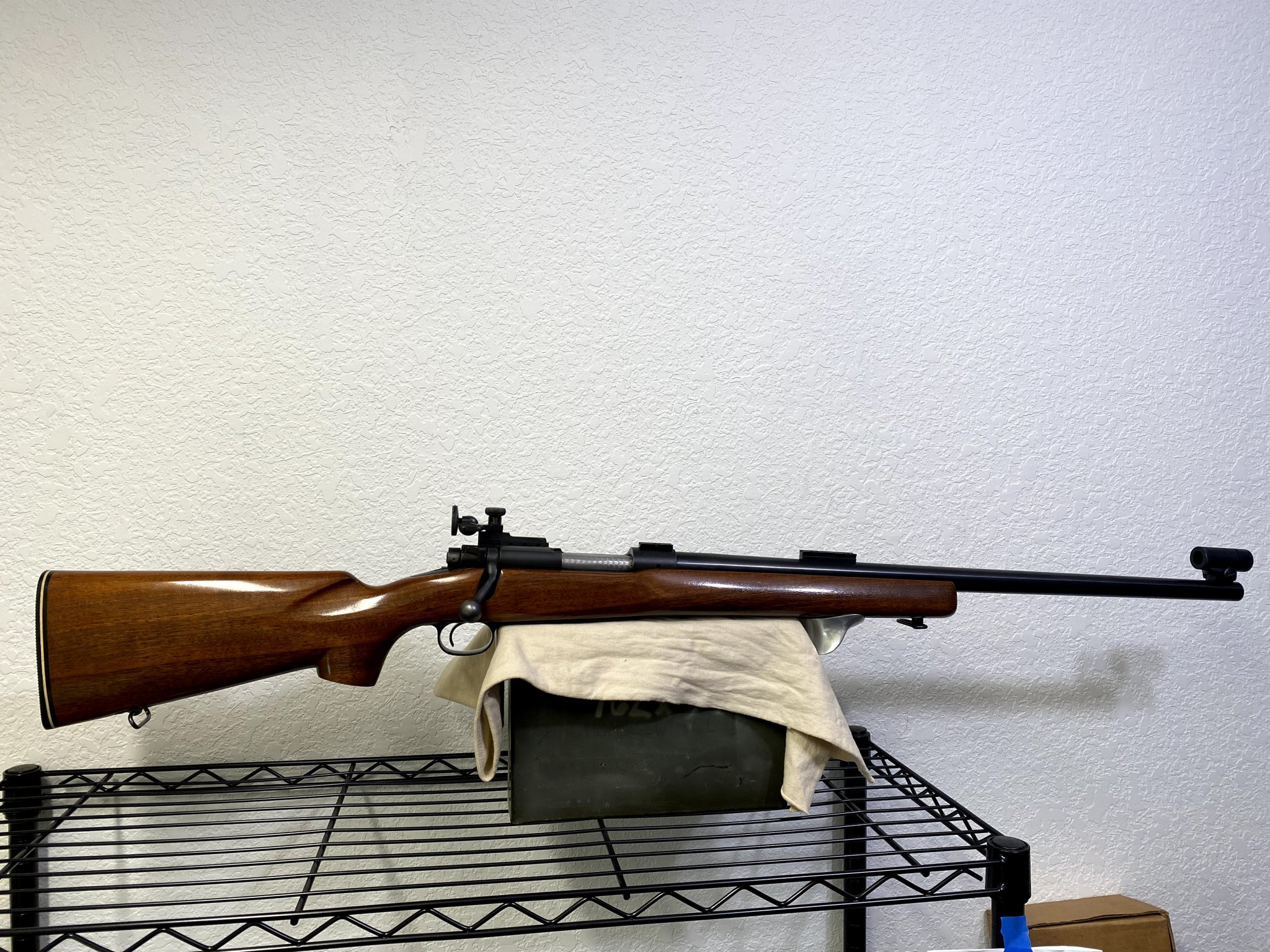

Since we are all M70 fans here, I thought you might enjoy seeing this one. 1965, first year push feed, in 308. Factory across-the-course and any-any rifle setup, ordered from WIN as a complete rifle/sights/scope combo. Best I can tell it's been to the range once or twice for zeroing, but never really shot. It's basically a new rifle, with new sights and a new 14x big tube Unertl. Clearly an evolution of the Pre-64 Marksman stocked rifles shown above. I don't know if anyone ever adopted this configuration into the Sniper ranks, though most certainly it carries all the features to have been a part of the evolution.

Yes - similar configuration, but pre-64 CRF.... mine is a '65 push feed.

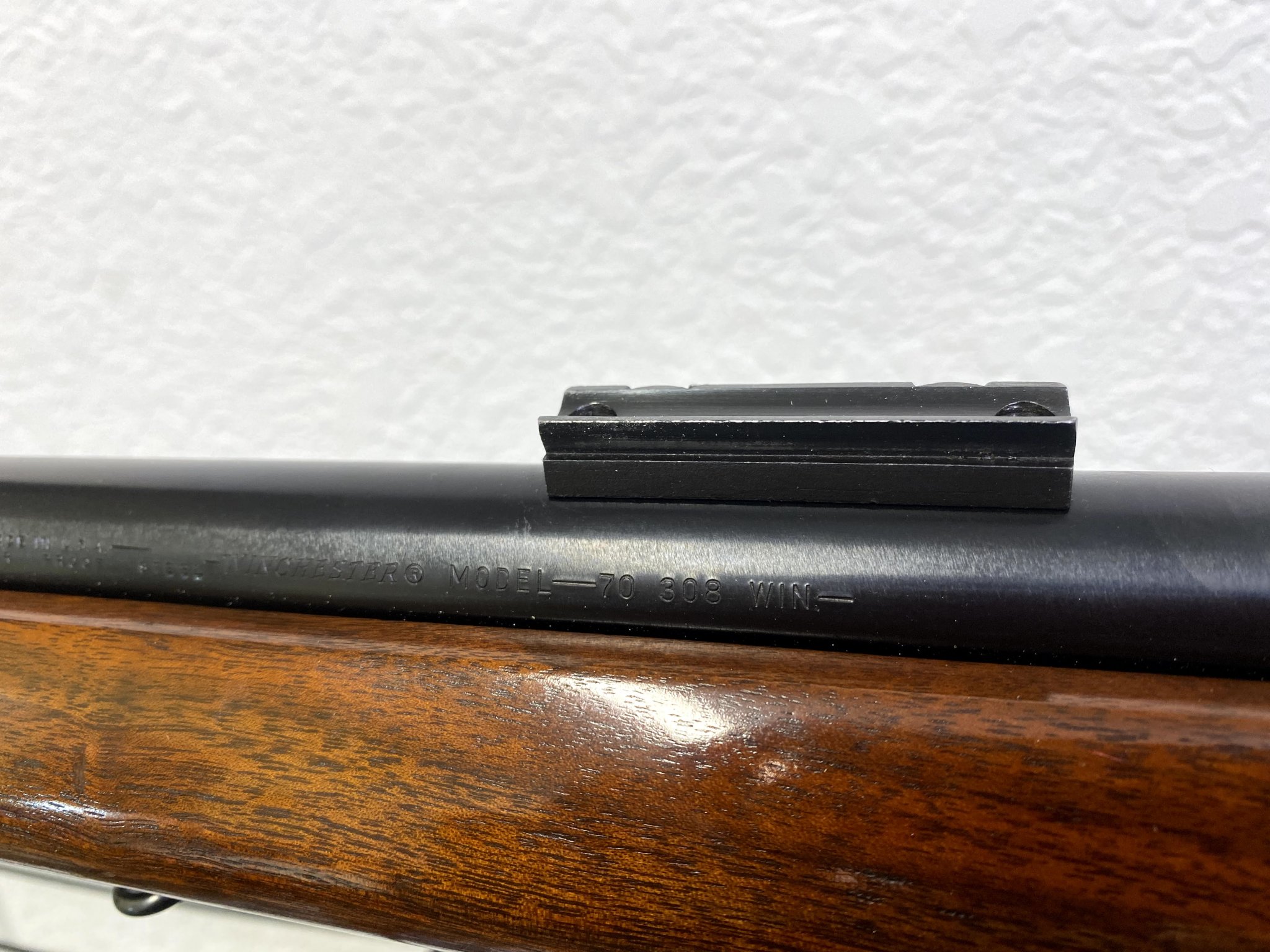

Your bases could be trued up with some brass shim stock hidden under the bases and you could do that yourself. The only way to truly "correct" the slightly off line holes is to weld em up and redrill..... not a pretty scenario. You can't "reclock" A M70 barrel with the extractor cutout in it. Besides it would only address one set of holes if you could.
Reactions: pmclaine
Bases could be trued with steel bed and look natural.
You dont weld on a barrel. You put taller plug screws in and fill the holes, then finish them level with the barrel, and a dab of cold blue..
You can then drill the correct location base holes where the base covers the plug screw fix, within an 8th of an inch of the original length from the receiver and not affect scope function.
You can clock a pre-64 a few thousands which "can" correct a small offset. The extractor cut doesnt have to be exact or perfect as long as it's not opened more than a few thousands.
Clock the front sight mount, plug, predrill the front scope base.
Either way, a competent smith can correct this.

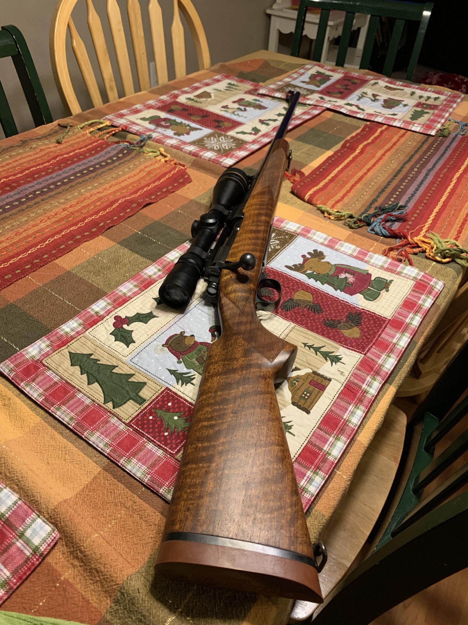

Anyways, enough mushy shit, here’s my contribution. 1941 Super grade in ‘06. At least the barreled action is a super grade, have no idea where or what the stock is. The bottom metal isn’t marked “Super Grade”, either way still a nice rifle. This post has inspired me to build a Resto-Mod, Vietnam era sniper rifle but with more modern optics. Maybe a S&B pmii fixed 10.
I don’t post much, I’m here often but more to learn and for entertainment purposes. I’ve been following this post since day 1 as I’m a huge m70 fan, and wanted to express how much I appreciate this thread and all the knowledge in here. Watching the roller coaster ride you’ve been on with this thing has been kinda gut wrenching, it’s like, what else could go wrong with this project?! Sounds like it will be made right.

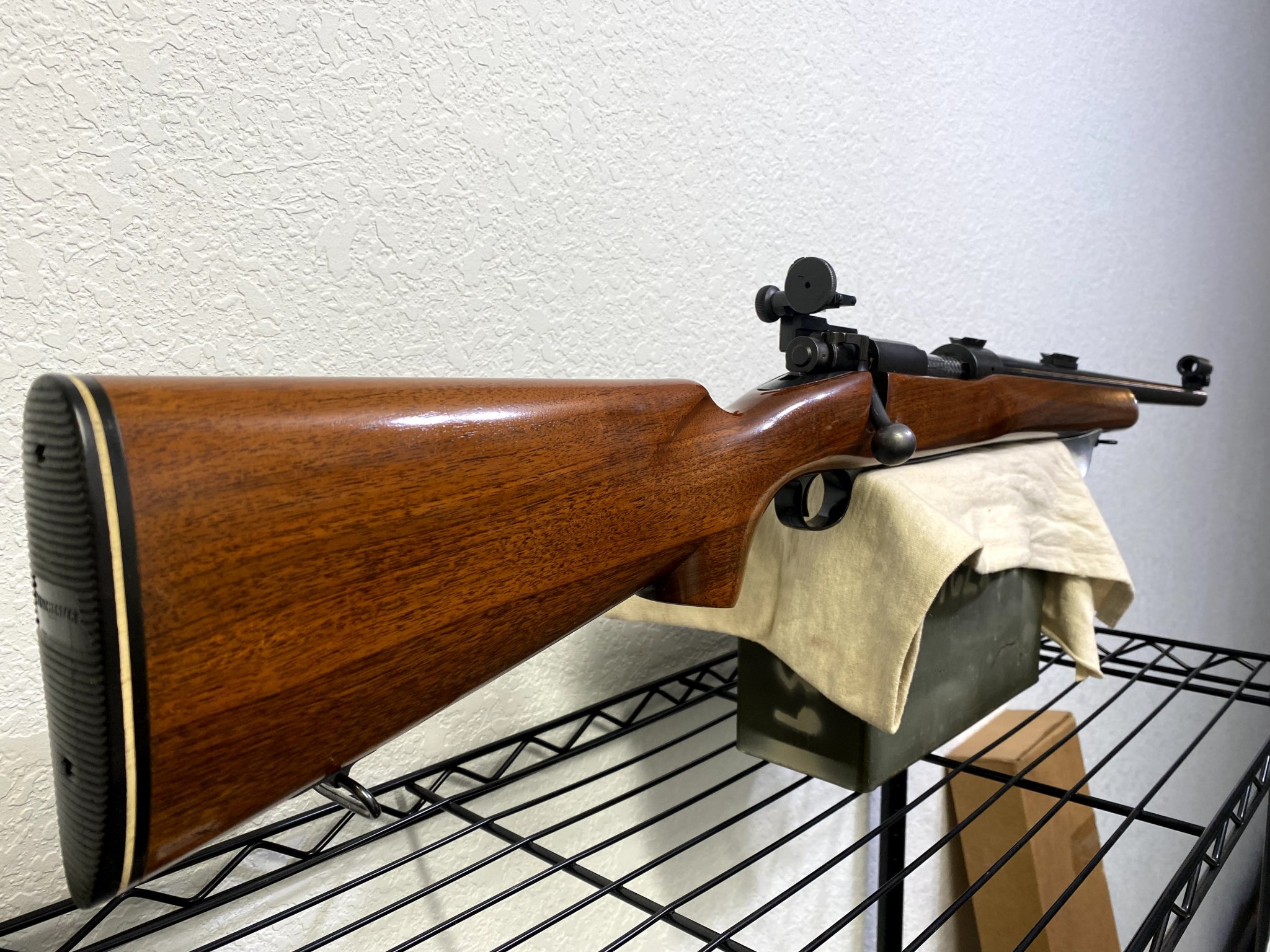

Im having LRI build me a "Modern Antique" based on the USMC M40 Remington idea....
They should be cutting the stock soon and Im really interested in seeing their work on that.
These wood guns shoot great but I do get hesitant to bring them out in rain or crap weather where as plastic stocks I dont care.

Those markings can indicate several things. S is often seen on .220 Swift among other things.
I have owned over 30 original Mod 70 Super Grades. None were marked in any way other than the floorplate. I have seen many standards marked with an S. I did see one once that was marked Super Grade on the barrel. It appeared original. It is doubtful your rifle was a super grade but there was little difference in the metal anyway. Some were jeweled on the bolt, some were finished a little different and they had a different front sight. Super Grade was primarily a cosmetic stock option with QD Swivels, more checkering, a cheekpiece and a black plastic for end tip.
Yours is a nice rifle.
