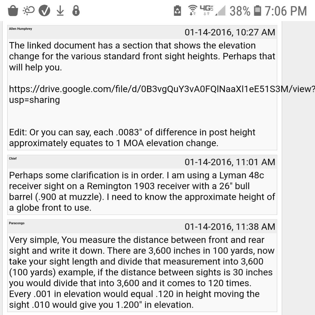

Maybe yall way more mathematically smarter than me to use the below.
So, that gives you in the neighborhood of 4 moa (approximately at 100) in the sight itself bc those old clicks arent perfect. So.......
With a tall target.... shoot the gun. As sighted in now. But, count the moa down to the stop and see how many minutes you are playing with and need on the mount height, to get your desired setting on the sight for the stop.
Run the sight to the bottom and shoot it on the tall target and see what u playin with on the needed moa.
You may end up with the lowest mount and the lowest lyman front to get as close as you can.

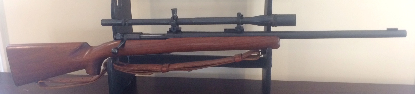

I have one built by TBA that I just got my 15x Varmint Unertl mounted on. Thinking I might go with a lower power
I have a 20X on a Springfield M2...the scope shake is no joke.
On my M70 I run a 10X.....its perfect.

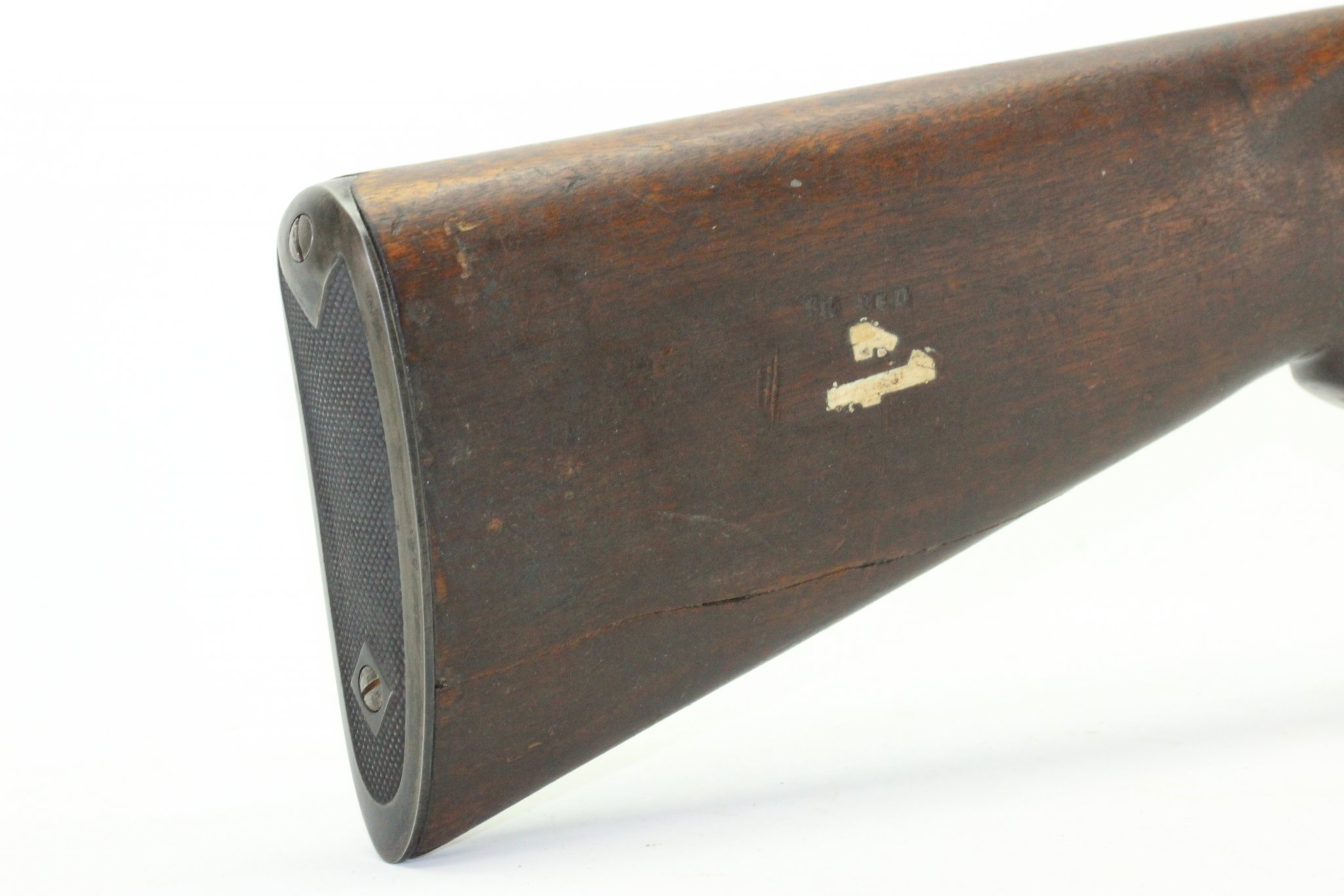

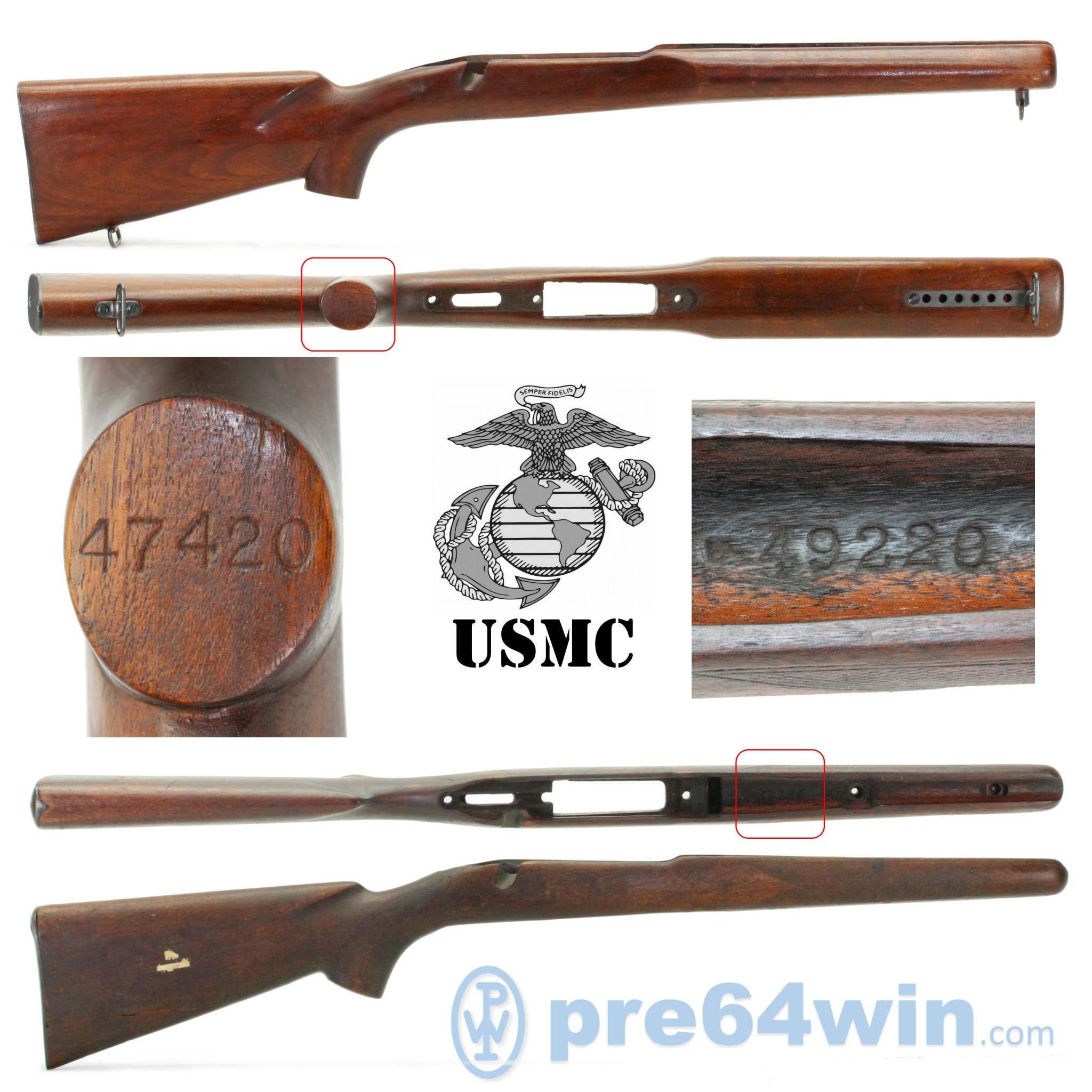

I have a two stocks in the shop from the original 373 USMC rifles. One is a marksman stock that has already sold and is going into a sniper build we are working on now. The other is a Low comb sporter stock with heavy original patina. A rack number is stenciled on the butt, some various stamps randomly scattered on the exterior of the stock, and the serial number stamped in the barrel channel. This latter stock also has a very large toe crack which has been repaired in our shop. It is by far the cooler of the two stocks, but may be too rough for most to be interested. Photos of both are below, with a couple additional photos of the sporter stock. At the bottom is a WWII era photo showing both styles of rifles being used side by side in training.
If you were not thinking of going with something this authentic, we have plenty of other options for you. Just let me know the details (pre-war tang & low comb, or something different?)

Slight correction.....that last photo is the Vietnam USMC sniper school....

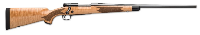

I looked last night at a McMillan GP in marble walnut, and almost ordered it.

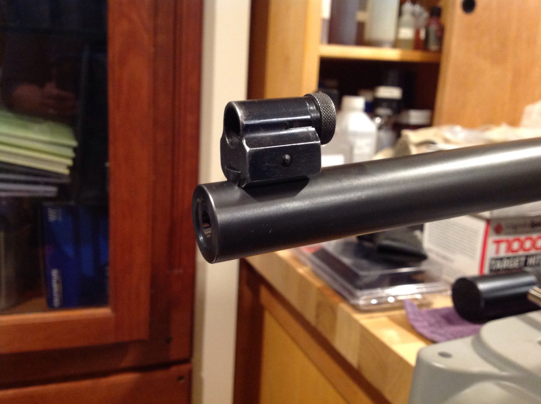

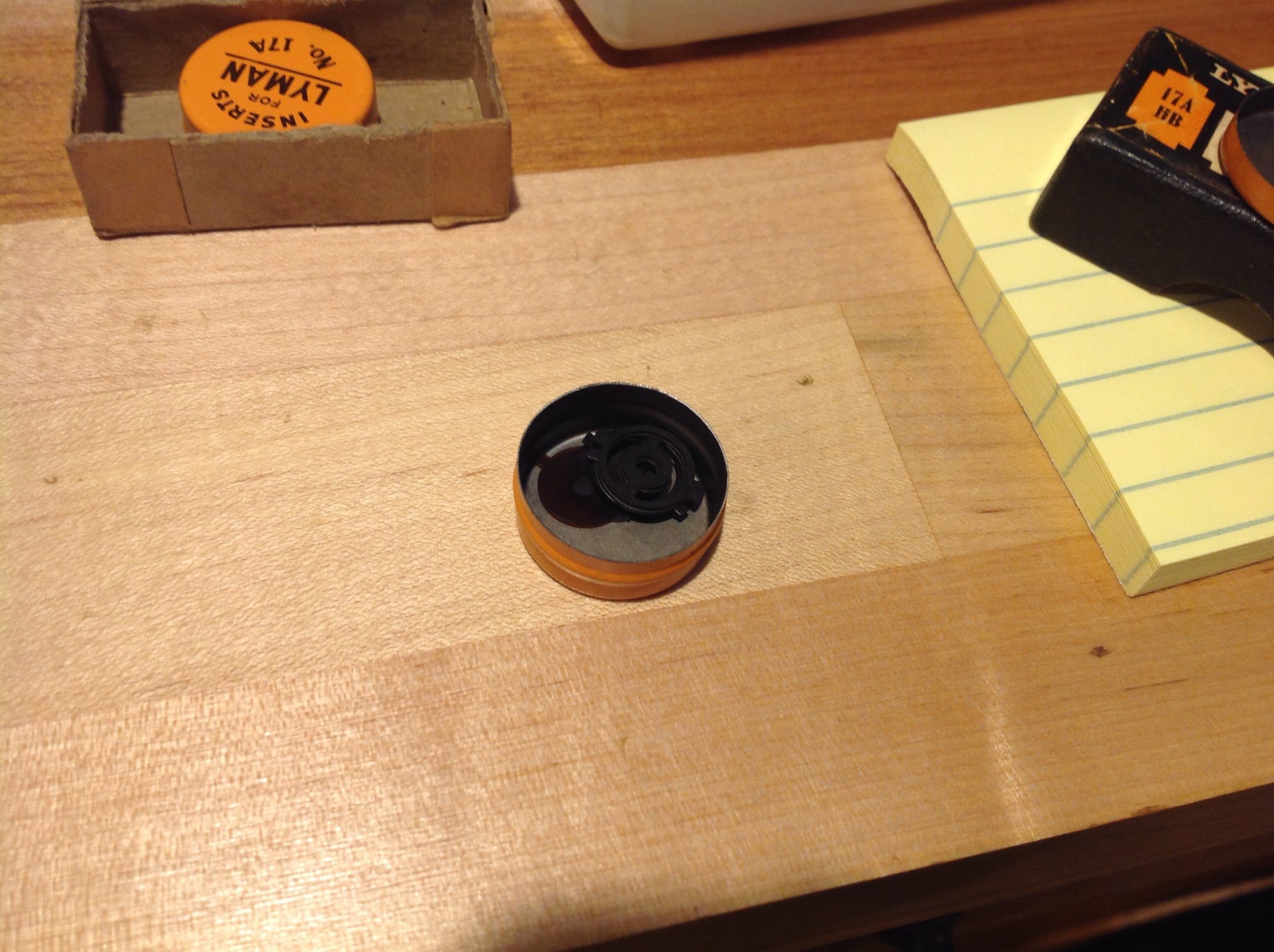

I think it's as low as can be.
I had to hone the bottom of the site to fit.

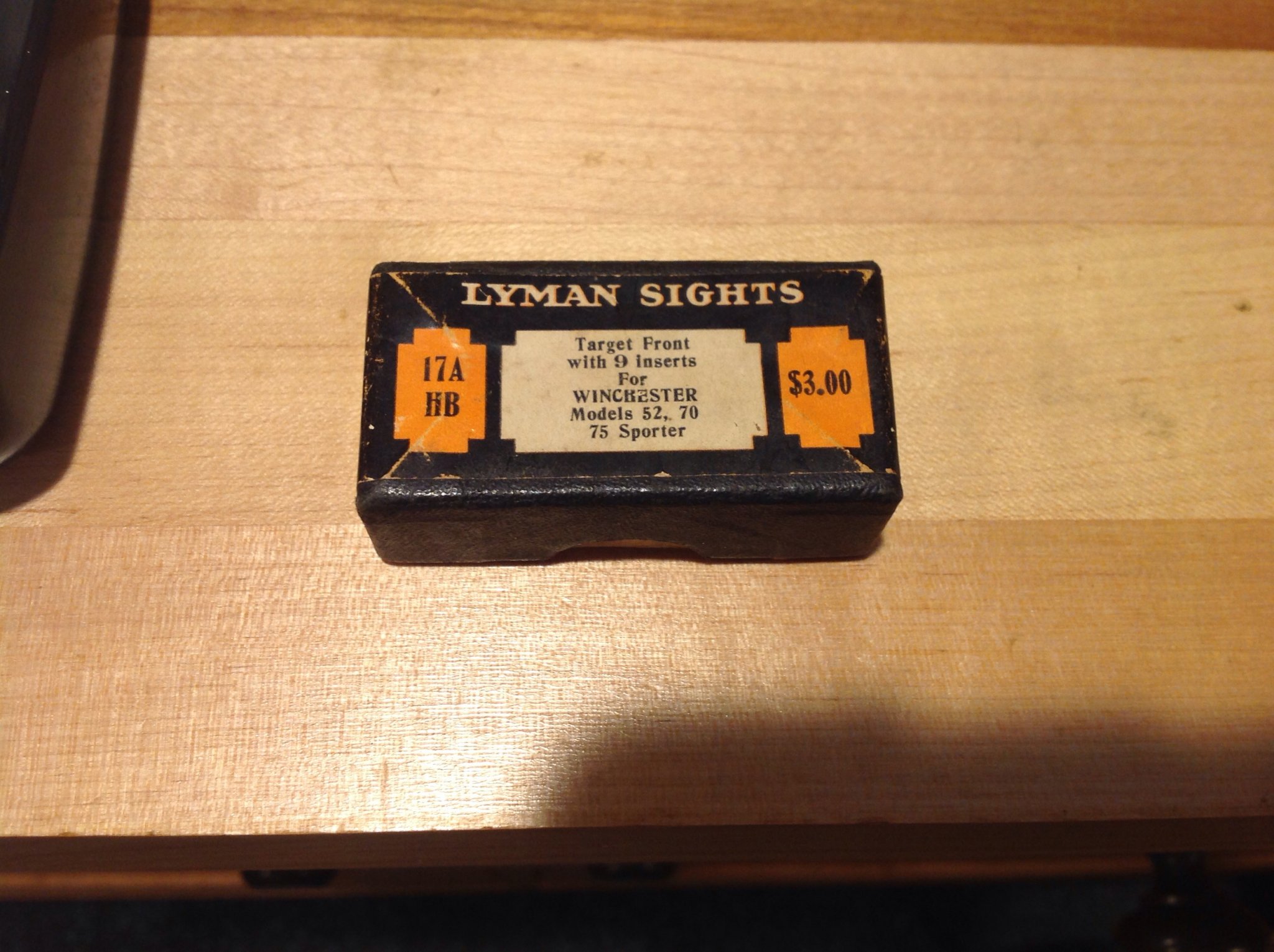

It looks good, Phil. Pretty clean. Not sure if the Lyman was lower than the Winchester, but I sort of agree that the Winchester has a better more utility look to it. Good luck finding inserts for it, however. I assume that is why you went with the Lyman? Anyhow, let us know what that did for the aperture arm on your receiver sight. Close to getting it back where it belongs?

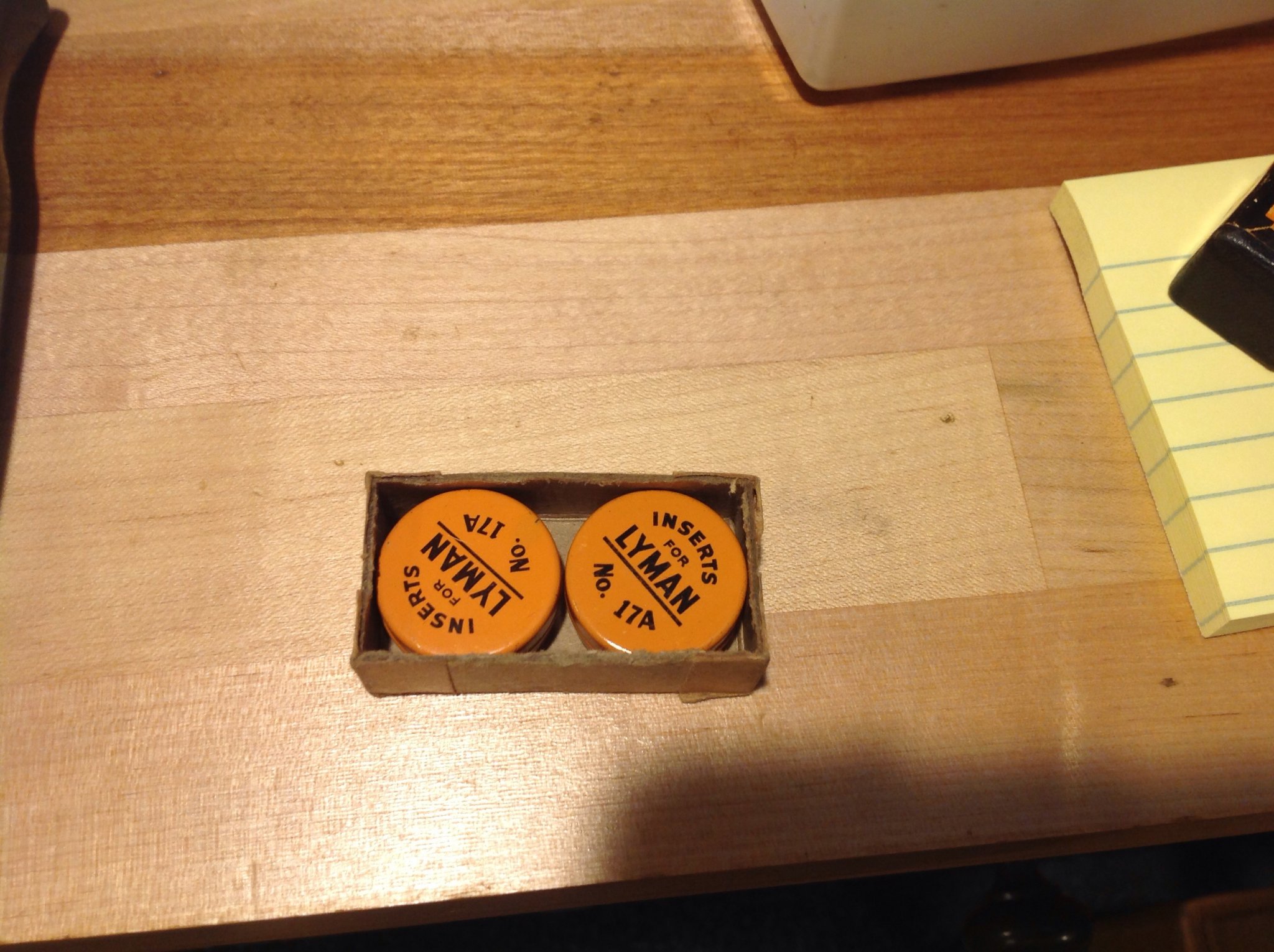

I've been lucky to find all the Winchester inserts.....people buy entire guns just to get one of the three they are missing.
The Lyman is lower than the Winchester and if need be I could lower a Lyman front sight post....I don't think I will need to.

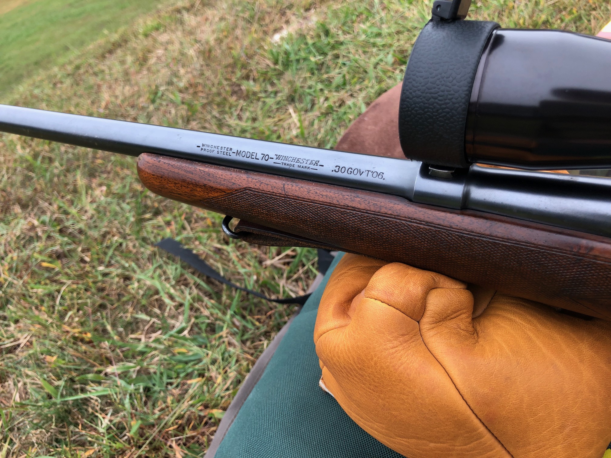

My USMC replica started out as a pre-64 Featherweight hunting rifle (299xxx serial range - not sure what year) with a skinny barrel in 308W,
and an old Bushnell 3-9x scope. Found it local for $750 back in 2016....
...but it was subsequently re-born with a new Douglas barrel with WRA's 'medium-heavy' profile in caliber 30-06, given a satin blue finish,
...and carefully bedded in a Marksman stock. Initially had a 10X Lyman Super TargetSpot, but later got a 10X Unertl, as seen here:
(Also found a 1963 dated leather sling for it)
Used it once at a vintage Quantico Shooting Club match a few years ago, and had a nice chat with Maj. Land (ret)
about these oldie but goodie rifles. This thread makes me want to try it again this summer at another match.
