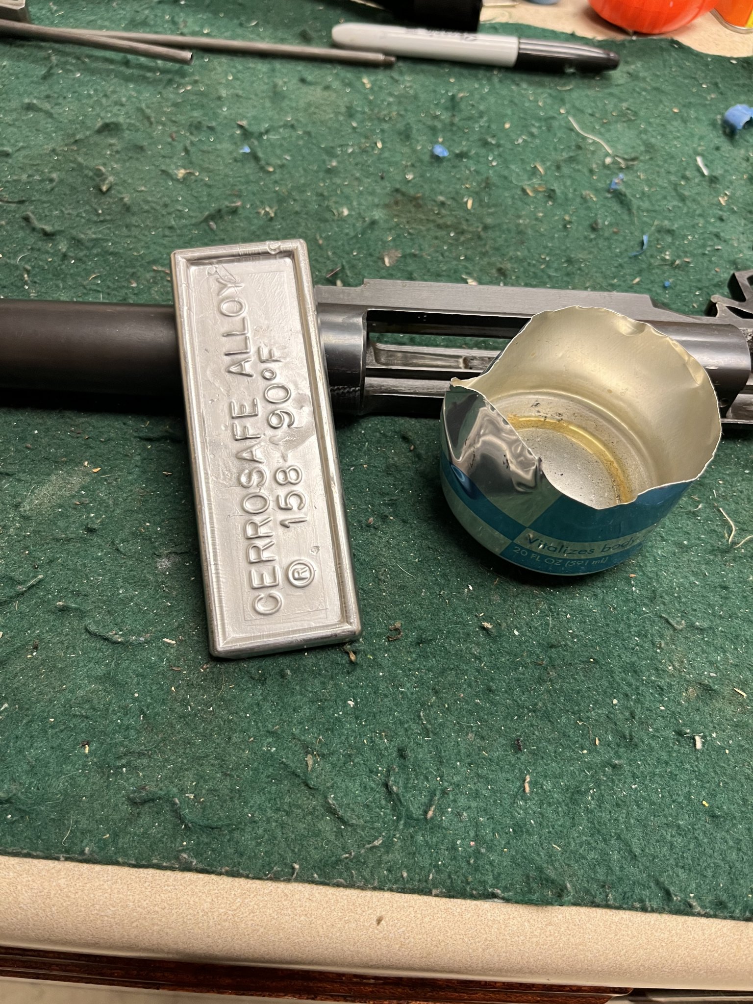

Brownells shipping has gotten slow. I am still waiting on my chamber casting material to ship, it was ordered on Monday or Tuesday. If I wanted to support amazon more, I would have had that crap Thursday
You should have told me... I could have had you some Cerrobend for nada!!!

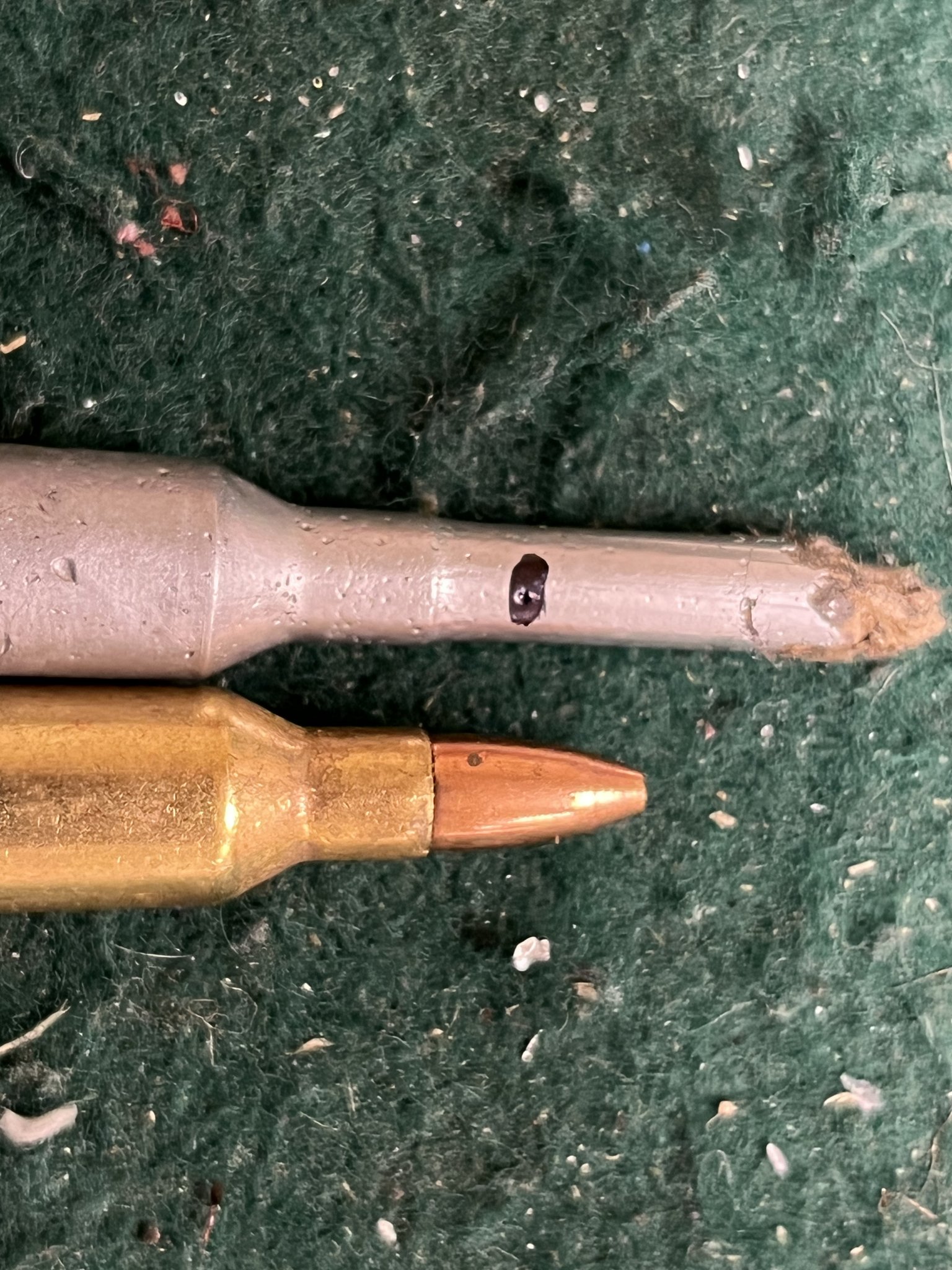

Casting material should be here tomorrow so the weekend will be for truth telling and maybe some shooting if it is in fact a 22-250

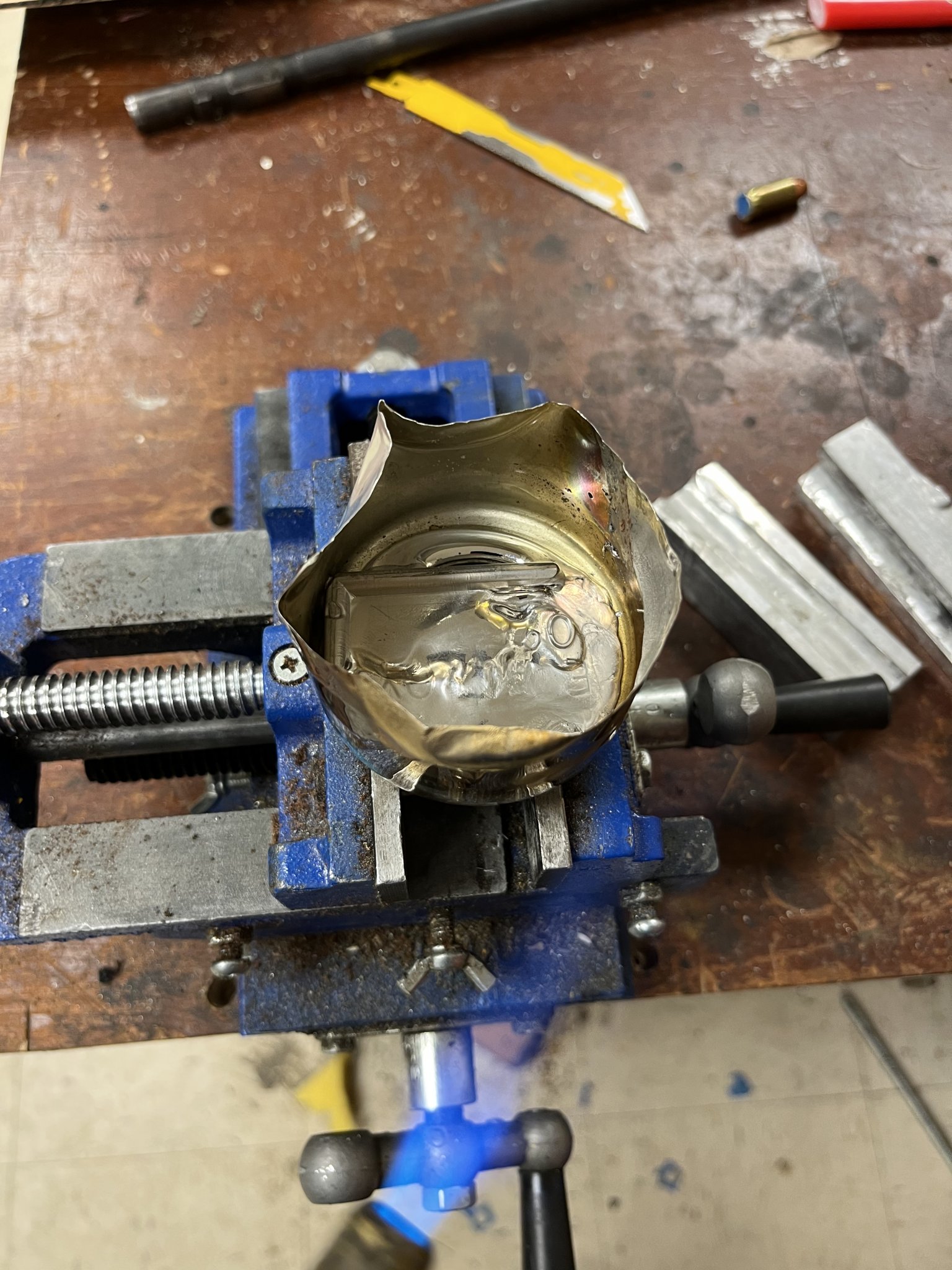

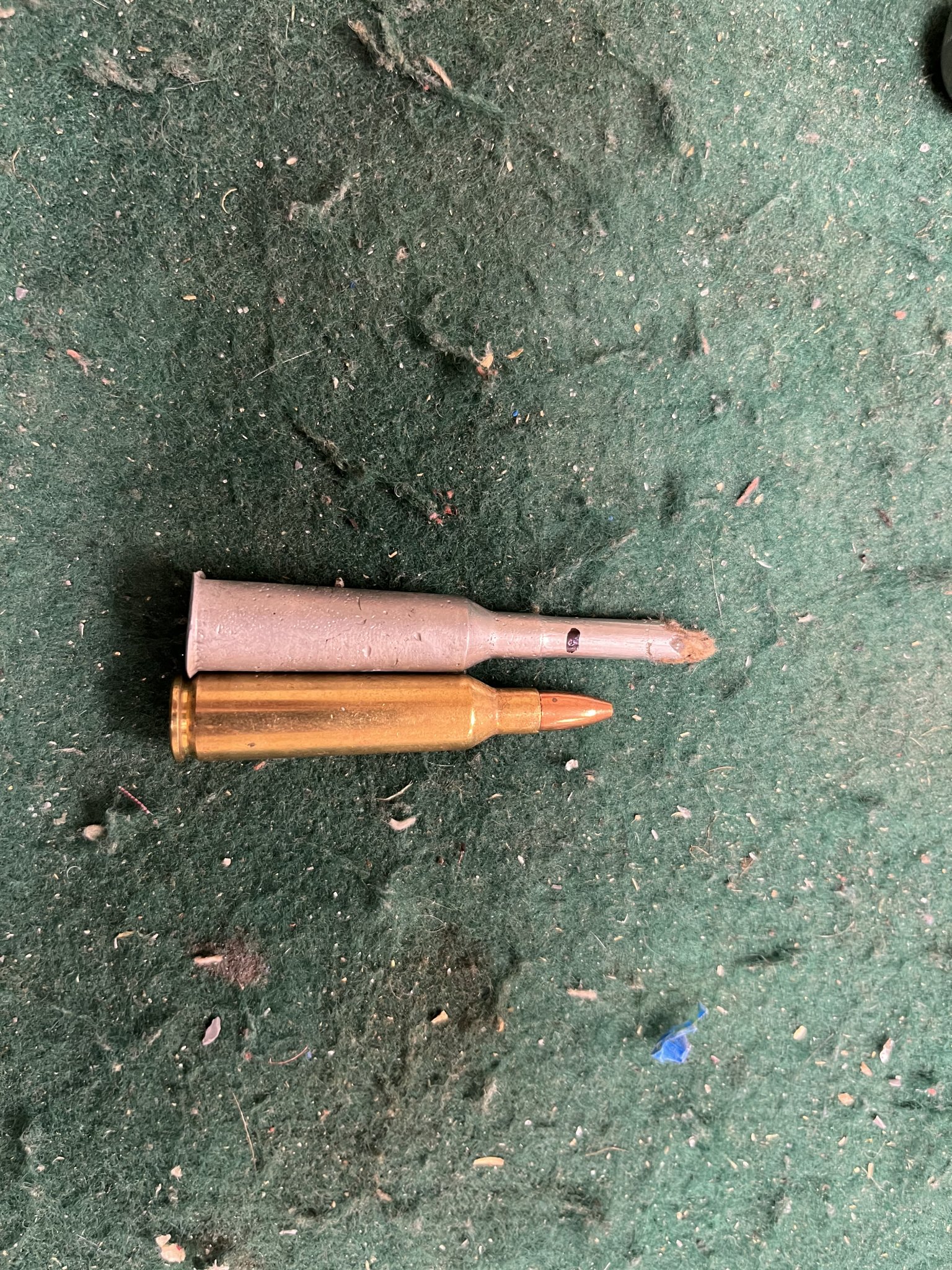

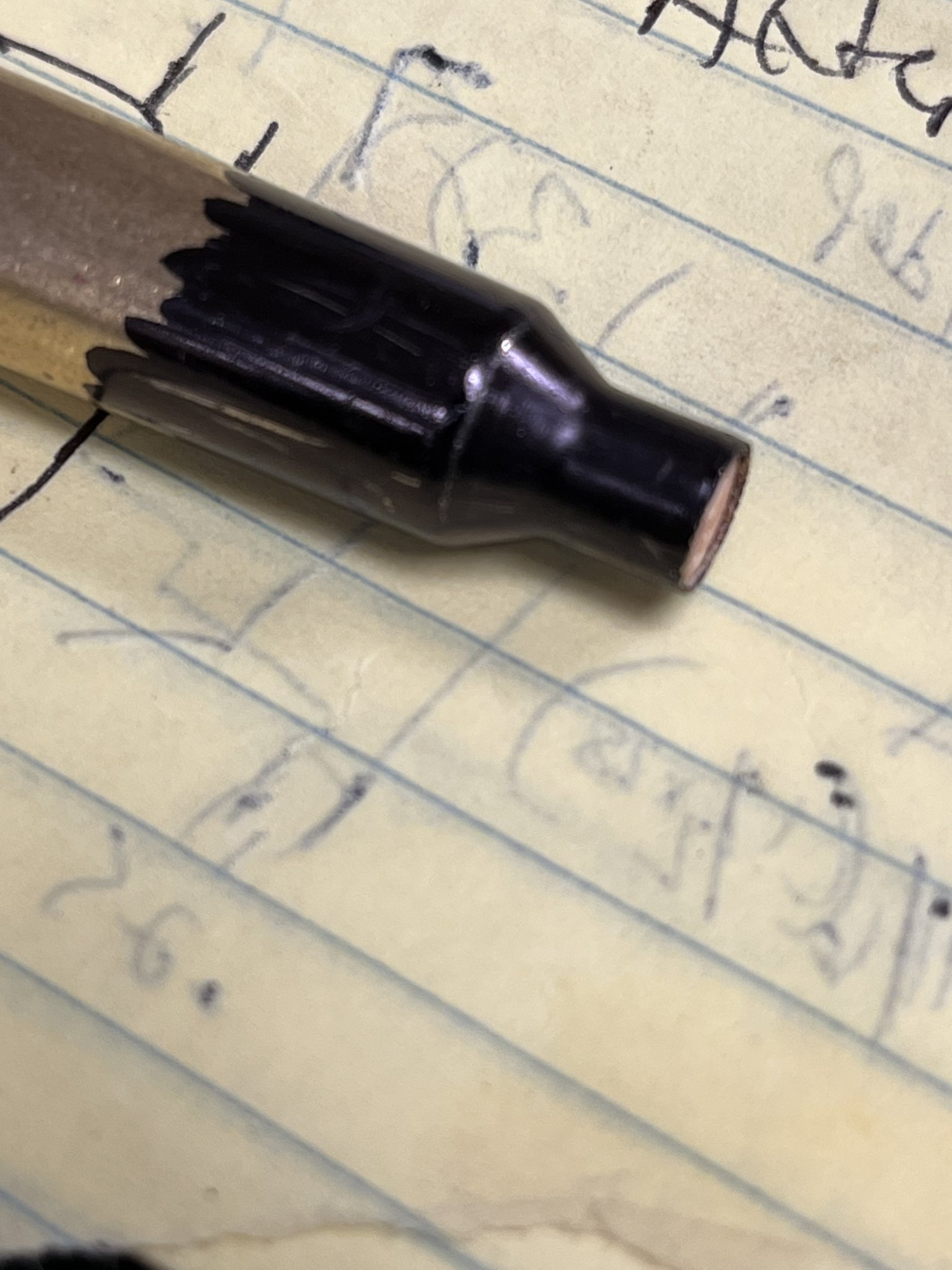

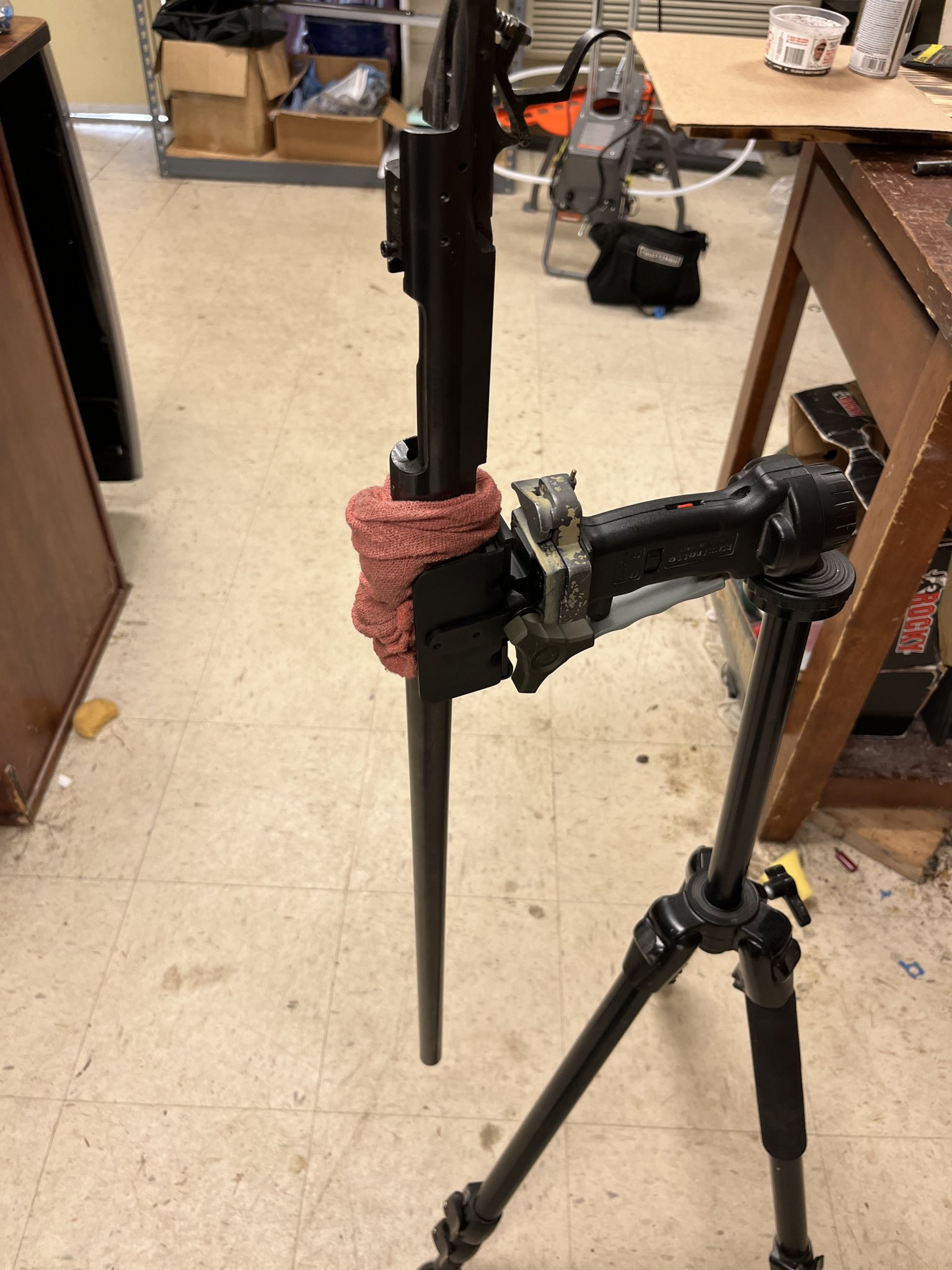

Casting material showed up. Cleaned the chamber, stuffed it, and lubed it(sounds like those three events should be in a different order 🤔). Anyway, broke off appropriate amount and added to my Red Bull can. Switched my MAP to regular propane and got busy melting. Pour went good, will wait for it to dry and have the gender reveal.
^ Hmmm. .25-20 single shot is a pretty narrow case if I recall correctly.
I saw the casting and thought "It's a .219 Zipper!" (though that's probably just because he cast a perfect rim)
Electro-penciling your name and drivers license number on your guns seemed to be the thing to do in the late 1950's and through the 60's, but I'd love to know started that awful fad.
Based on everything I can find so far, and my odd mafia of folks, and as close as we can eyeball... off pics...
Without more to go on.
So more digging is definitely in order. Shame on me for not trying it earlier, but I never actually closed the bolt on a 22-250 round. As it turns out, it will not close. I marked the case and worked the bolt a few times. You can clearly see the line on the start of the shoulder. This is not a 22-250
So digging continues. Pulled some old manuals. The Speer #9 is full of choices, but two cases have caught my eye. The 225 Winchester and the 220 Swift. I am looking for case dimensions of the 22R, none of my old books have them.

In a pm, I posted about that rim, that rim is simply overflow out of the chamber patted down when casting. There is still "lost" length to the bolt face, that casting can't capture.
My thoughts on the width of that casting VS the R Lovell case are similar to yours. Without more to go on...

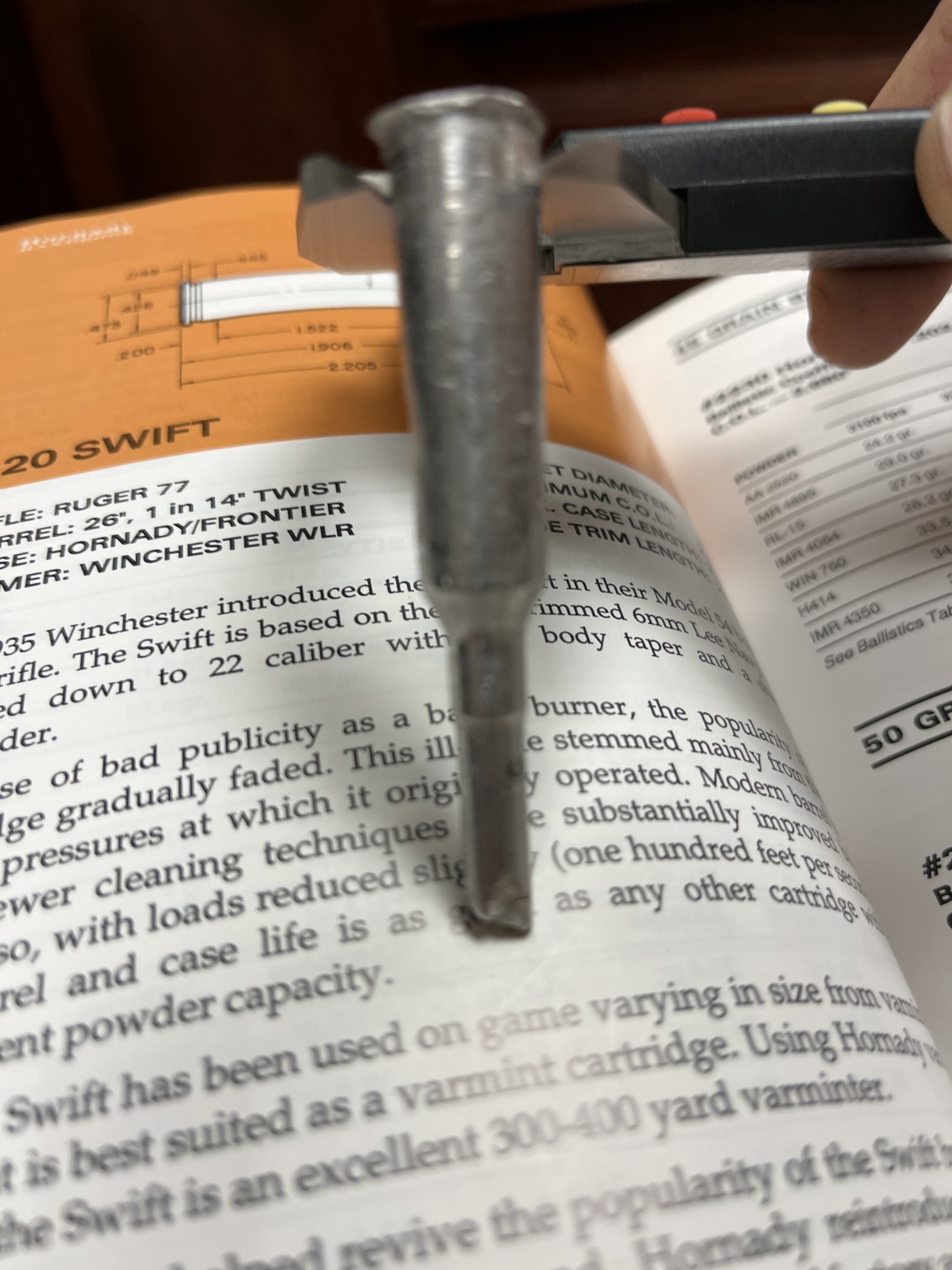

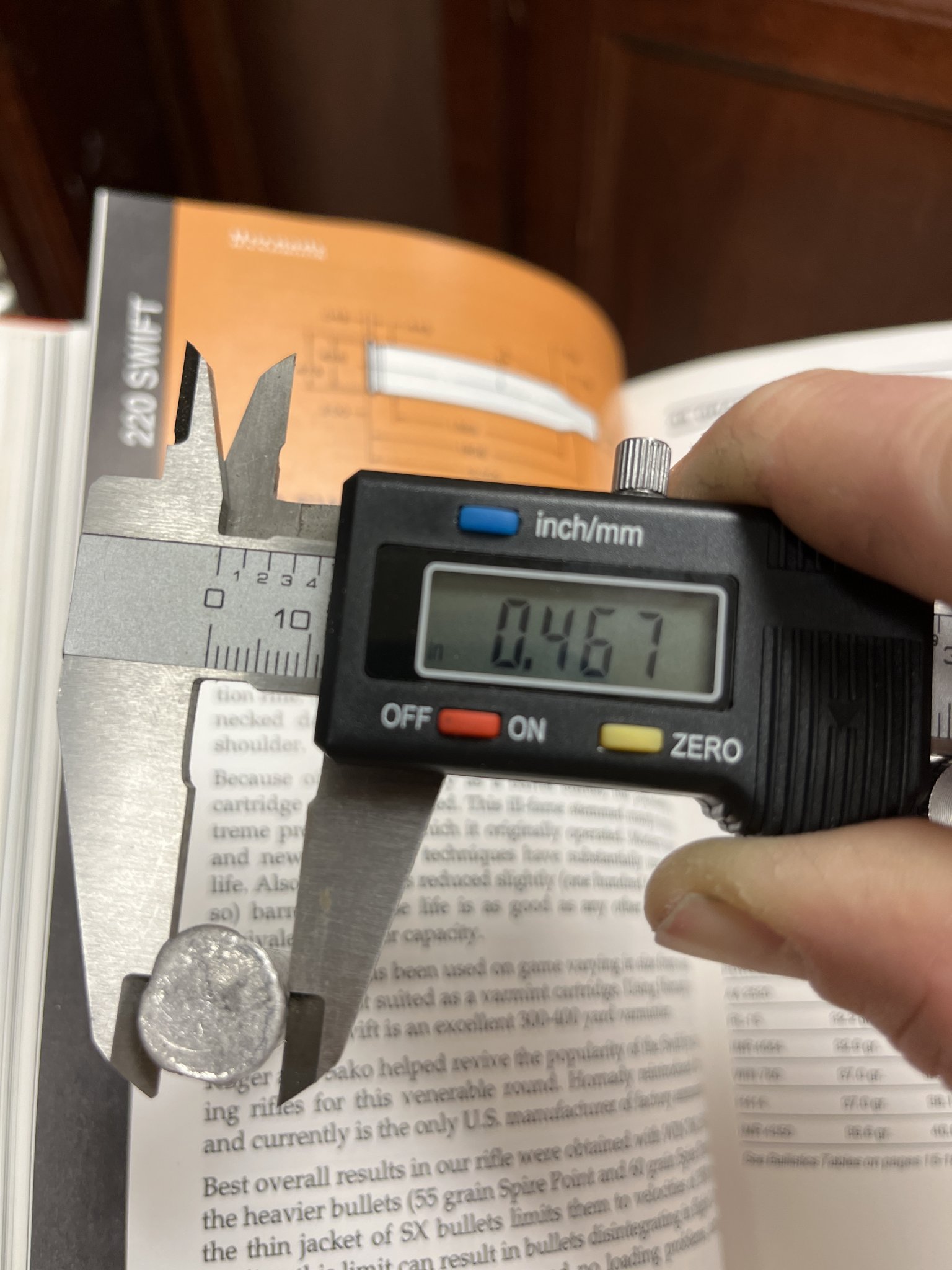

Please give us caliper measurements on the mouth, neck junction, shoulder, and at the end of the casting b4 the mushroom. Plz
I'm not where I can get to my old lyman book. At some point....
Where oh where is my copy of "cartridges of the world" ....
Reactions: roostercogburn98
@j-huskey
Mouf- .260
Neck Junction-.262
Casting end-.473

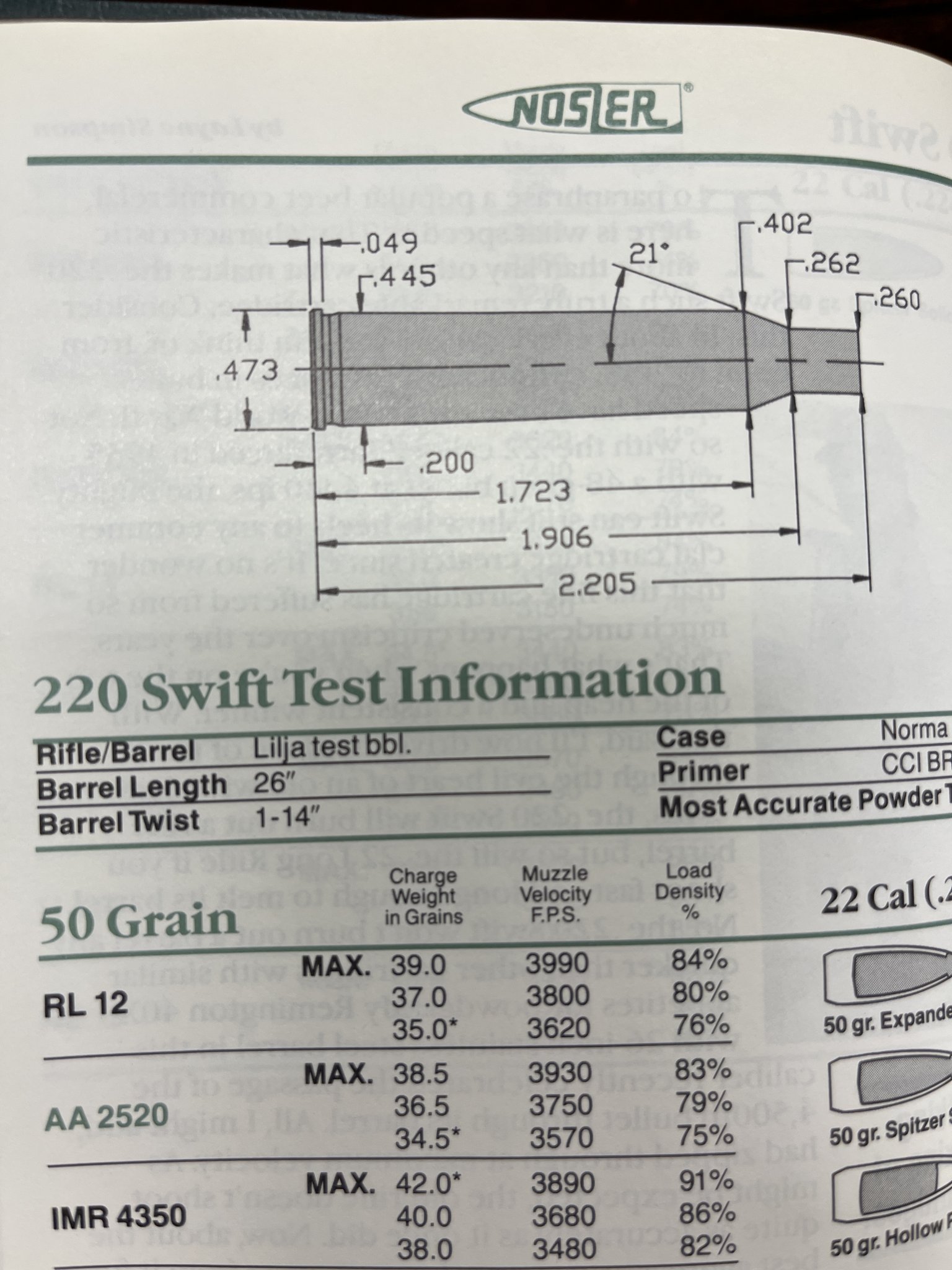

These dimensions are exact for a 220 swift in the Nosler #3 manual
That .473 at the end of the casting.... should be .445 for a swift. That dead space, missing from the casting between chamber face and bolt face.
You are correct, I run the calipers around some to see if it changed. I can get .467 just below the mushroom, so too big for 220swift there. Digging through some hornady manuals now

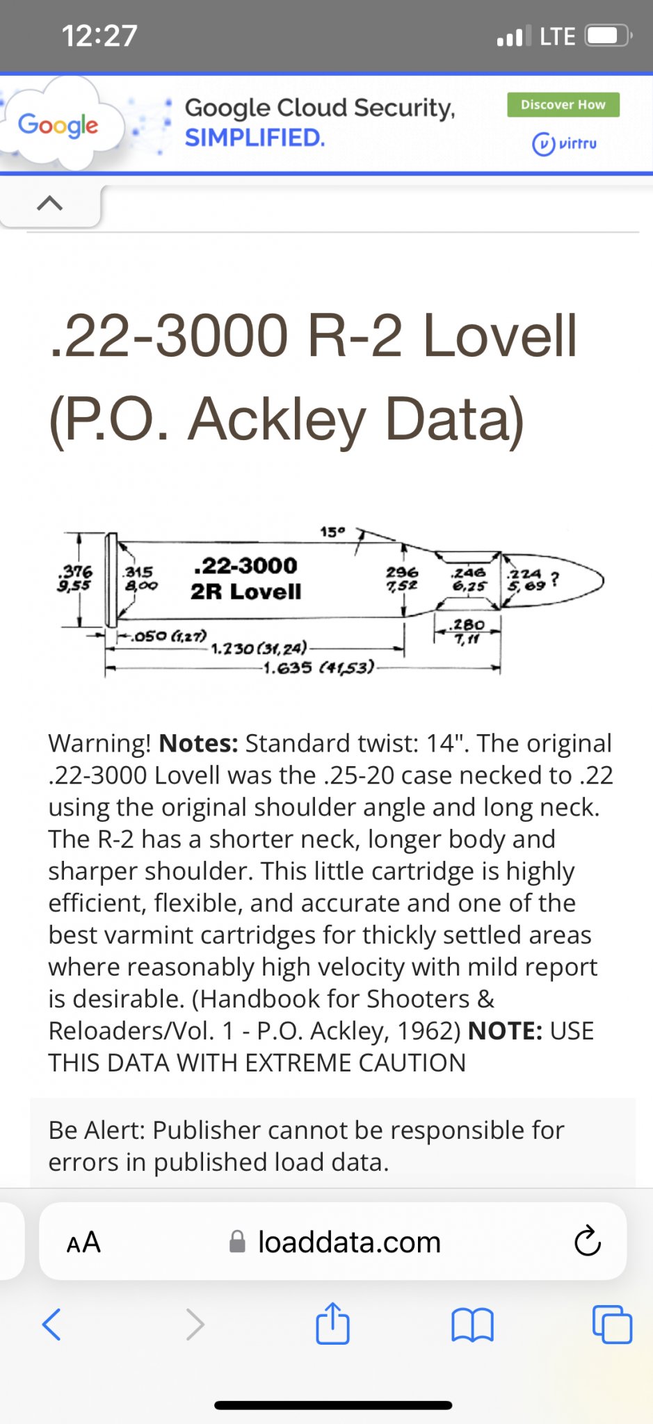

Not a Swift by any chance or a 2R Lovell. I don't know who posted the shit in the book that j-huskey showed (no offense j-huskey, the book is WRONG) but that ain't an improved version.
The shoulder should measure .419" and the base should be around .470" (convert to metric and it's ~about~ 12mm, give or take...Damn that Paul Mauser was a smart guy).

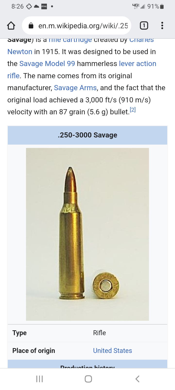

Have you determined if the bore is .224", .243" OR .257"? Remember this case could be based off the .250-3000 (1915) or the .300 Savage (1920) which has a 30 deg. shoulder and is .062" shorter. But the .300 Savage is a .447" shoulder With the taper I see, it should be based off the .250-3000 case

Is .467" what I should be after?

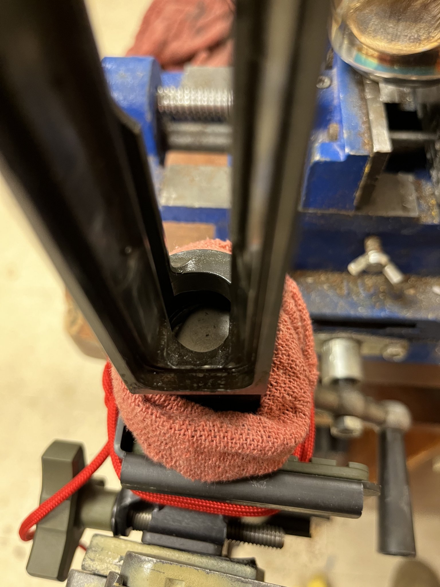

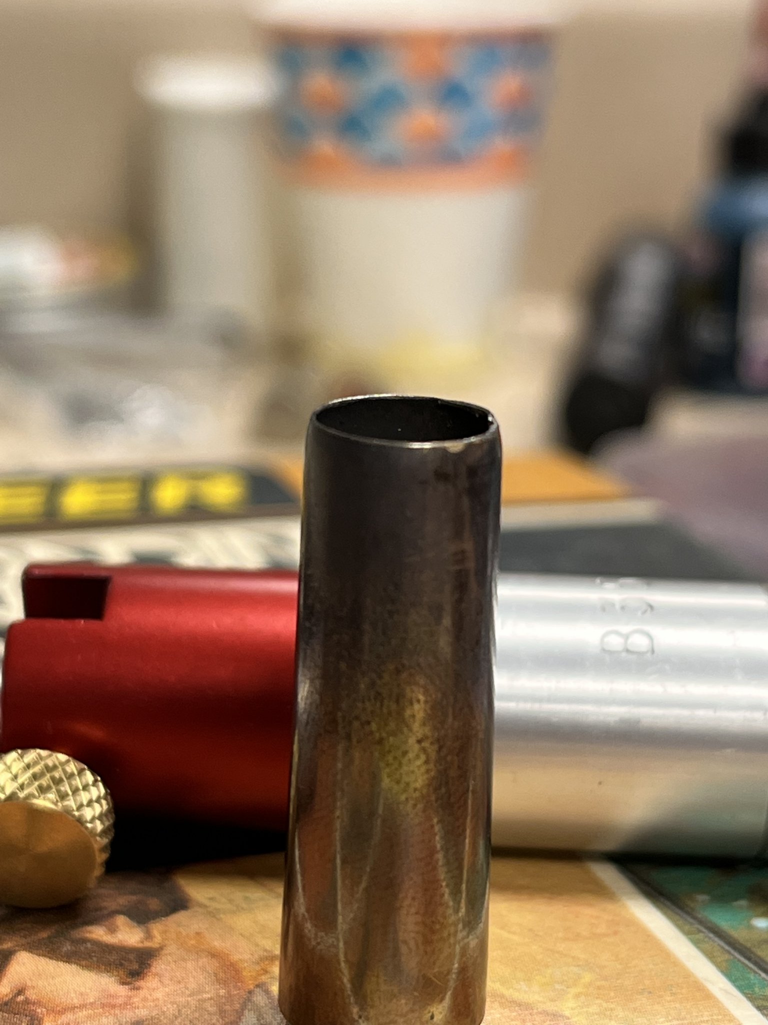

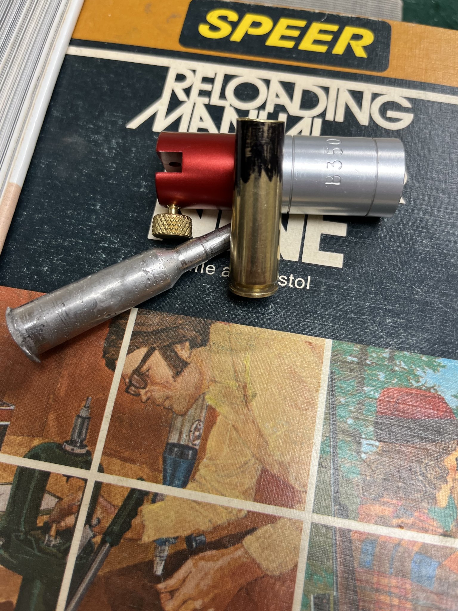

cut the 22-250 case off just below the shoulder. Be like a 44 automag case. Anneal the hell out of it.
Try to chamber form it in the action...
Be real curious. That would be my next thing.
Hopefully it would just start to form the bottom of the shoulder and not into the neck.
@j-huskey
Had to break to go mess with horses, will try that when I get back to the house. Got a chop saw, so will chop one and got it with the benzo torch for a few. Might get bored and cast the chamber again just to have two references

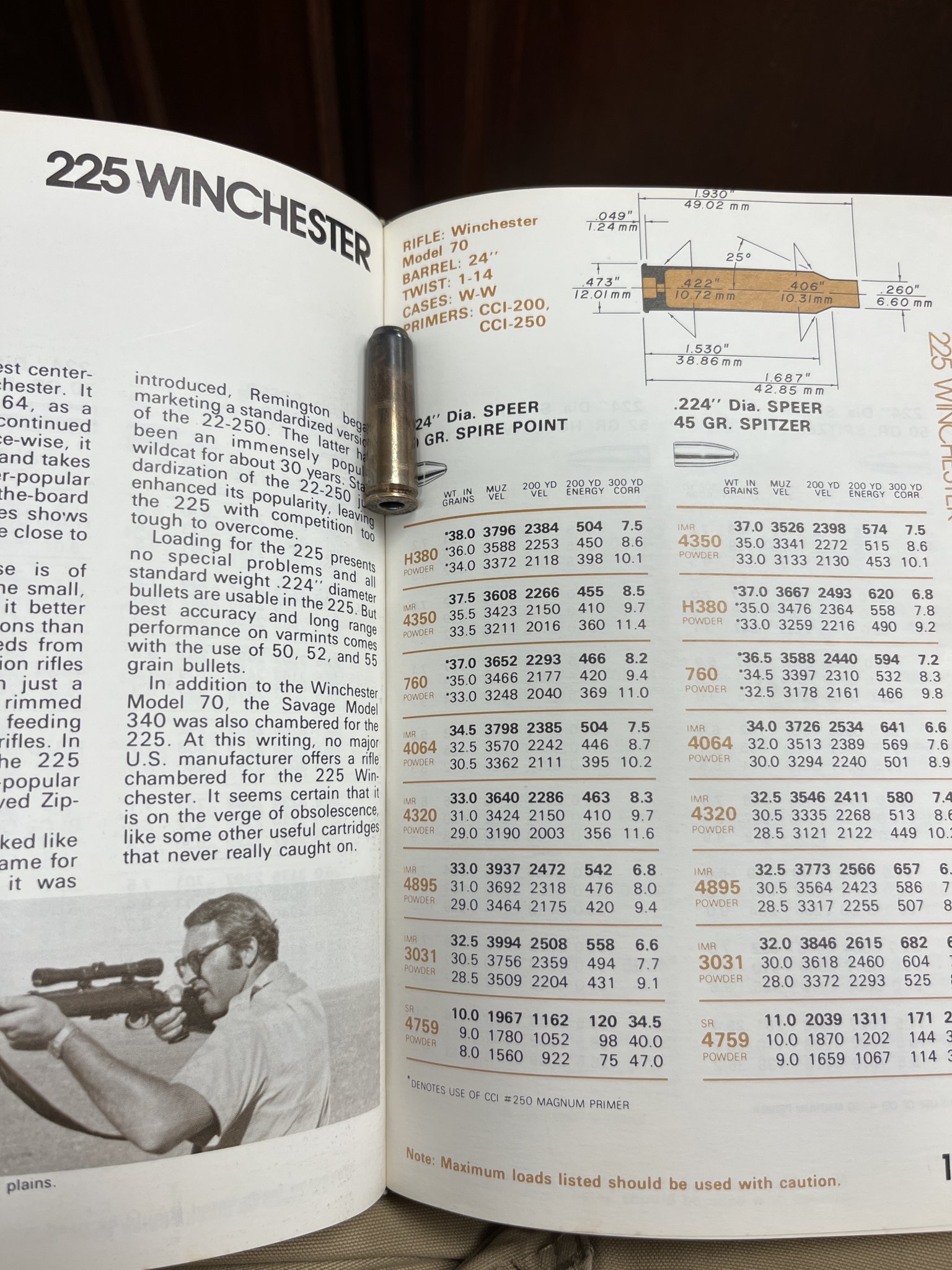

Case cut just behind shoulder and annealed till it cried momma. You can just barely see the shoulder starting to roll
That gives you more measurements to work with.
Base to shoulder.
Base diameter.
Shoulder diameter.
Shoulder diameter on the casting.
Along with the other casting measurements.
Might get closer to knowing what it is.
Base to shoulder.
Base diameter.
Shoulder diameter.
Getting close measurements to a 225 Winchester with that method you referred to. Head to shoulder measurement is 1.53 which is exact for that caliber. All other dimensions are fairly close or exact.
Time to find a 225 Winchester cartridge and see if it fits.
Where oh where 225 win Cartridges....🤨
