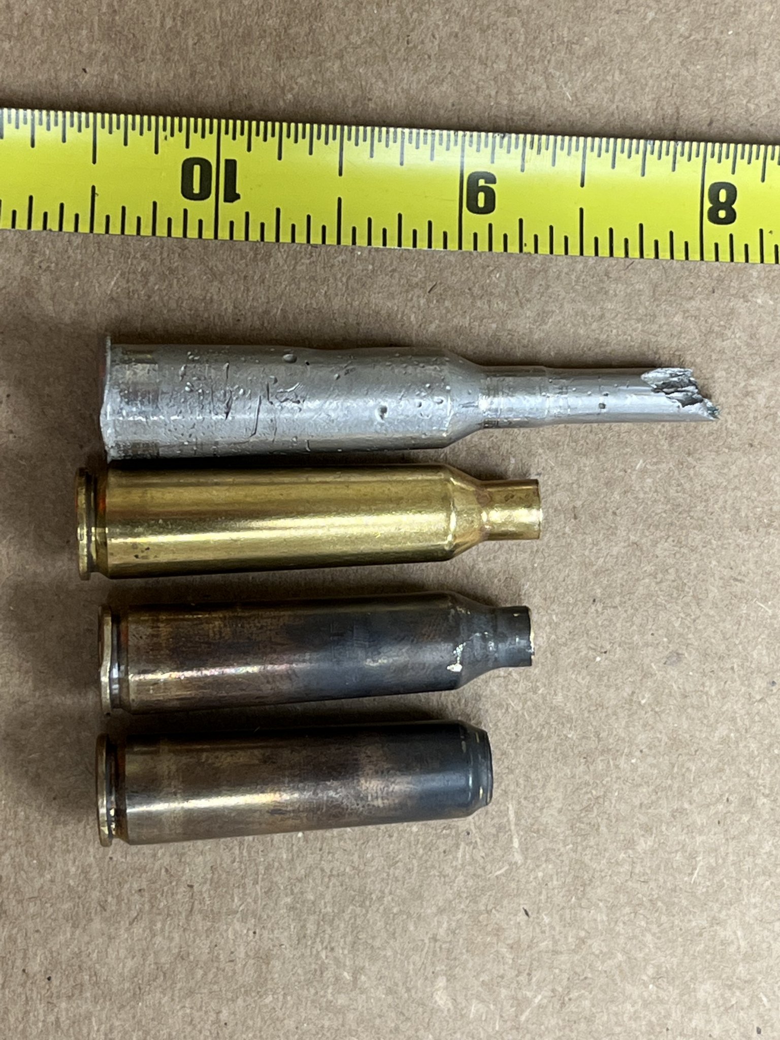

To prove Marksman's point... the easy way... is.
Pull another 22-250, decap it.
Anneal the crap out of it and "bolt size" it like you did the cut off case. It should , should be pretty above.
It really looks like that would give you the closest case to the chamber cast.

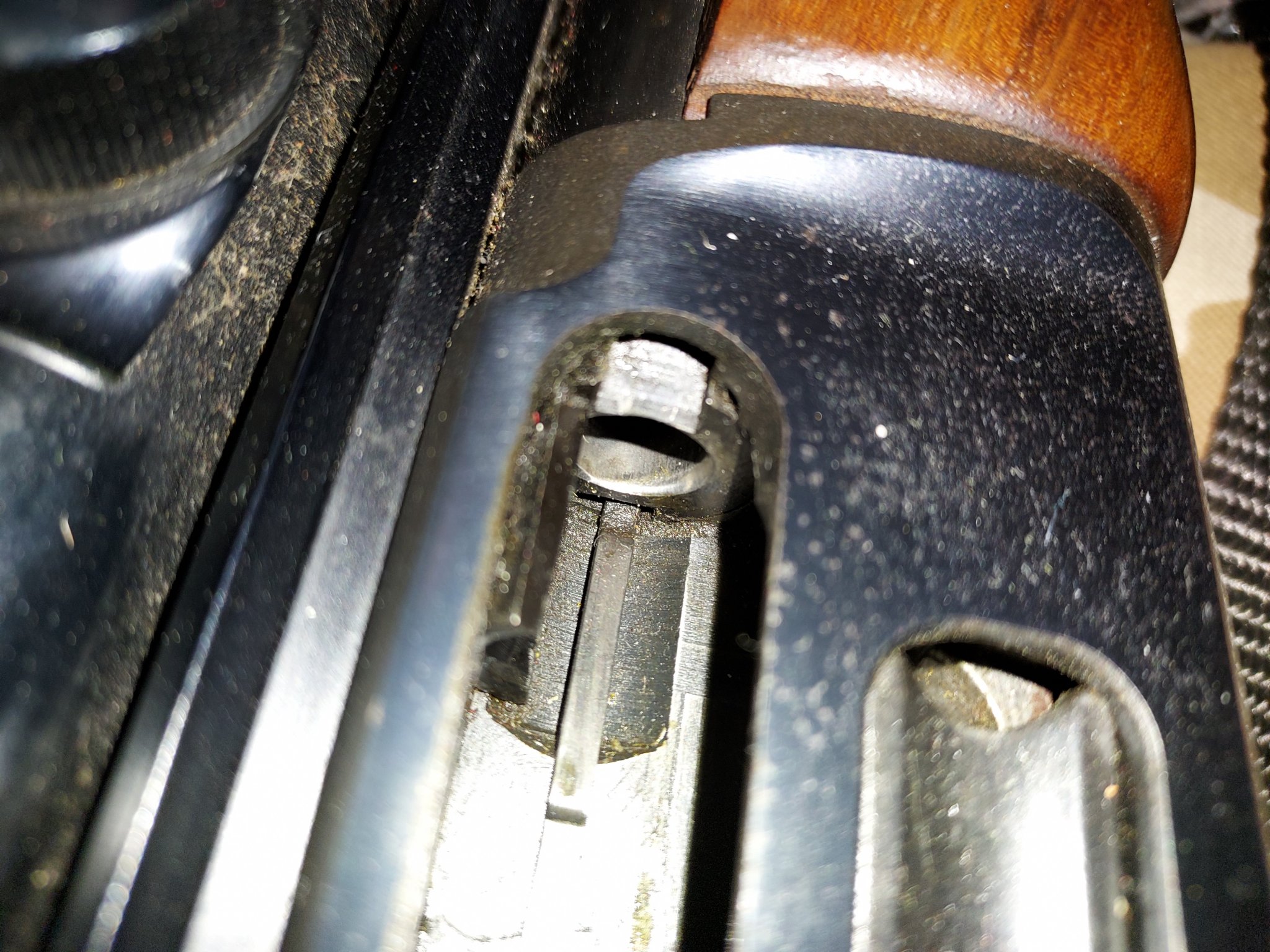

Unless this defies standard gunsmithing practices, there should be what looks like a counterbore, at the base of the chamber, the diameter of the rim. If you have a rimmed cartridge. Rimmed cartridges headspace on the rim, not the shoulder. You can fireform them and headspace off the shoulder if you wish. As this is an unknown wildcat, there may be all kind of things going on with this.

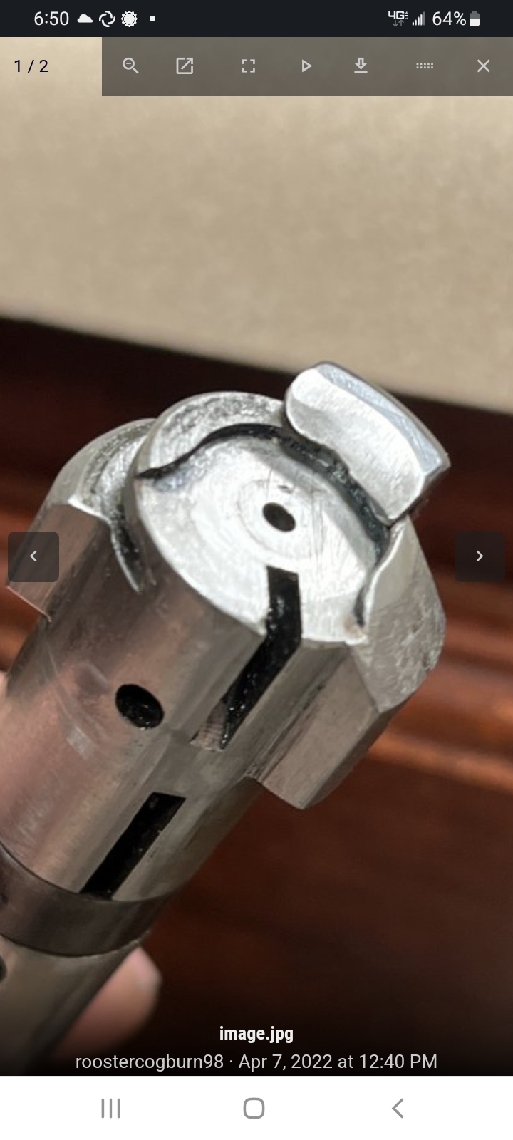

Can you post a pic of the chamber that is illuminated? And the bolt face? What diameter is the bolt face? (only that which holds the case head)
And, FWIW, I cannot imagine how a conical bolt face would do away with the extractor cut. @pmclaine has pics up of his custom 30-06 Win 70 with a conical bolt face and included pics of the extractor cut being made.

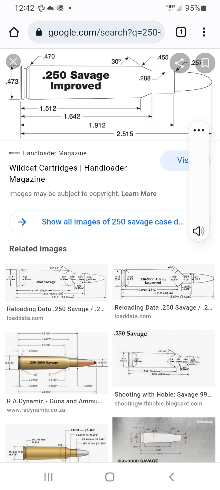

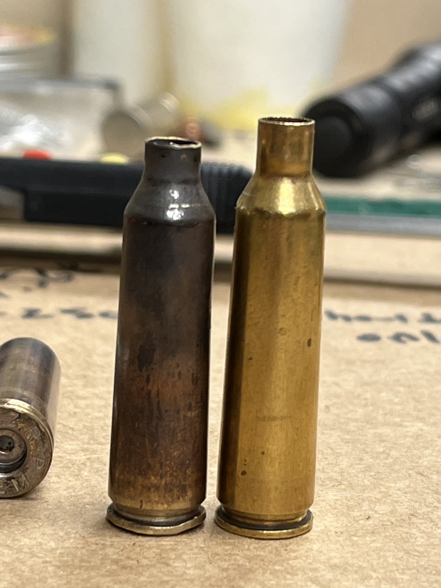

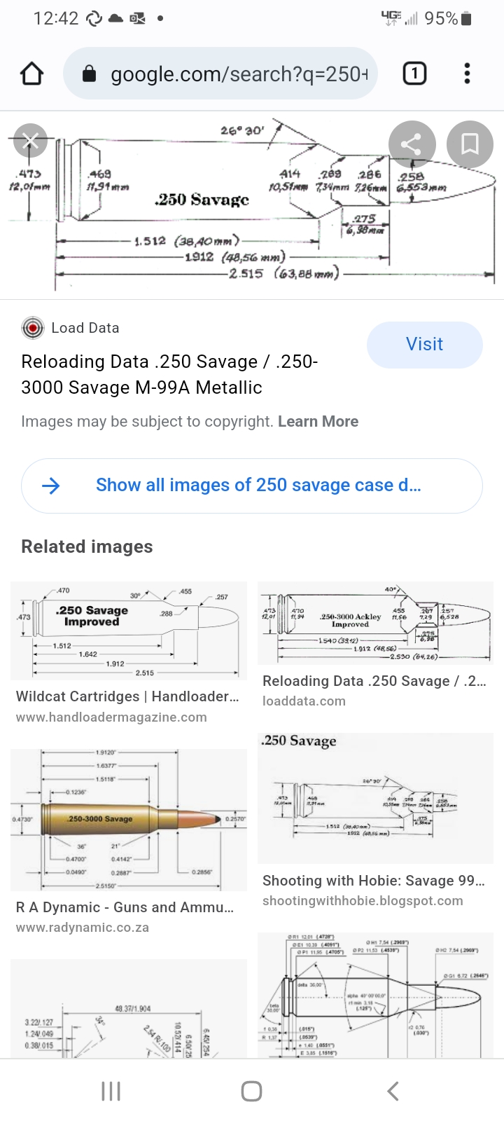

Ok so has some significant shoulder setback when roasting a 22-250 case and closing in chamber. Had to trim some to get it to got so don’t pay attention to the mouth. Plain 22-250 case measures 1.568 in the headapace comparator, and the modified case comes in at 1.520
250 savage is 1.510 In the Speer #9. The 250-3000 is 1.512 in the Nosler #3 book.

Shoulder angle difference is noticeable with brass sitting next to brass, versus looking at the cast and brass

Ok so has some significant shoulder setback when roasting a 22-250 case and closing in chamber. Had to trim some to get it to got so don’t pay attention to the mouth. Plain 22-250 case measures 1.568 in the headapace comparator, and the modified case comes in at 1.520View attachment 7851476View attachment 7851477
What's with the bent rim? Dumb question, cuz I'm a dum guy, You did check headspace by first putting the case against the boltface with the rim under the extractor? And, no pics of chamber or your own boltface? Or, feed it from the magazine?

Same as any 3006/270 m54 or m70.
You can't see the extractor cut in his pics bc the casting overflow covers it.
You can't see it on the casting bc no pic of it turned that way to see it.
You figure out yet he re- "cast" the chamber with an over annealed 22-250 case.
Looks like he bent the rim extracting sed cast...
Where's @Skunk when you need him, he might have some insight into this as well.
Bent rim is from pushing the bolt forward to from case.

As to what @Marksman said about a die, running a 250 savage case in a 22-250 die to neck it down, the 22-250 is longer, and can easily be seen in the photo taken of a 22-250 case next to the hard sized to Roosters chamber case. In a 22-250 die, the neck would only be half sized.
Cutting the bottom off a 22-250 die to the right length would work. Dies are hard to cut, but, I've had dies shortened.
Otherwise, to get enough shoulder width, when trying to just neck size an odd case, I have used a 6mm Rem BR bushing die for that with a correct size bushing. (On some similar undertakings...)
